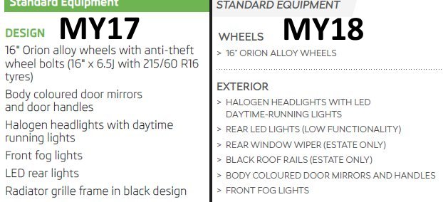

On 12/10/2017 at 10:34, Alan_P said:
Interesting… what month was your car built? Is it possible the current brochure doesn’t tie in with all MY18 cars and the LED sidelights were added a little later? Could you take a pic of your headlight sticker?
Brochures:
It is really annoying, but even if I was OK with the original sidelights, I wouldn’t have been OK with removing the bumper and headlight then a realignment just to change a bulb. I certainly wouldn’t have been happy to pay the labour costs either… or even the ridiculous amount dealers charge for a conventional PWY24W. Dropping the liner is definitely the easier job and now I just remove a cap to change the bulb.

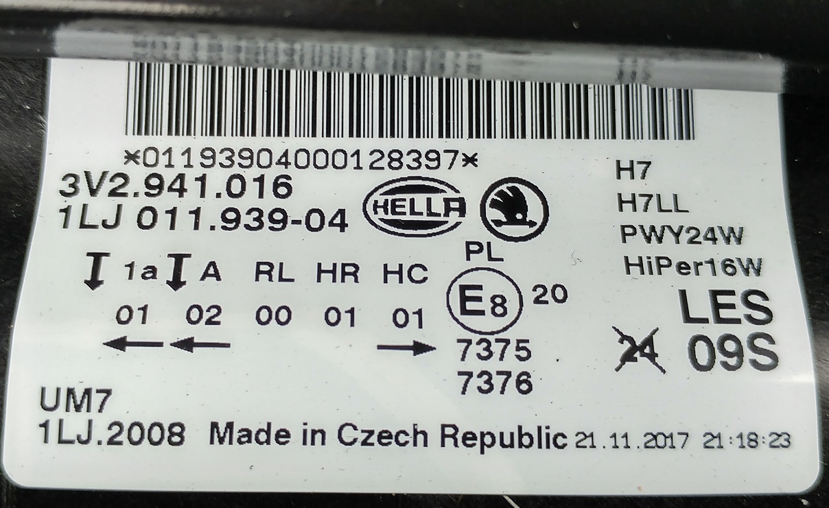

The brochure lies! Got my car Friday and its has yellow Halogen DRL's! They look even worse now as have Philips Racing H7's installed. Trouble is no locking wheel nut key I can find so can't take the wheels off yet, will contact the dealer as I expect its left on a torque wrench in their workshop, I ordered a space saver but got a 205/55/R16 spare, trouble is real tyres are 215/55/R17 so a different circumference by over 5% ....
My headlamp sticker below
Cheers
Thanks for the update. Not sure if they changed their mind about the spec or it’s just a straight up brochure error… not good.
I was also missing the locking nut key (and a few other items) but they were insistent I brought the car in and ordered a new set to be fitted. I ended up getting the same one so it was either a huge coincidence or they had a few keys (including mine) kicking about.
I seem to remember the spare isn’t the same circumference as it’s only for temp use… maybe someone can conform the size it should be?

Don’t suppose anyone’s got a photo showing the current MY18 LED DRLs with the standard halogen headlamps?
I ordered a Superb 1.4 TSi DSG hatch just after Christmas. Standard headlamps at the front, but LEDs at rhe rear - not by choice, but because they come in a package with the electric tailgate.
I’ve seen plenty of photos of the rear LEDs, and LED DRLs with xenon fronts, but none of the LED DRLs with your basic headlamps.
Realise I’m probably 94th person to ask this question...
Edited by MorrisOx
It doesn’t have them… the brochure is wrong:
There is a picture on the previous page of this thread showing a 17 plate version, to my eyes on my car they look even more yellow on my 4 day old 67 plate.

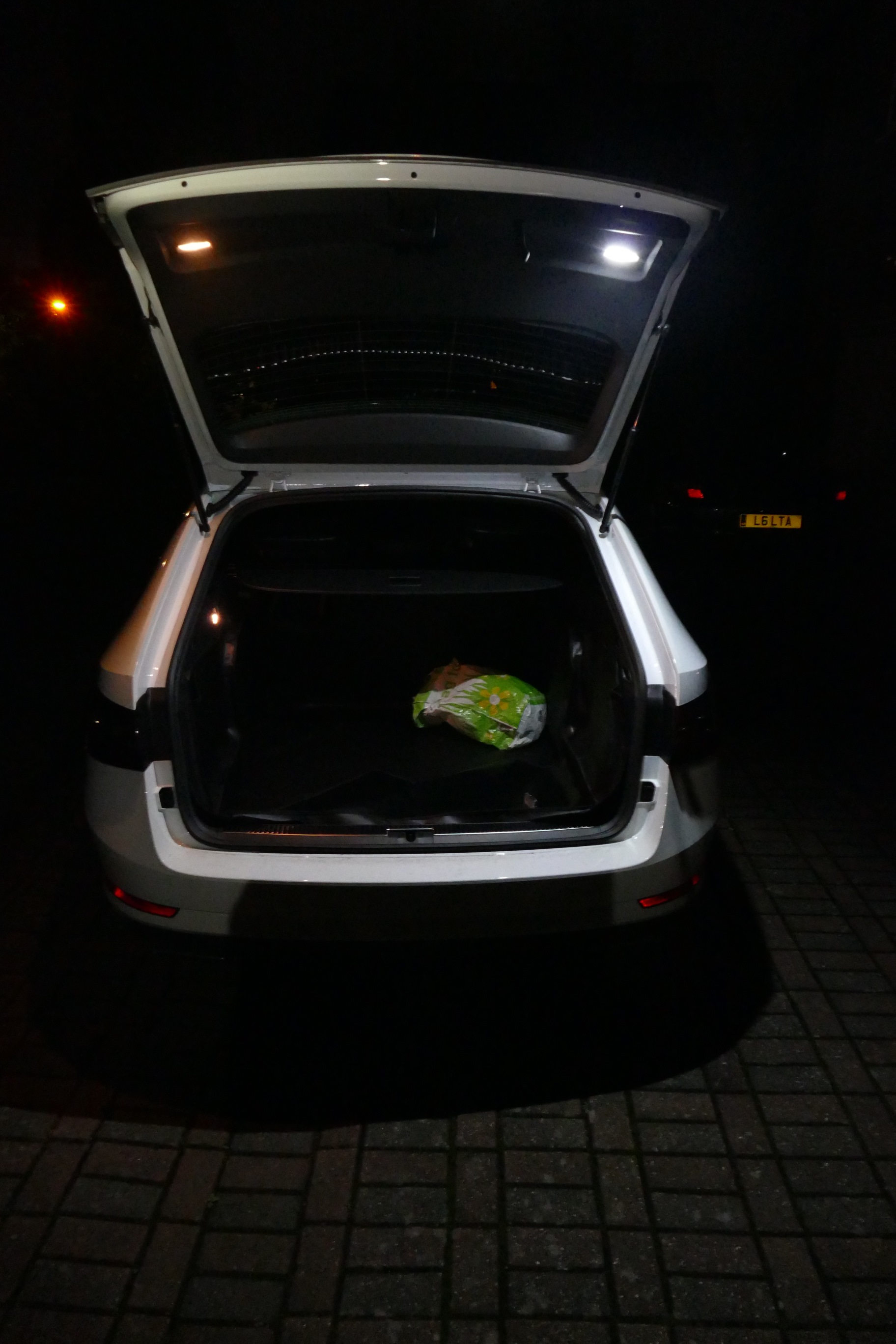

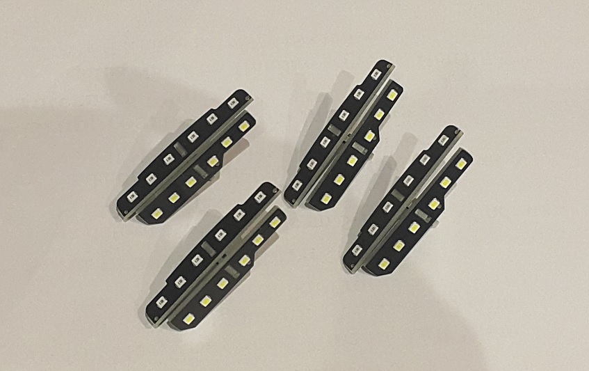

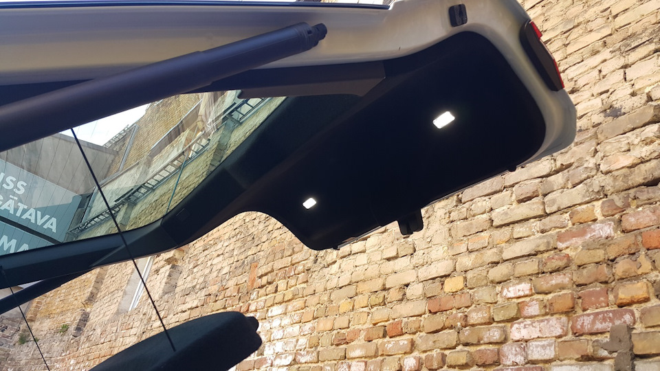

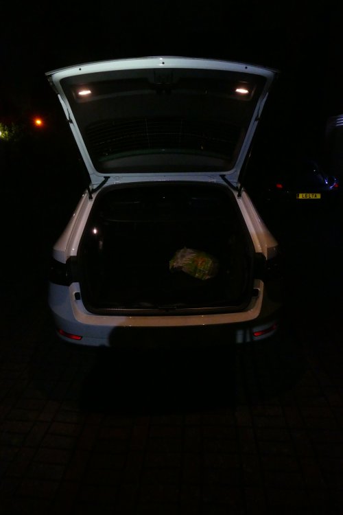

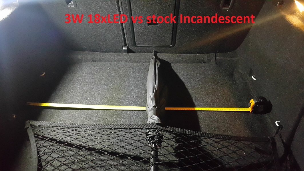

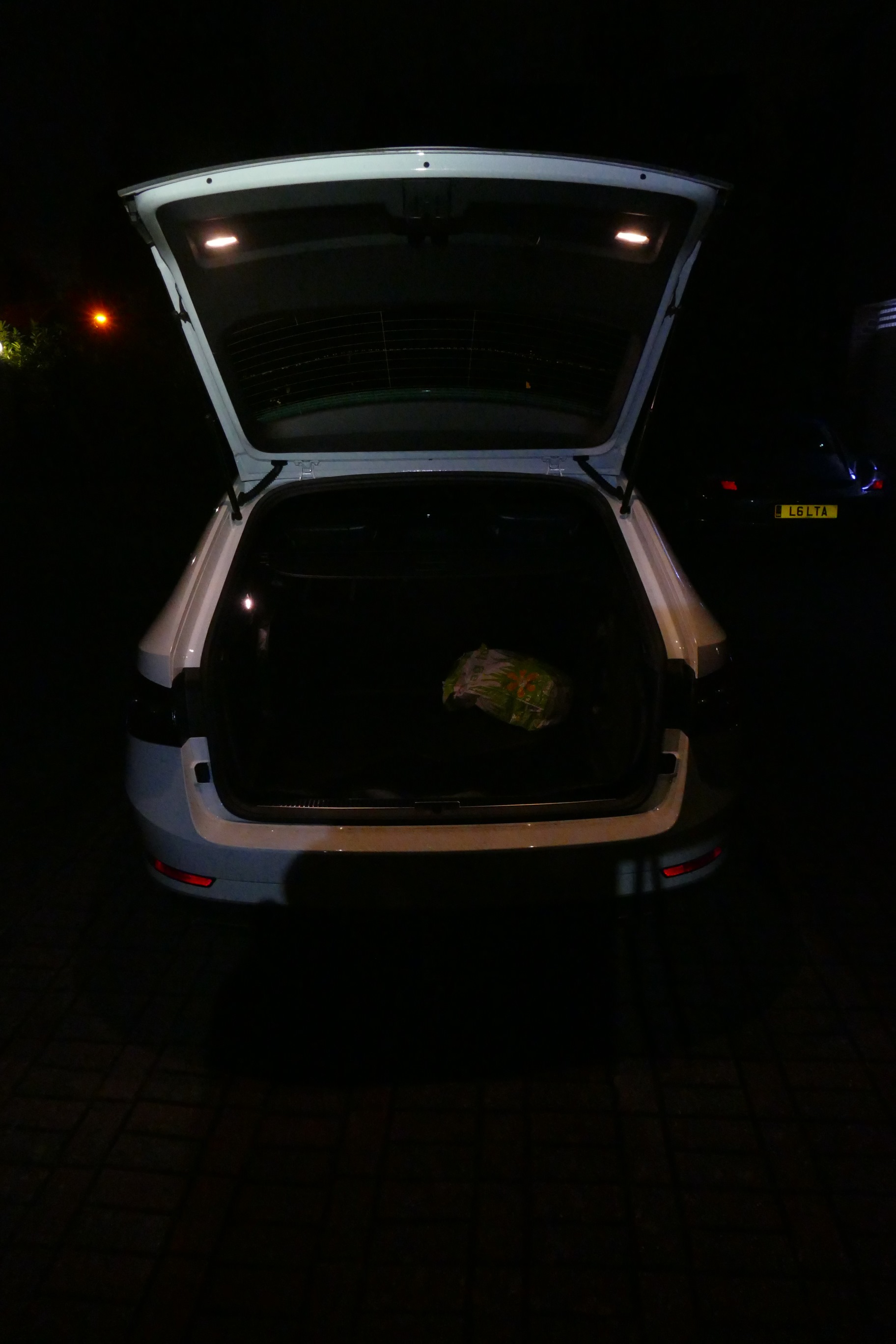

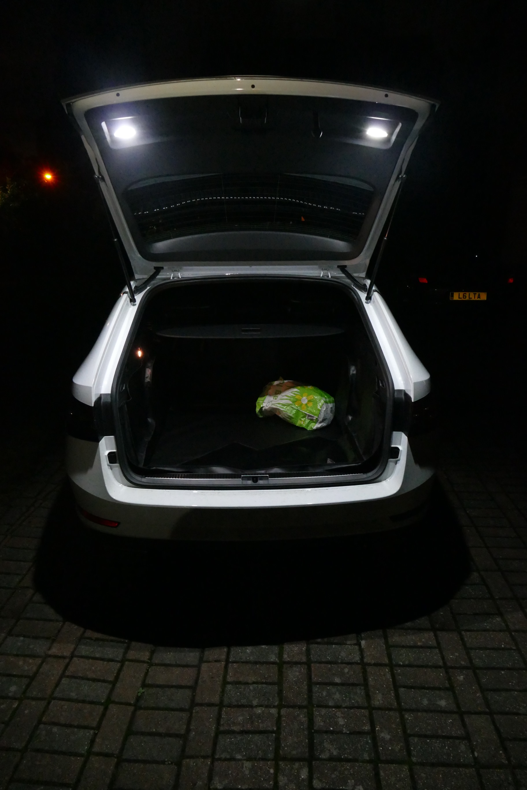

Just installed these in the tailgate https://www.ebay.co.uk/itm/LED-Courtesy-Luggage-Trunk-Boot-Footwell-Door-Light-VW-Passat-CC-Golf-Rabbit-Eos/262431708090
They needed filing a bit on the back corner furthest from the wires to fit into the holes without excessive force but nothing tricky, 20seconds filing at approx 45degrees across the back edge.
The wire clips are also rather a tight fit but they do go in once lined up right.
Pictures speak for themselves really - converted from pointless to useful.
Exposure was locked for all the pictures.
Standard
New on the right
Both replaced
The box label
Edited by paul_7_7_7
Looks a lot better that.

to complete trunk illumination
hatch's ownenrs have to install extra two bulbs under cover,
but combi's two extra bulbs in the trunk
€13,46 two pairs from Ali
Im surprised you felt the need for these additional lights, I ‘only’ have the two in the boot (replaced with superskoda LEDs) and they are more than bright enough to light the whole boot up.
it's perfectly illuminated when empty,
insert some suitcase and there is darkness
as well bulbs from the top little bit illuminating ground area around car's rear
i not regret, also after had to pay 39e to dealer for install them

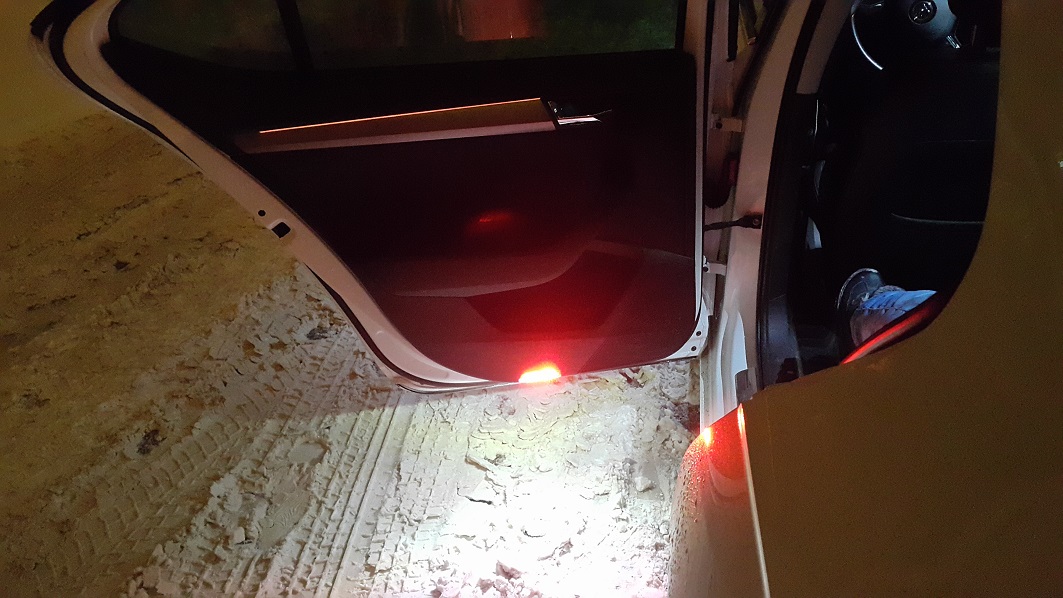

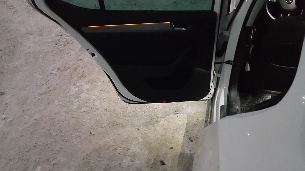

finally have added bulbs also to rear doors!!!
long delay were connected to a fact they originally are powered by controllers(2х ~110€)
which are installed only in L&K.
but on russian forum i found info how they were added in Tiguan
https://www.drive2.com/l/487533077556363352/
and the same instructions were approved also there by @przemoka
On 12/16/2017 at 14:59, przemoka said:
I connected positive to the engine (the thick white-red cable, pin 2)
and the negative to door lock cable (yellow-brown, pin 2).
before
after
i had already bulb's bodies from front doors and i asked Ali to send only LEDs,
by mistake they sent 6+6 SMD version instead full set pictures have 6+12 SMD
but anyway that is lot better than stock reflectors 1K0 947 419 A.
how does look 6+12 version you can see in previous post about front doors
p.s.
LEDs in original 1KO 947 411 bodies produces little bit pink colour
instead LEDs in Ali's 3AD 947 411 bodies are perfectly red
