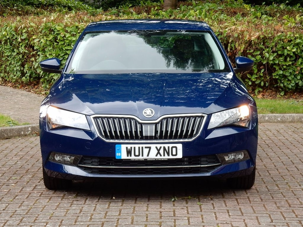

A DRL Bulb question re MY2018 with Halogen Headlights, SE Tech due to arrive late December.
Brochure on page 18 suggests even for S models,
> HALOGEN HEADLIGHTS WITH LED
DAYTIME-RUNNING LIGHTS
But looking at pictures such as the below from MY2017 cars it looks like they used to be or still are halogens or perhaps low colour temp LED's, has anyone just got a MY2018 to comment/send a pic?
Looking in the manual it only shows how to replace the two headlights, no green element for the DRL position.
Is there a thread somewhere else on this?
Any help appreciated as the ones below don't look good!

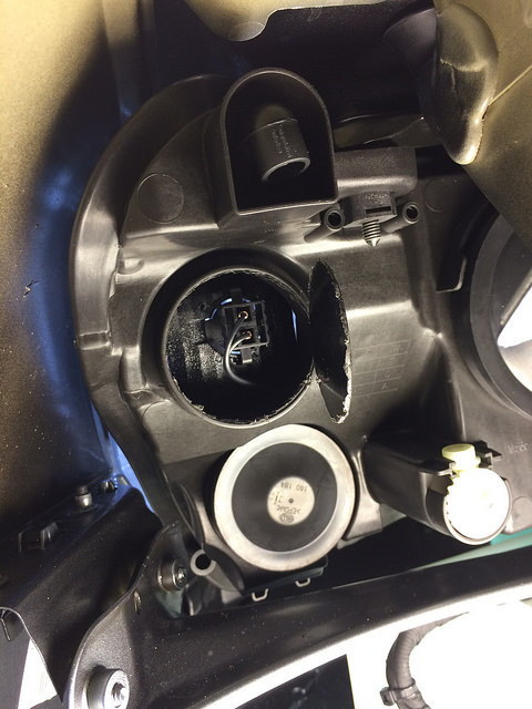

Upon looking again, am wondering if i could get a dremel tool in behind the DRL to cut the plastic cover and then reach in by hand.  its tight, but may just work...
Is it possible to get a suction cup on the cover or glue something to it so that you can pull it out?
Certainly built after week 22 so must be a build or brochure error... or updated shortly after?
It is thin plastic, but I doubt it would snap out neatly without cutting. I cut it with a Stanley and the cap from the indicator fits perfectly… see SJCSE’s image below:
As you can see the indicator is actually less accessible but they allow for DIY :wacko: I thought about a Dremel but it is tight and didn’t want cuttings and dust dropping into the unit. I suppose you could vacuum it out.
Its not a cover as such - the back is actually moulded closed.

Thanks, yours look good! But your car has what in the UK is called BI-XENON HEADLIGHTS (a £1,295.00 option) so the DRL's are different, my question re the lower spec cars with Halogen headlights like the blue 17 plate picture I posted.
