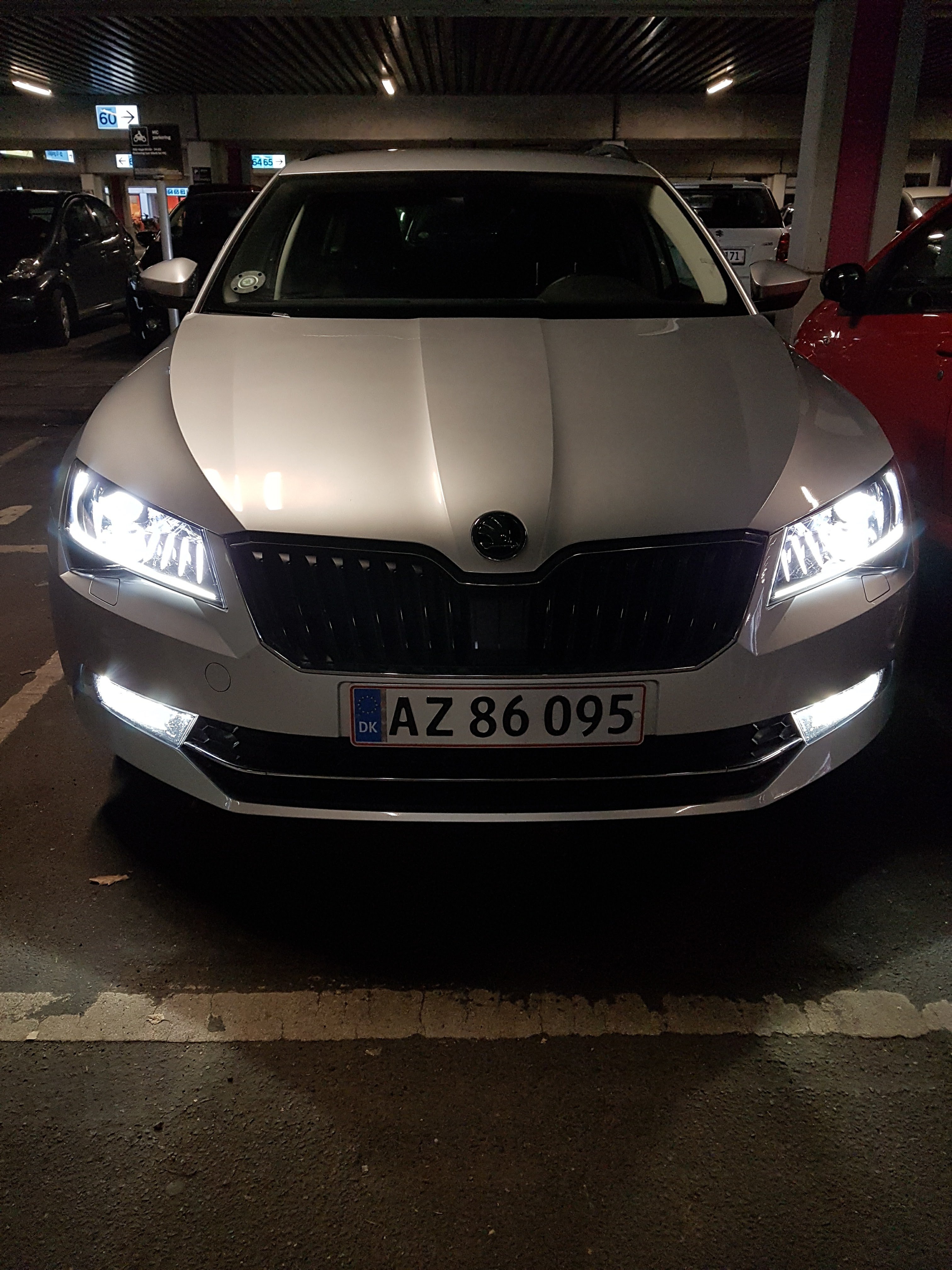

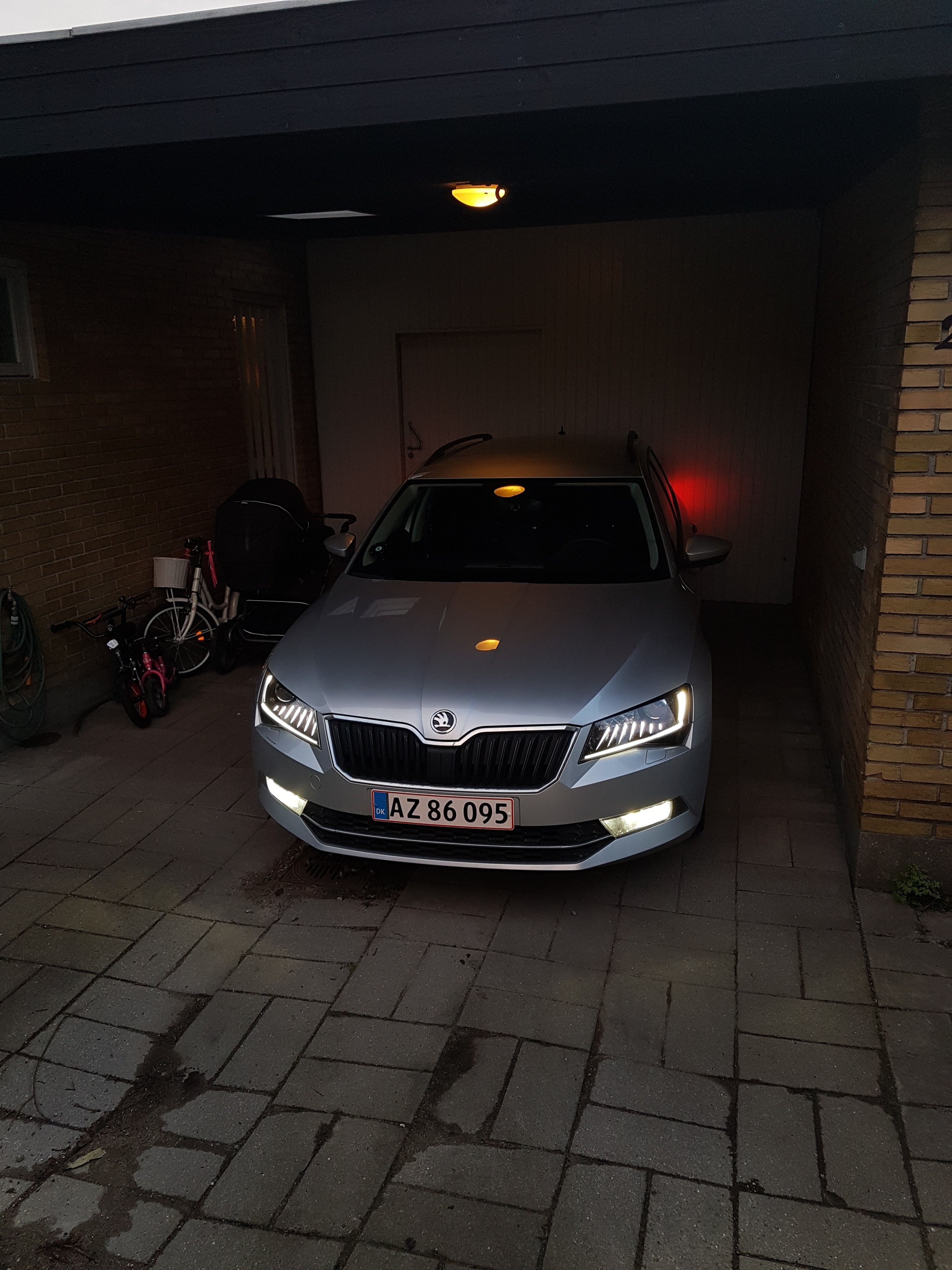

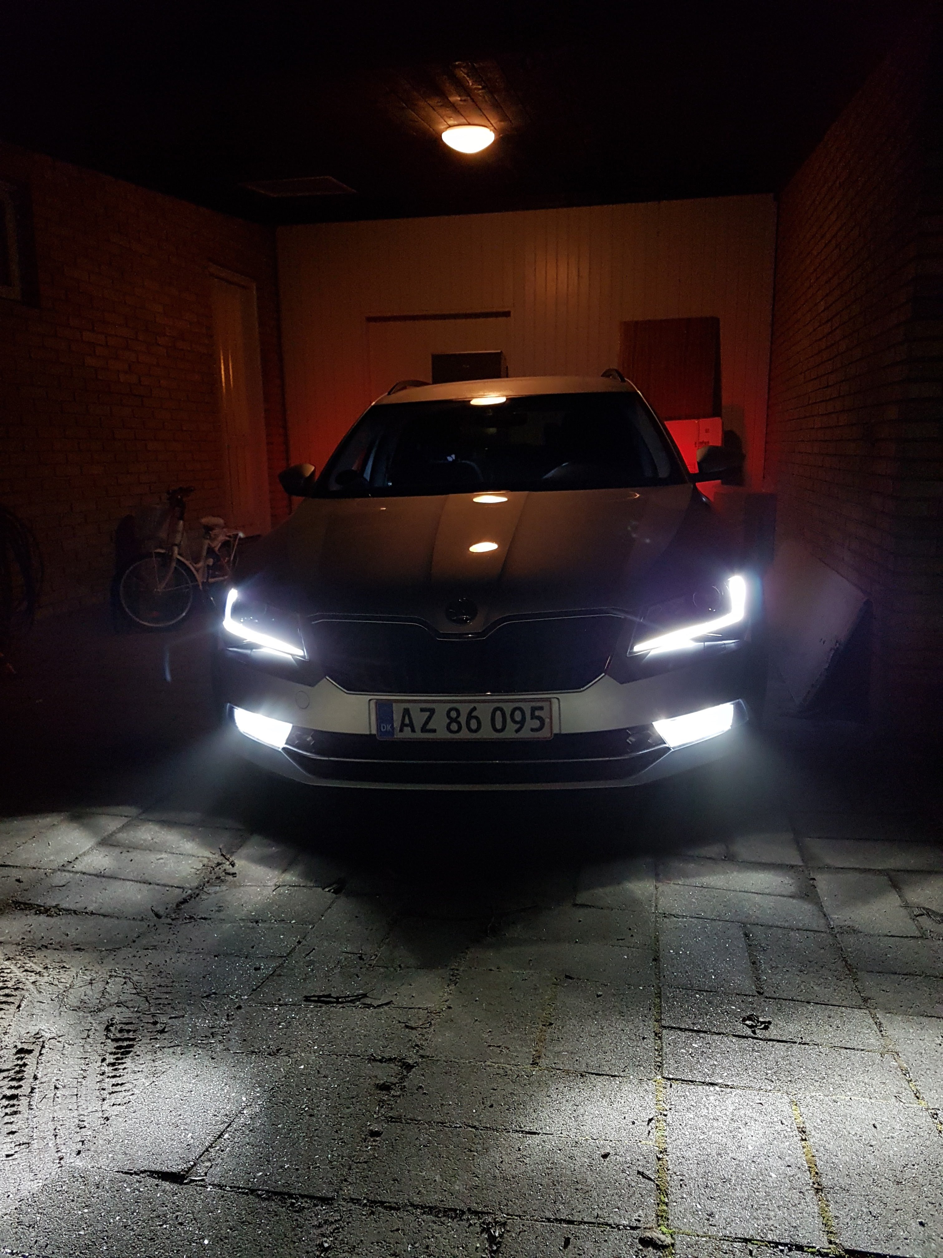

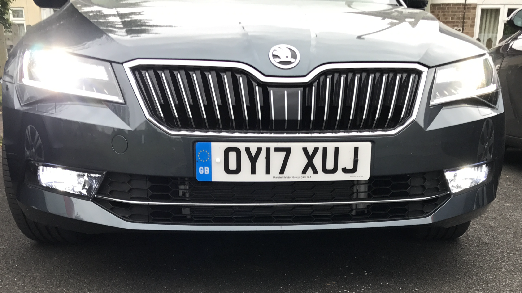

 I actually did something somewhat controversial. I removed the original xenon bulbs and retrofitted 55w LED bulbs soldered to the ballast wiring harness to achieve the best output and comparable to the original LED stribes Kelvin color.
Also I mounted 30w LED bulbs in the fog housing.
and the verdict...

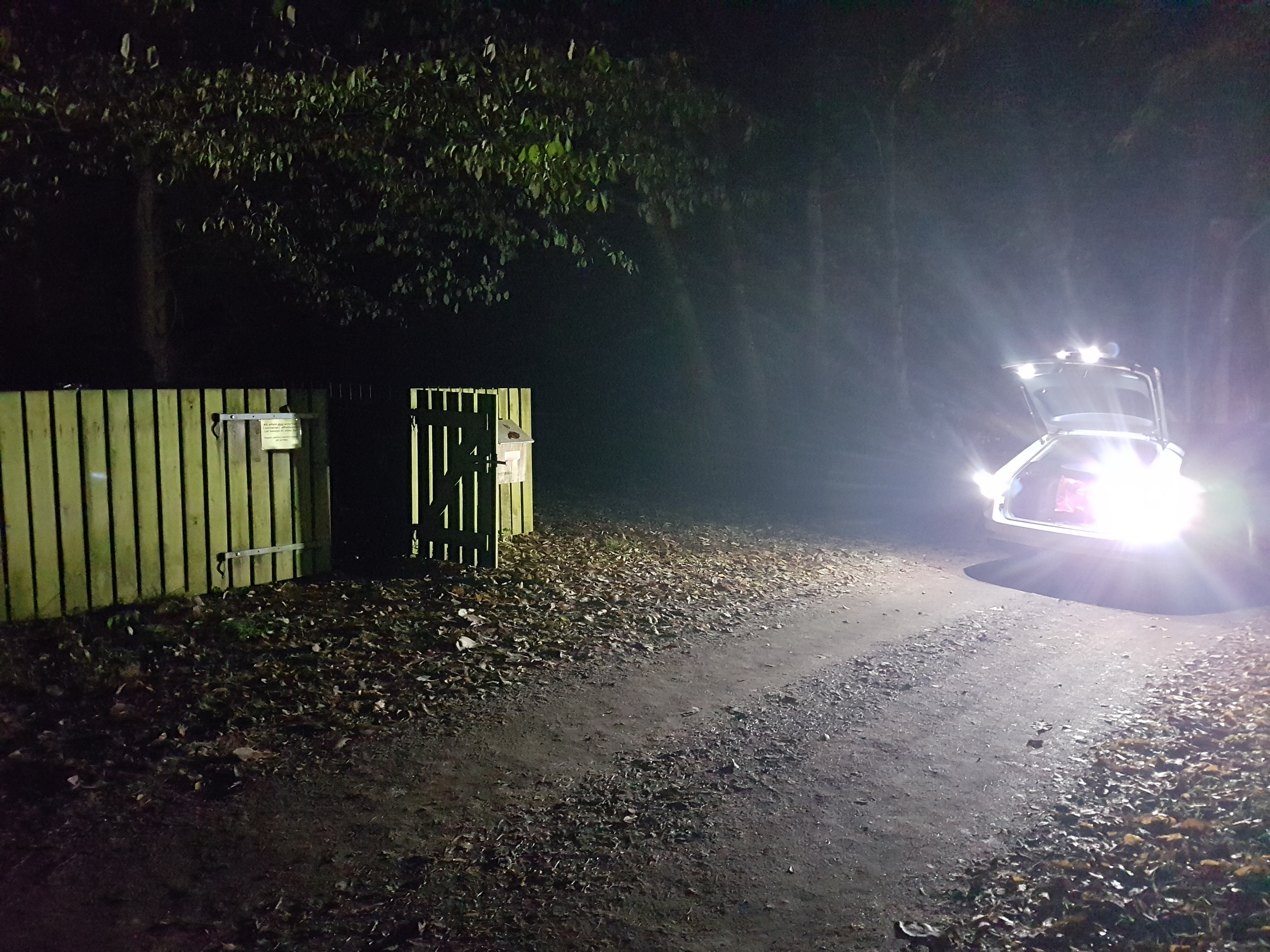

I have to ask, what the f*** did you mount for the Reversing lights? It looks like you gor a Xenon at the back... or is it just the Photo?
How is the Led 55w compared to the Xenon? And how did you fit it in the housing?

7 minutes ago, Gizmo68 said:
With these LEDs they come on and go off instantly, they do not dim down slowly.
I understand. This is not a problem on the car, is it? Lastly, the product you give your address is not for sale. I copied it, but I still can not find it, can you help? For example, does this product fit in?
https://tr.aliexpress.com/item/Super-Bright-Car-Headlights-H7-LED-H8-H11-HB3-9005-HB4-9006-70W-7000lm-Auto-Front/32684222030.html?spm=2114.13010608.0.0.tcwKvu
Edited by fzl66
Just google:
Generation 2S LED Car Headlight CREE ETI Flip Chips 12V Car Headlight 30W 3600LM
 This found https://tr.aliexpress.com/store/product/Generation-2S-LED-Car-Headlight-CREE-ETI-Flip-Chips-12V-Car-LED-Headlight-30W-3600LM-Aluminum/335027_32265512967.html
As for your link they may fit but the ones I fitted the cables touch the washer bottle... so space is tight, it all depends where the cables join the LED

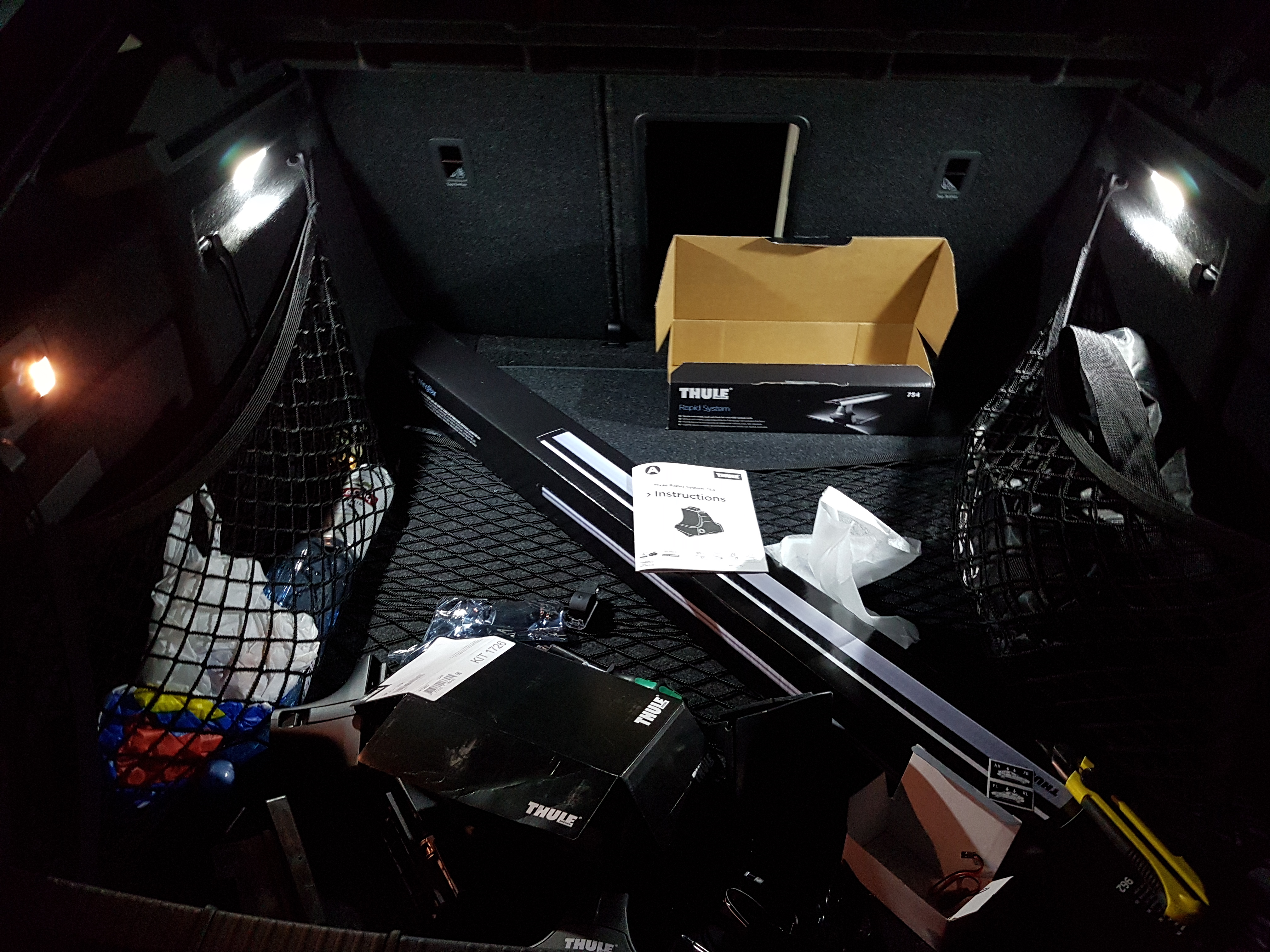

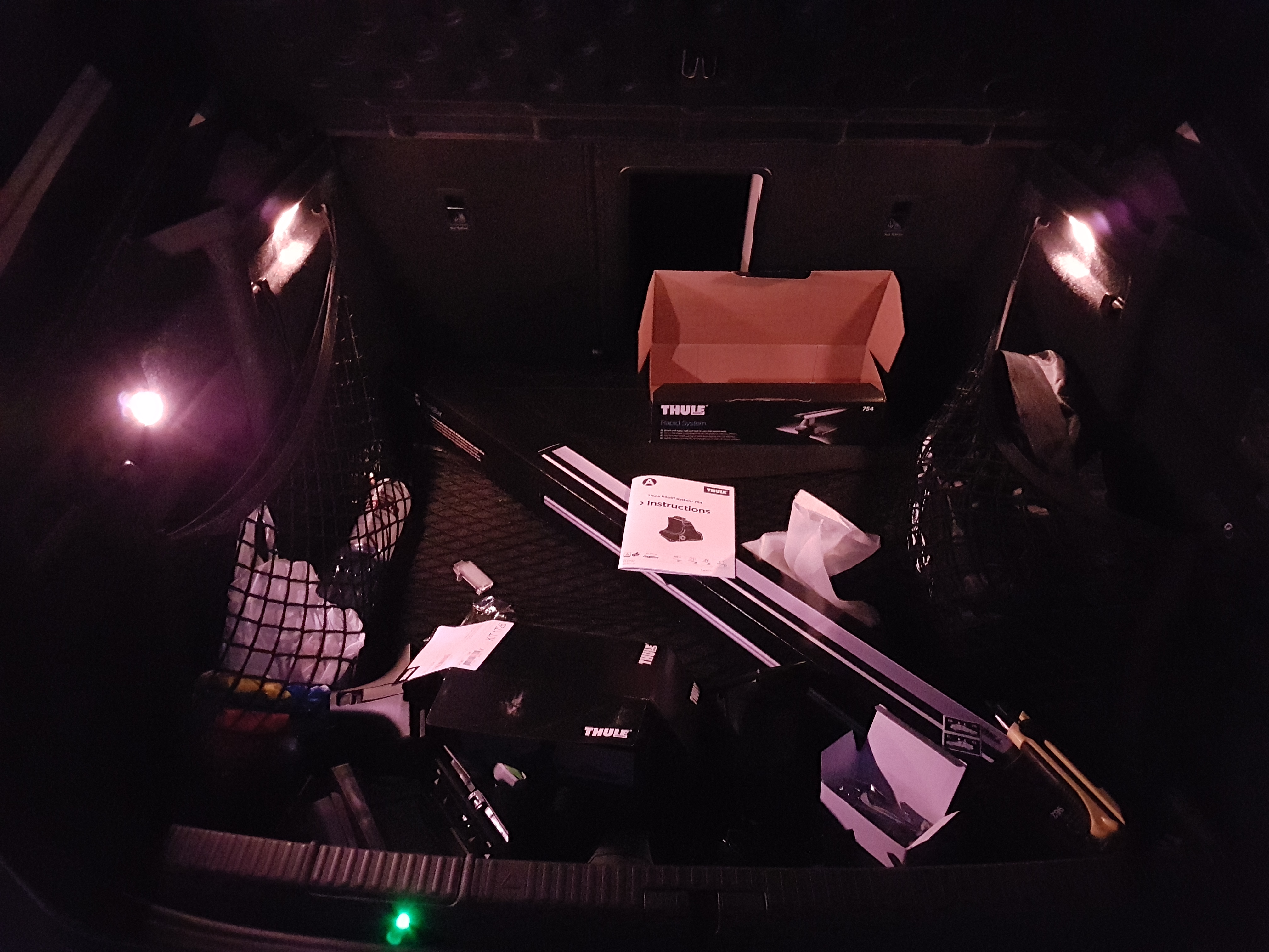

Installed LED-s in luggage room. They seem to be very good for money ($9.50 from Aliexpress). Hopefully they will also last.
Aliexpress product link
Before (Don't know where this pink tone came from)
After
For me difference is huge and light level is superb.

1 hour ago, fzl66 said:
Okay I'll take that into account. Measuring the distance between the fog and the washing box is 4.2 centimeters. The product you are offering is not for sale. Would you mind looking at this product? If it is harmonious; (Https://www.aliexpress.com/store/product/CNSUNNYLIGHT-Car-Headlights-H7-H11-LED-H1-9005-HB3-9006-HB4-H3-61W-9000Lm-Mini-Auto/1473227_32796090581.html ? Spm = 2114.12010608.0.0.XALhMC)
 I need some more help :)
1: Will the 6000 k be be compatible with DRL?
2: 30W when you recommend it, but most products are higher than that. For example in the address I give 62W.
sorry I fixed link
Edited by fzl66
They should be fine (even in a 280)
6000k may have a slight blue tint to them, I usually go no higher than 5000k
62w is for a pair = 31w each
My car is an Active version. In Denmark the rear light cluster on Active doesn't contain the small "blinds", that on the higher versions hides the bulbs, if you know what I mean. Hence, small LED bulbs with a reversing projektors will actually have better and more targeted output.
Oh right got it :) tnx!
29 minutes ago, Blindek said:
Question. You replaced your Xenon bulb with a LED one? How did you connect it or rather did you connect it to the xenon bulb connector?
And what of a difference does it make?
The LED driver (ballast) is simply soldered into the original wirering harness, that provides 12v+ and ground to the original ballast, that drives dipped beam.
so, Did I find out what I was looking for?
https://www.aliexpress.com/store/product/12V-30W-5000K-6000K-4200LM-2PCS-P7-H8-LED-Car-Headlight-Bulbs-Waterproof-LED-Lamp-CSP/1774151_32683642888.html?aff_platform=aaf&cpt=1493885734471&sk=VnYZvQVf&aff_trace_key=00e23e51296d4eb8b4e5154582762b36-1493885734471-00411-VnYZvQVf
On 04/05/2017 at 09:27, fzl66 said:
They are too long as they are 57mm from the mounting to the end not including the wiring loom
sorry I don't understand Is this not appropriate? I guess on the side of the cable entrance. 57 mm not reach length.
What do you think about the actual performance of the LED setup compared to Xenon? I've had expensive LED conversions done on past cars, but nothing was even close to how bright my Superb's AFS is.

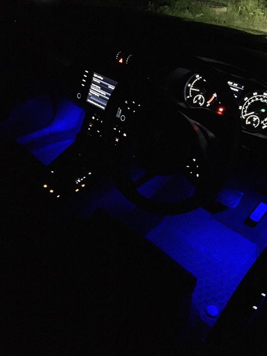

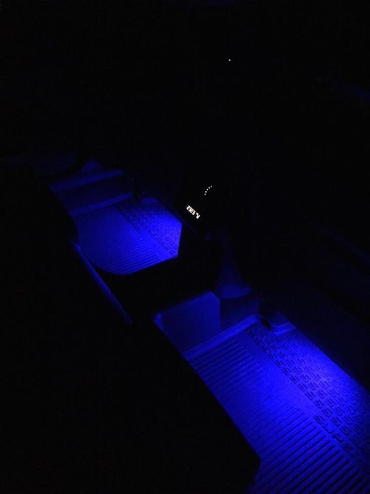

On 2017-4-19 at 10:09, Jaytip said:
Following Gizmo68 advice on what bulbs to use (5050 W5W LED, lots of choice on EBay) I changed out the white foot well bulbs for blue led ones to create my own DIY ambient lighting. Very pleased with the result.
Do you have a link to the Led's you used? There seem to be so many different variations of led placement/sizes/number of leds and all under the same W5W 5050 T10 reference. I haven't got the car yet so can't check and  don't want to order the wrong ones or something that is too bright. Thanks
