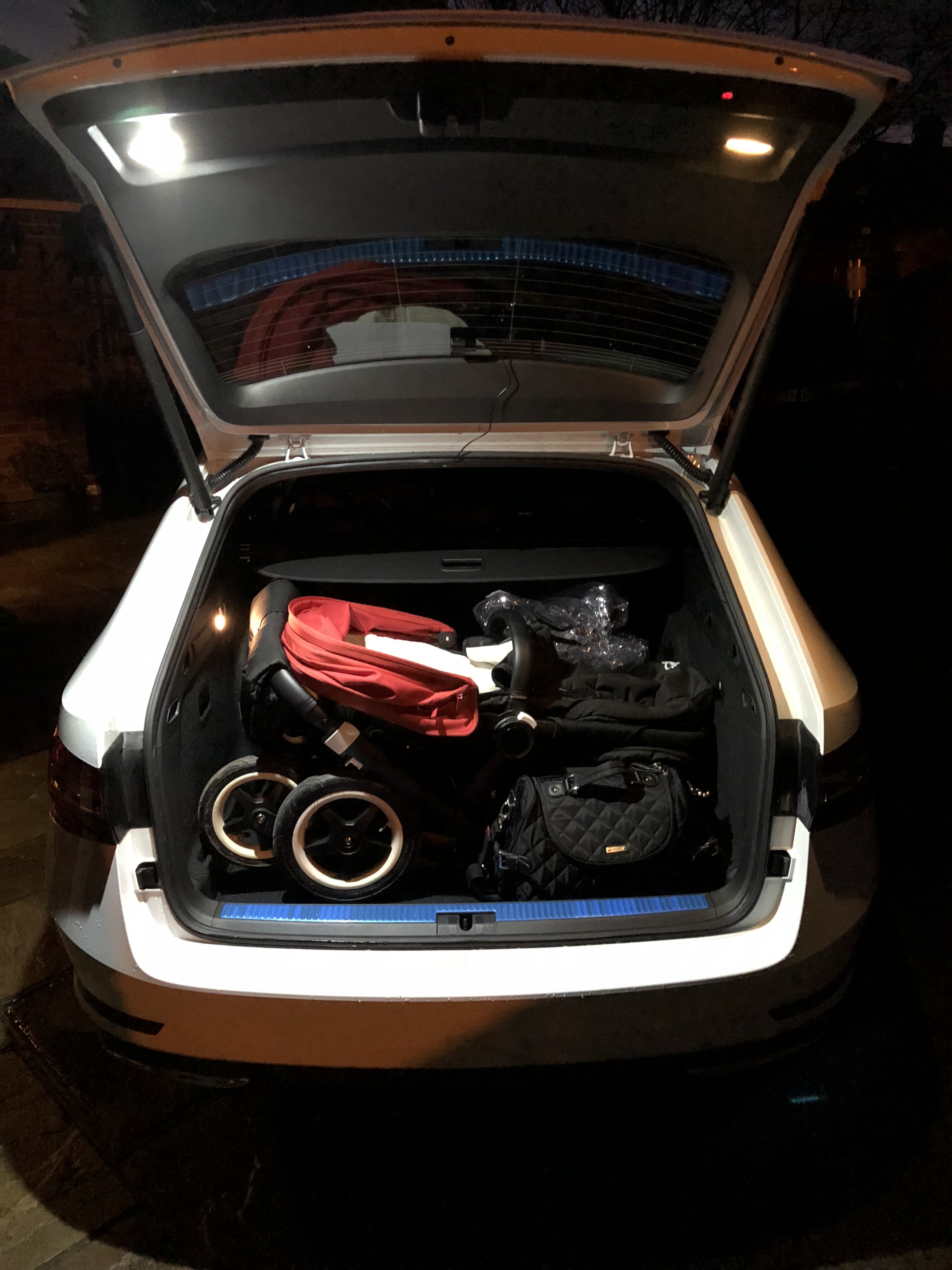

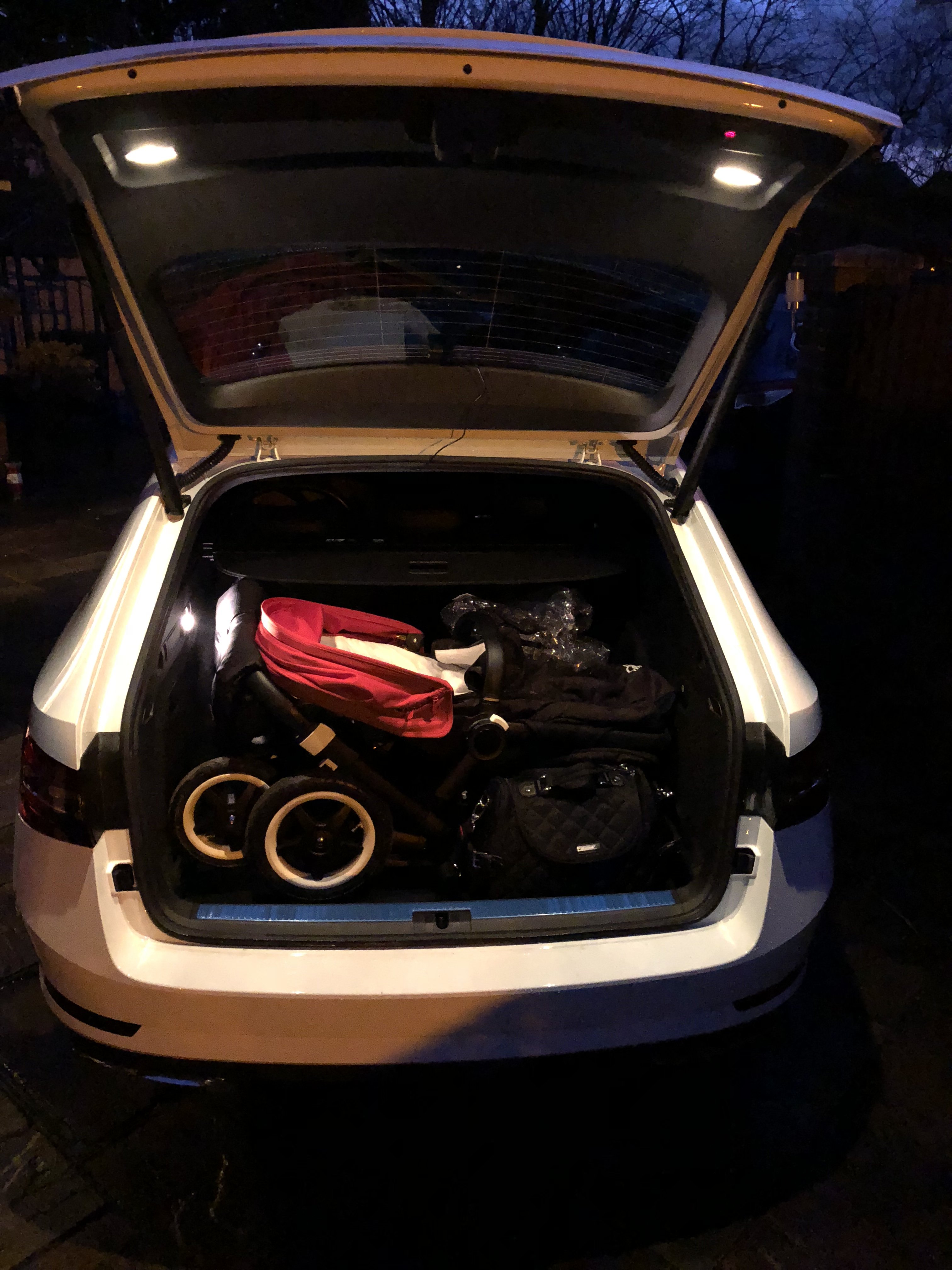

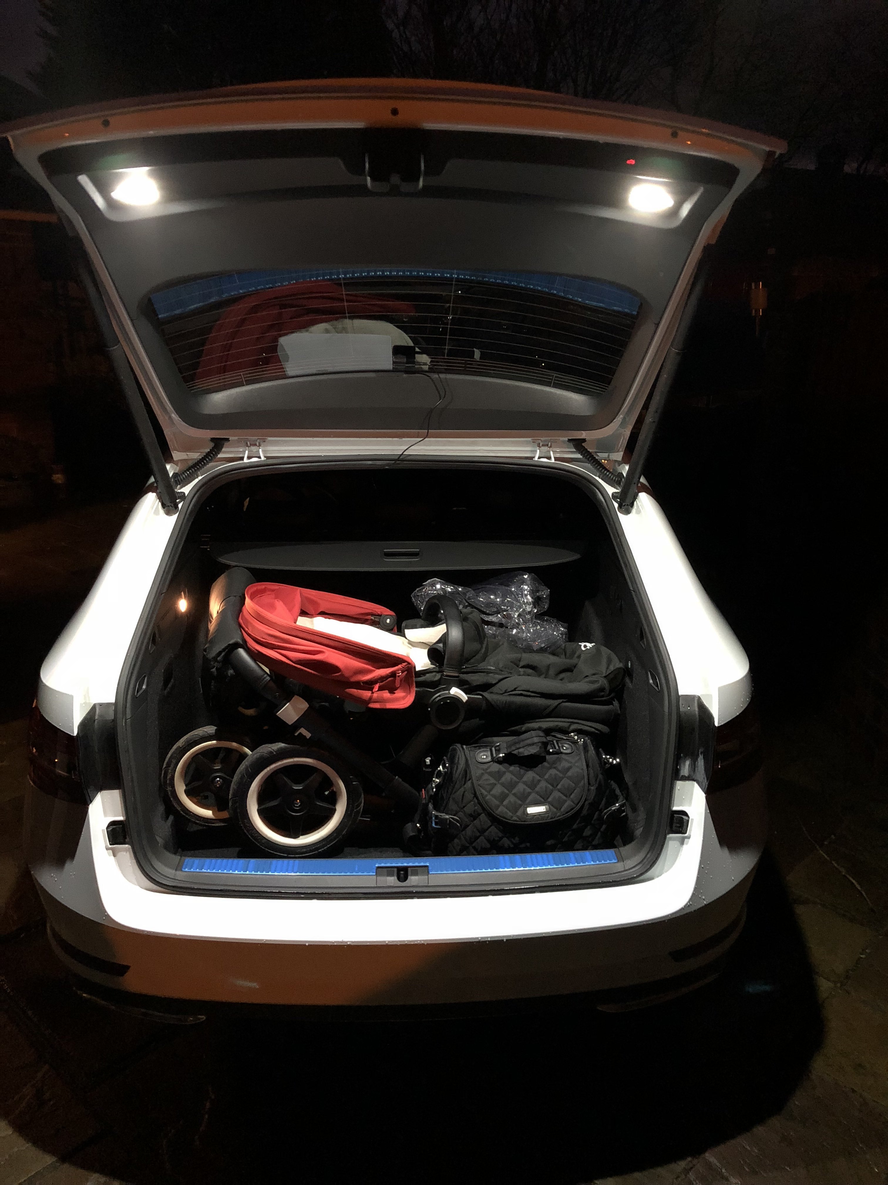

Fitted but my photos don’t really do justice.
Happy with the result. More frustrated that superskoda now have 20% on. The superskoda ones are well made, similar to OE with a metal back casing.
The boot is well illuminated now as you can see with the Bugaboo Donkey in the picture lol.

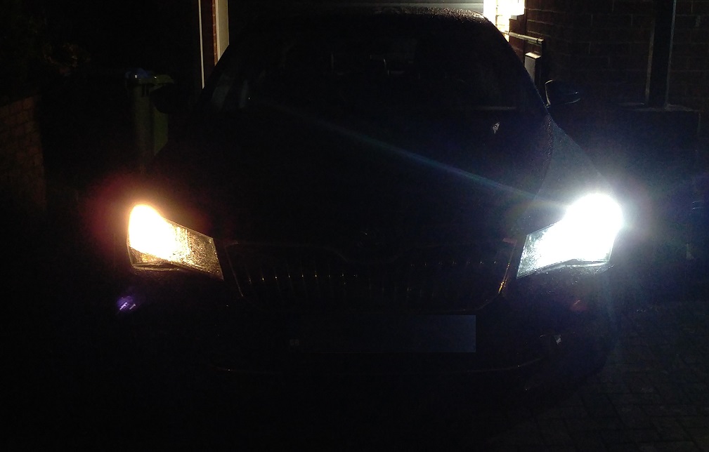

So Finally got round to doing the SE Tech DRL change, took off the wheel and arch liner, neatly cut out the plastic cap pulled out the old 10p yellow candle bulb and put in one of these, https://www.hids-direct.co.uk/pwy24w-white-60w-cree-xbd-smd-12-5w-canbus-bmw-indicator-led/
Looks great and no canbus errors plus work both as DRL and side light without issue. For a couple of quid I bought two indicator rubber covers and can confirm they fit perfectly so no need for hinges and masking tape some have mentioned, God knows why in 2018 Skoda on a + £20K car don't do this as standard, even their MY18 brochure says the LED DRL from S model but that's a lie as we know. Got dark so second one tomorrow .
Not sure on the colour temp, looks like 6000K to me, not mentioned in spec.
Phone camera makes the new one glare but with eyes they look fine, no dazzle.
Also found the front indicators are actually the same PWY fitting with Amber 10p halogen bulb, shame I didn't have some of those ready, Hids direct also do an Amber version 60W but seems like overkill for an indicator, another day maybe ...
Not shown yet but dipped beam now Philips Racing H7 (Legal) and high beam 100W MTEC https://www.hids-direct.co.uk/mtec-100w-super-white-natural-glass-bulbs-h1-h3-h4-h7-9004-9005-9006-9007/  (illegal as 100W but not normally ever on, very bright!)

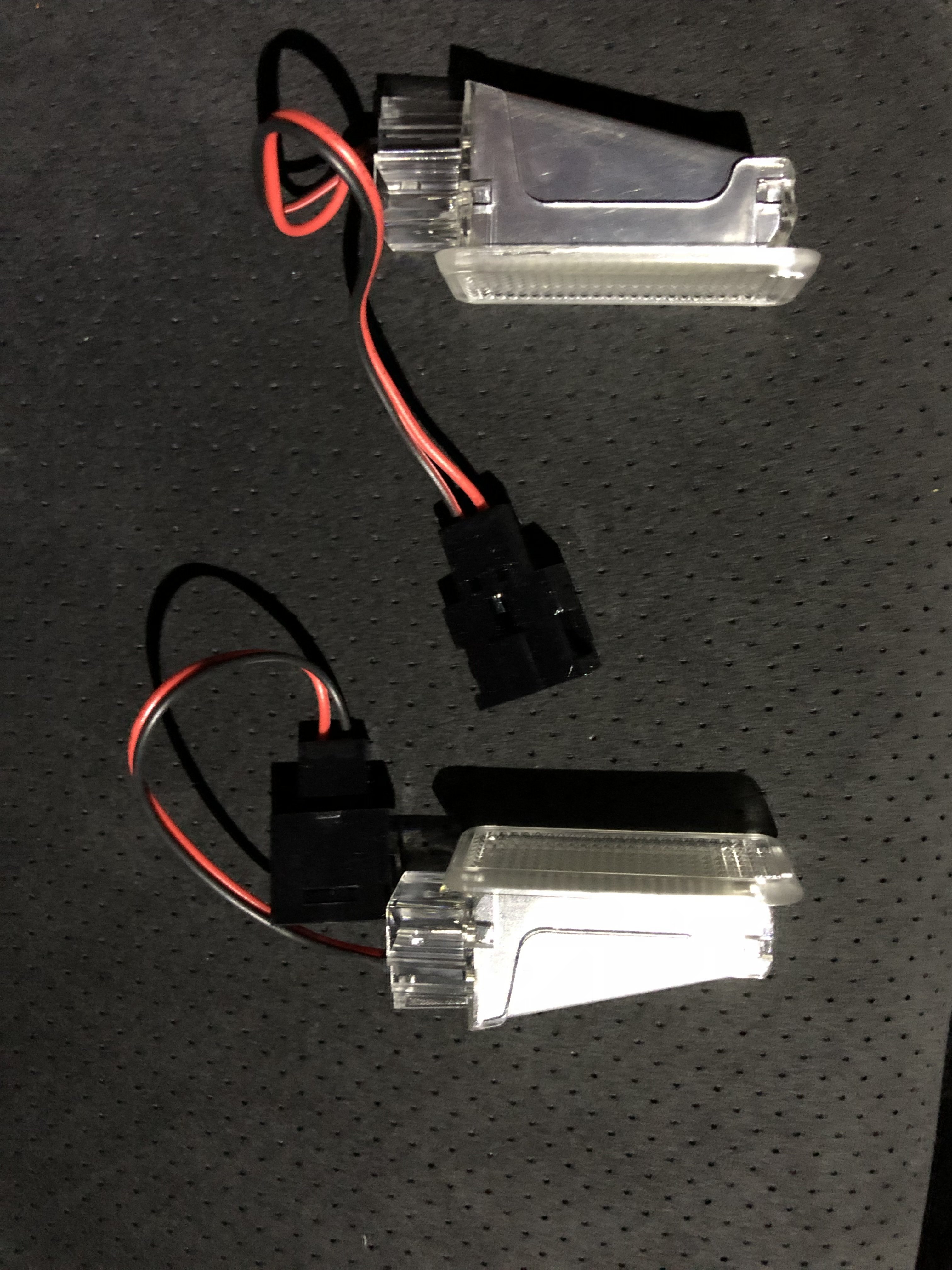

The first ones should be fine for the doors, but they look the same as the ones I just used and I found them too bright and the upper red section has a white surround (a bit cheap looking):
I have ordered these which have a replaceable bulb if they still aren’t quite right:
https://www.ebay.co.uk/itm/OEM-Warning-Red-Door-Lamp-Light-for-Passat-CC-B7-Jetta-Golf-Touareg-Skoda-VW/142341478904
The second ones you listed are for the boot by the look of the connector although I used them when adding new rear footwell lights as the case is the same size… different connector from the door warning lights though.
