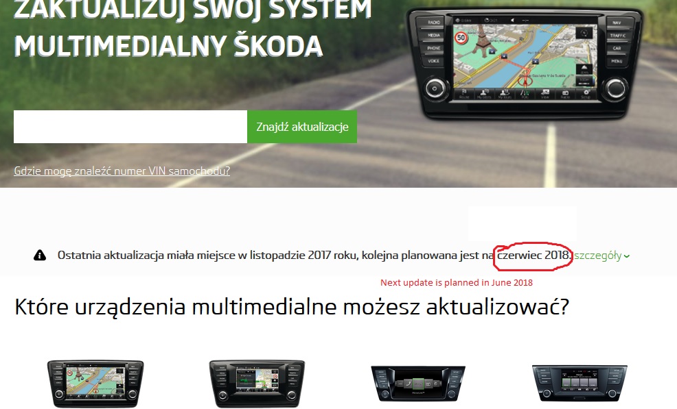

The same was in November. They changed for October and the maps were old. They made it available in October. Must wait to June
