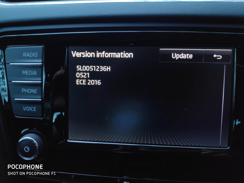

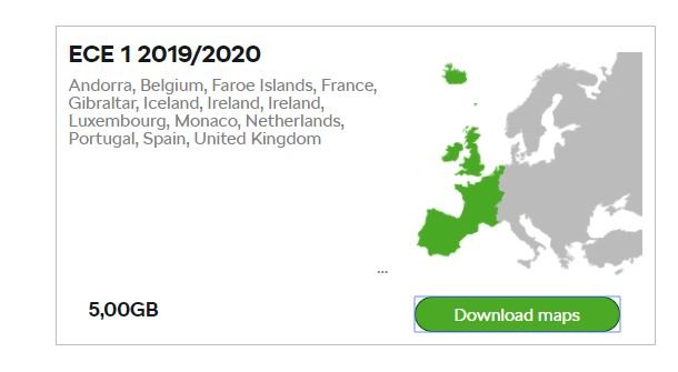

Just to clarify before i download anything my 2016 (march) Octavia SeL 1.4 tsi DSG has MiB 2 Amundsen ( 2 SD cards, no CD slot )
current info screen
and the map i should download (will only ever need UK maps)
Is this correct please advise Tia

Davefra,
You have same car as me. The latest map is the one you have shown ECE1 2019/20.
Just format the SD card (you cannot delete the security file as it's in hidden sectors). Download the map to your PC, and follow the installer instructions. Should take about 30 mins to install. Writing to SD cards is not fast!
You may also like to update your radio station images as well.
Good luck.

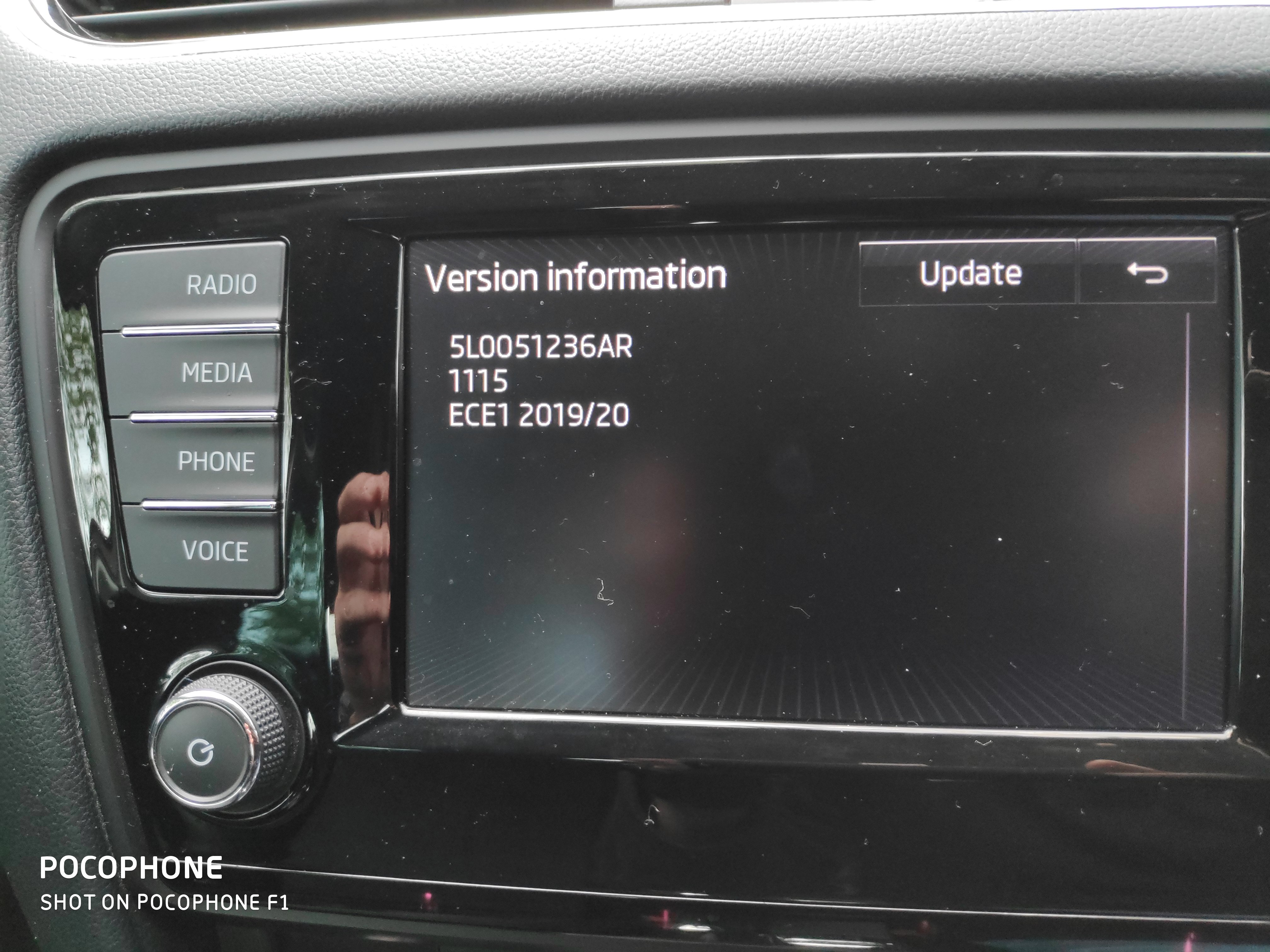

Thanks Hardgrafter, will do it tonight when i get in from work, already have the map downloaded now and 7 Zip ready ;=)
Yeah. Did mine today (Amundsen) and the format of the SD card prior to the new data seems crucial. Previously I had read that I hsould format in NTFS (tried twice and it wouldn't read it) but Fat 32 4096 worked for me. Skoda Octavia III SEL 2015.

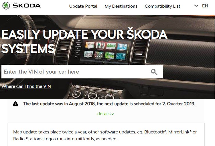

Does anyone have any idea when the next map udate is?
The update portal says "second quarter 2019" but we're in the third now.  It also says twice a year and the last one was August 2018, almost a year ago.
Edited by BionicJohn
Well, knock me over with a feather!  The map update has appeared!

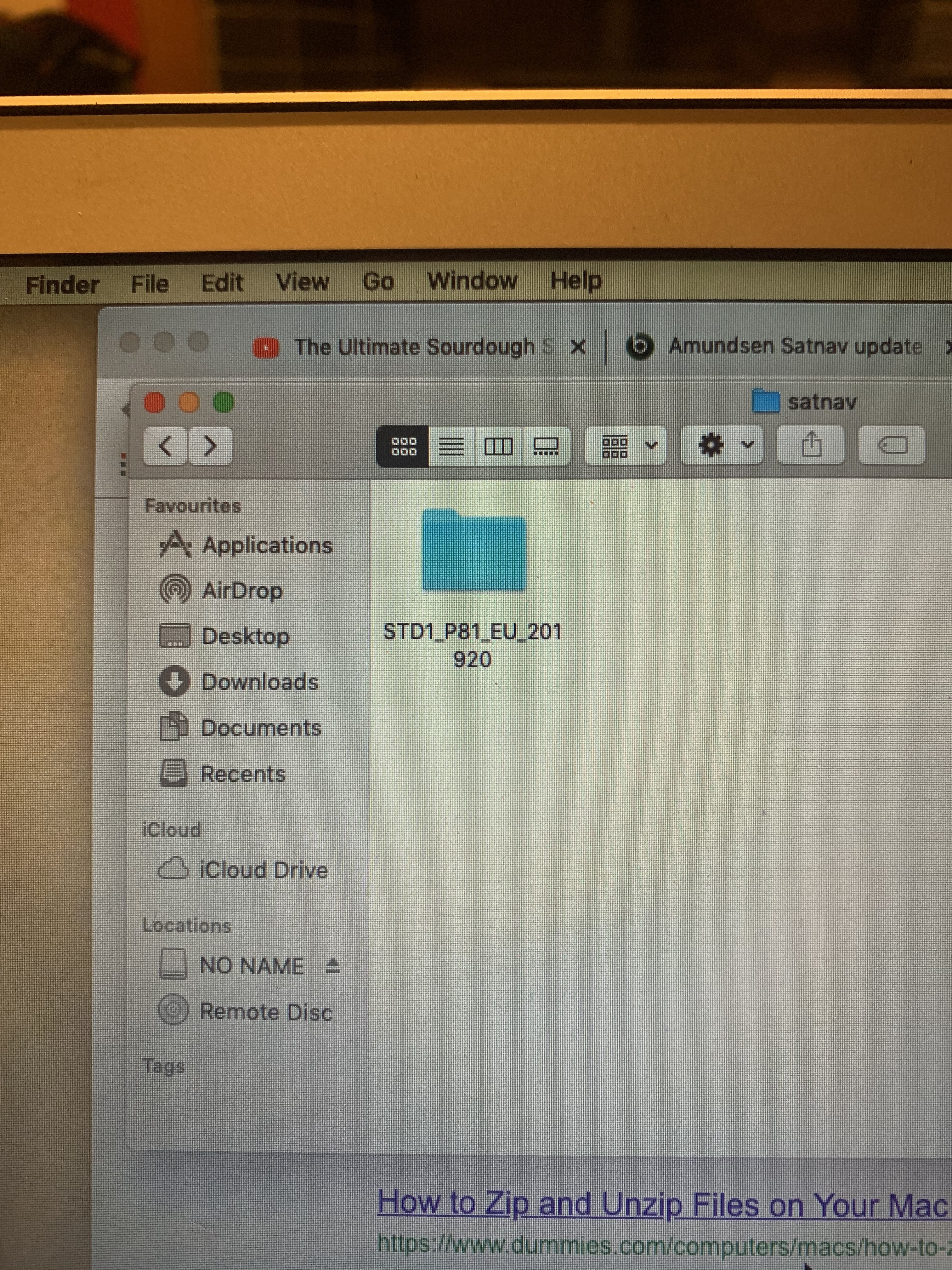

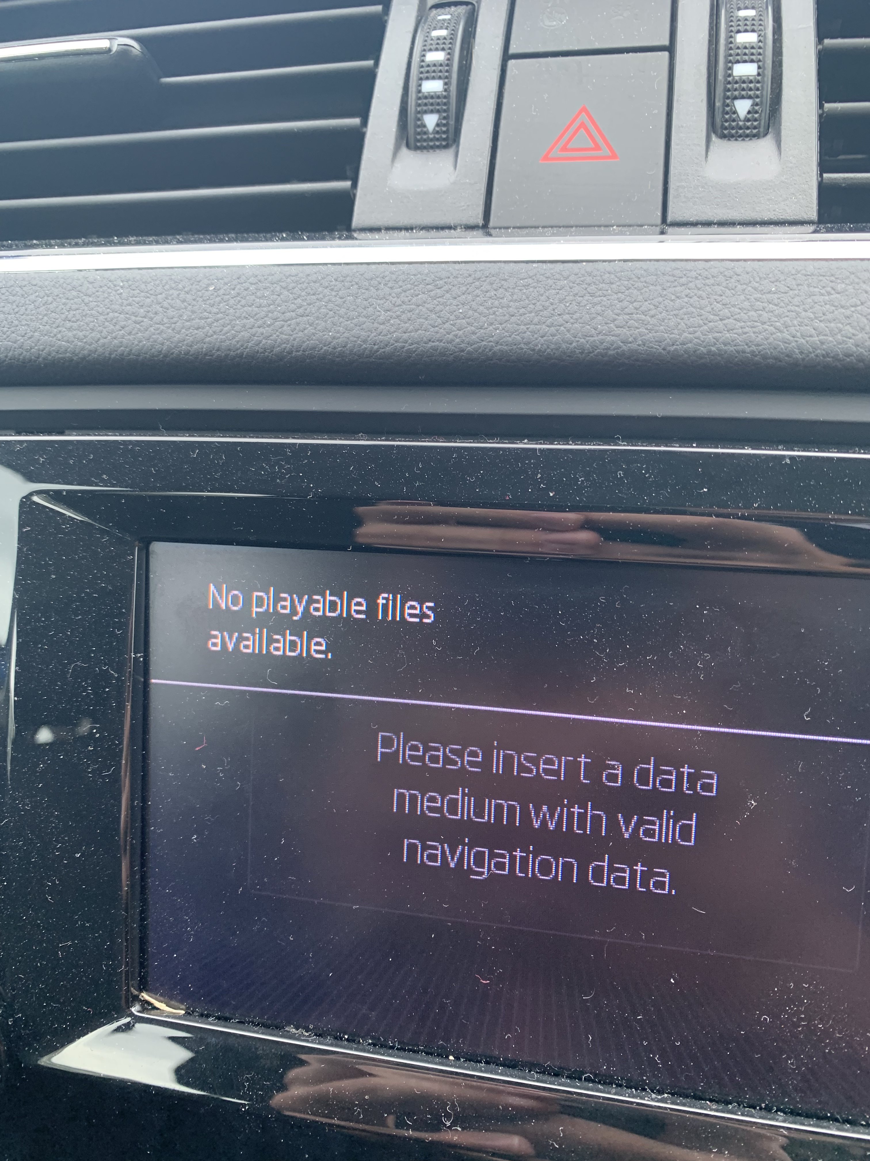

Looking for a bit of advice please - not sure if this is the correct thread so apologies in advance. I’ve recently bought a 2015 Skoda Octavia 1.6L Greenline estate (sorry not got the full details on me at the moment) and I have tried to update the satnav. Oh boy I wish I hadn’t!
I followed the instructions on the official update portal and when I reinserted the SD card into the car it told me it couldn’t be read. After some tinkering around it is finally reading the card but doesn’t recognise the files as navigation files. I realise one of the problems stems from the fact that I am using a Mac.
To top it all off I’m completely useless with technology and wiped the SD card without saving the original files.
I’ve attached some pictures to help paint the picture. The SD card is the original Skoda one which came with the car.
That's what happened to me too. First, don't put the full download folder (named STD1..... ) on the SD card - just the contents. i.e. these two files:
DBInfo.txt
Markets (a folder)
That should at least get it going again but you might have the same problem as I do - no road names in the little info boxes.
I am giving up trying to fix this using my Mac (problem of hidden Mac files continually returning on the SD card and apparently causing the problem with displaying road numbers) and will start from scratch to reload the files with a PC not a MAC, after reformatting the SD Card to see if that solves it.
Once you've put those files on, try following the routine posted by OscarTheGrouch above also - repeated below:
After files have transferred, tidy the SD-card up. Being a Mac there isn't a straight forward way of doing this. The quickest way is with the Terminal, which you can open from Spotlight and run the following.
cd /Volumes/NO\ NAME/
rm -Rf .fseventsd/ ._.Trashes .Trashes/ .Spotlight-V100/ ._maps
exit
Then whip the sd-card out without ejecting it and return the write protect tab to read only. Test out the new maps on your Amundsen, if everything is ok you can remove the download and empty the Trash Can on you Mac.
