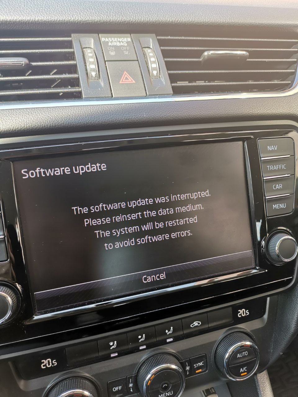

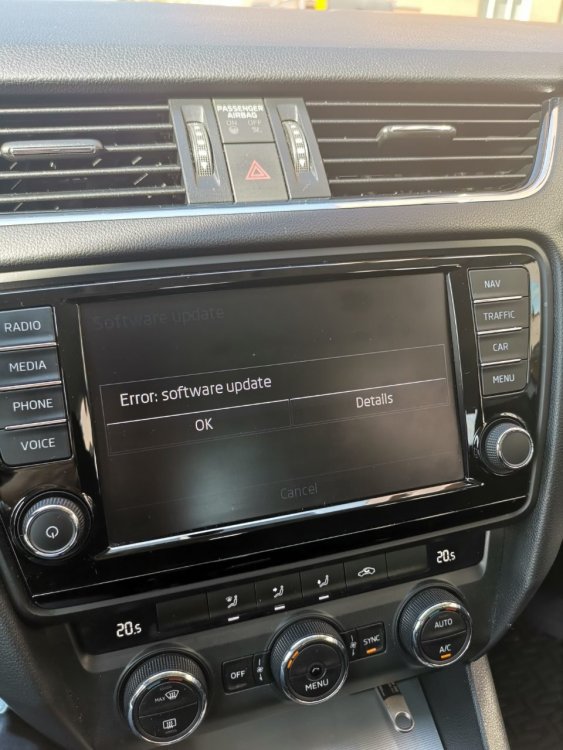

I have issue with my device, each time i start it i got message error: software update, and when i click ok, message disappear  and device is working fine except i cannot update my maps.
IMG-bc094d7c46cfa45da8f930bc6f7f021c-V.thumb.jpg.f43141bdefdec607f67018624584af4f.jpg
When i click details i get this message.
IMG-390260f58a51a91ef83aaff442b86ad6-V.thumb.jpg.5ecba1718327f1c26a20075c60661180.jpg
Issue is that this was done in Skoda service and car is still under warrant but they keep saying that i done this, which i didn't. In any case i'm still arguing with them but just want to get 2nd opinion. And yes, they cannot fix this, whatever they tried same keep happening. But pretty sure that they don't have clue what to do.

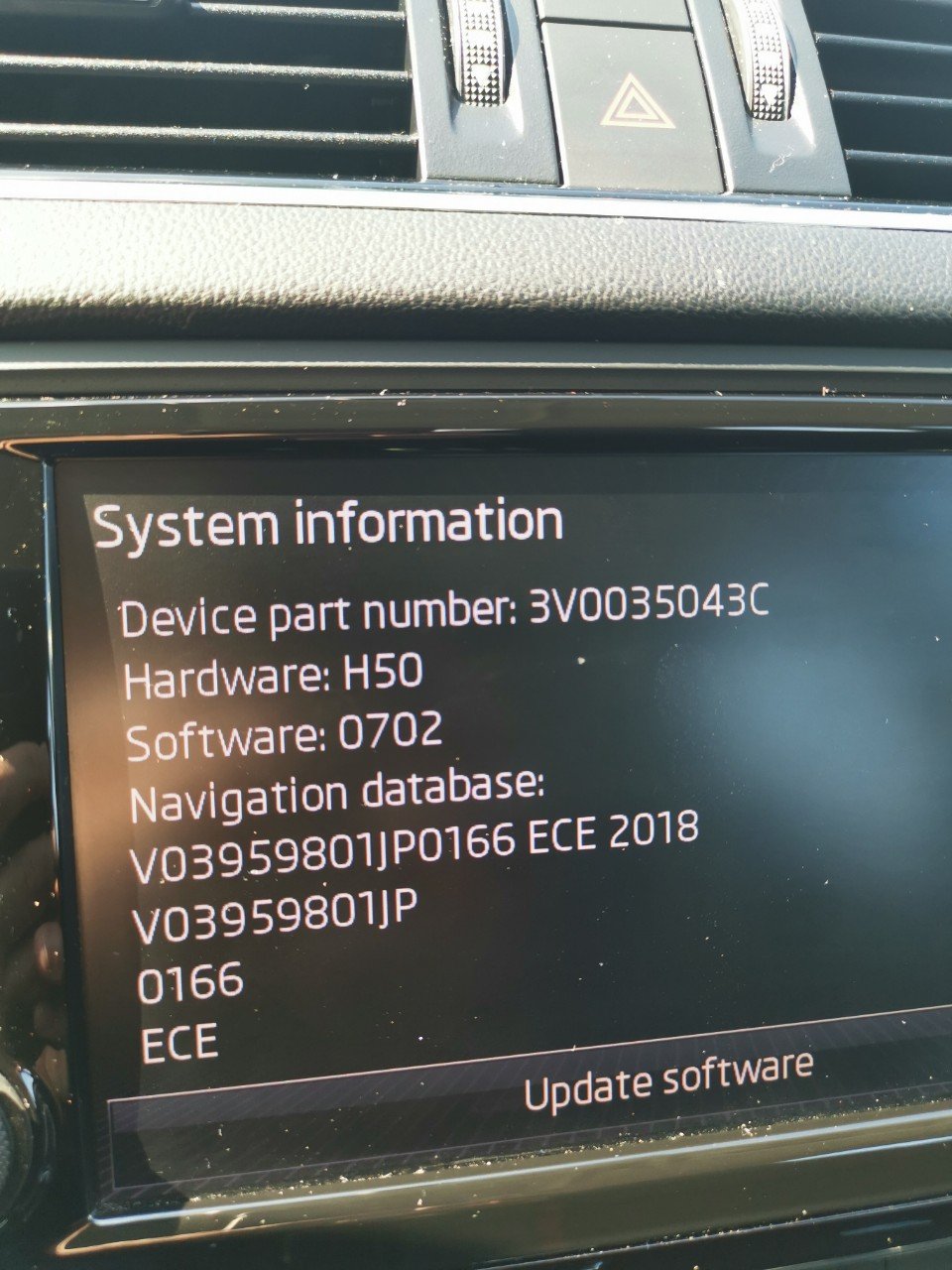

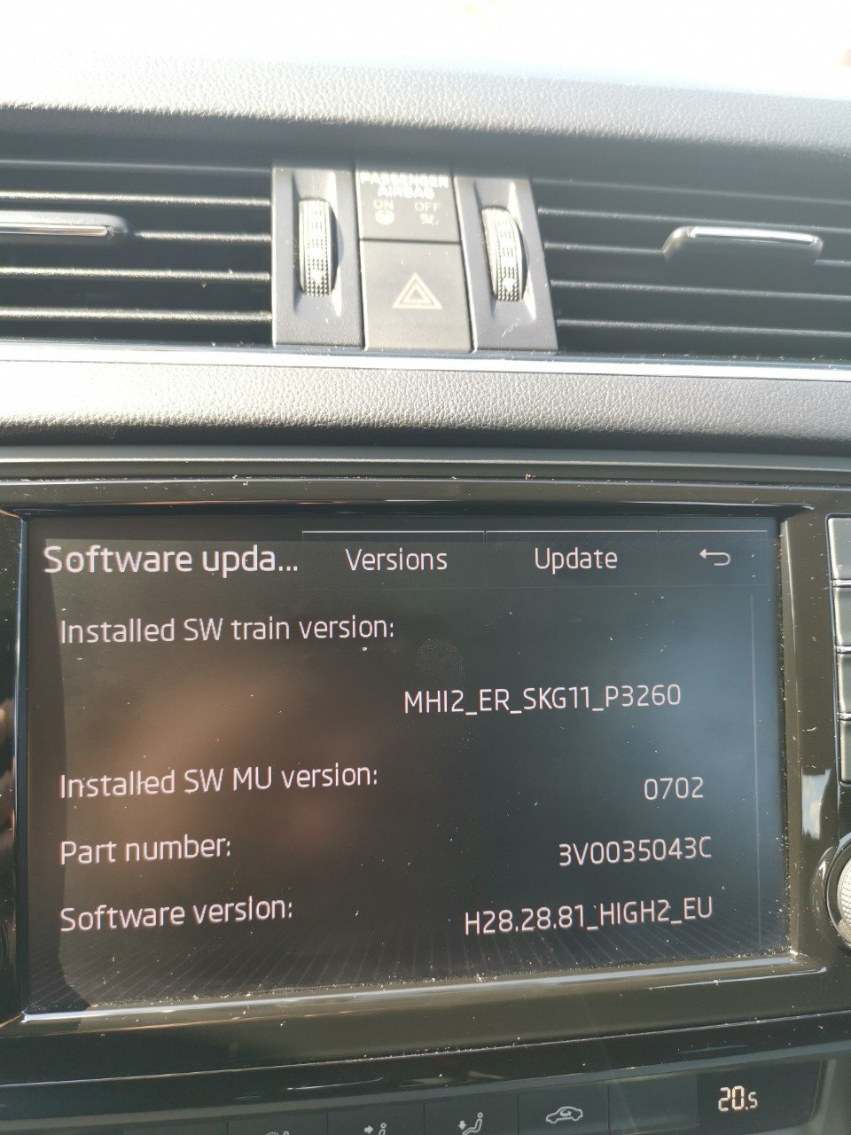

Also i'll attach other screenshots with software version.
IMG-23c35460c825f380287565d076858c59-V.thumb.jpg.84560547a1712f77f4ac13bb152b29bc.jpgIMG-67123b83f9cef6612128be4490557513-V.thumb.jpg.f2e52cac53e07a7c83ec6ef479981c0f.jpgIMG-1e08dda690be5a534231e428dc3857d4-V.thumb.jpg.6b72cf413b27eb0adb09ae3acd181f93.jpg
Is there anything to be done? Like, is it possible to download latest software on computer and update it via usb/cd/etc?
I won't do anything until car is under warrant but just want to have some option's in case they don't do anything.
Sorry for long post and thanks in advance!
This thread is related to the Amundsen system, while your system is a Columbus system so different. Probably best starting a new thread with the correct title to avoid cluttering this thread and getting incorrect answers which will cause further confusion.
