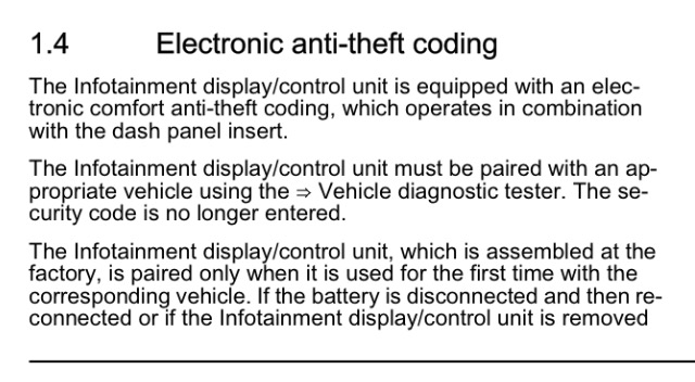

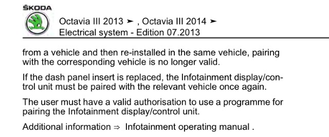

Electrical manual states otherwise...
Okay, you win...
I distinctly remember last time I disconnected the screen on my Columbus system, I recall going to the dealers to have it re paired with the main unit. :dry:

You mean they're different Component Protection standards? I think not. In fact I have a couple of Amundsen units in the shed and I can swap the screens over, connect up a gps antenna etc. and no Component Protection gets triggered.
Also, look in the VCDS settings for the infotainment system and you'll find a trigger setting to check component protection. Activate it and it locks the unit as if it'd been stolen. Cycle the ignition and it registers as recognised in the correct vehicle, and unlocks itself again.
