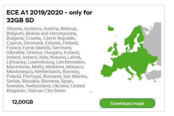

  • An update to this topic. I just successfully updated my satnav data from the Skoda website - no problems at all.   I have an Amundsen satnav, with 16GB SD Card (14.8 GB actually !) and I'm u

well i've checked and the official sd card is only 16gb. so are we supposed to go ahead and update to the latest maps or not? bit confused by skoda's advice.
The maps will fit on a 16gb card. Skoda have no idea what they're talking about (or someone is scaremongering).
I just updated to the latest maps and the file for all of Europe is about 13GB once unpacked.

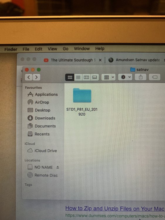

After files have transferred, tidy the SD-card up. Being a Mac there isn't a straight forward way of doing this. The quickest way is with the Terminal, which you can open from Spotlight and run the following.
cd /Volumes/NO\ NAME/
rm -Rf .fseventsd/ ._.Trashes .Trashes/ .Spotlight-V100/ ._maps
exit
Then whip the sd-card out without ejecting it and return the write protect tab to read only. Test out the new maps on your Amundsen, if everything is ok you can remove the download and empty the Trash Can on you Mac.
Thanks so much - almost sorted. Exact same problem as you though as I now only have blank boxes instead of road names - at least I have a map now though! I've tried using the terminal but it says operation not permitted. Might have a go with that other software and if push comes to shove then I'll try find a PC to use.

Note that I've managed to update the maps on the Amundsen M1B1 model using the original 8Gb card - I didn't have to buy a 32Gb card or do any tricks. The 2019/20 data for all of Europe still just fits on the card. Maybe it wont be big enough next update
