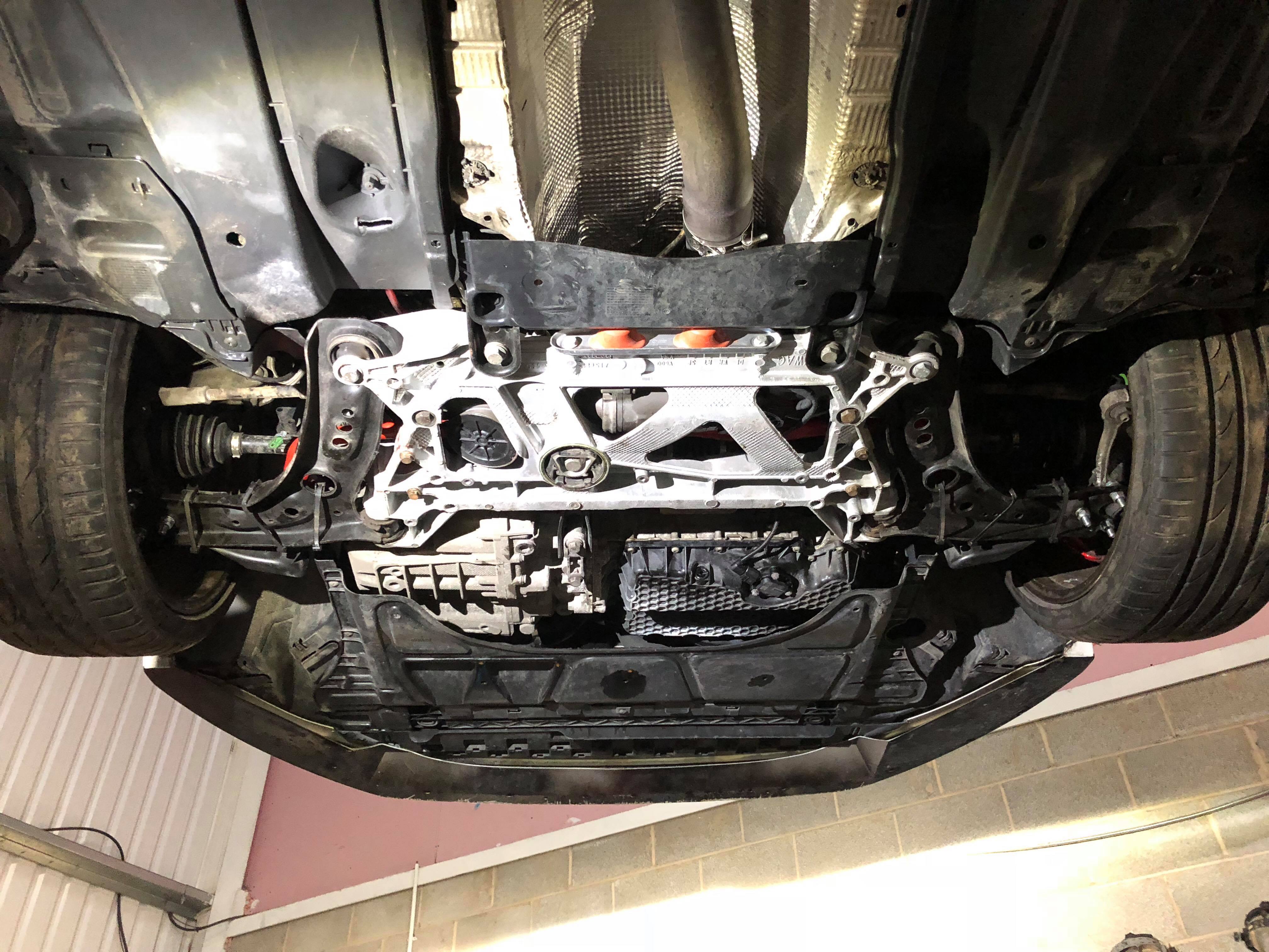

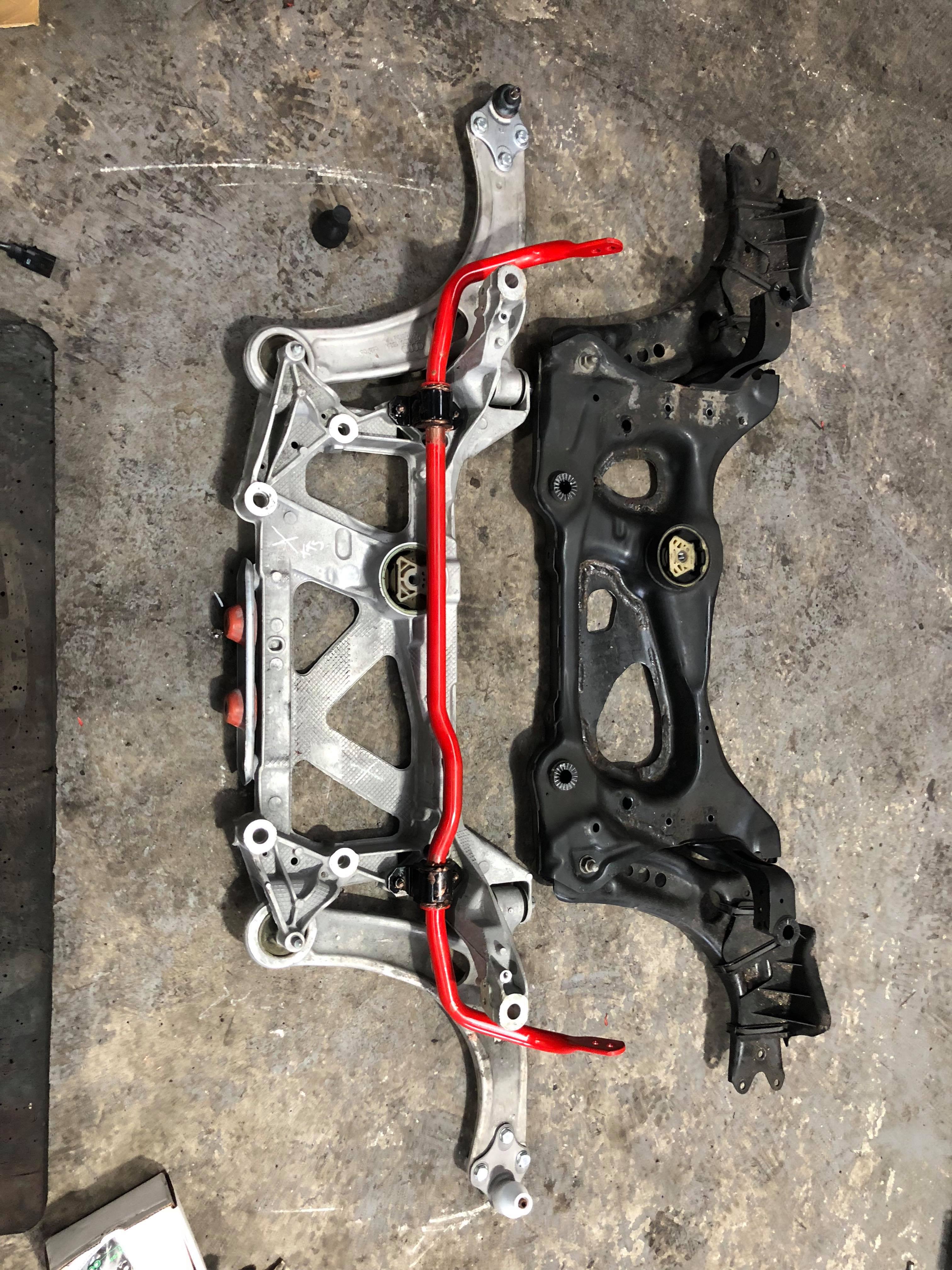

So she's going on a diet even more.. I've picked up a Audi TTS alloy subframe and alloy wishbones and hopefully be saving +6kgs
Am I right in thinking the wishbones are different size giving more camber etc.?
I'm not sure on that one. I will have to measure them against the steel ones.
You wouldn't believe how light it is, you can pick it up with one hand easy
So nicely designed and machined.

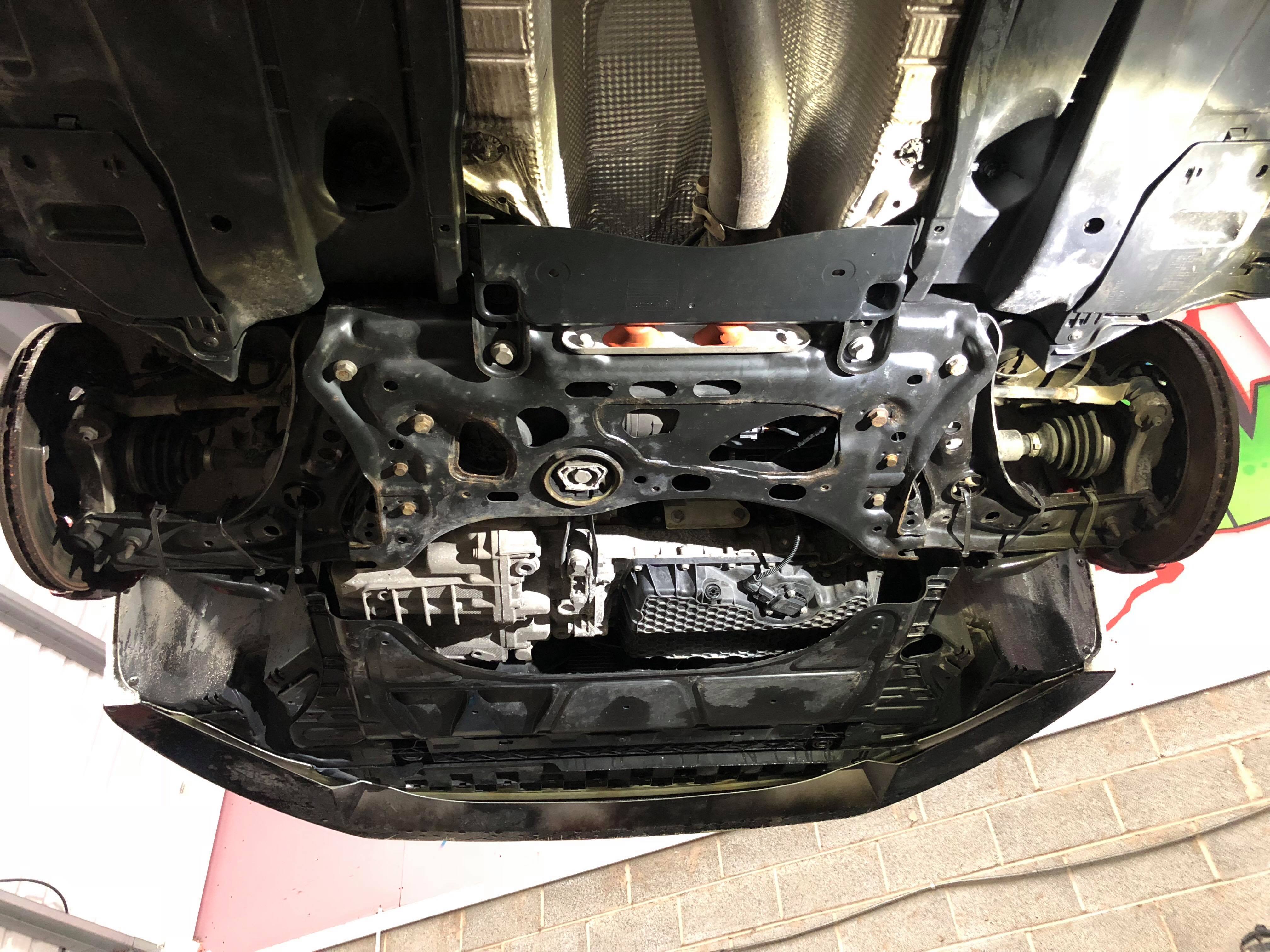

So I've got the car booked in at N.A.W automotive for the subframe/alloy arms swap, neuspeed farb and the turbo as I couldn't do the turbo on the drive :sadsmile:

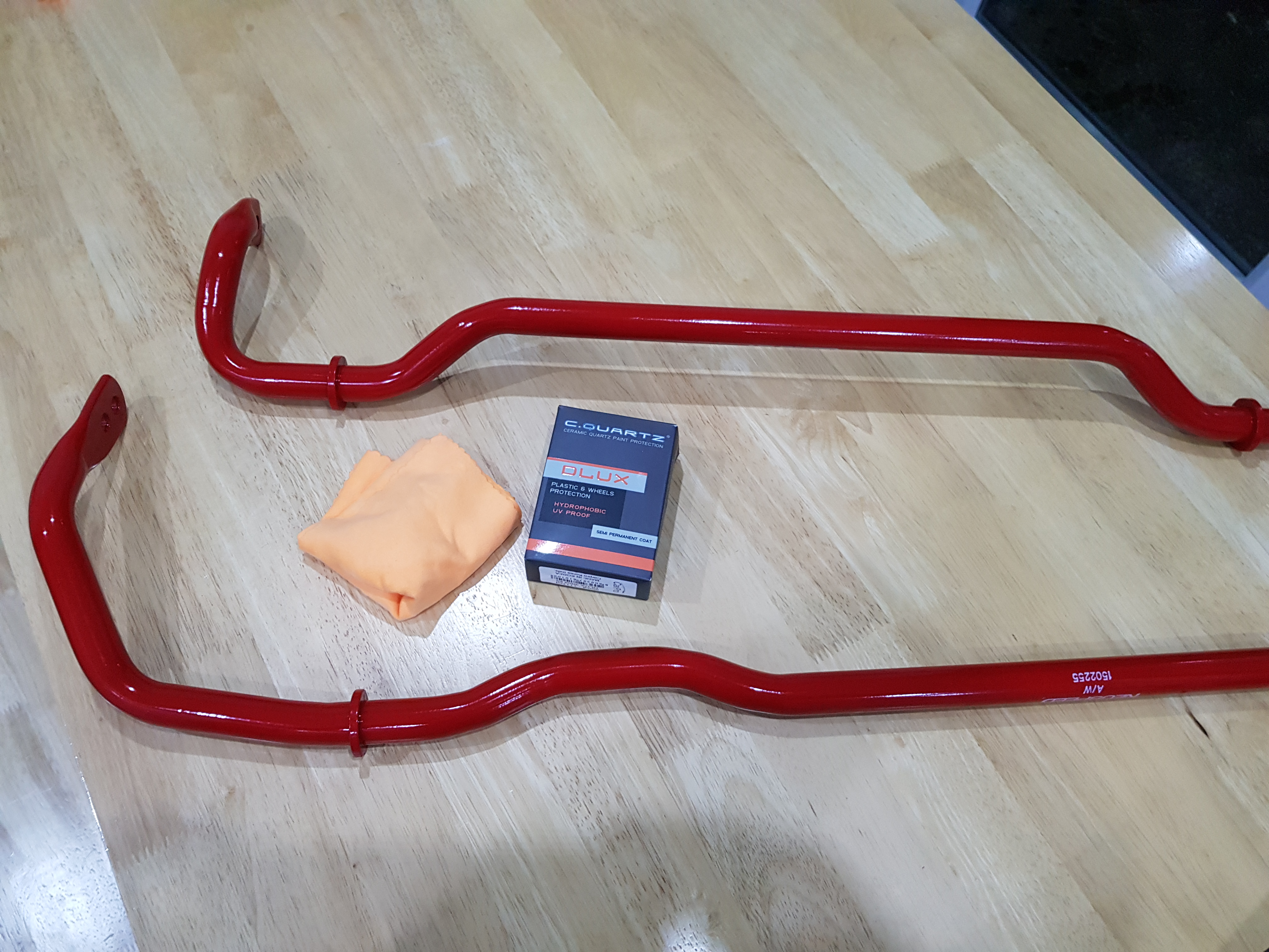

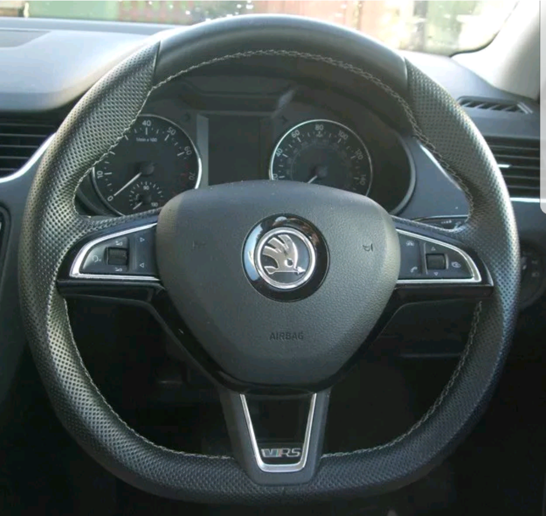

Also I've sealed the arb's with c quartz deluxe and hopefully they won't rush so quickly and won myself a flat bottom dsg wheel ( no airbag) of eBay but in the white/silver stitch but going to have it releathered and maybe a red middle stripe at the top

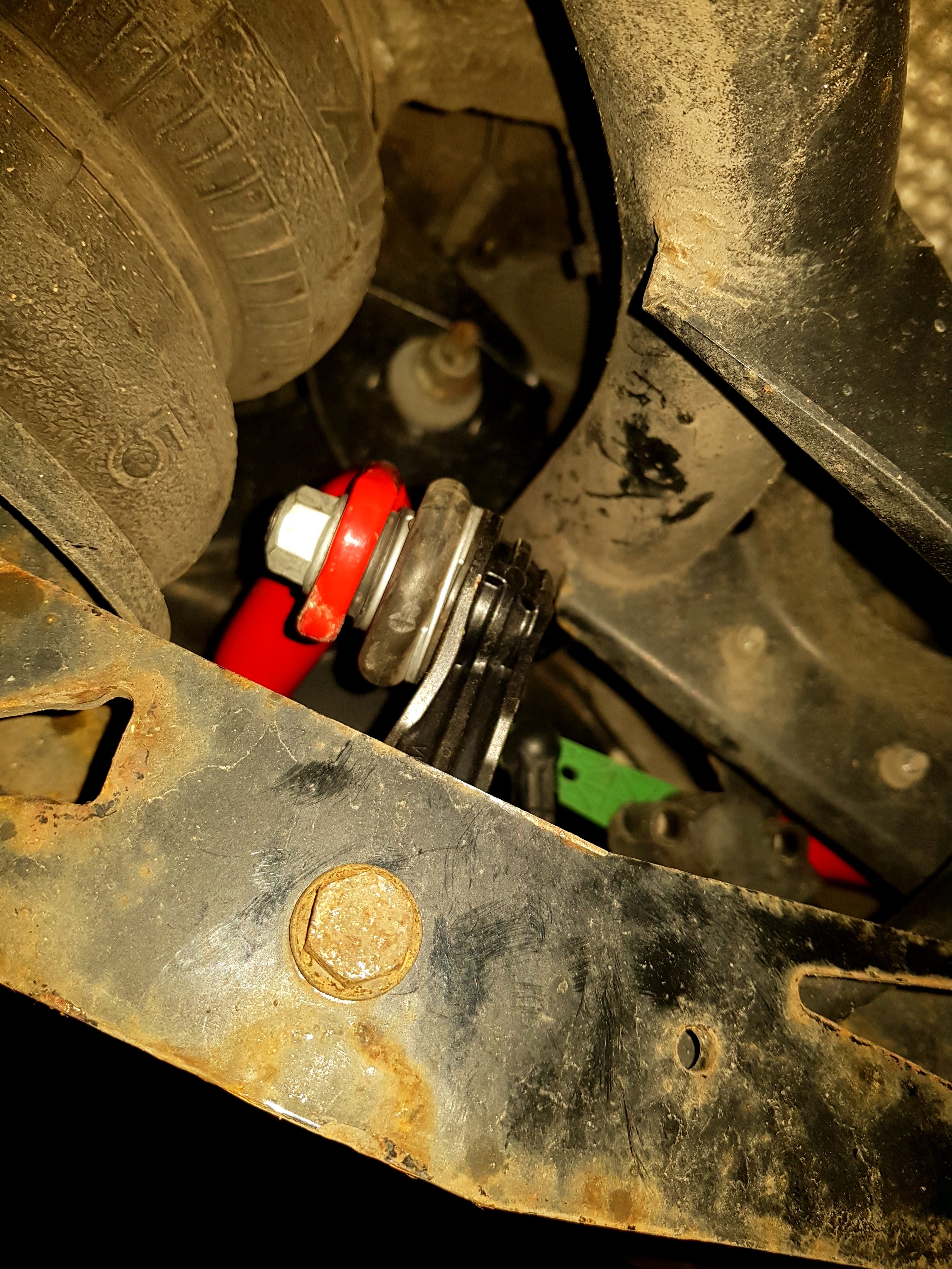

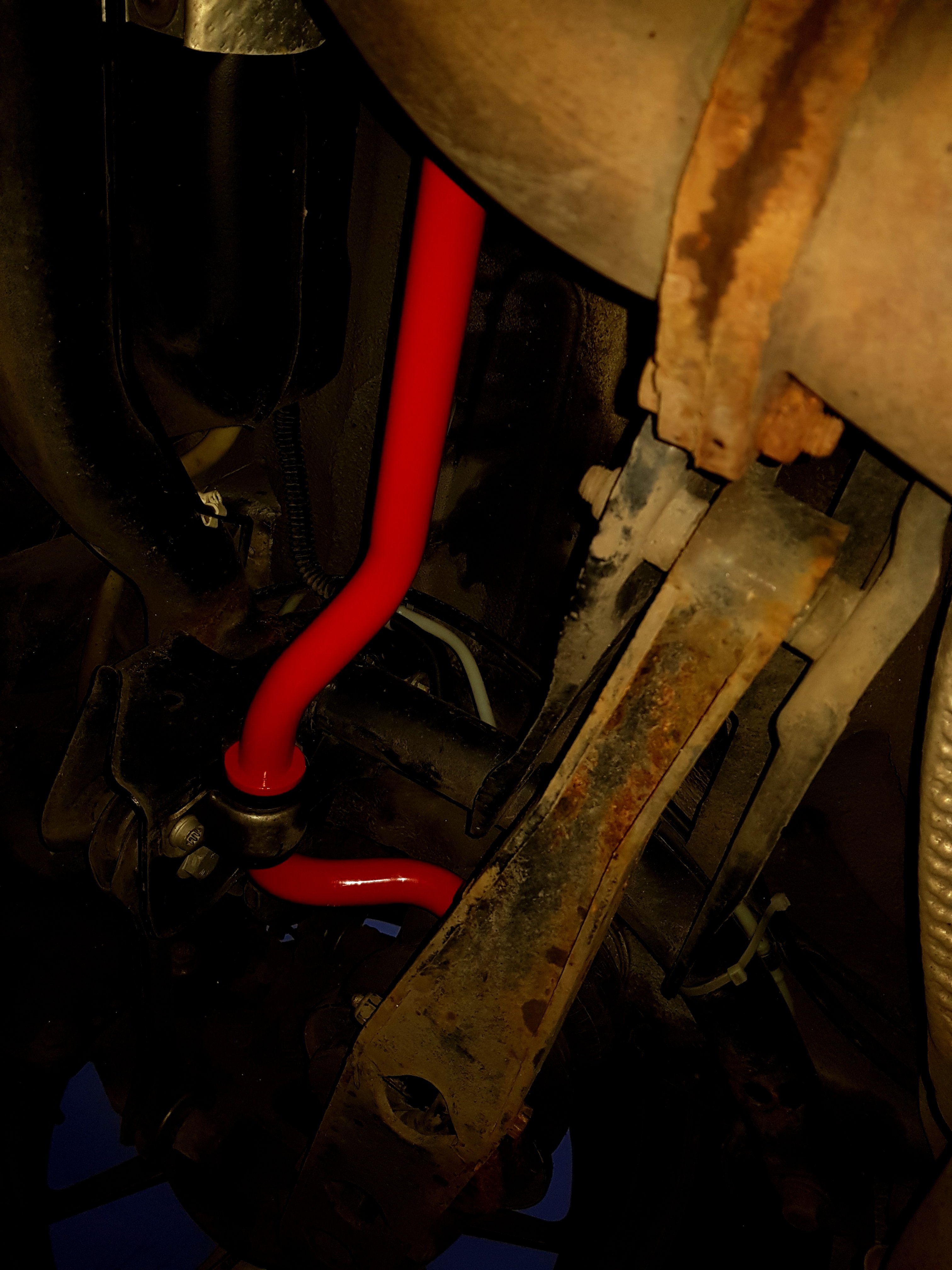

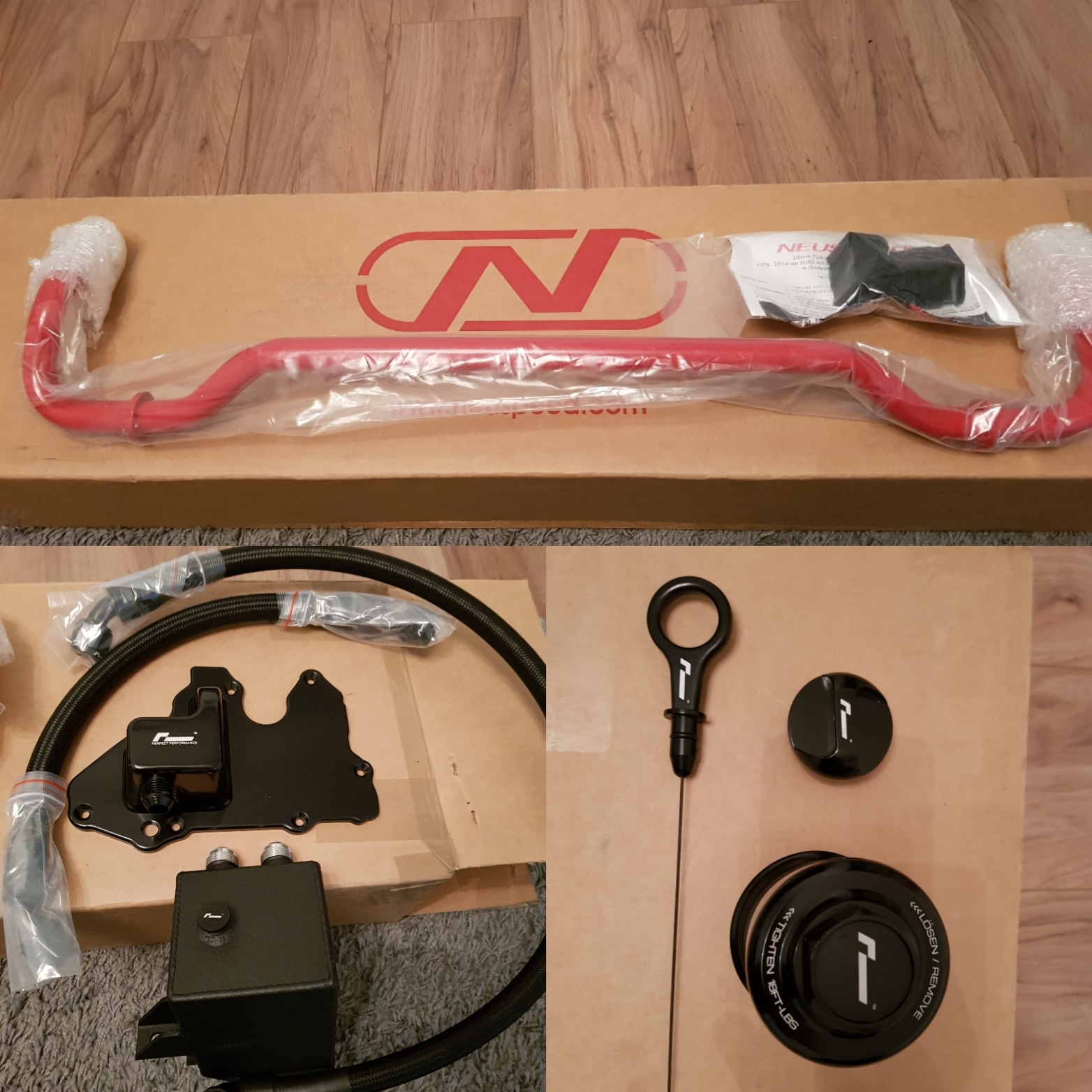

Got the neuspeed rarb on tonight and what a massive difference to the rear. If your doing the mod make sure you've got a new set of rear drop links as the original ones wouldn't come off the standard rarb. I got a genuine set from my local tps at £51

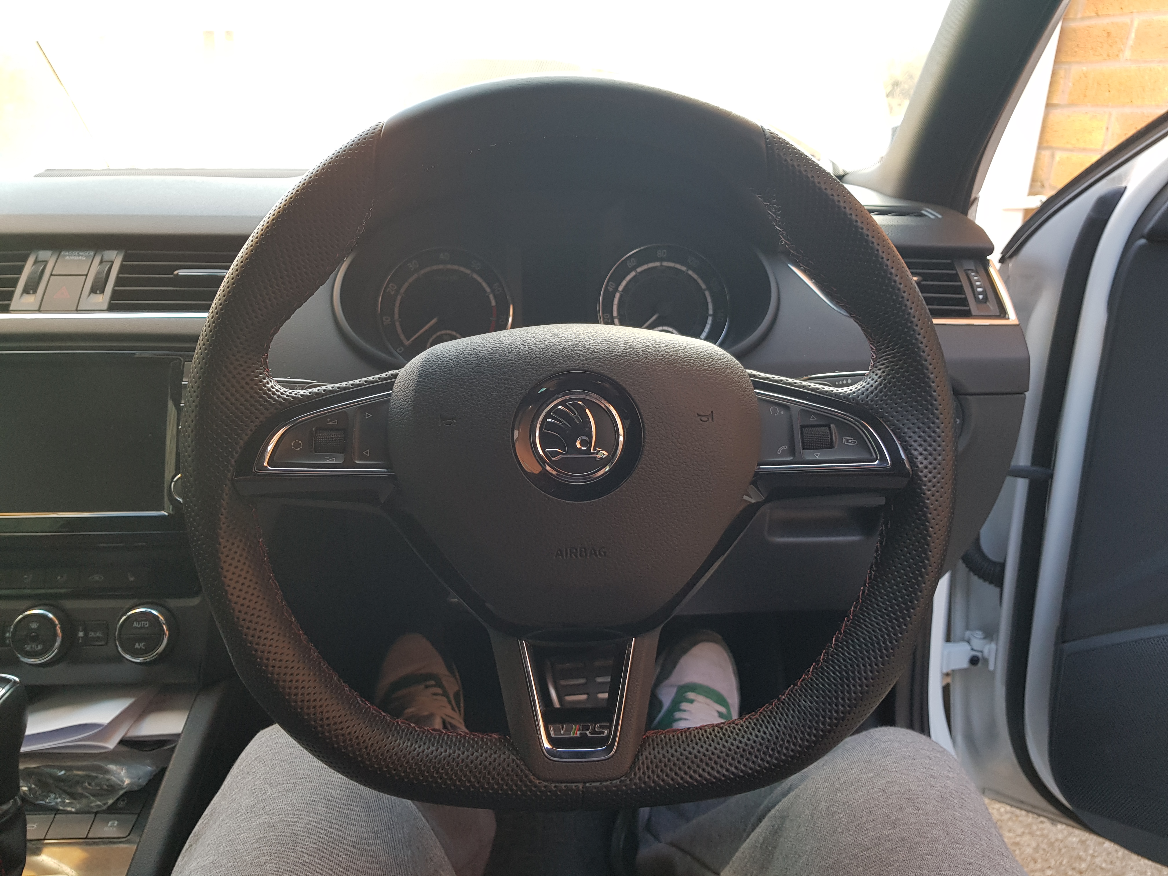

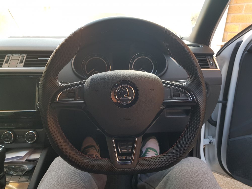

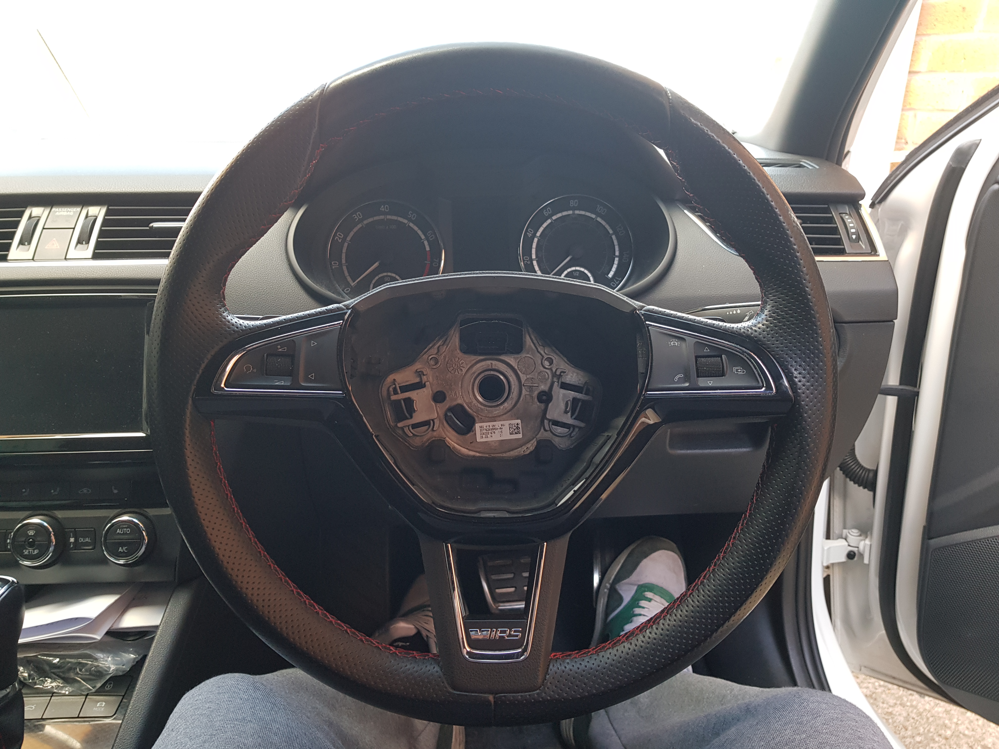

With having the morning free I've fitted the flat bottom wheel. It came with the white/silver stitch but nothing that a red Sharpie can't fix :biggrin:
It took about 10-15 minutes to do also I've swapped the controls over too

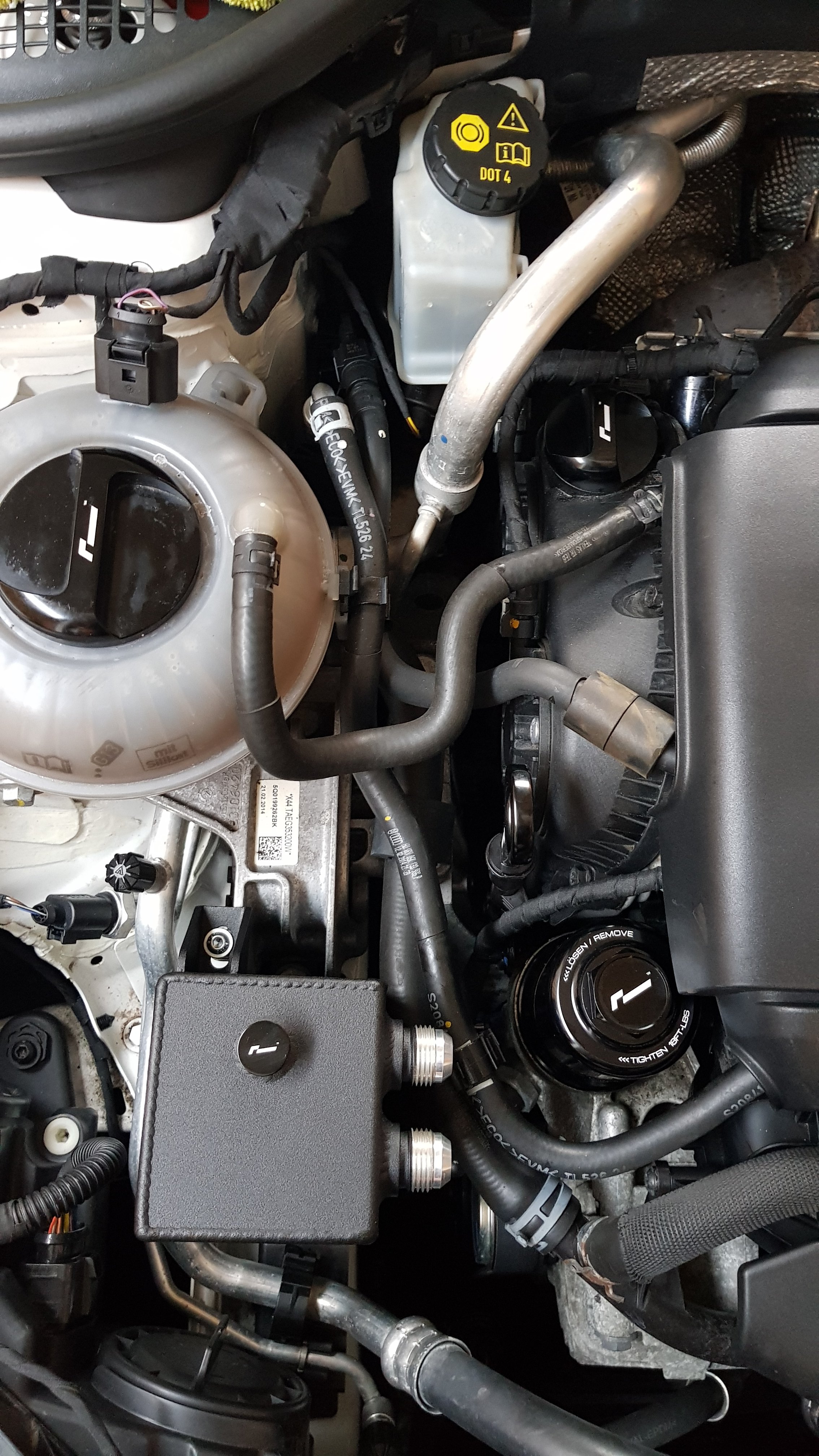

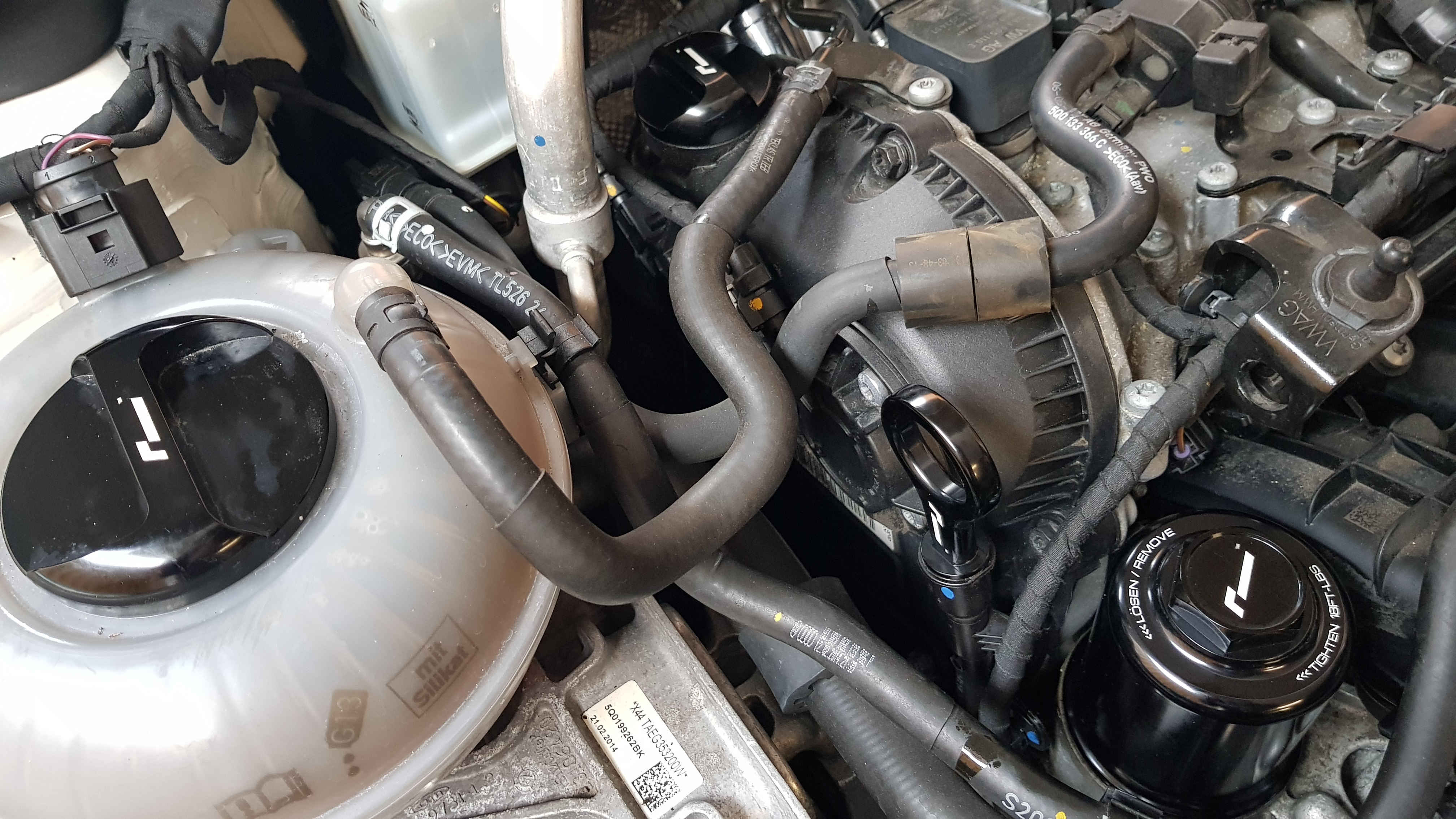

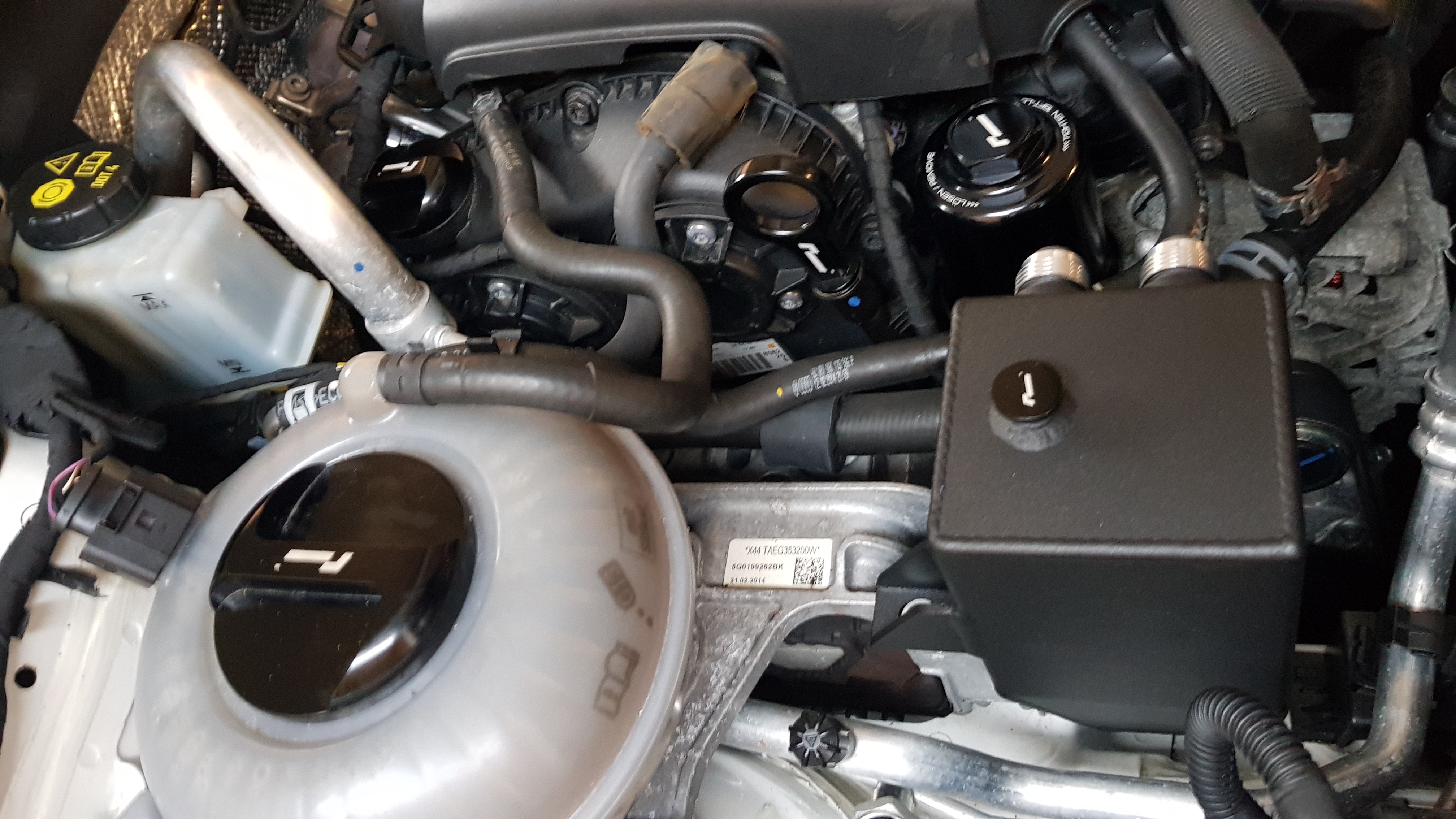

Also I've fitted the vwr billet engine bay dressing kit. I went to fit the vwr oil management system with catch tank and there was a part missing which stopped me but I fitted the catch tank only.

Pretty pleased I was correct about the wishbones :D
Notice much with the new subframe or are the ARB’s taking all the glory?

The alloy wishbones are the same size as the steel ones, its the ball joints that are too wide making the car wide track. They will be going on just going to modified them.
The front end feels loads better and flat around the corners but the weather is poo here and wet all the time, plus I cant really boot the car with the turbo on at the minute.
