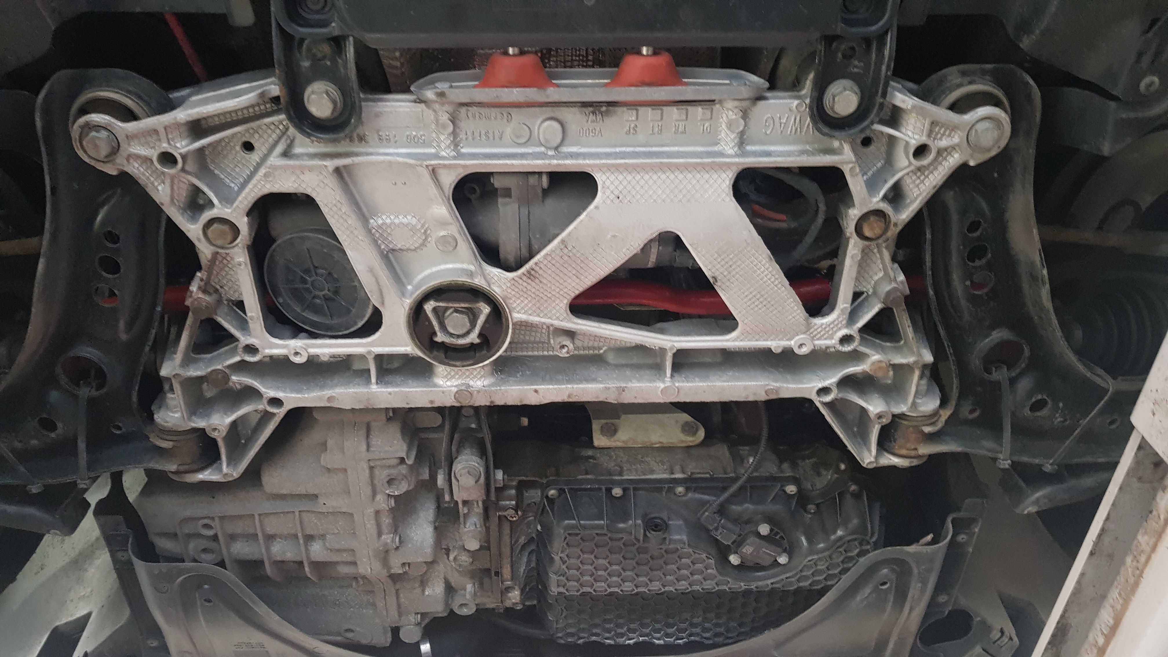

Nipped down to N.A.W AUTOMOTIVE to get them just to check over the subframe, wishbones etc is it with the extra power nothing had come loose with swapping everything. Managed to get a under picture of the alloy subframe and neuspeed farb
