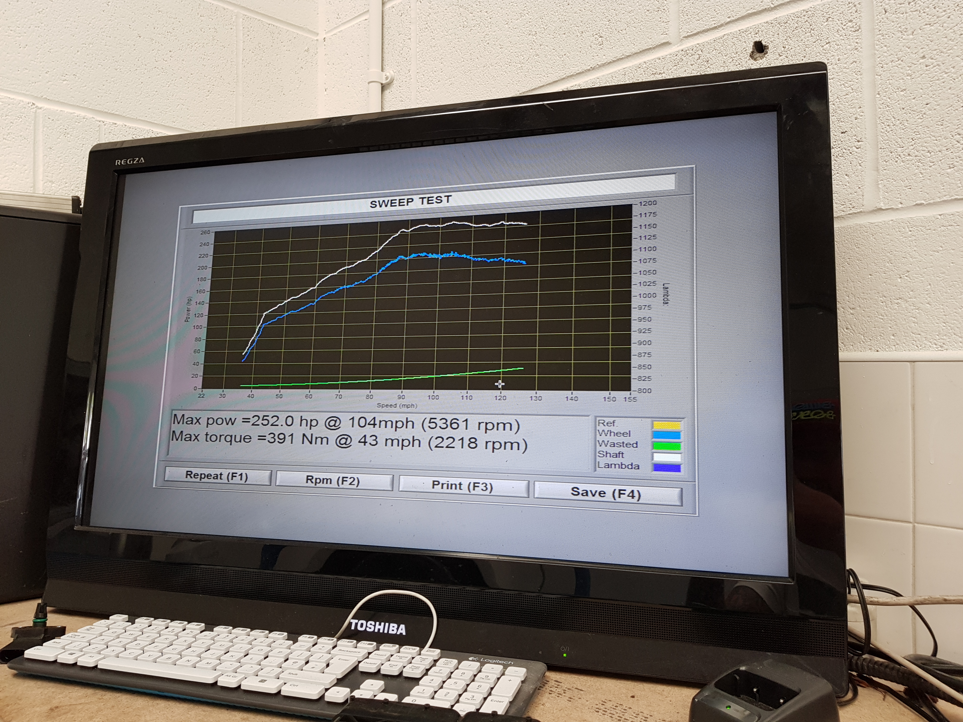

I'm good cheers,
When I had the car on the rolling road it made 252bhp and 390nm/287lb/ft

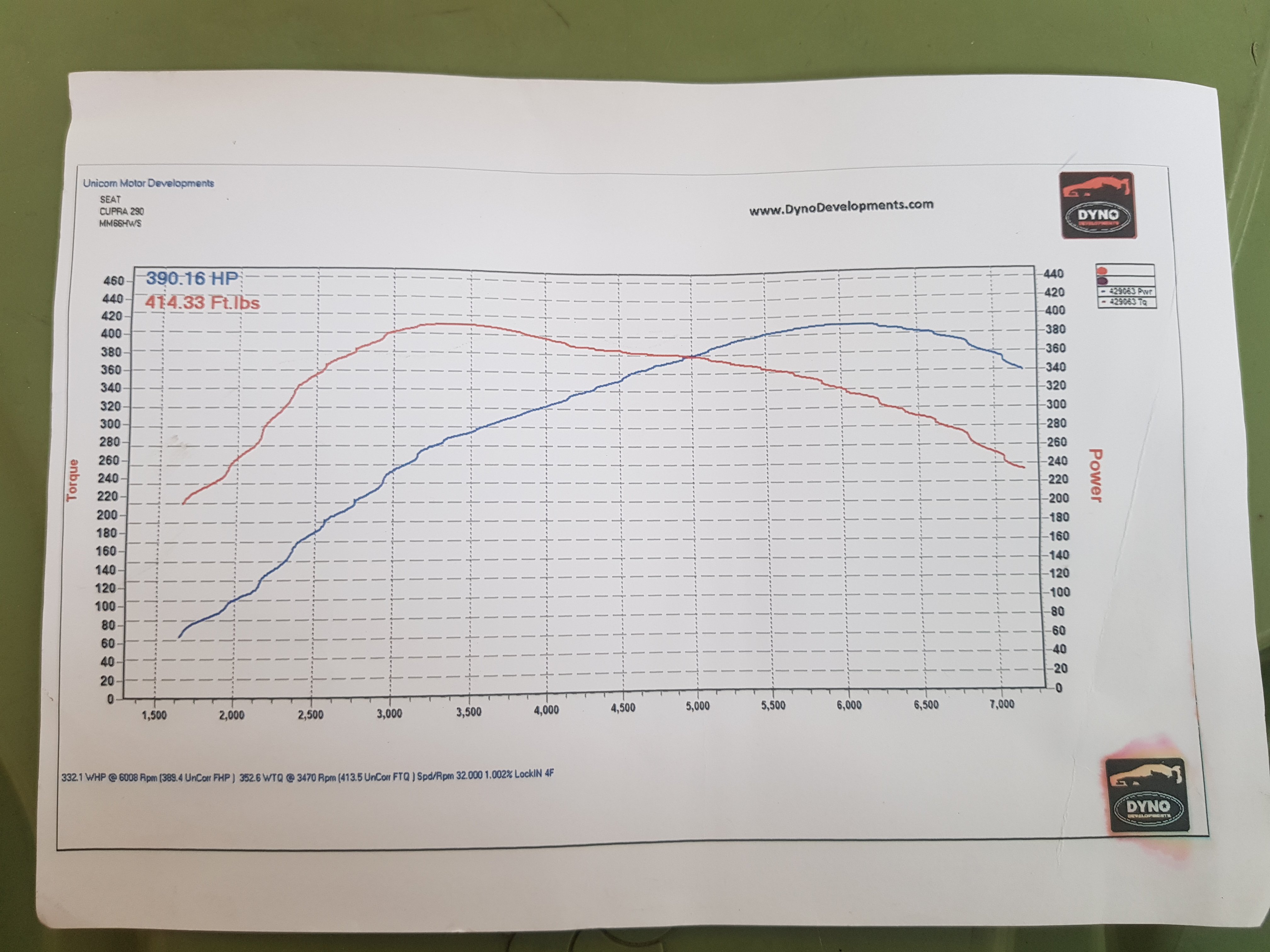

Stage 3 390bhp and 561nm/414lb/ft

SEAT Cupra 290?
1 hour ago, john999boy said:
SEAT Cupra 290?
They must have but the wrong info but I got this after my run

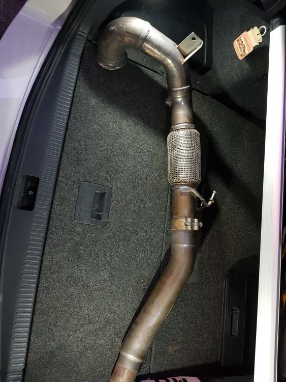

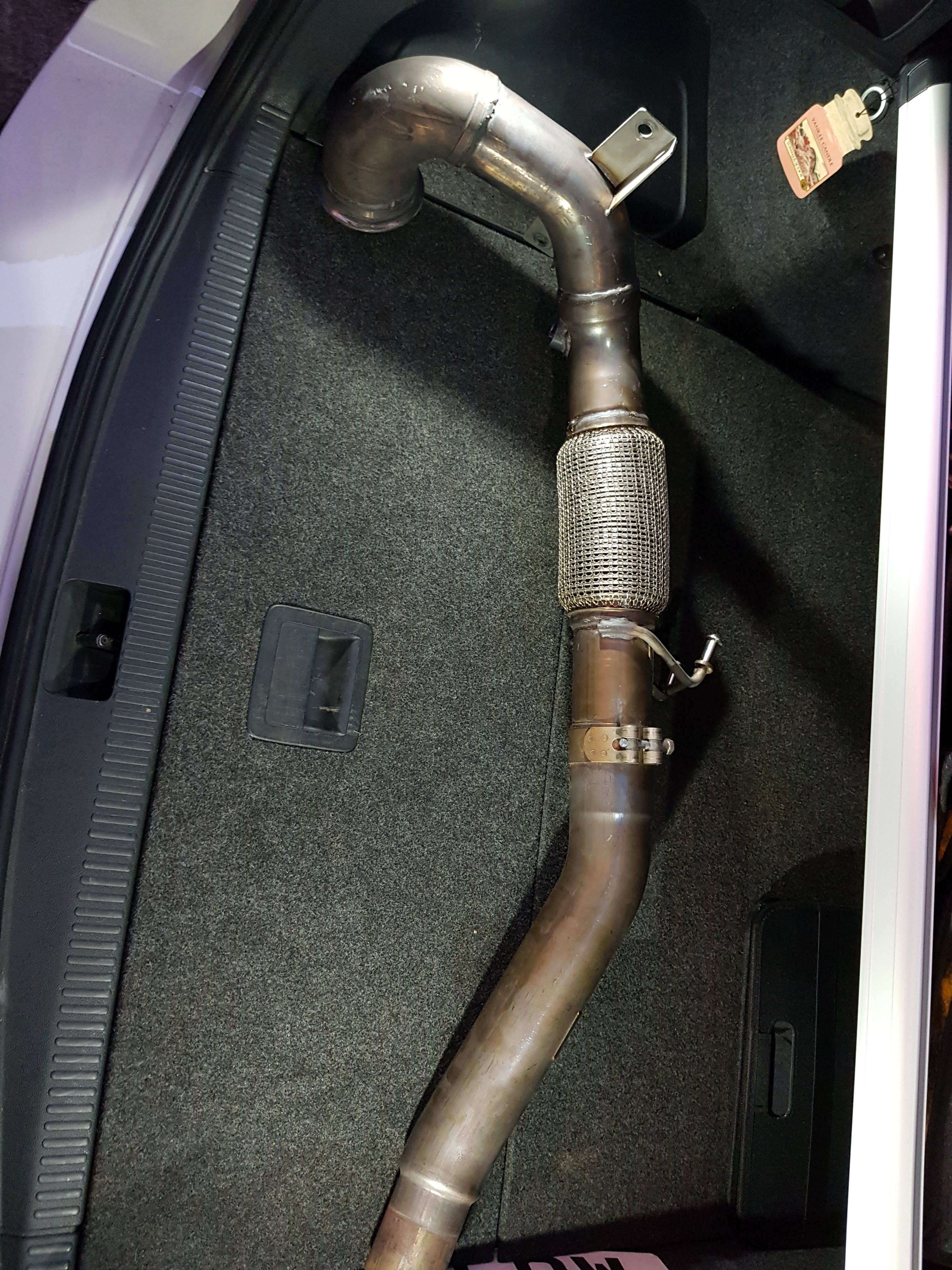

The decat has been wrapped and is on. :giggle:
Any videos of the noise?

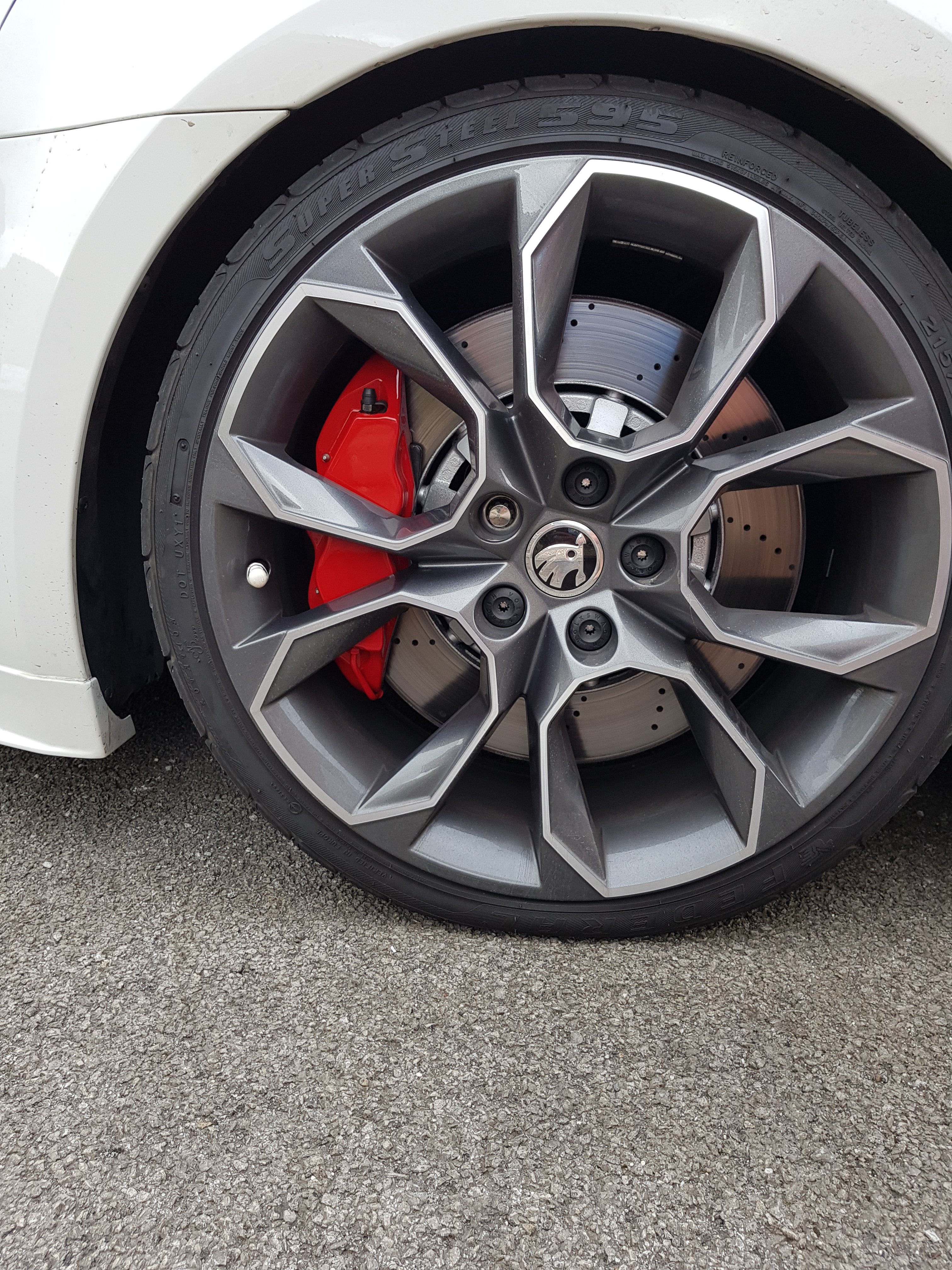

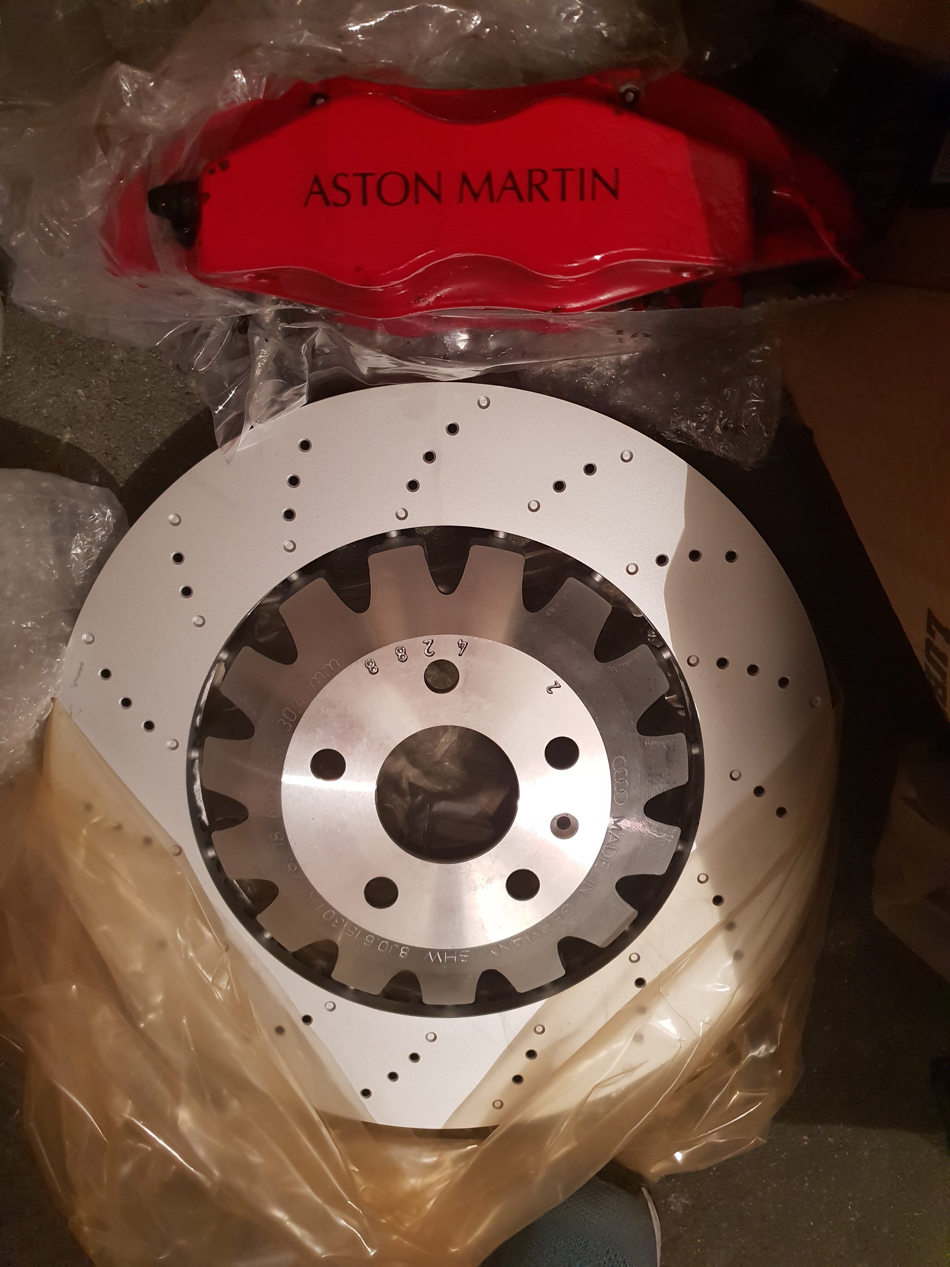

Look my new babies :inlove:
Like yours eheheh considering to buy TRW pads or textar. (My mechanic is telling to buy RIDEX pads as they are very cheap but don't know nothing about them)

Is that for your DB9 or DB11?:tongueout:
The DB9 front calipers are the same as yours :) and they were way cheaper than TTRS / RS3 calipers. And, they are colour match with the rears
Any opinion about the pads?
Not really this is a case of mistaken identity as my 245 has bog standard 340mm front and 310mm rear ventilated discs with TRW calipers and pads, plenty for road use, until those stainless steel brakelines and DOT5 brake fluid get added next month, then it's fade free braking.:dry:
Did you removed the TTRS calipers and the 370mm discs?!:dull:

So I'm loving the decat pipe it sounds insane
Sounded much better on the 2nd video. The chap in Portugal thinks I am you LOL.:notme:

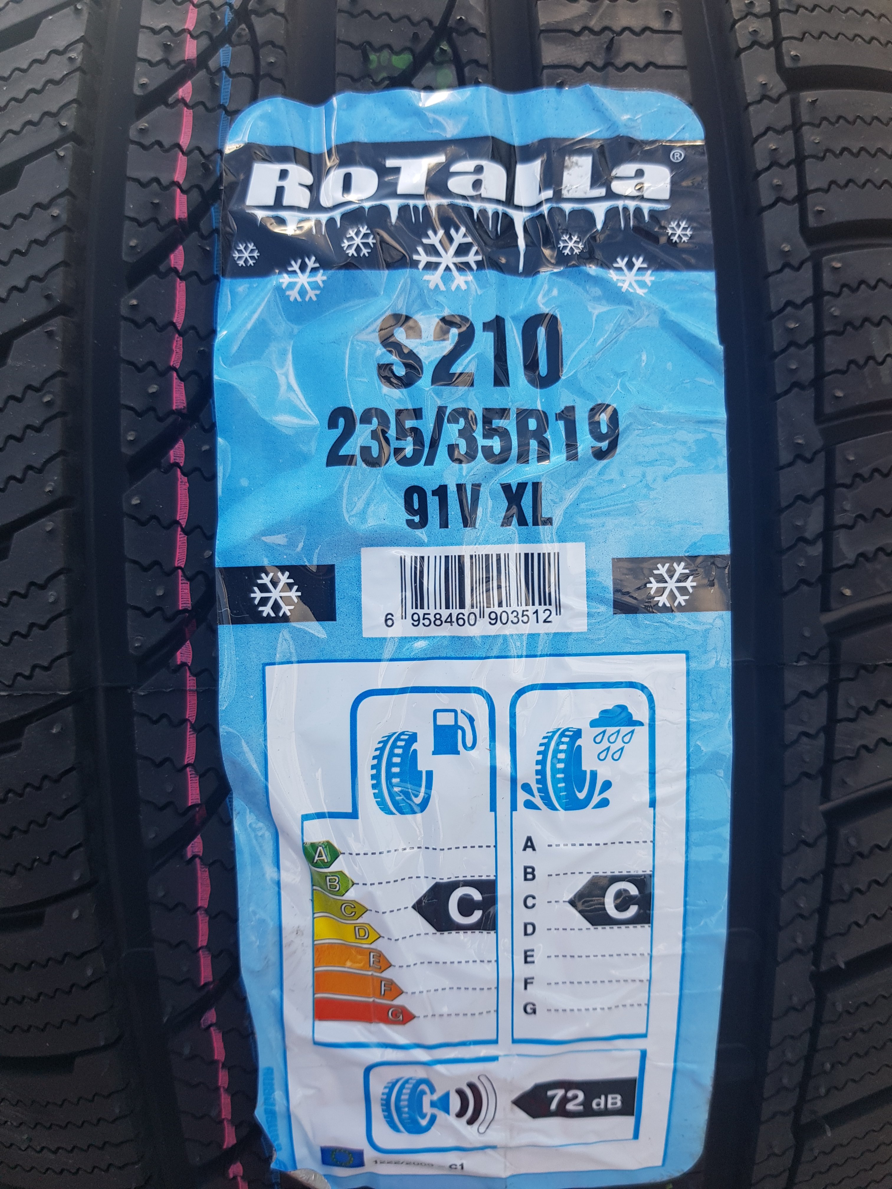

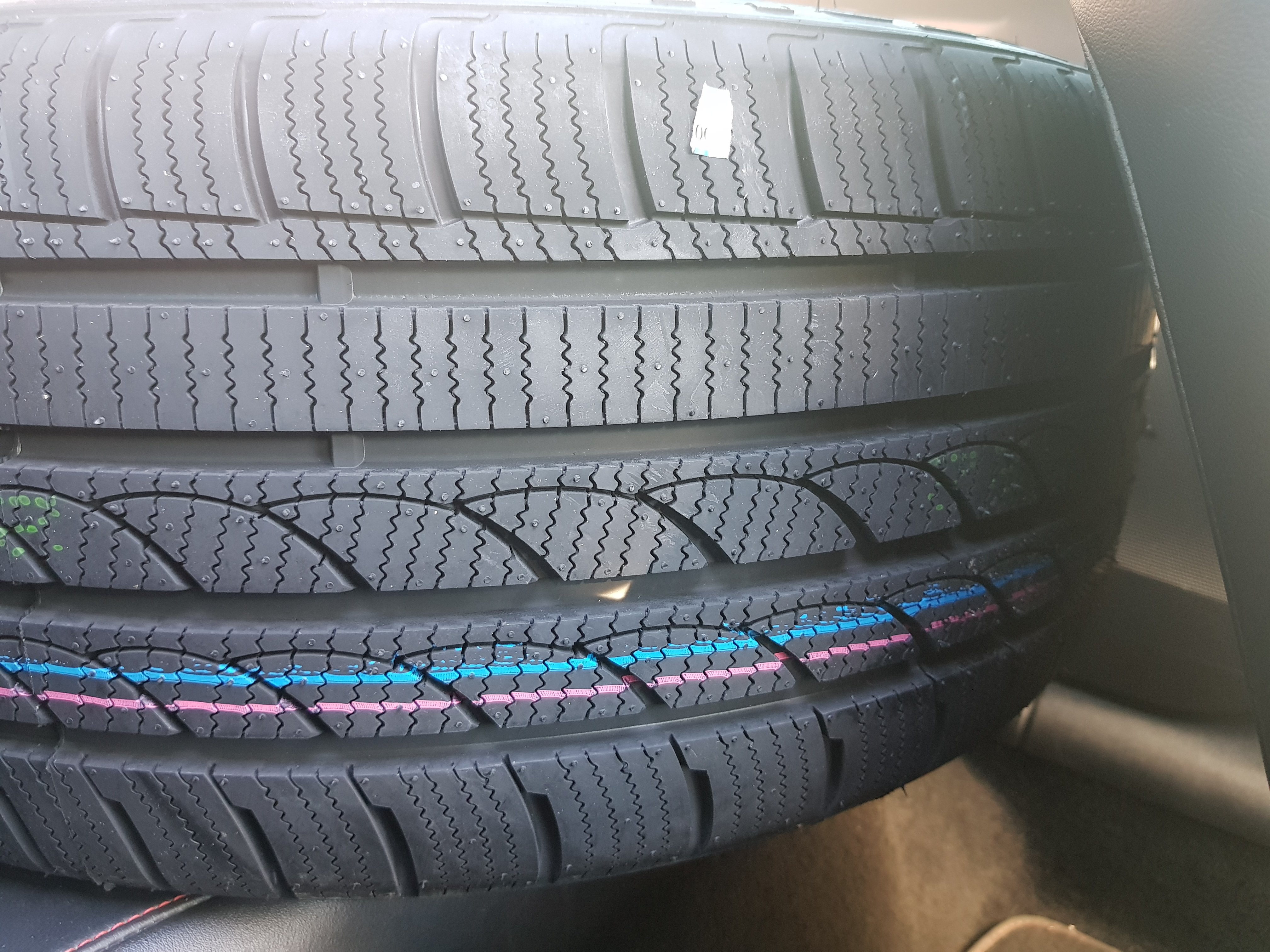

So I'm having the winter tyres fitted to the extreme wheels soon. Rotalla s210 235 35 19 91v 4* rated online and £210 for 4 delivered

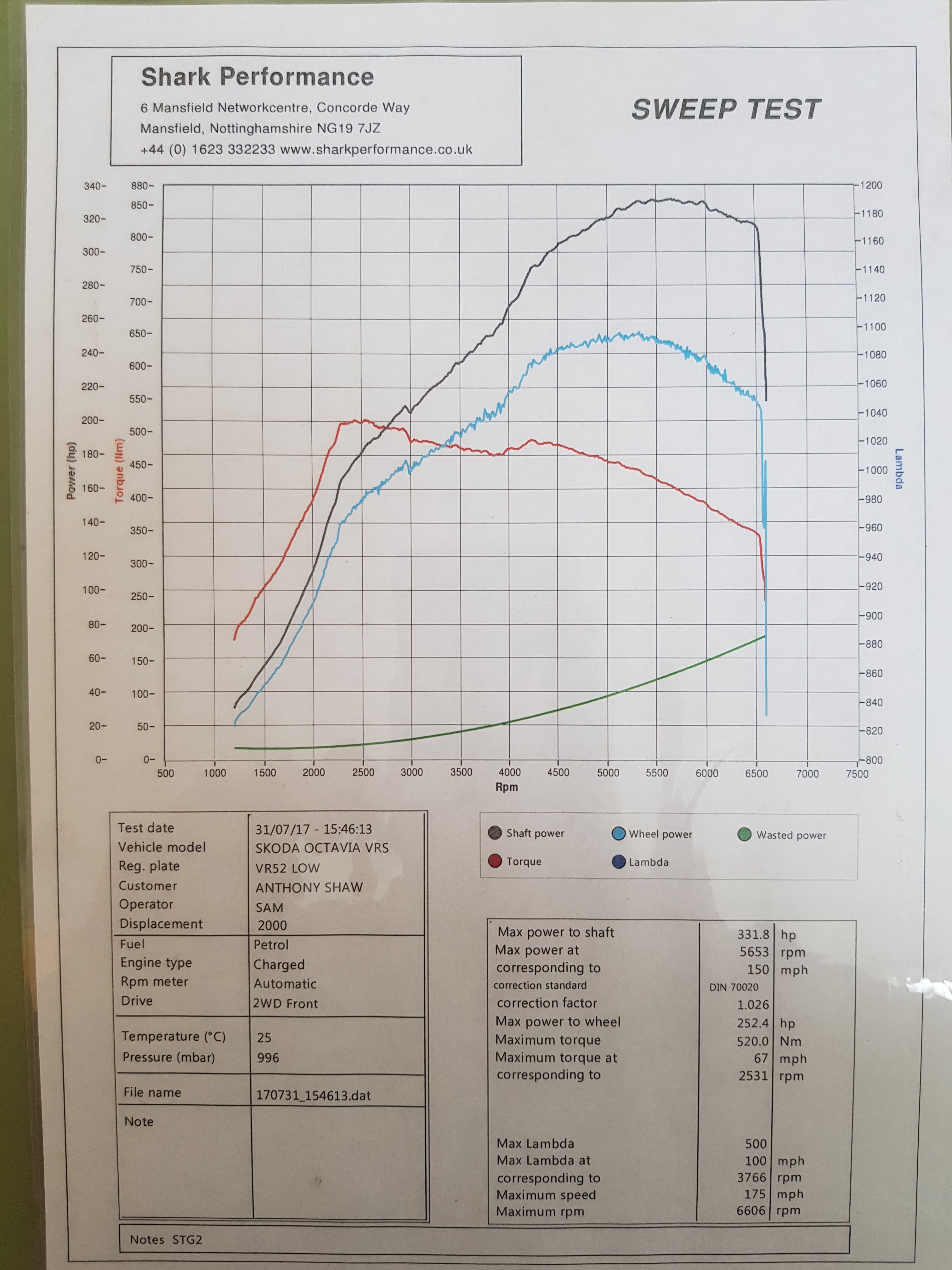

The car has been mapped at shark performance in Mansfield I can't thank Ben and the team enough. We did a before and after runs. The before run was 252bhp, stage 1 303bhp and then stage 2 331bhp and 520nm it goes like stink now and puts a massive smile on your face. Also we did in 5th on the rollers and omg the Speedo was reading 170mph and the dyno read 150mph and we had another gear to go at. I think this will be close to a 200mph car, roll on Germany for the autobahn
Remarkably similar to my 245 with 248bhp standard, stage 1 at 302bhp and finally stage 2 at 336bhp and 517NM of torque. Even faster at stage 2 due to manual hatch a bit lighter than your DSG Estate both on factory turbos for comparison. Mine was 400NM as standard.:party:
