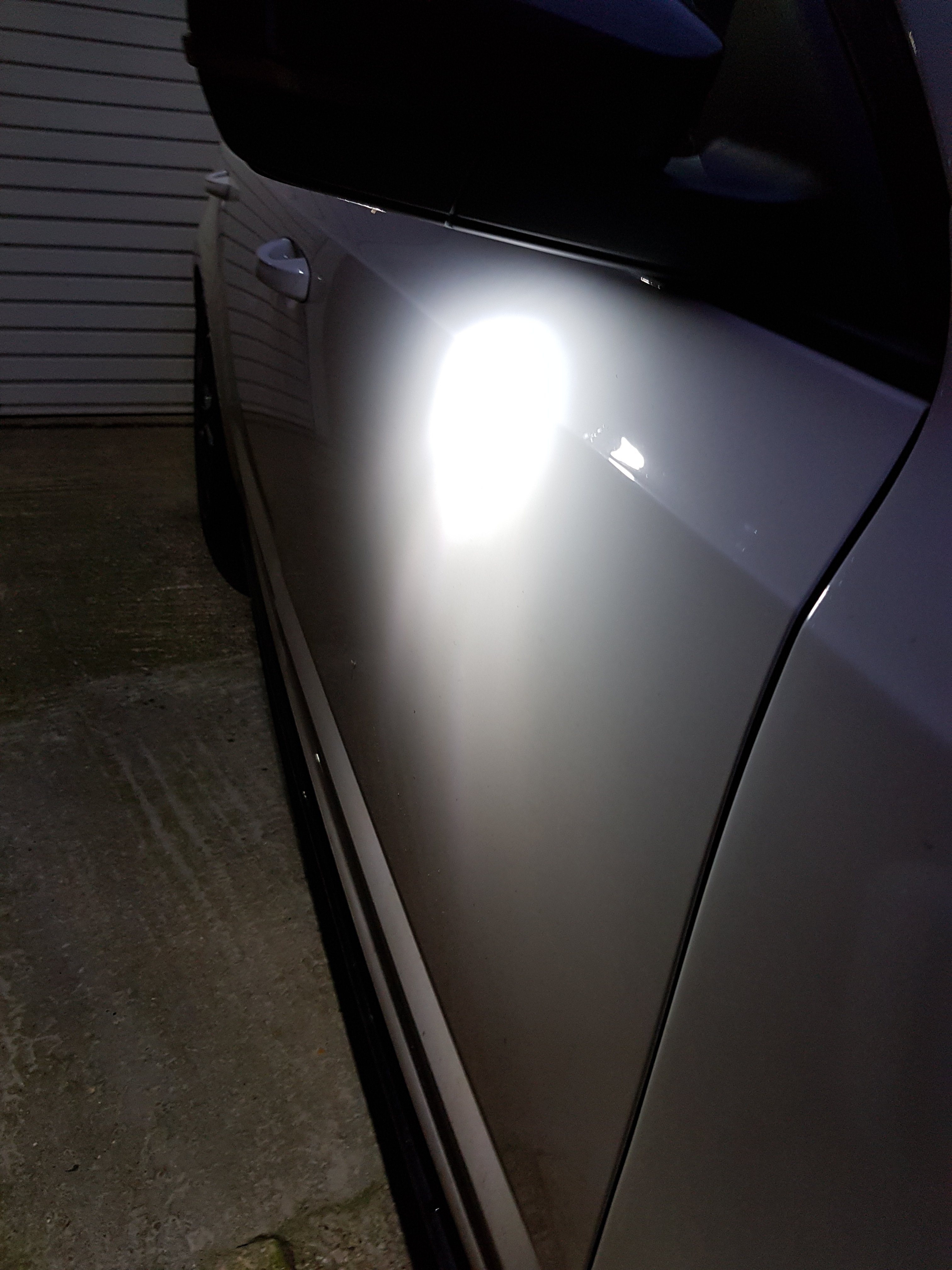

Led puddle light in the wing mirrors but had to wire them into the interior door light as no wiring loom was there (14plate car)

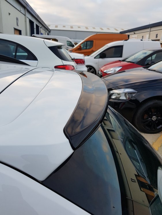

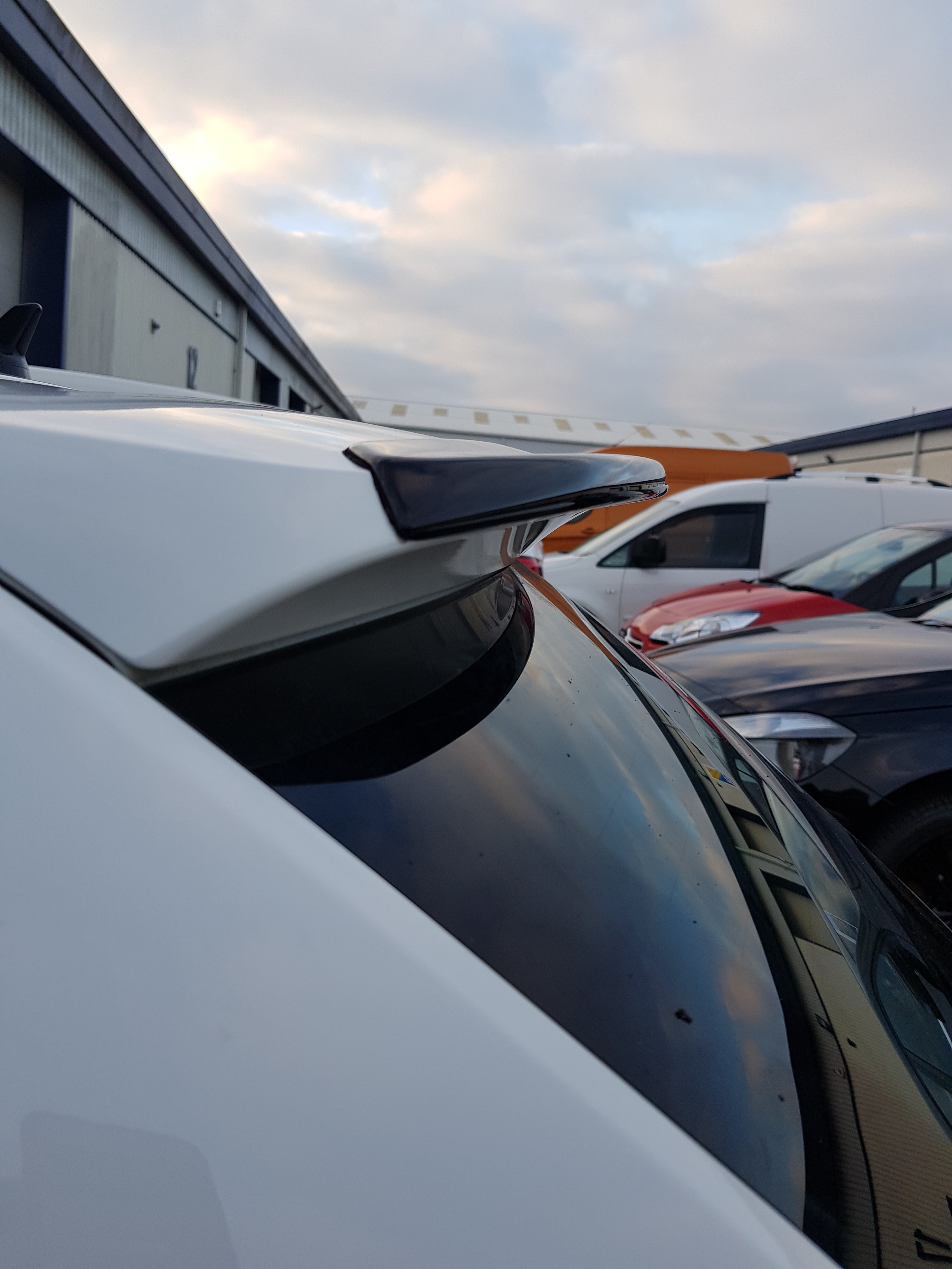

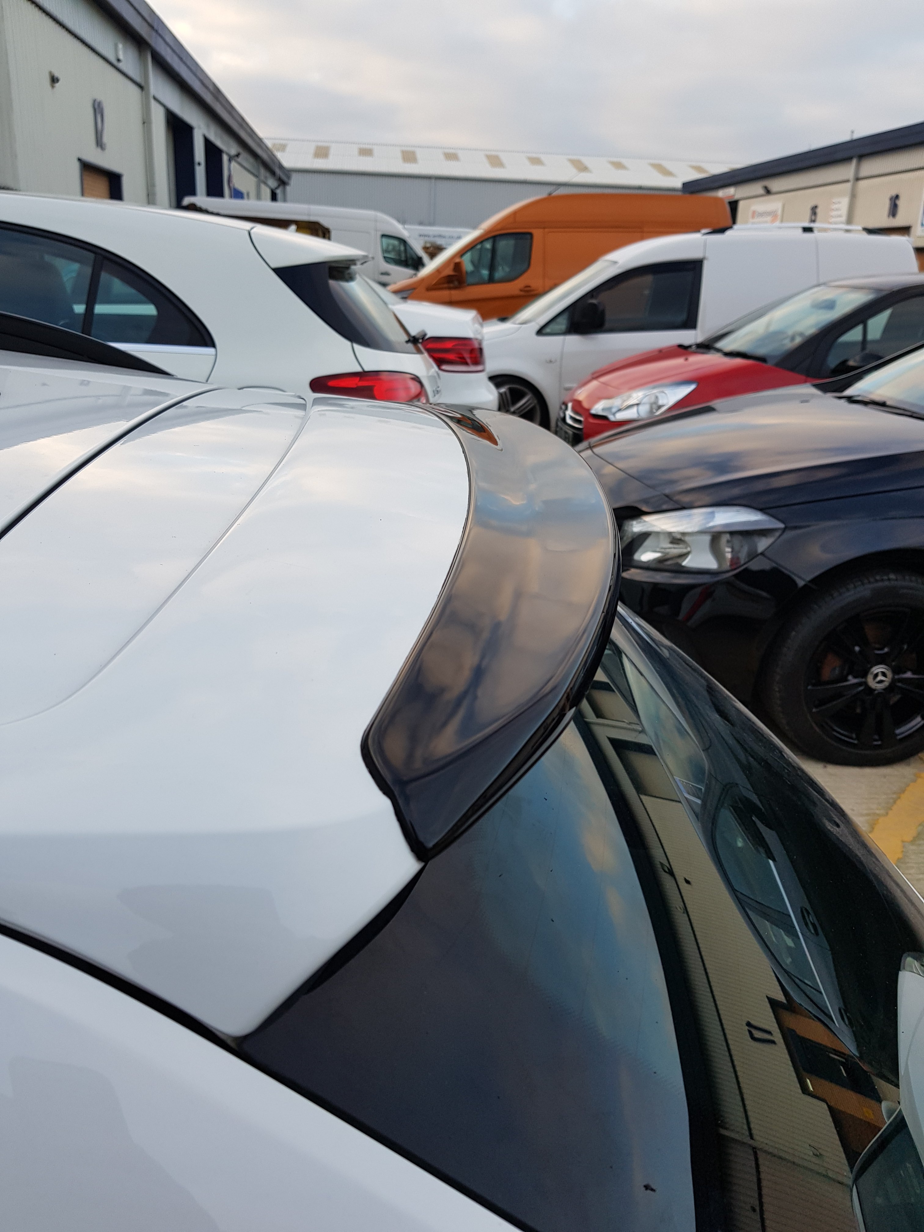

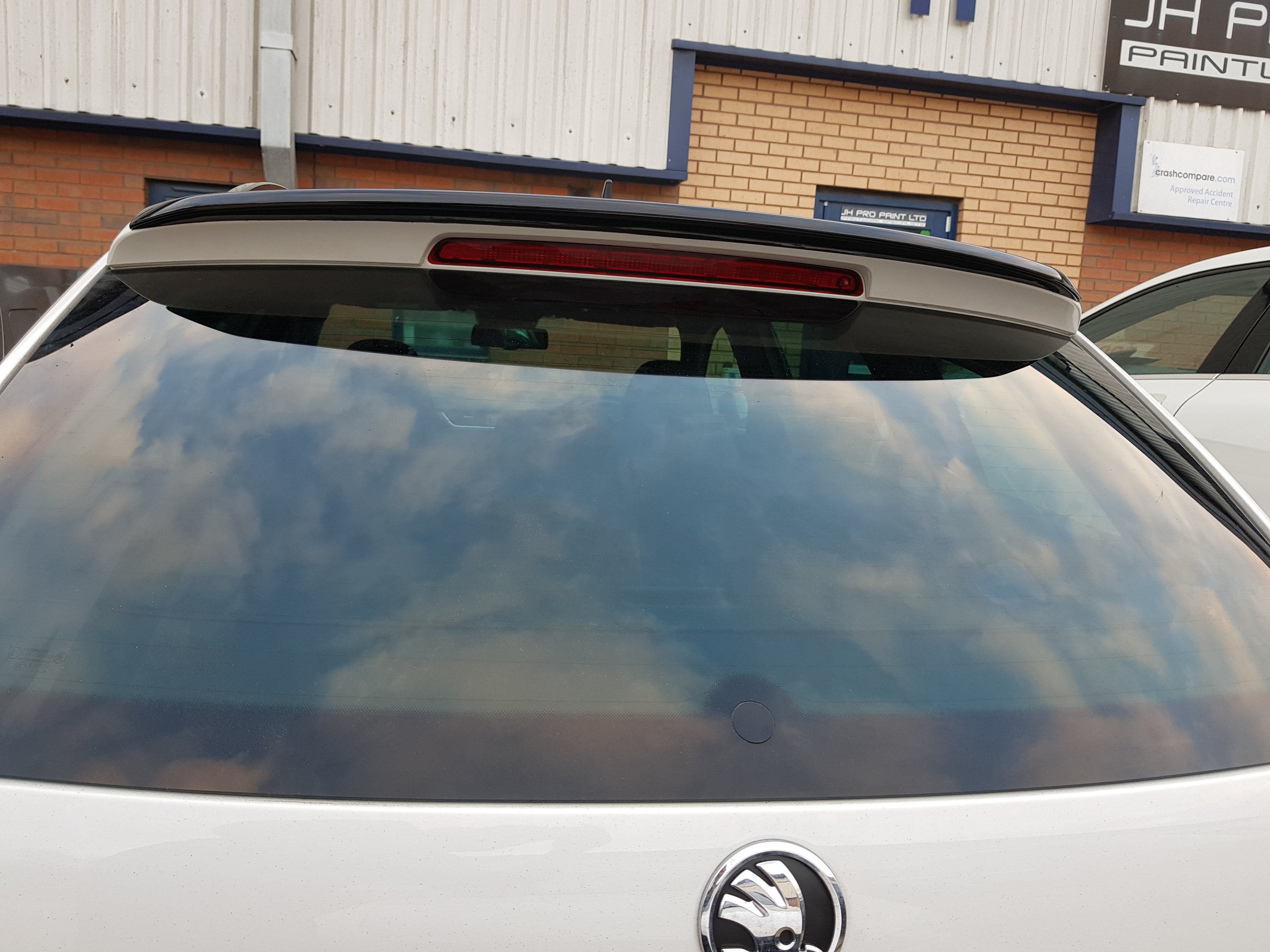

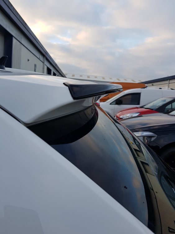

Milotec rear spoiler extension in gloss black
Did you have to buy different wingmirror covers for the bottom section where the puddle lights are?
Nope the shape for the puddle lights are there I just cut them out.

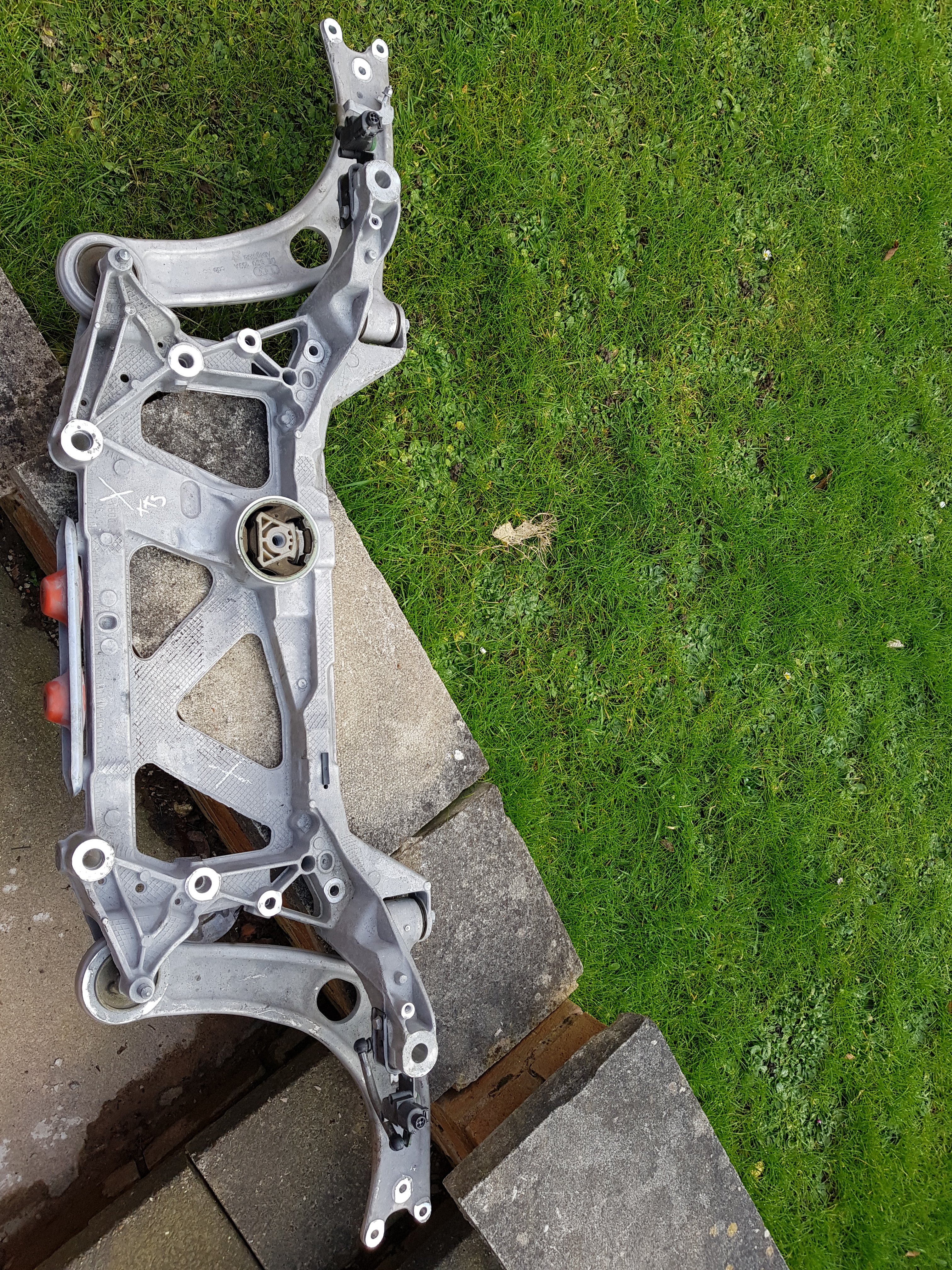

On 05/02/2018 at 23:53, Ant-Vrs said:
So she's going on a diet even more.. I've picked up a Audi TTS alloy subframe and alloy wishbones and hopefully be saving +6kgs
Wow , even i am planning for a alloy subframe .... could you pls tell me the part number of this part number , and is it same as that of audi a3 , s3 alloy subframe ....
Respect for you build from India....
Sorry I cant remember the part number for the alloy subframe, I think they are all the same on the mqb platform. The wishbones have to be modified to fit the vrs balljoint to keep it the same width/track
