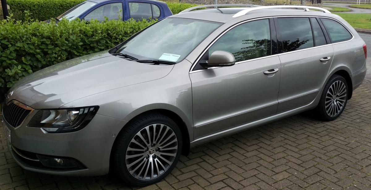

I've a late 2014 2.0 CR 170BHP L&K Combi, 2 wheel drive with 33K miles on the clock. I bought the car from a main Skoda dealer back in Sep of this year with only had one previous owner and a full dealer service history. Now that i've had the car a few months i've noticed how bad the fuel consumption is, i'm averaging 19-22MPG on short trips and thats when the engine is up to temp and on medium journey's (30-50 miles) i get an average of 39-42 MPG. I typically fill the car to the brim and on the current tank of fuel i've traveled just over 145 miles and left with just under half a tank!! I would expect to get around 430-460 miles on a tank and that's on based on driving around town. I've had a 2006 Octavia 2.0 PD 140bhp (manual) from new and not only is the fuel economy much better (typically get around 460 miles to a tank and again this is mainly town driving) but it feels a LOT more powerful!.
Something else that i've noticed with the Superb is the power or rather a lack of it or so it seems! My Octy 2.0 PD feels like it has a lot more torque but since i've not driven any other 2.0CR 170BHP Superb's with DSG it's really hard to know as i've seen other people mention that the CR diesel's are a lot more progressive than the PD's which dump all their boost in one big dollop so this might be me having to get used to the CR over the PD but again i can't help but feel that this might be relating to the poor fuel economy i'm getting.
I plan to book it in with the dealer after Christmas but before i do i wanted to get some feedback from anyone else driving a similar Superb and if they've experienced the same and had it to the dealer and what the outcome was in the end.
From other posts people have suggested driving habits, tyre pressures, alignment etc so here's a summary of what i've done and how i drive the car:
  • 18" Sirius Alloys with brand new tyres inflated to 40PSI front and rear
  • Wheels all aligned by dealer as new alloys were fitted after i bought car as existing were all buckled.
  • I drive in D mode the whole time and am not hard on the brakes when coming to a stop or hard on the accelerator when taking off
  • I'm not driving around with any unnecessary weight in the boot. Mainly just my wife and 2 young kids
Another issue i have is with the brakes as they seem very loose and not at all progressive. Because of the lack of progressive feel you tend to apply too much pedal and therefore slow down and stop too hard. I'll take a look around the forum to see if this is simple as air in the system and a simple bleed or potentially a problem with the master cylinder but if you have any ideas again your feedback is appreciated.
I might be over thinking some of this but these issues are really stopping me from loving this car and to be honest i think this is a great car and hope to get all of this addressed without too much back and forth to the dealer. I've attached a pic of my pride and joy.
thx all
