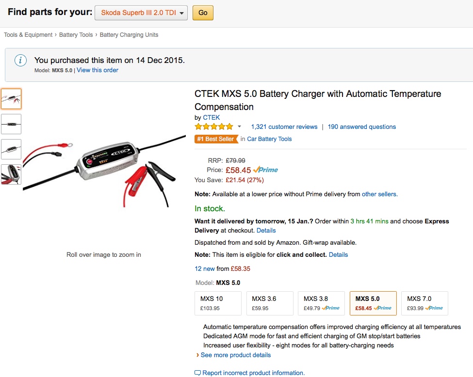

I purchased this charger for my Superb MK3.
