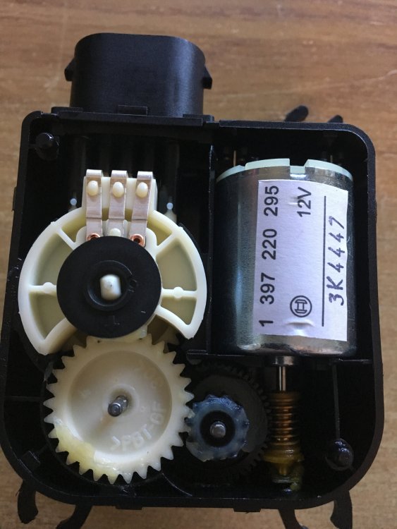

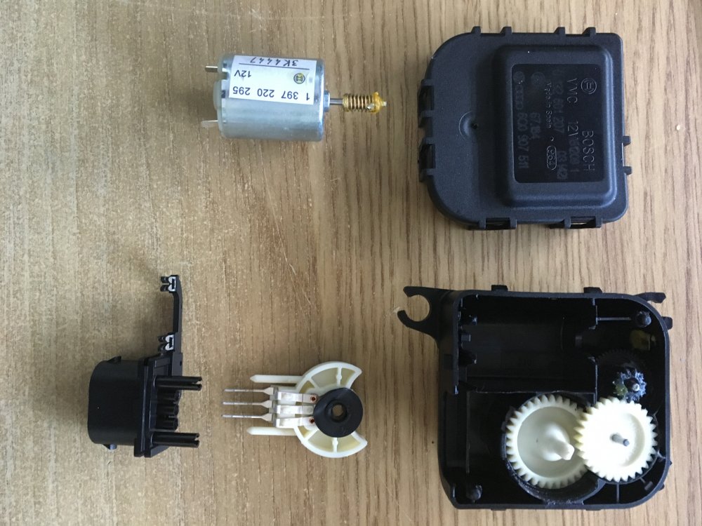

Some info in case anyone needs to strip down the motor in future. The poster in the link above mentioned having to break off various bits to get the potentiometer out. There's a better way - first, pull out the motor element, then pull the whole plug socket upwards with the potentiometer still attached (it just slots in). Pic attached.
Also, the arrow on the top of the potentiometer indicates the extent of travel - if correctly installed, the potentiometer should be able to travel from the arrow at the left edge of the gap in the potentiometer's white plastic to the right of it, when you turn the big black cog on the rear of the unit from stop-to-stop.
Waiting on contact cleaner at the moment which will hopefully breathe some more live into it. I've confirmed that the motor works when in the car with the potentiometer removed, so it's definitely the pot that's at fault.

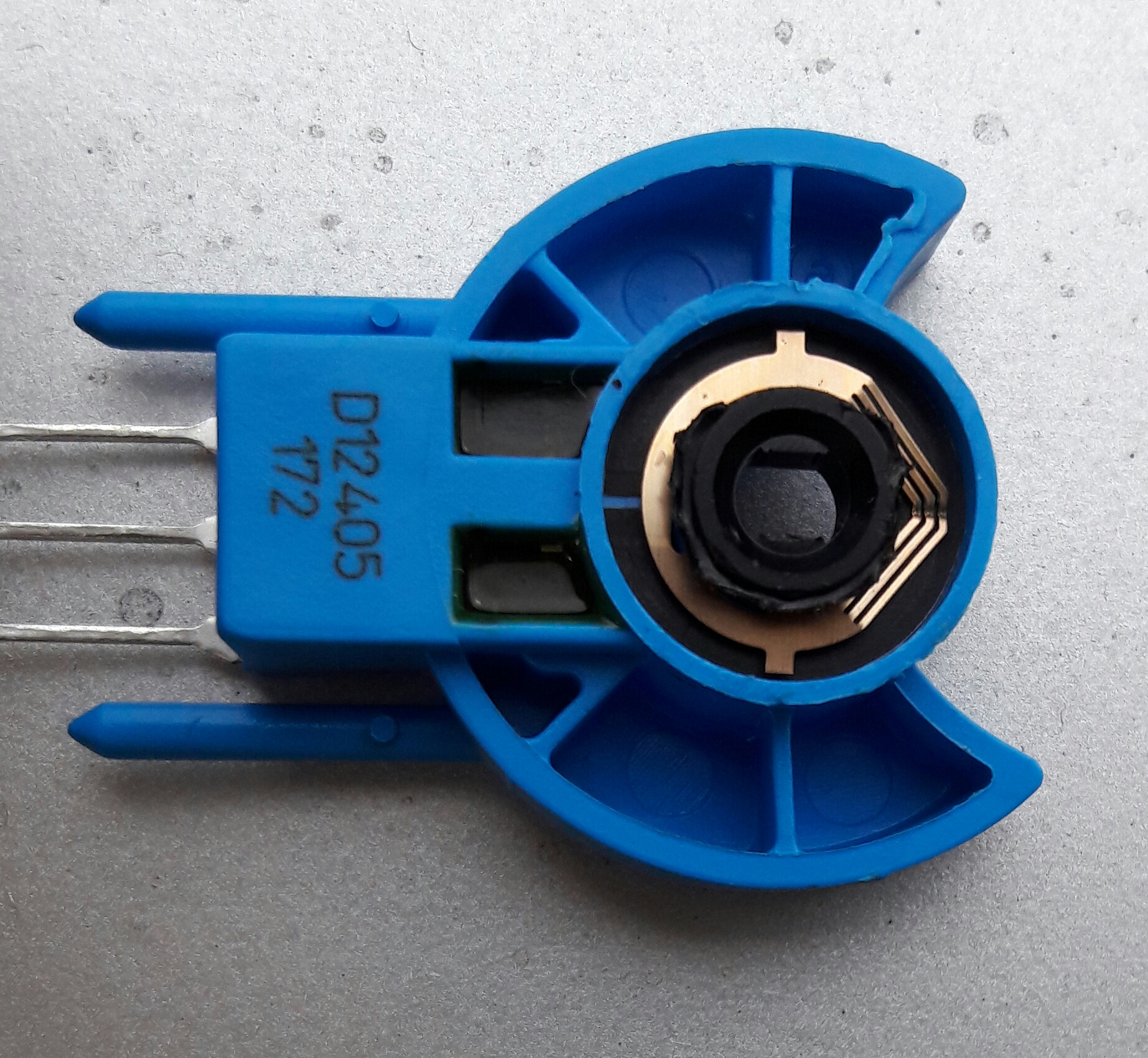

There's the number 162H 2479 on the side (or that H might be a K). The blue one on the Polo forum showed D04104 172, but havn't found anything on either of those numbers. Also saw the number C03523 172 on a very similar blue one, again nothing found.
To get access, I've cut off most of the black part (except the arrow bit). I figure there's not much to lose at this stage. The track looks intact but dull, so it might clean up alright.
