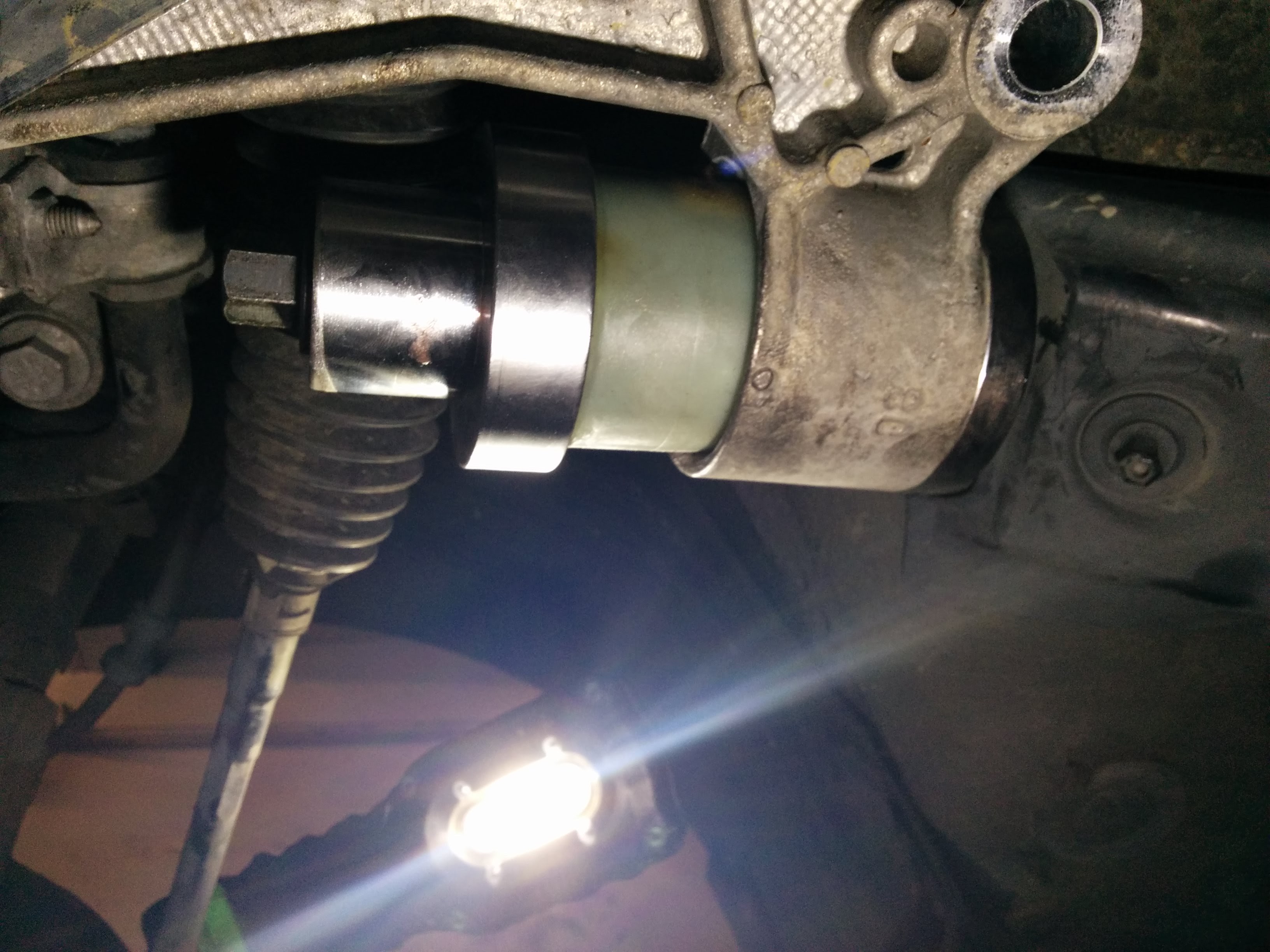

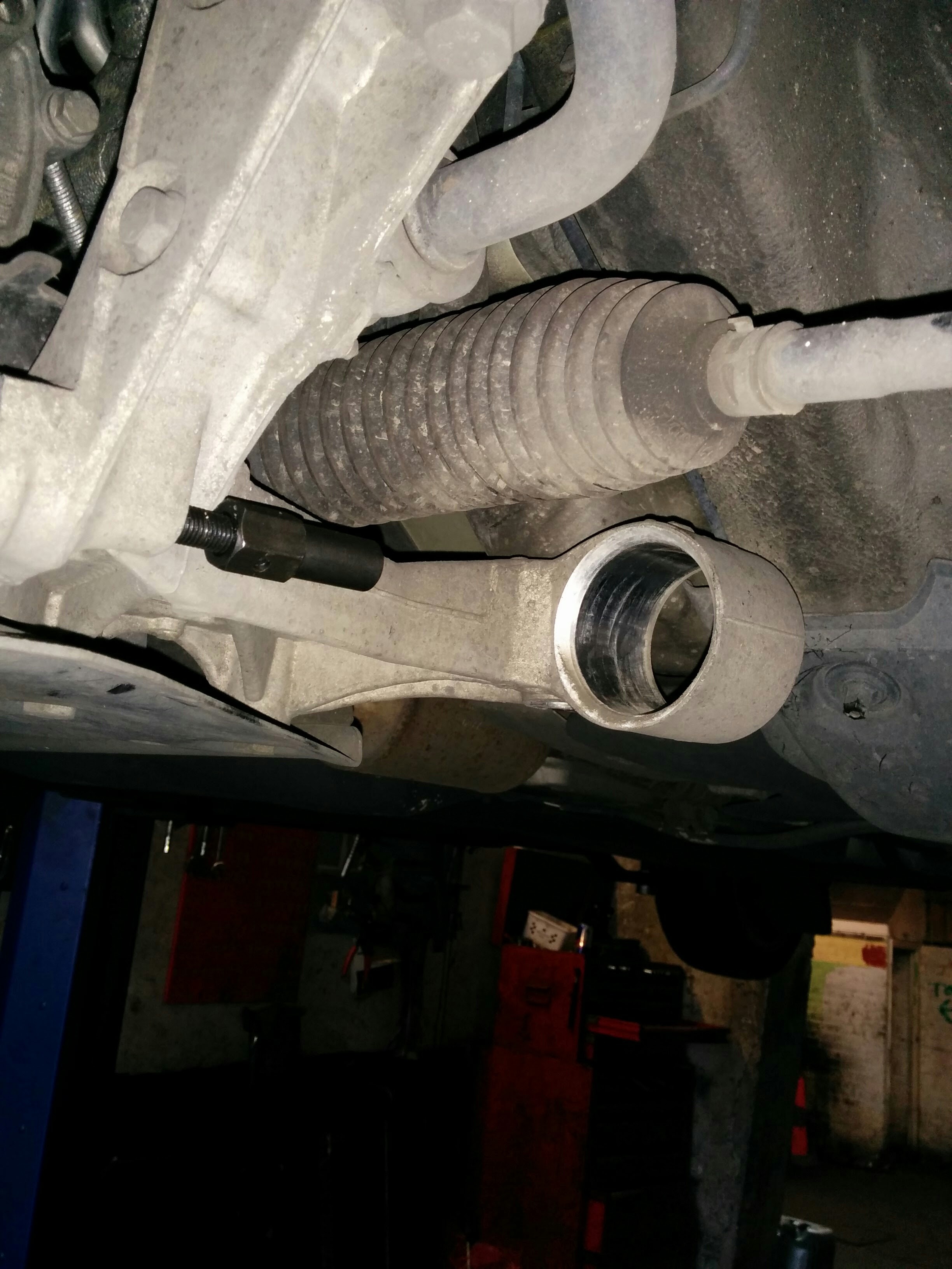

My Roomster used to make a front knocking sound, especially when going from forwards to backwards and also over bumps. The knocking was due to the console bushes for the front wishbones. I got one of those screw removal tools and changed them both and the problem was sorted.
Yes before I had my front console bushes replaced (last year)on my Scout 2007 ,I used to spray them with lithium grease about once a month. The noise till then would sound awful ,like something was loose under the car.It was worst in winter time
