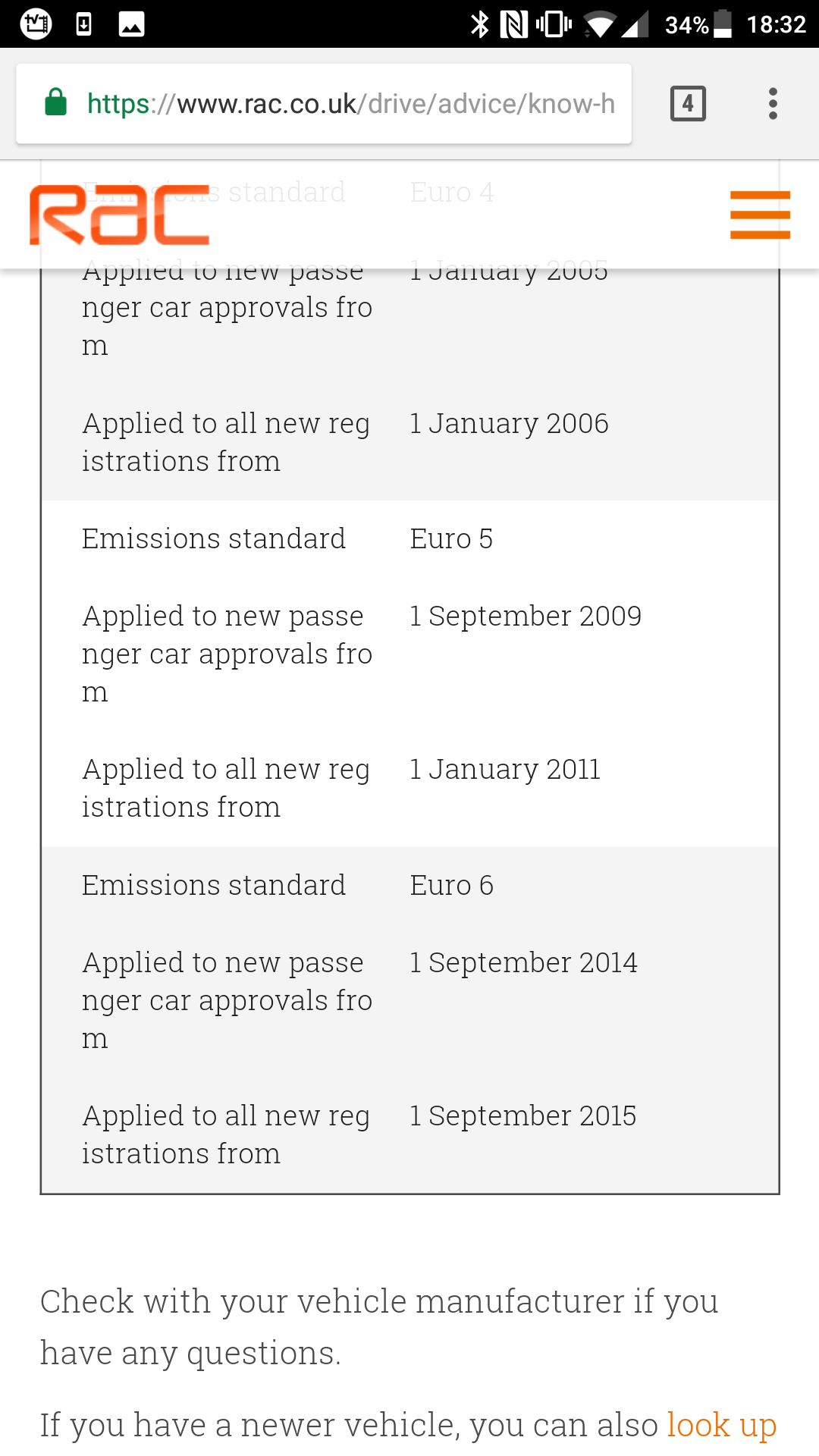

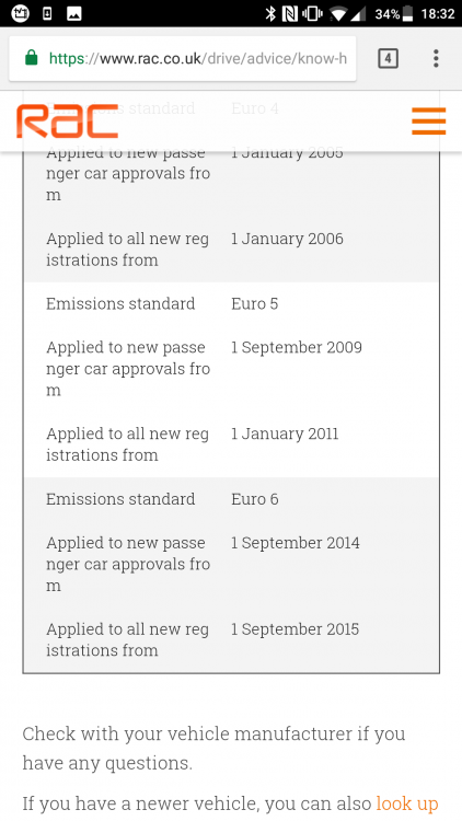

I think you will need to check your v5 to determine the euro level but I believe your car is Euro 5 not 6.
Euro 6 came in for all cars registered after September 2015 and for type approval from September 2014.
So a car registered in September 2014 I believe is going to be euro 5. According to this site, https://www.raccars.co.uk/value-my-car/ my March 2014 registered vrs is only Euro 5.
But as I do drive in London occasionally, I would like to be proved wrong and have a Euro 6 car, so I don't have to pay the T-Charge.

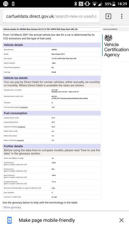

DVLA data seems to suggest Euro 5 MK3 Octavia diesels exist. Example vehicle is an Octavia VRS 184 2.0 diesel DSG registered in March 2014.
Compliance for Euro 6 started from September 2014 for new type approvals and applied to registrations from September 15 onwards.

But surely it's irrelevant.. the engine could be designed for Euro 9, but it's only going to be approved to the level available at that time. So in this case Euro 5.
If the government decide to penalise/tax Euro 5 but not Euro 6 cars in the near or distant future, it's very relevant because the model year/reg date will have a significant effect here, even if the engine itself is identical.
