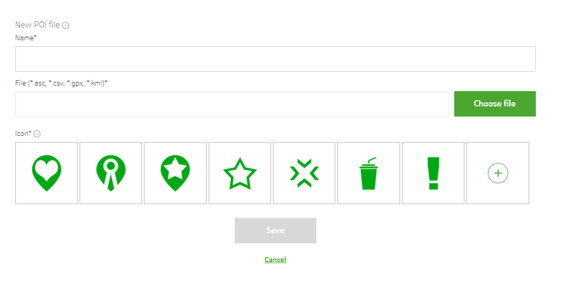

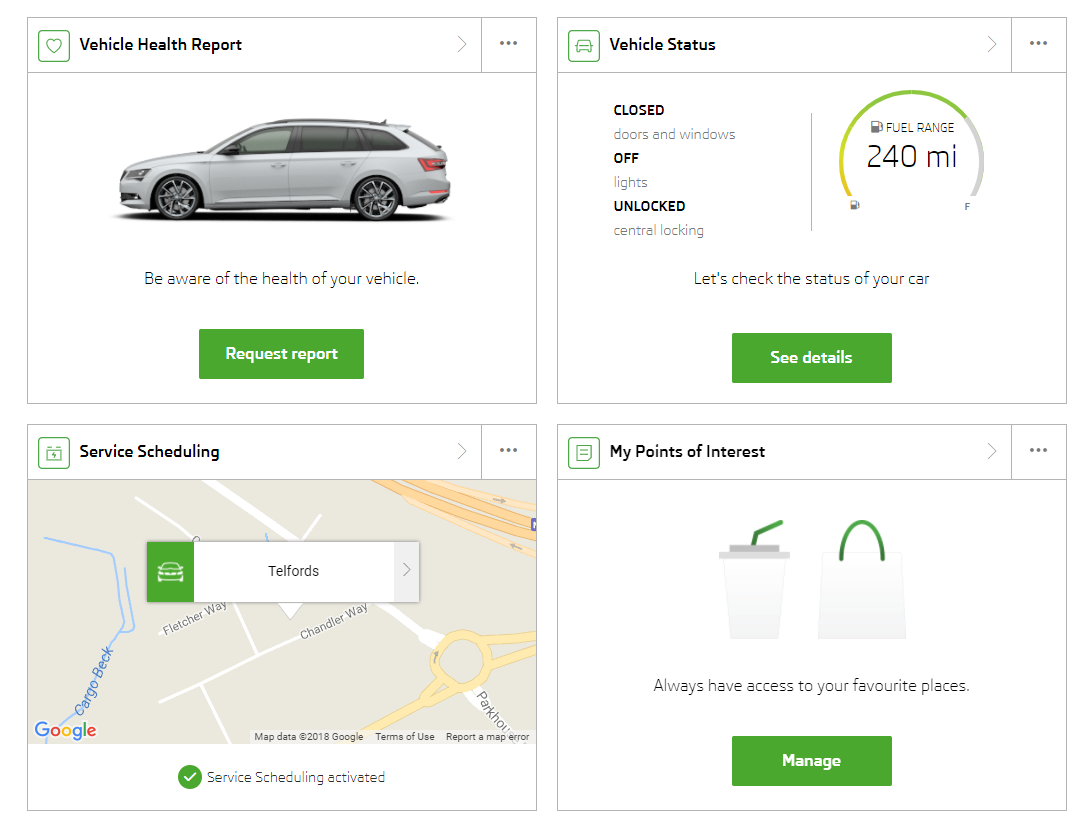

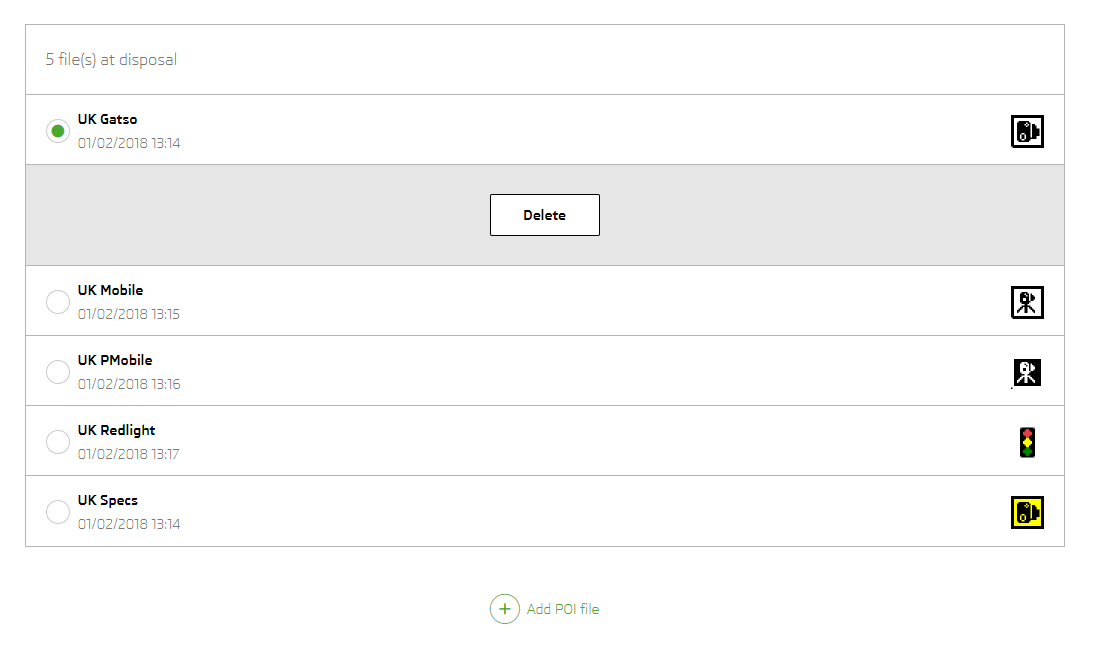

well, it's been easy and successful (to a degree). I did all the steps of downloading the camera data as per the instructions above. I did actually download all the possible file types, not just csv, as will become apparent shortly.  I figured I would try it first without manipulating any data (and indeed, you don't have to)
you go to skoda-connect.com to login. (actually this site is pretty frustrating, as it keeps forgetting some of your details and you need to keep adding them).. anyway, once in the overview page for your car, you select "Manage" under "My Points of Interest", which leads to a page where you can upload the files.  Several formats are supported, except they aren't because every time i tried to upload the .gpx file, I got a server error. So, I just uploaded the CSV's.
Then in the car you fire up the navigation and have to find the my POI's settings (I didn't make such a good note of this at the time, but I will next time i update) - and there is an option to update from online; selecting this and it miraculously grabs all the files from online.  I then did have to do some finagling to get them to show - that didn't seem to work at first but after a couple of attempts has done so.
only issue is: no warning on approach...  If I remember correctly I couldn't find a setting on the columbus that seemed to relate to that  - but I can confirm that the icons do appear on the map..

You’ll see in the images in my post that the screen that lets you add a file also has an icon selection, and a + button that allows you to use your own image. I just uploaded the ones that came with the POI download without any changes. :)

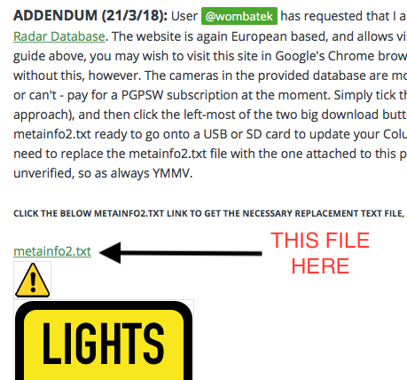

CLICK THE BELOW METAINFO2.TXT LINK TO GET THE NECESSARY REPLACEMENT TEXT FILE, AND THE HAZARD WARNING ICON IF YOU WANT FRENCH AND SWISS CAMERAS FOR EU DRIVING.
metainfo2.txt

The text file you need is the only one linked (as far as I recall) in the OP. Here it is, highlighted with an arrow for clarity:
5ac196a9c54be_ScreenShot2018-04-02at03_26_25.png.3f54a1272712bf5bacd965a70e00531c.png
The guy you quoted fixed his issue in the end by trying a different USB stick and/or reformatting the stick again. As per the guide in the OP, try re-formatting the stick (i.e. wiping it completely) to FAT32, NTFS or exFAT (and try the others if one fails). Try a different stick altogether also. It sounds like your issue is the metainfo2.txt file being either missing or incorrect, however; so try fixing that first.
As said, you can download the correct file in the OP (and replace the one provided by the VW site when you follow the guide). Alternatively, the contents of the correct file are enclosed in the following code tags, should you wish to make a file called metainfo2.txt of your own. As you can see, there's nothing about French or Swiss in it, so it would appear you've not got the correct files on the drive. That would explain the failure to update.
