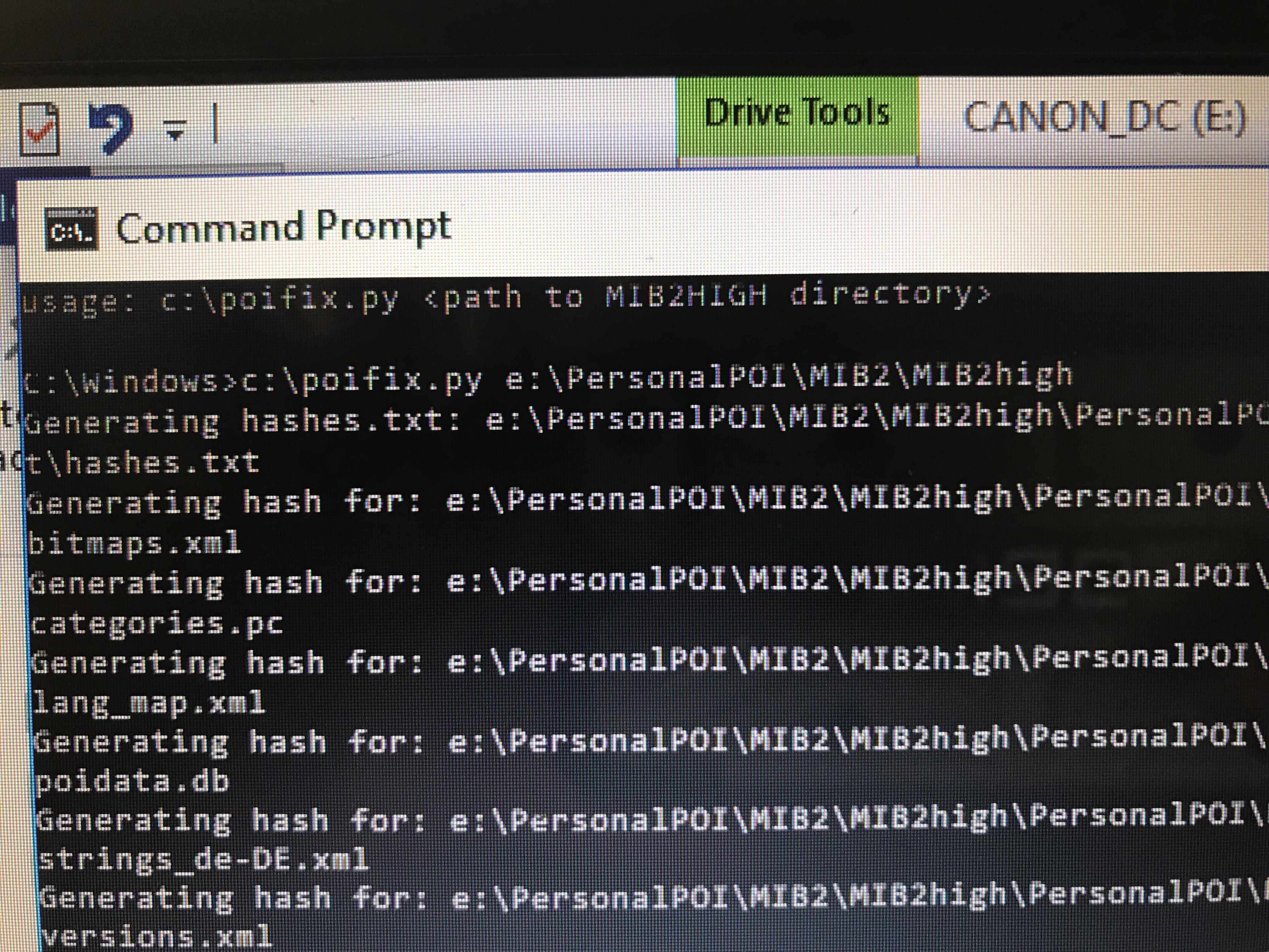

42 minutes ago, atki81 said:
Hi I've since borrowed a windows 10 laptop, formatted 2 different usb sticks a 16gb in FAT32 and a 64gb in exFAT. The first time I did it I'd forgotten to change the metepinfo2.txt file and it just tried to installed failed and rebooted. I went back swapped the file out with the one here and tried again and it doesn't find anything like it did before just sits on searching!! I'm so confused beyond belief?!? Do I need to run the poifix again as I've changed this file? PS.. I have no SD cards or SD card slots.
Atki81,  when you ran poifix did you get a similar screen to that below? (This would indicate it was successful.)
