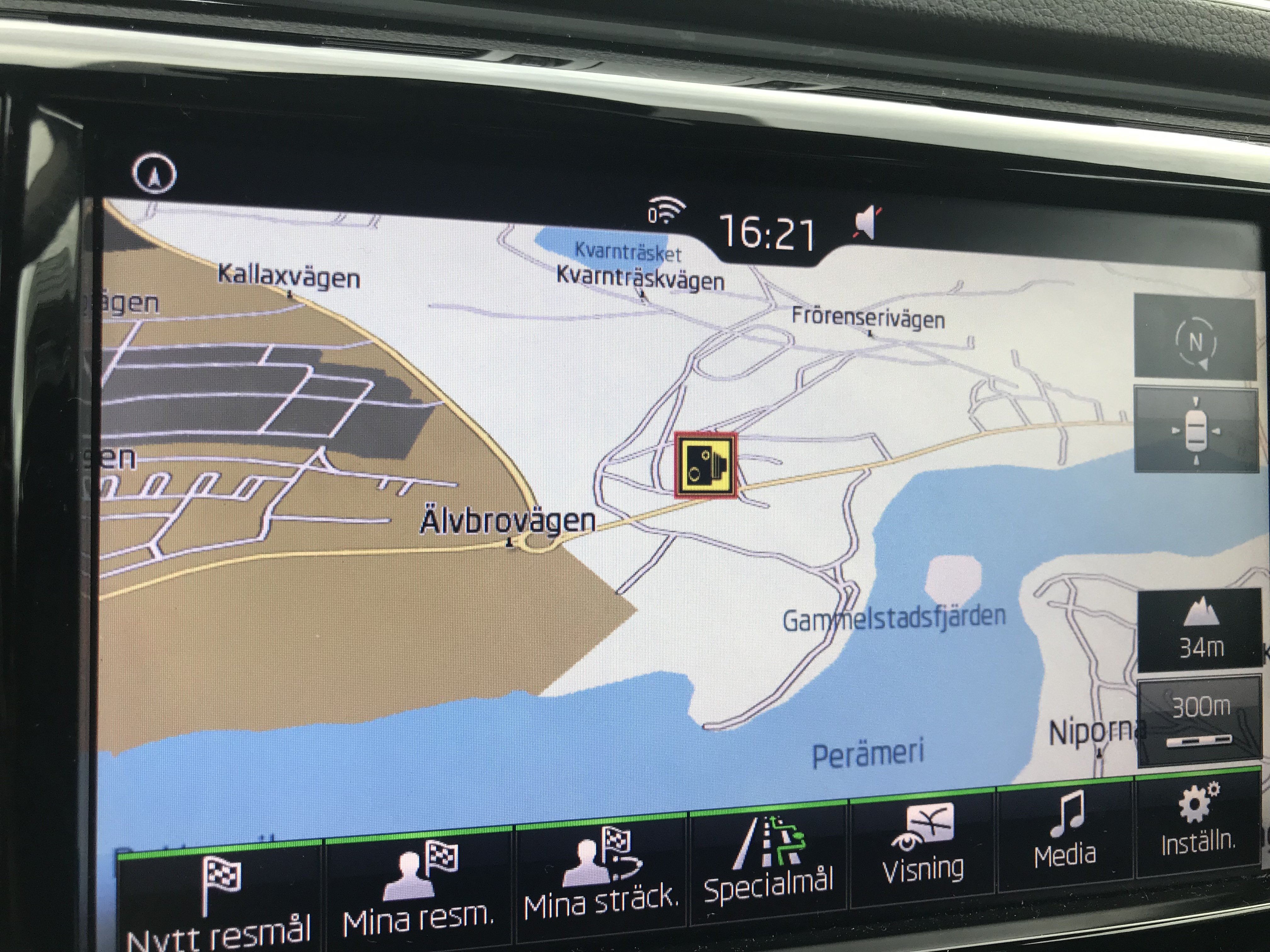

Yay it works! =)
I think I just had too big picture for the speed cam icon.

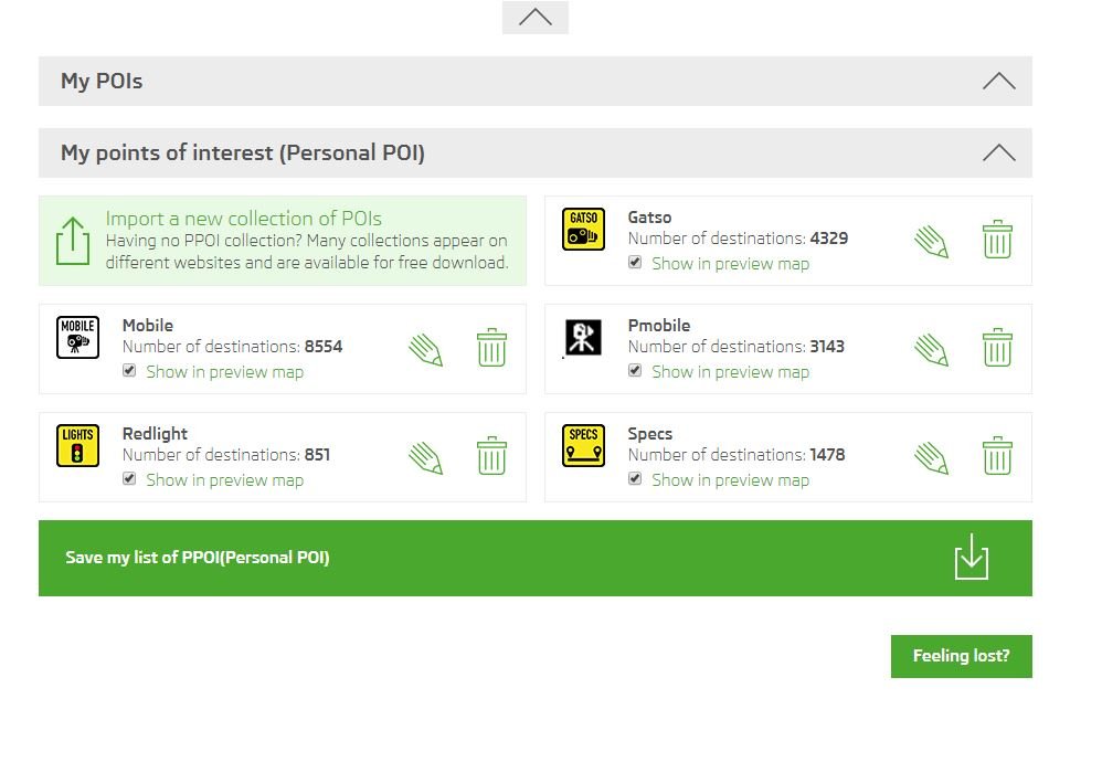

1   Downloaded CONSOLIDATED file from Pocketgps world in *.GPX format ( ok )
2   Extract file and remove *.BMP files  ( ok )
3   Download new *.BMP files        ( ok )
4   Go to  SKODA MY DESTINATIONS and inport files and bitmaps  ( ok )
5   Create POI files  ( not working  )
Tried again with same file from Pocketgps world, this time with original *.BMP files but still not creating files.
Is the portal down or is there something else I am missing ?

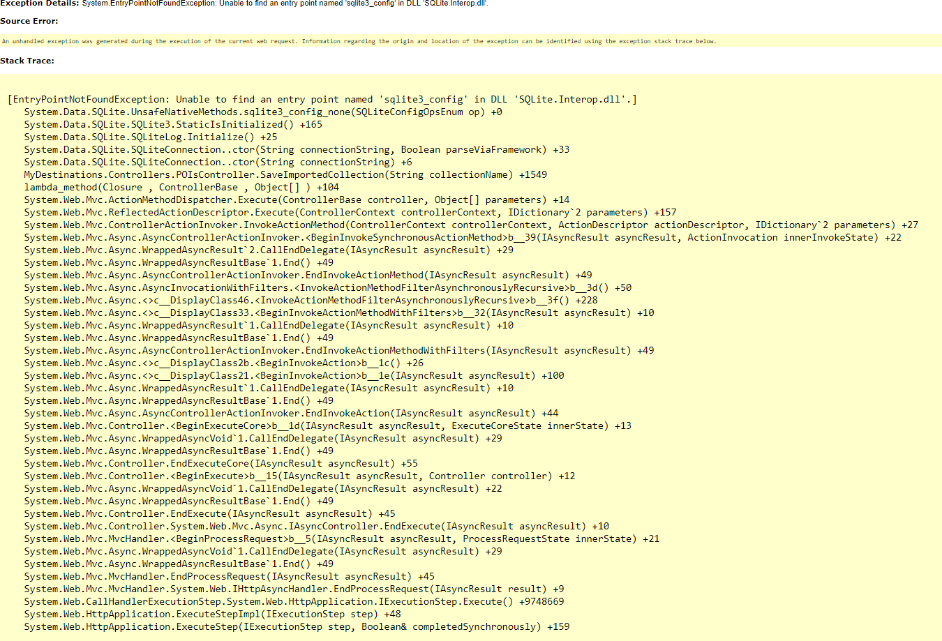

Yeah it doesn’t work here either at the moment. Previously it would only crash when saving down the database in Google Chrome but it would work in Internet Explorer, but today I get the same crash in both browsers.

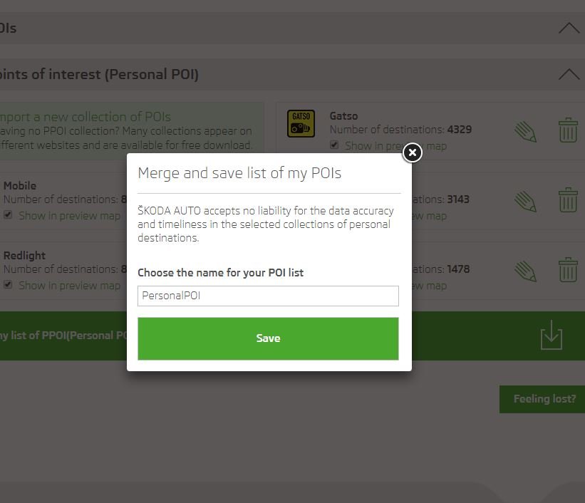

If you created you file using the "Skoda My Destinations" web site, after you choose the files you want to convert; but before you actually convert those files, there is the option for "make a sound" (or some description like that) near the top right of the box. You can also select or change the icon which represents that location at the bottom of the box. You then proceed to the conversion to a file that your car GPS will accept. But for what its worth, its only a "Bong" and it only makes that sound once. At first before I realised what the Bong was for, I thought it was a warning of something wrong with the car. :doh:
Hope this helps

Yes i have created my poi from skodas site and have ticked the box for make a sound but only for speedcams not for the speedbumps that i also included in my pois. I have not heard any sound when passing a camera but maybe i have had the music to loud.

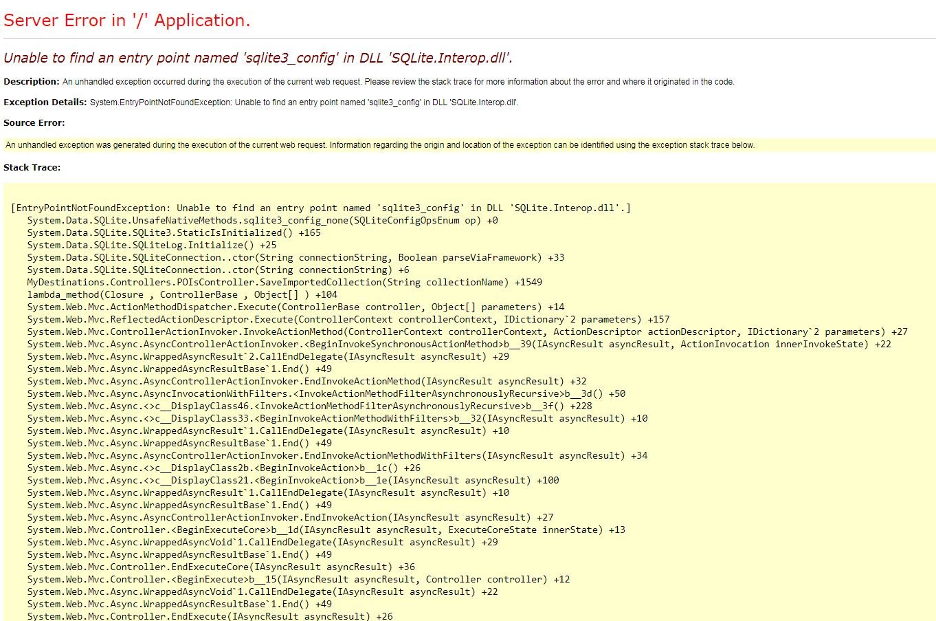

Ok ive got windows so ive tried everything to the letter but when i get to saving my pois on the skoda site i get the yellow screen with loads of error messages as posted by someone previously
You are correct. The Skoda site has got the gremlins yet again. It keeps doing this and last time I spent a long time onto Skoda Customer Service to explain the issue. Eventually they sorted it out but it just seems to recur again without warning.
