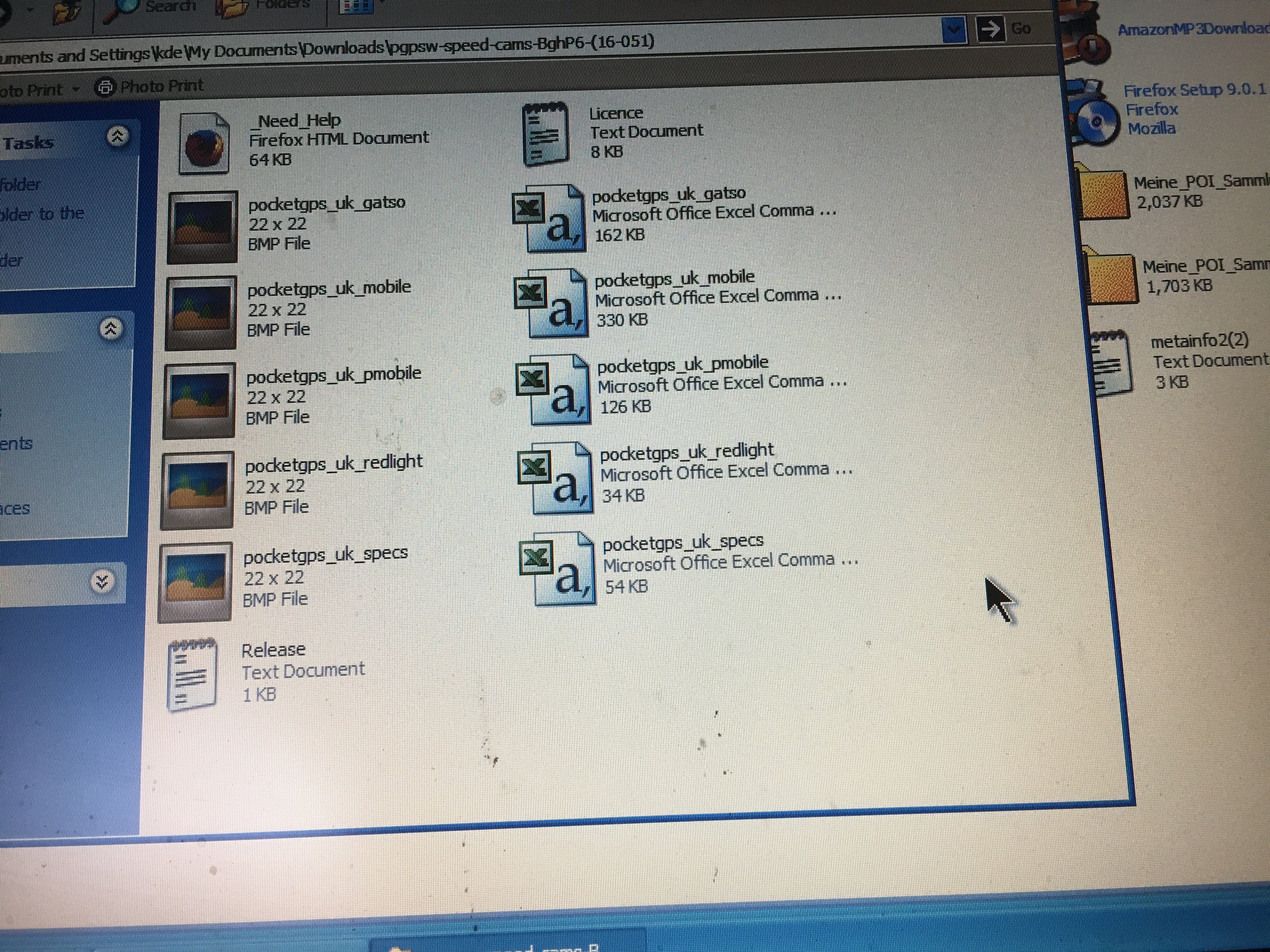

I’m downloading and unzipping the pocket GPS files in csv format but when unzipped they look like this. It’s the latest updates so wondering if there is a file glitch ? I’m pretty sure these aren’t csv files but could be wrong. Lat time I downloaded they definitely came up as csv after unzipping
Edited by kevin defty
Don't worry, it's down to your windows explorer settings - you have the .csv files displayed as MS Excel Comma Separated Variable files.

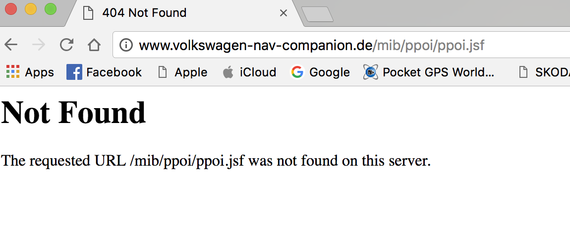

Hi Folks, Is there another site to convert the CSV files?
The VW site doesn't work @ the moment - see attached file..
Regards
Alan
Regards
Alan
This happened once before and they did then reinstate the website but I suspect on this occasion it could be gone for good.
Basically the new system VW are using requires you to register with them and put in your VW VIN before it will allow you to use the new POI site and obviously a Skoda VIN will not work.
I have not found an alternative site that works.
