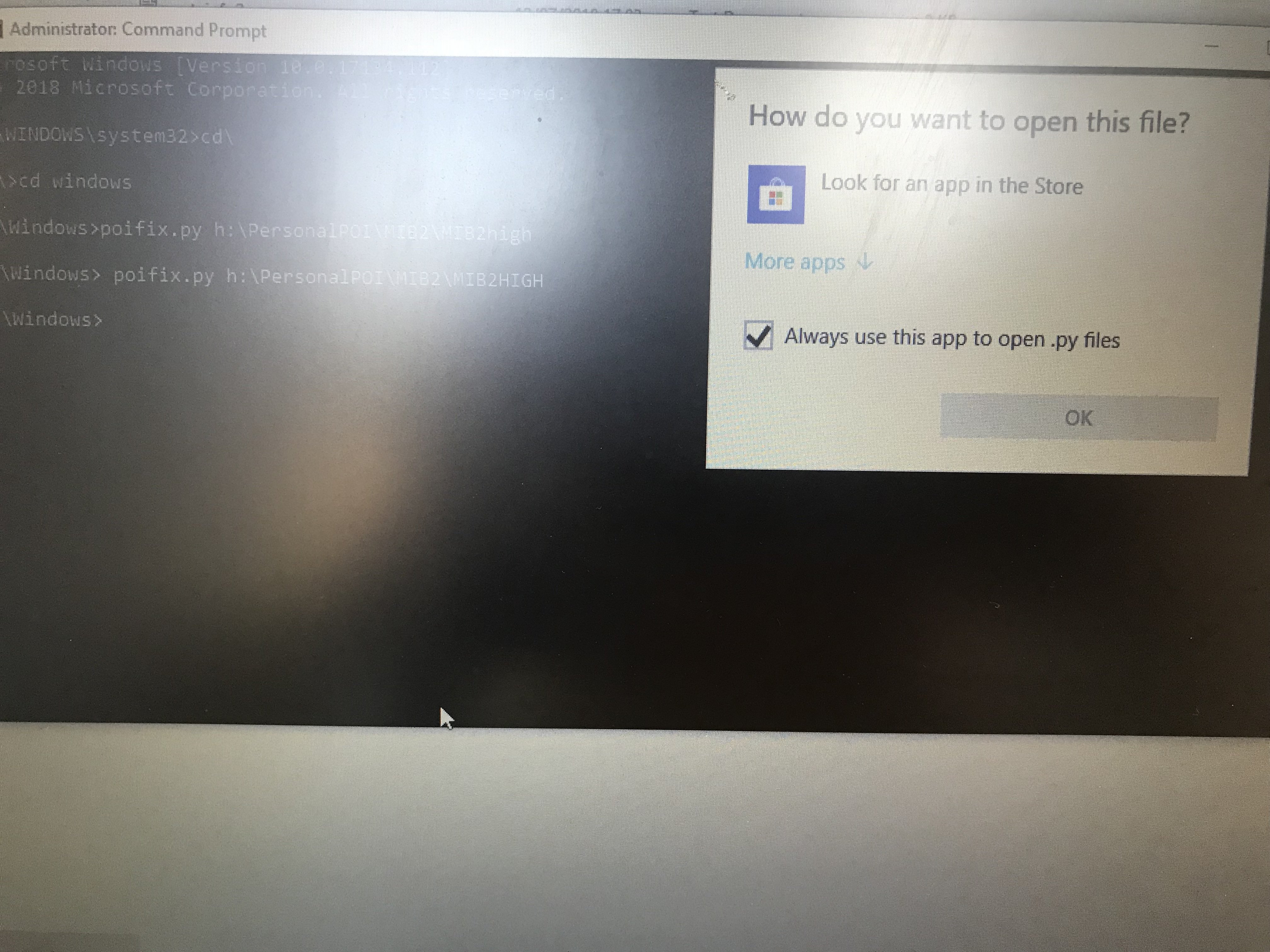

Can you help out please. Trying to use the poifix.py file in cmd(admin) now seeing as though Skoda MyDest is currently working but keep getting the following issue. A bit stuck here so any help would be appreciated.
5 minutes ago, RoboOp said:
Hi @flumpie,
Hi RoboOp,
You've missed out the python executable from the command line. Need something like c:\path\to\python.exe poifix.py h:\personalpoi\mib2\mib2high.
The path is wherever python got installed.
@flumpie :blush::blush: Thanks for that. Brain fart this end. Much appreciate the advice.
