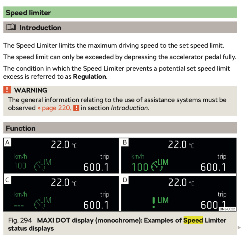

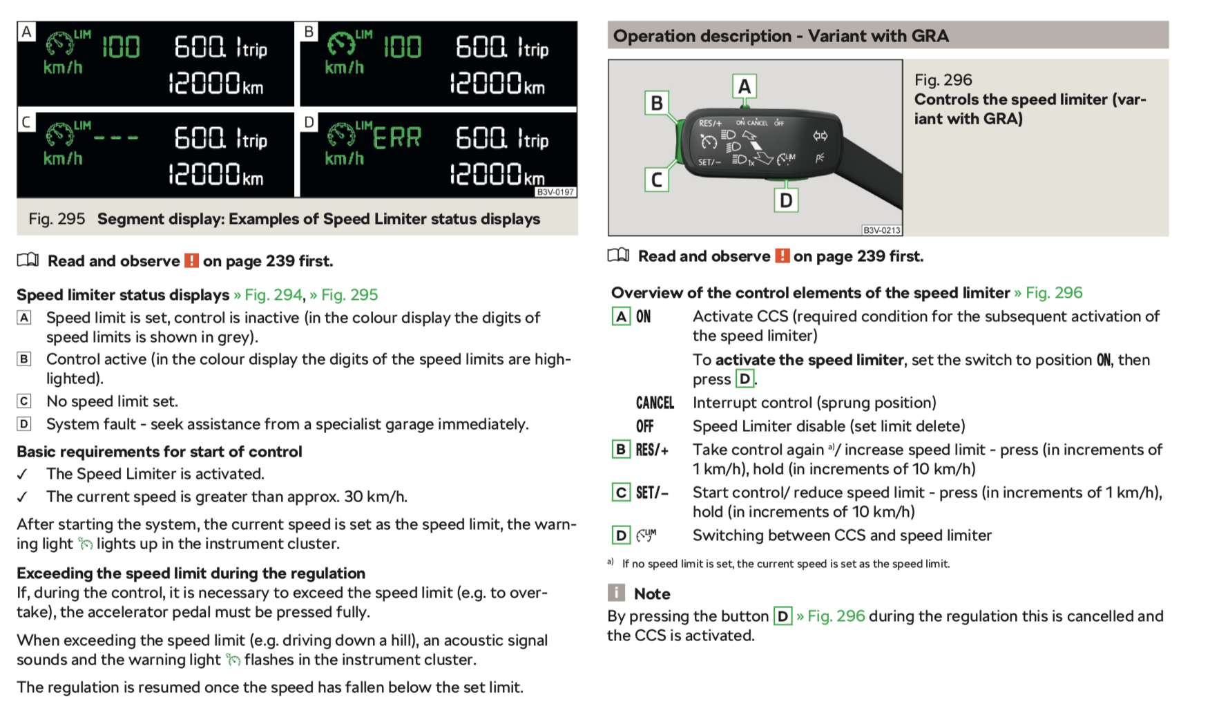

I hate that my Superb does not have a speed limiter. Active Speed Control is nice but a speed limiter is what keeps you out of trouble, FFS Skoda incorporate this as standard just like Volvo have done for years.
Not sure what model and year you have but I do have Speed limiter function
2016. Does your model have active control and a pedal block to stop you exceeding a limit? For example 20mph then 30mph when crossing a junction that you can only over-ride with a full pedal depression. Two clicks up to 40 then two back down to 30. London 20mph limits are a pain on roads capable of taking four lanes of traffic.
Not quite sure what you are expecting but as described in the manual:

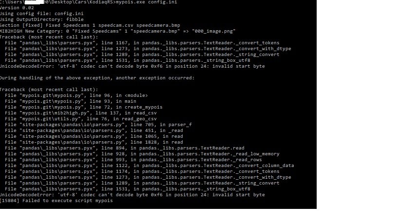

Hello, I followed the steps for MIB2, executed the command but get the attached error. The output directory fibble is created though with PersonalPOI, metainfo2. The PersonalPOI folder also contains MIB2,MIB2TSD . Is this good enough? Is there a need to execute the python code again?error.jpg.22c7097ac6a75302550cd13bb91ff42e.jpg

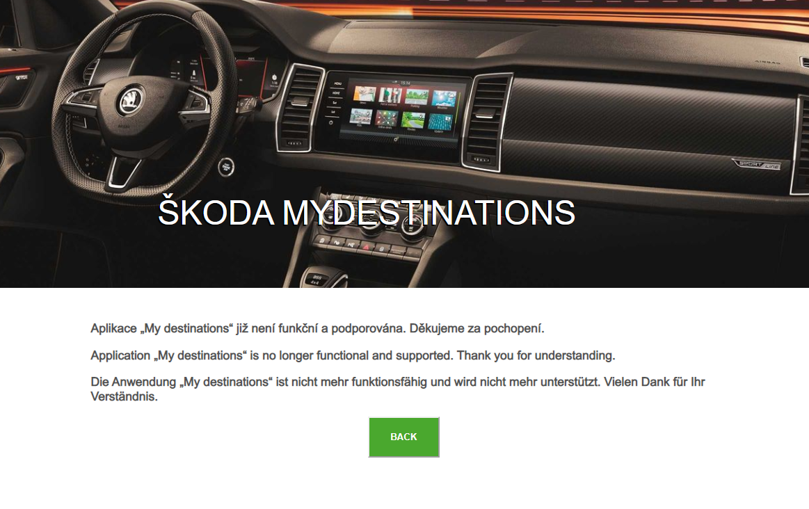

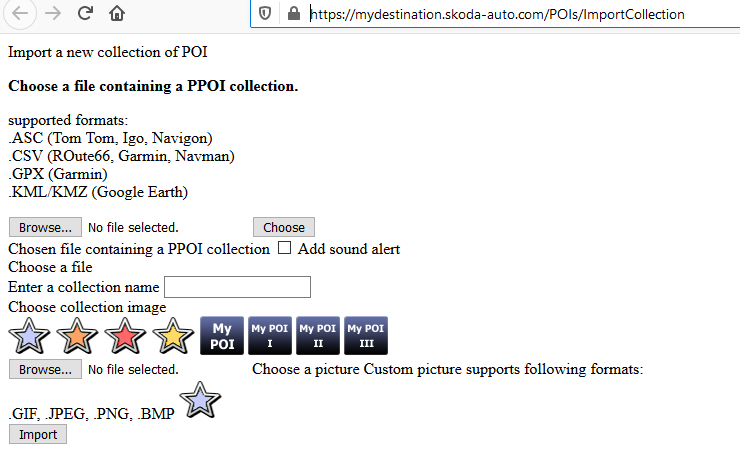

I have stumbnled upon this link
https://mydestination.skoda-auto.com/POIs/ImportCollection
which appears to be live:-
Has anyone tried to use it? and if so with what results?
Most of my destinations are on my HP iPaq Travel Compaion, and iGo8, with a few on my phone under Co-Pilot
Edited by cmp1951
HI CMP1951
Just tried the link but says no longer supported. It could be me though.................
8 hours ago, Fairgame said:
HI CMP1951
No, not you. Tried minutes ago with small file and it fails with the same message as the other link.
Same here. Tried to update the cams database via my pocketgpsworld subscription but the page says the application is no longer supported.
So how do we convert the .GPX files from pocketgpsworld to the appopriate format?

Yep looks like Skoda took down that Web Site. The VW one I used to use had also been shut off.
It's a bit late, I know, but anyway I was having the same problem and fixed the issue using this method:
Quote
A much simpler solution is to open the csv file in notepad and select "Save As" in "File" dropdown list. Choose "Save as type" to "All files(.)". Select "UTF-8 Encoding" in Encoding dropdown list and put ".csv" extension to the file name
In other words, restart the process all over again but firstly open your converted .csv files in notepad and re-save them in notepad using UTF-8 Encoding. Hope this helps.
