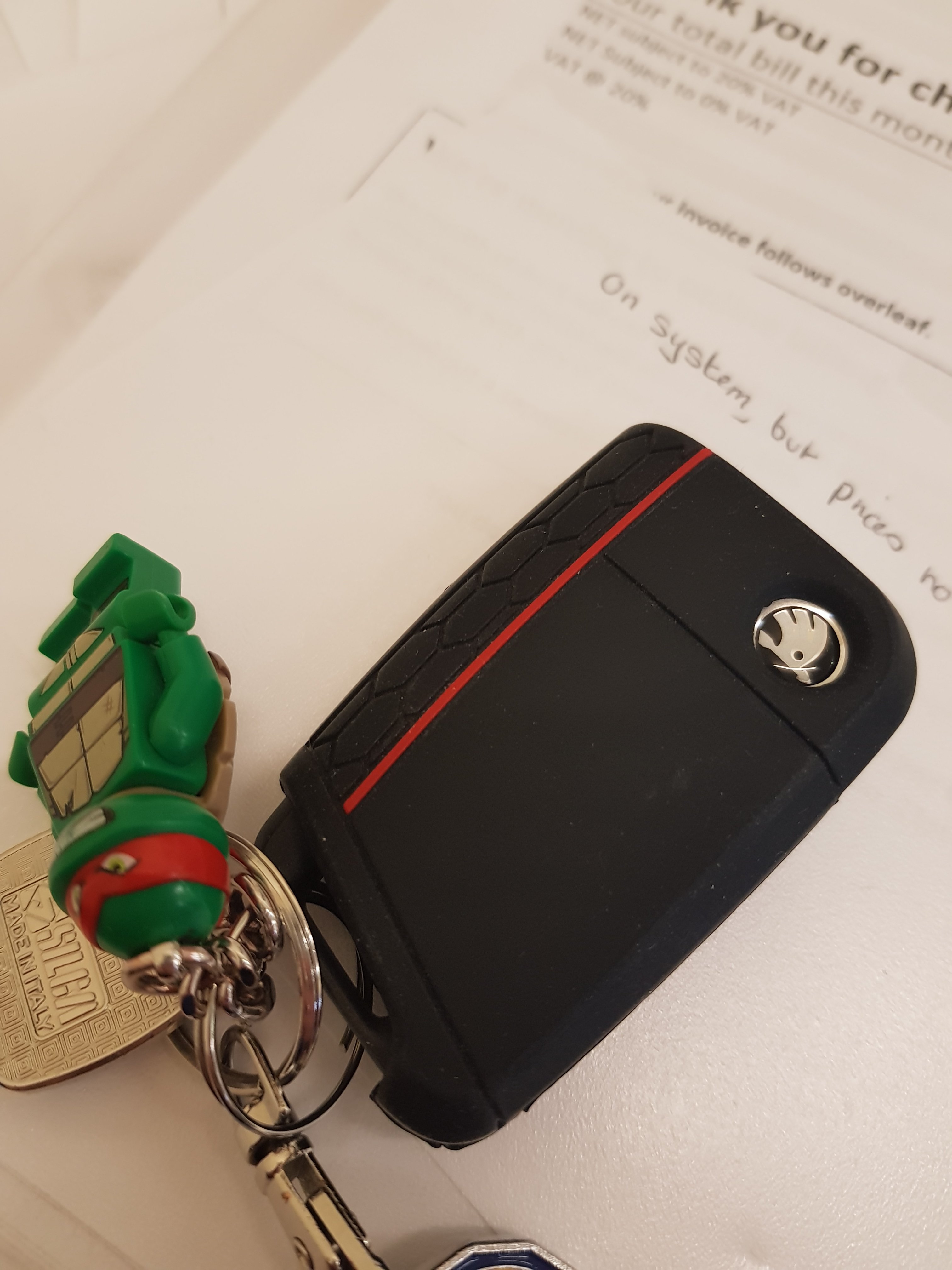

13 hours ago, Baillie said:
Brilliant thread! Ordered myself some chrome key ends and silicone case that I didn't even know I needed! :D
Do all Octavias have the personal key thing (setting mirrors etc)? If so, then I'll be getting a couple of silicone key covers to differentiate mine & Mrs Statto's keys

My MK3 FL came with 3 keys so after reading Sasha's post about the silicon covers I bought 3. Red, blue and black so now it's easy for us to pick up our own personal key with it's individual settings.
Also got a rear bumper protector and the led mega boot lights from Superskoda.
I was happy with the car as it was but reading all the things Sasha altered I just had to make a few minor changes !
