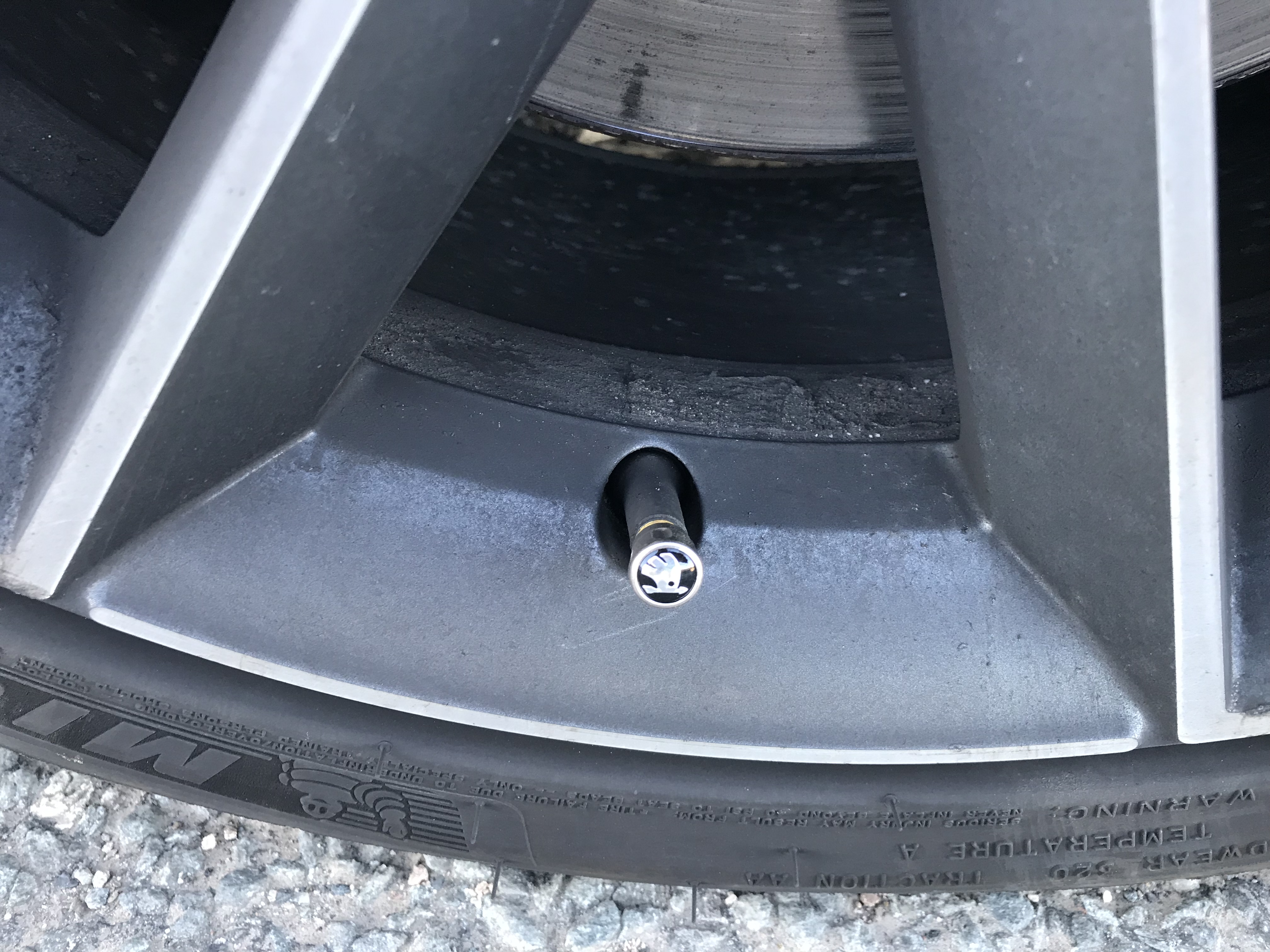

As the weather was nice over the weekend, I finally got around to fitting the valve caps I bought ages ago!

Everytime I see someone post that they have valve caps like those, someone else also asks “have you greased the inside of them?”.  I believe they have a habit of corroding and ‘welding’ themselves to the valve itself making it damn near impossible to remove. One of the reasons I’ve always just rolled with OEM black plastic ones.
They are OEM Skoda, slightly up in quality from the cheapo ones, but yes I have greased them and I’ve had another set on the Citigo for 13 months now without issue. I’ve never had a set of metal valve caps weld to the valve yet, seems to be a problem that is more heard about on the internet than actually experienced.
It’s to me and to my neighbour. We both managed to get them off eventually but it was annoying.
I had it with some a while back had to get new Valves all round luckily it was when I was getting new tyres. It's the salt reacts with the Ali in the valve caps and the brass of the valve you get a battery effect and it corrodes like a bugger
Greased, cleaned mine and took them off every 2 weeks or so and last year the rears welded on solid, so had to have the valves cut off and have gone back to dull black plastic to avoid the hassle and these don't get pinched.
I must be very lucky, it’s honestly never happened to me. If it does, it does and I’ll deal with it. Got the spare in the boot and my local fitter charges £8 to change a valve so it’s no biggy. It bothered me that I had them in the house and they weren’t on the car so I had to fit them :)
My sister saw some nice black hand grenades and bought me a set, I never gave it a thought until time to check and pump up the tyres :sweat: I had to get the Costco tyre bay to remove them for me :D they had welded on a good un, luckily I needed tyres at the time.
ironically this happened to me.   :dry:  i havent attempted to remove them. ill probably spray it with rust blast or something similar to break the corrosion.
Good luck with that. I drove around for a couple of weeks with wd40 going on and trying even with 2 pairs of pliers with no luck. But I didn't know about greasing them first.
hopefully the rustblast will 'eat' the corrosion ive taken pliers to them but they wont budge.
Your local tyre bay can chop off the valves, break the bead and refit the valve without needing to rebalance the wheel.
These caps sound like more hassle than they are worth :sweat:
Shame as they look good!
The set on the Citigo have been sound, I am hopeful this set will be the same. If they aren’t, they aren’t. I will take them off if I ever have one get stuck and join the ranks of people who’ve had one get stuck. I must just be lucky!
