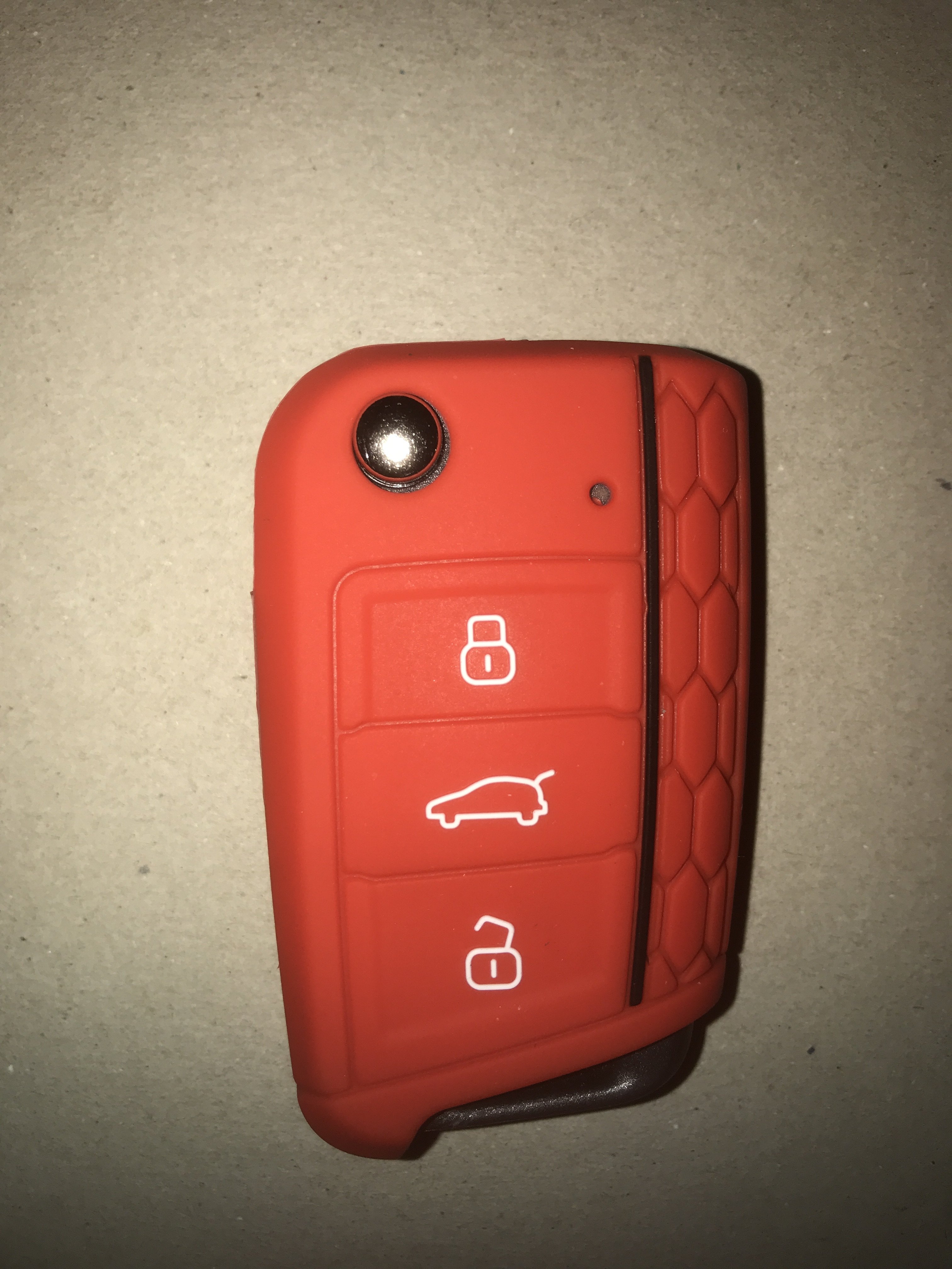

Exactly like mine. I have a black one, with a red line too, for a spare. This silicone feels so nice and gentle, I like it. Easy to wash and good to absorb impact on fall.
The only minus is some people laugh. Well...

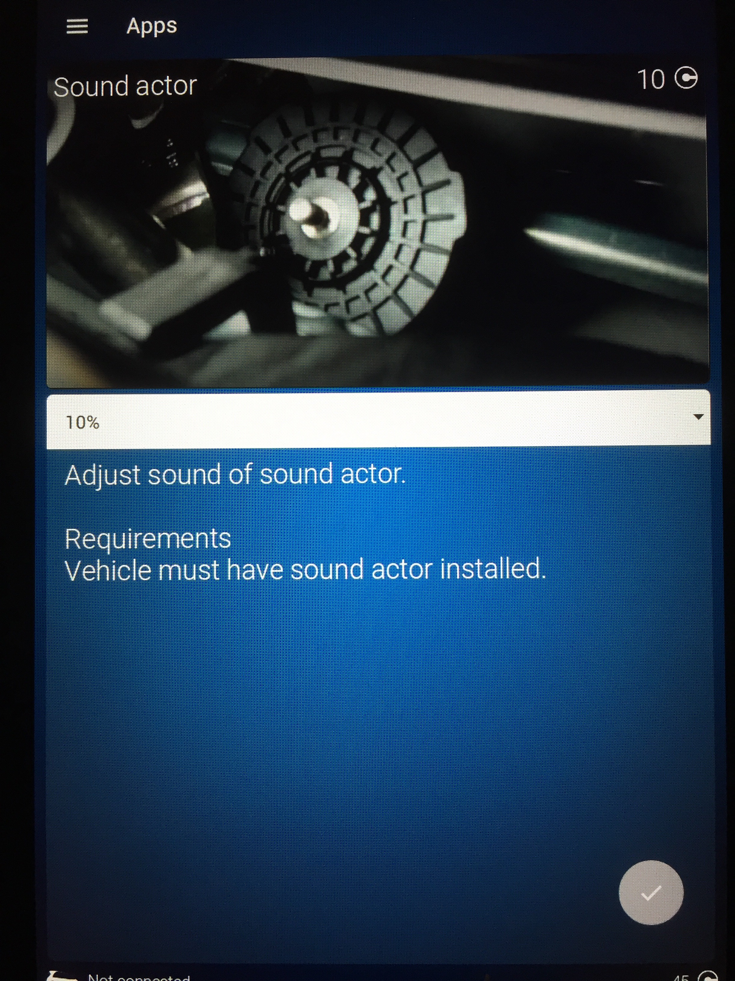

are you able to decrease the sound actuator using the obdeleven?
misses doesn’t like it when I use sport mode. Thanks
Yes you can, not sure how though. Think it has its own module to access to set the volume. I’d love to turn mine off in Normal mode only as I find it boomy whereas in Eco it’s fine but I get better MPG in Normal (now I’ve given it a fair test) and as mine is DSG I’m not a fan of the way the coasting mode works. I’d happily leave it on in Sport though. I think it’s just a set volume you can change in the settings though.

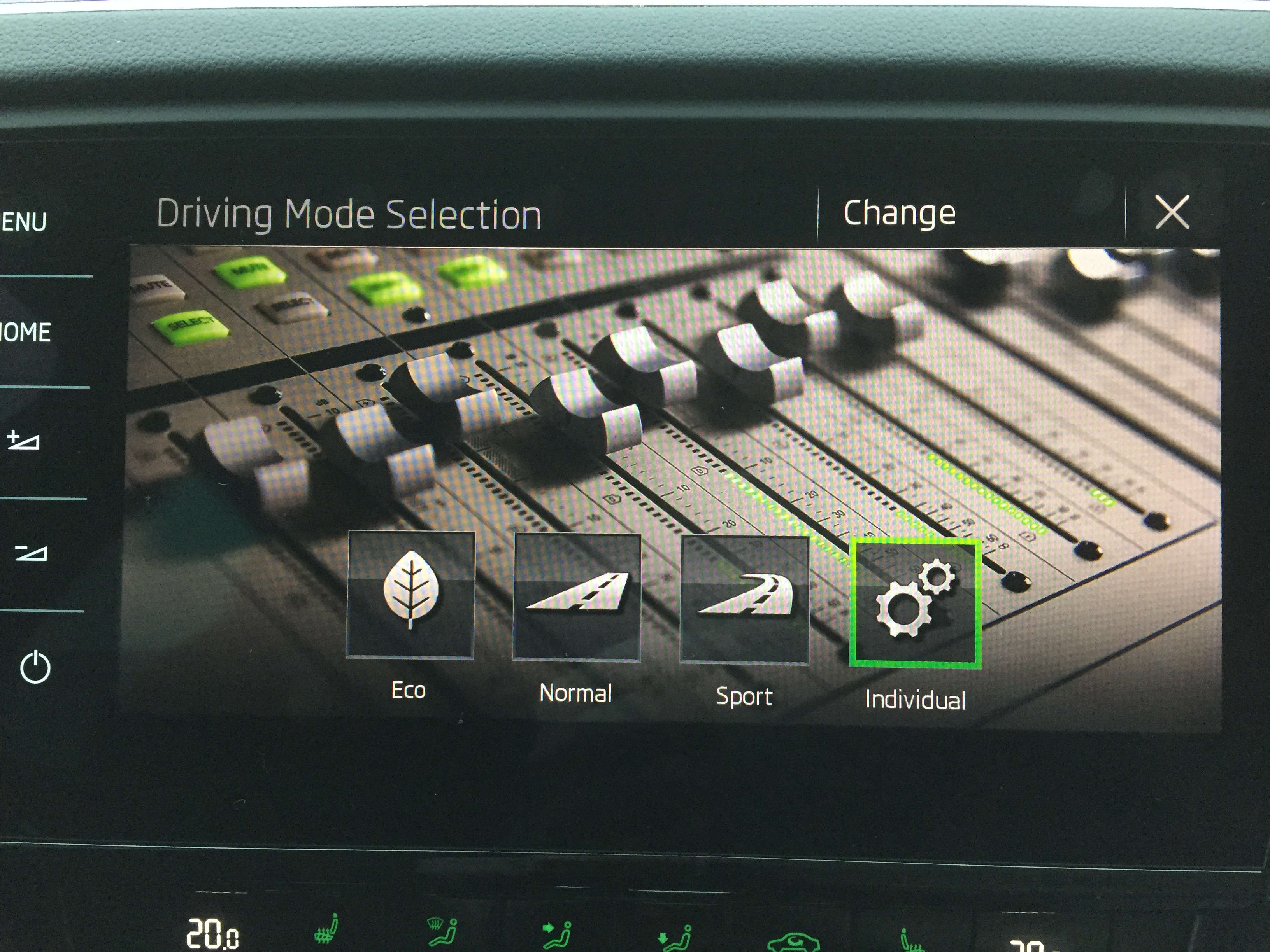

Yes you can change the sound with the OBDeleven. Think it was 10 credits if you want to do it the easy way. Or just press your vRS Mode button. Select individual then at the top of the screen press change. Set everything to sport if you want but choose ECO for your sound option.
Edited by Ozzy25
The easy way?!? It’s not even difficult to do by yourself.

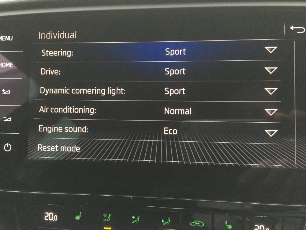

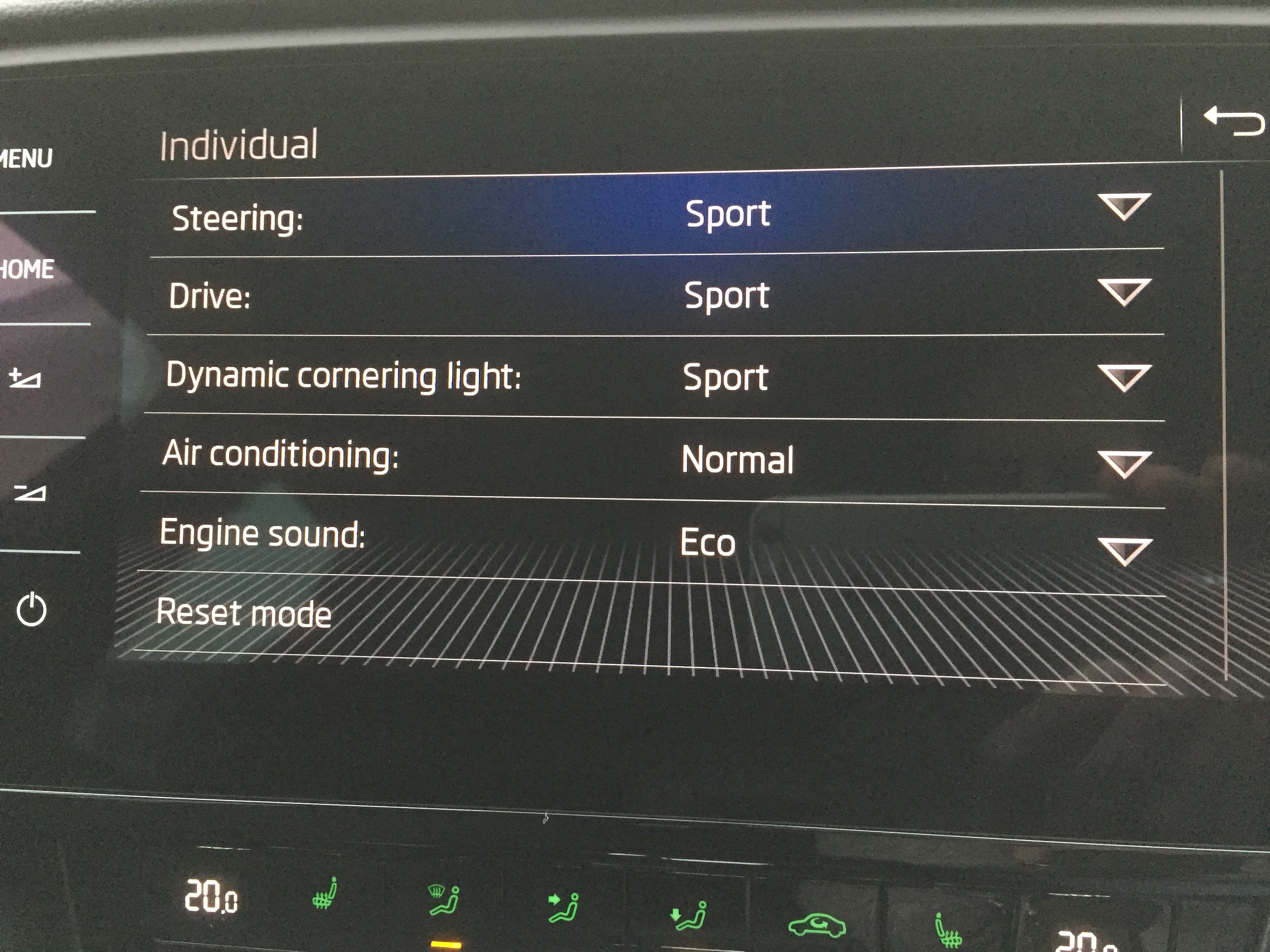

My car doesn’t have a sound option, only an engine option which is annoying as I wouldn’t mind the engine being in Eco, but not the DSG gearbox, I want that in Normal.
MIB 2 feature onwards that one :) sound is tied to the engine setting on MIB1 cars.
It's really simple to change the soundaktor volume; it has its own module and there's only 1 adaptation setting which is the volume. Makes sport and normal much more bearable and less boomy. I set mine to about 35%
I thought it only had the one module, is it the A9 module? It’s on my list of things to change. As is adding footwell lighting, doing full LED interior light conversion, LED plate lights (though I am going for the proper VAG modules) and a few other bits and bobs. First thing though is to fix a niggly fault that has appeared. Damn boot release is playing up and the car occasionally tells me the boot is open, then the message goes away, then comes back and the cycle repeats. It’s becoming a royal PITA so that’s front of the queue on the fix list!
Yep, A9 module and the adaptation is "volume of structure-borne noise actuator".  Footwell lighting is a fun retrofit, give me a shout if you have any issues with that. I had to ignore part of the coding suggested in the main thread for the footwell retrofit otherwise I had an error when I scanned the car. Hope you manage to get that boot issue sorted, sounds like a pain.
