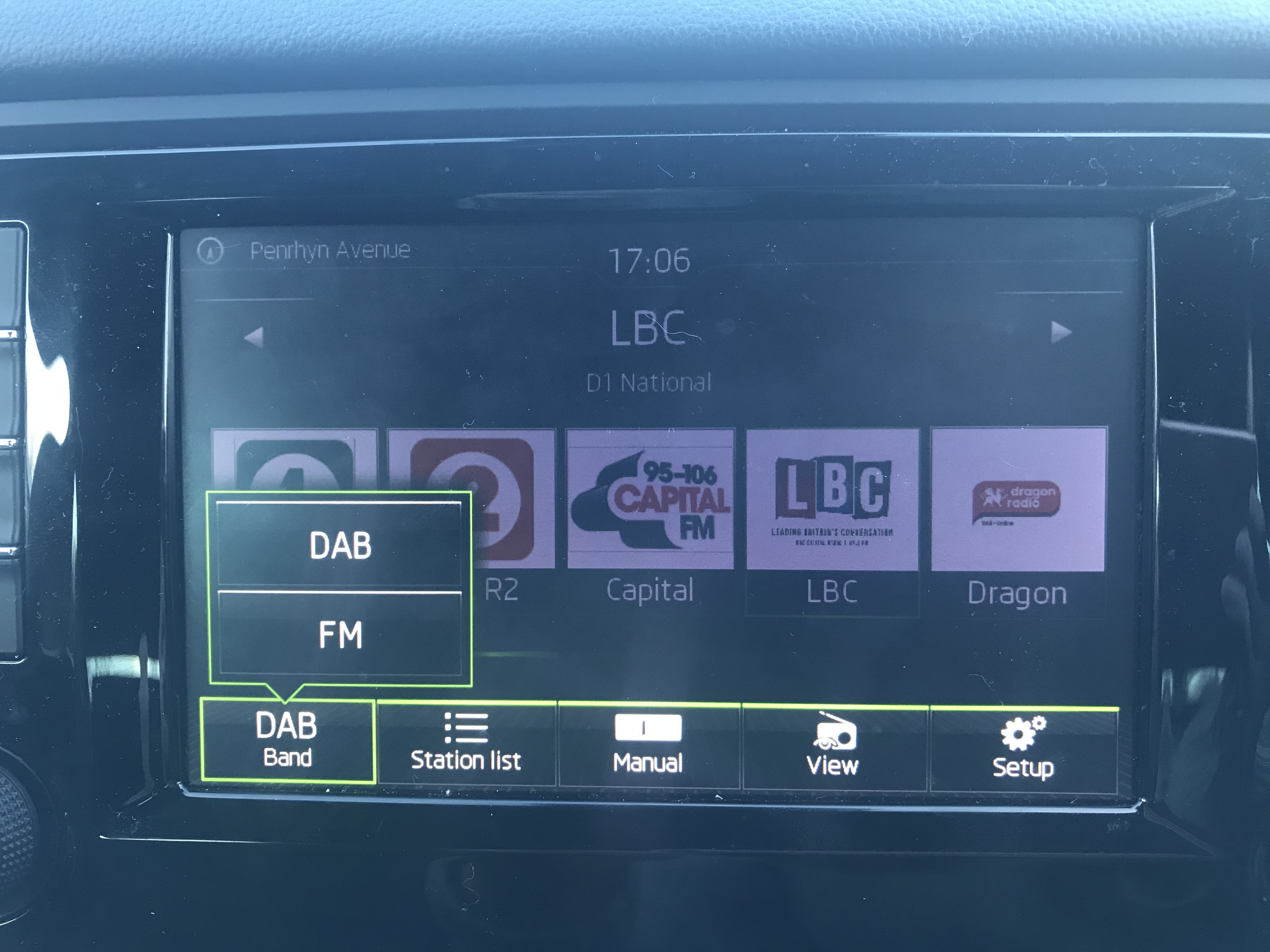

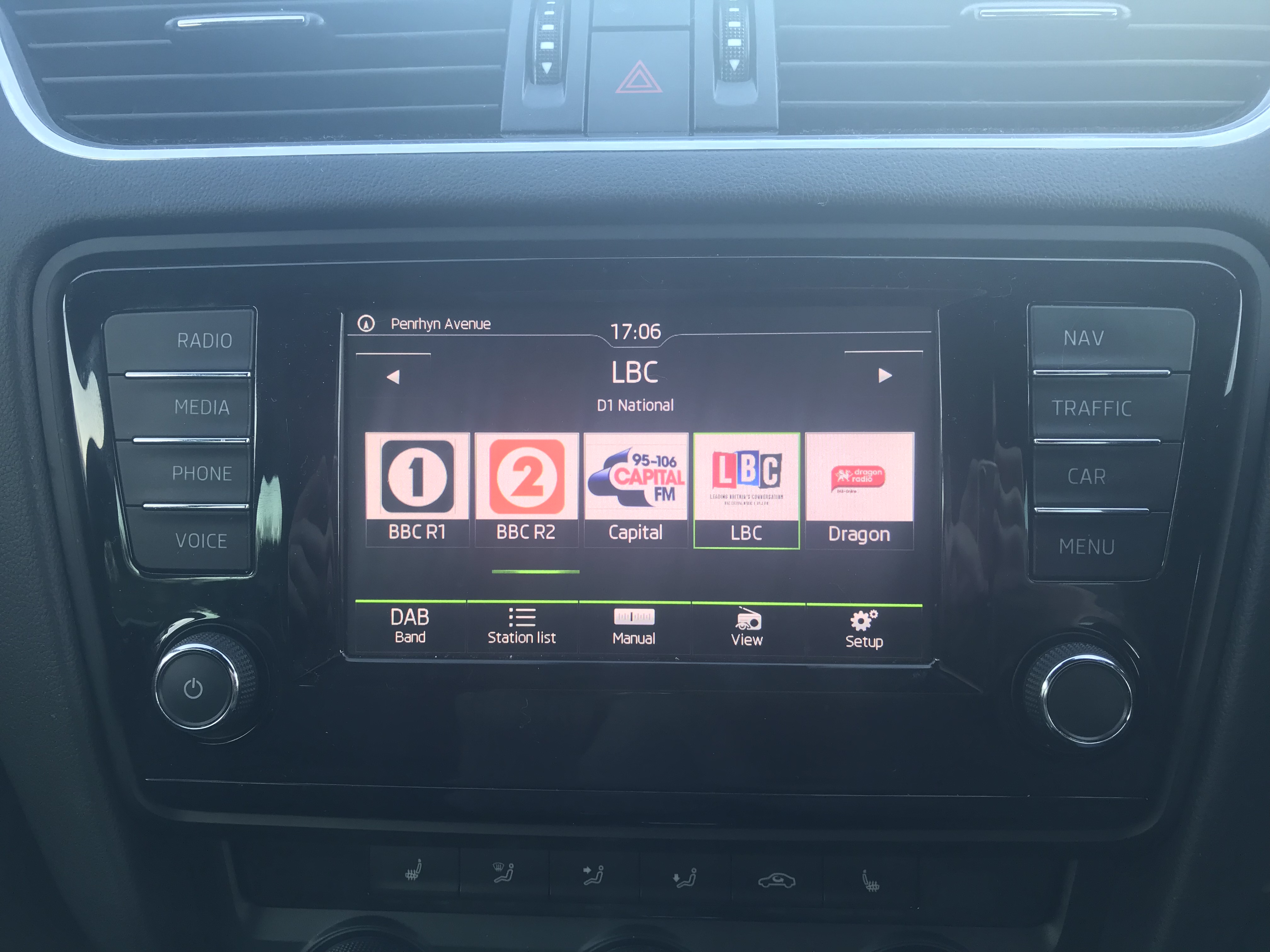

I forgot to post updated radio logos pictures, so thought I’d better had now I’ve sorted them all. Must admit, they are nicer now :)
Had to deactivate the AM band again (waste of time having it so I don’t want it)

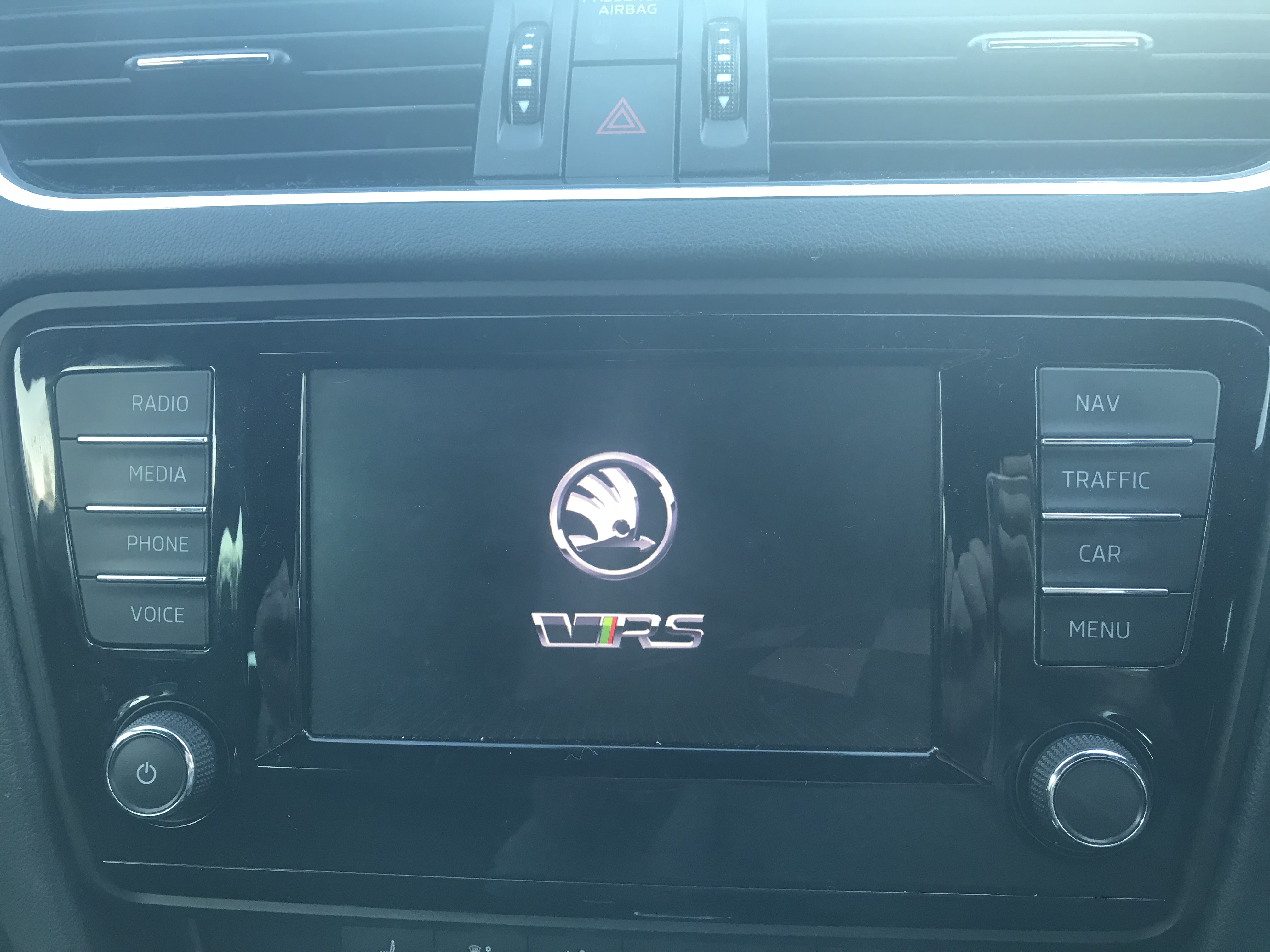

and managed to catch the vRS start screen as well

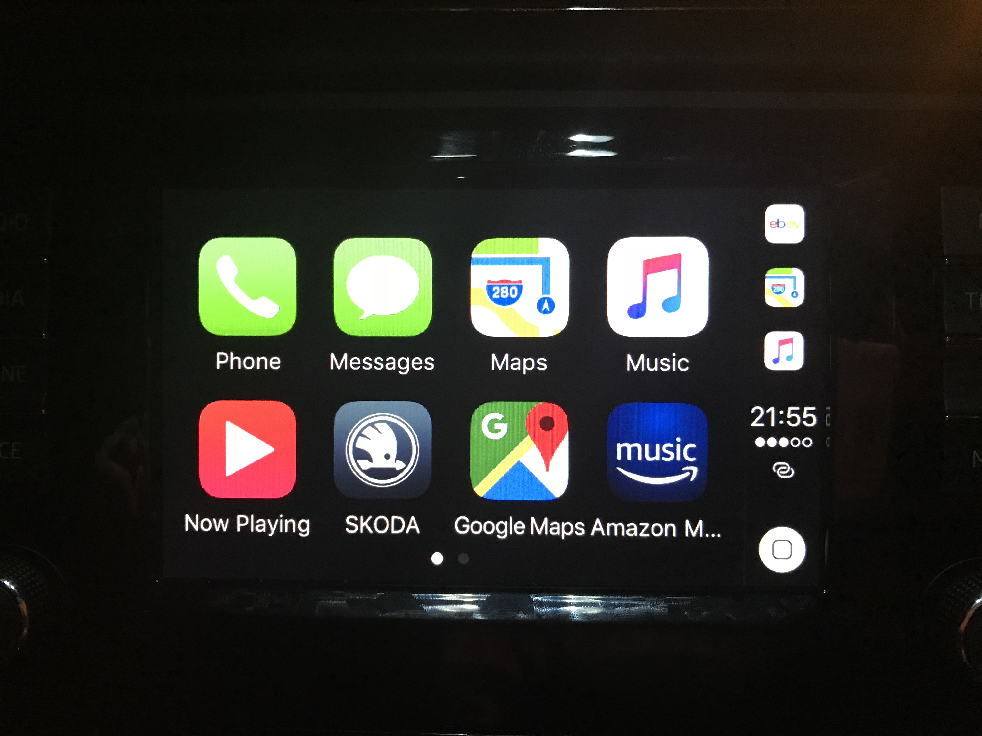

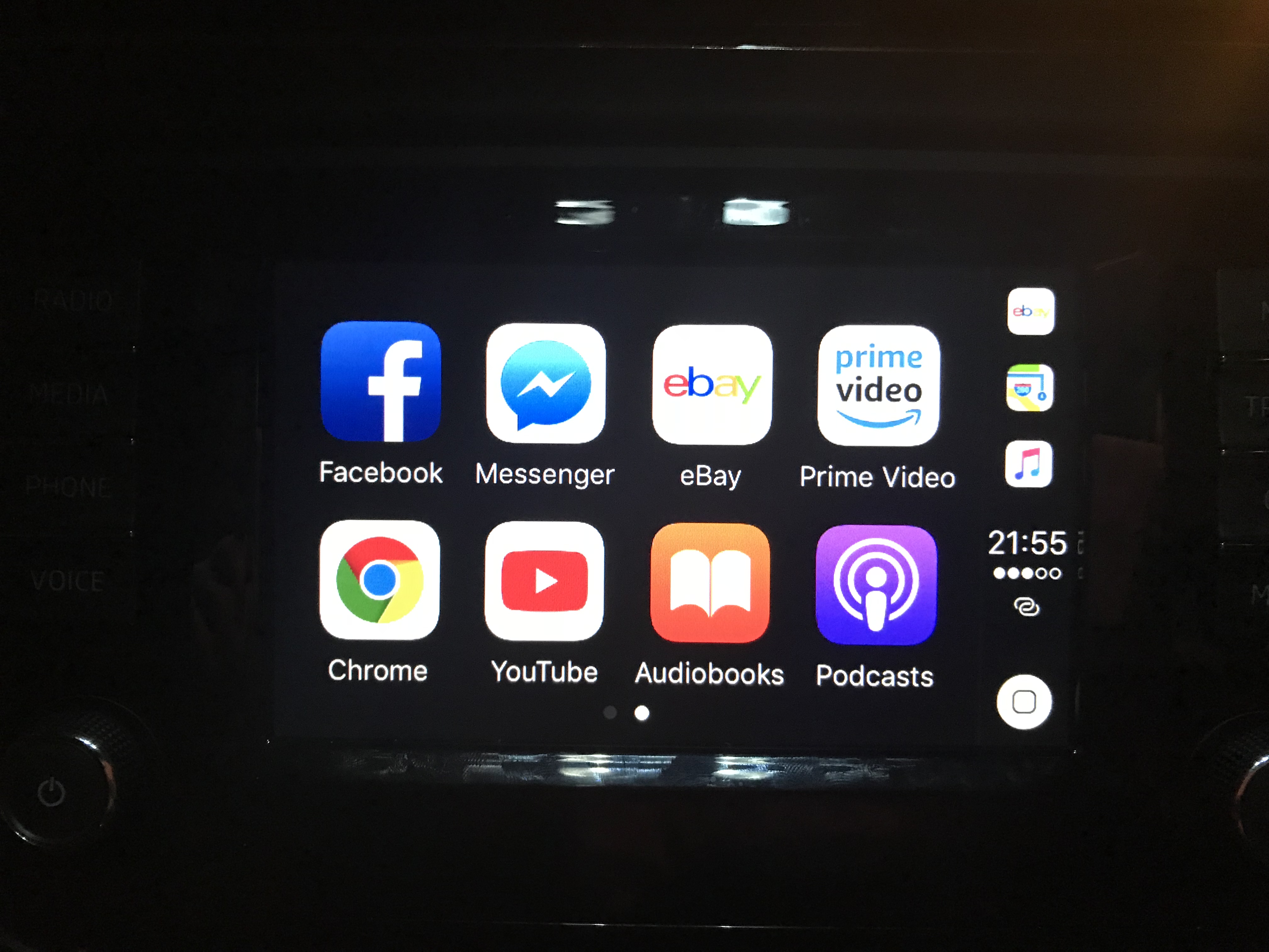

I intended to have an update with the towbar but my laptop is busy updating so I’ll throw the pics on later when it’s light. I have found my old iPhone and jailbroken it though, quick teaser of CarPlay with some extra features courtesy of NGXPlay. Some for stationary use only and others just for a laugh :)
Need to sort the screen ratios out on some of them in the morning, but they’re all there :D

I take it the only way to get the google maps is to have the iPhone jailbroken?
As far as I'm aware yep, only way. I have not jailbroken my everyday nice phone, I got lucky and remembered I didn't sell my old iPhone and it was still running iOS10.3.3 as it hadn't been touched in over a year so I could jailbreak it and run NGXPlay for a giggle and see what's what. It was certainly handy this morning to watch Paw Patrol on the screen to keep my son happy :D

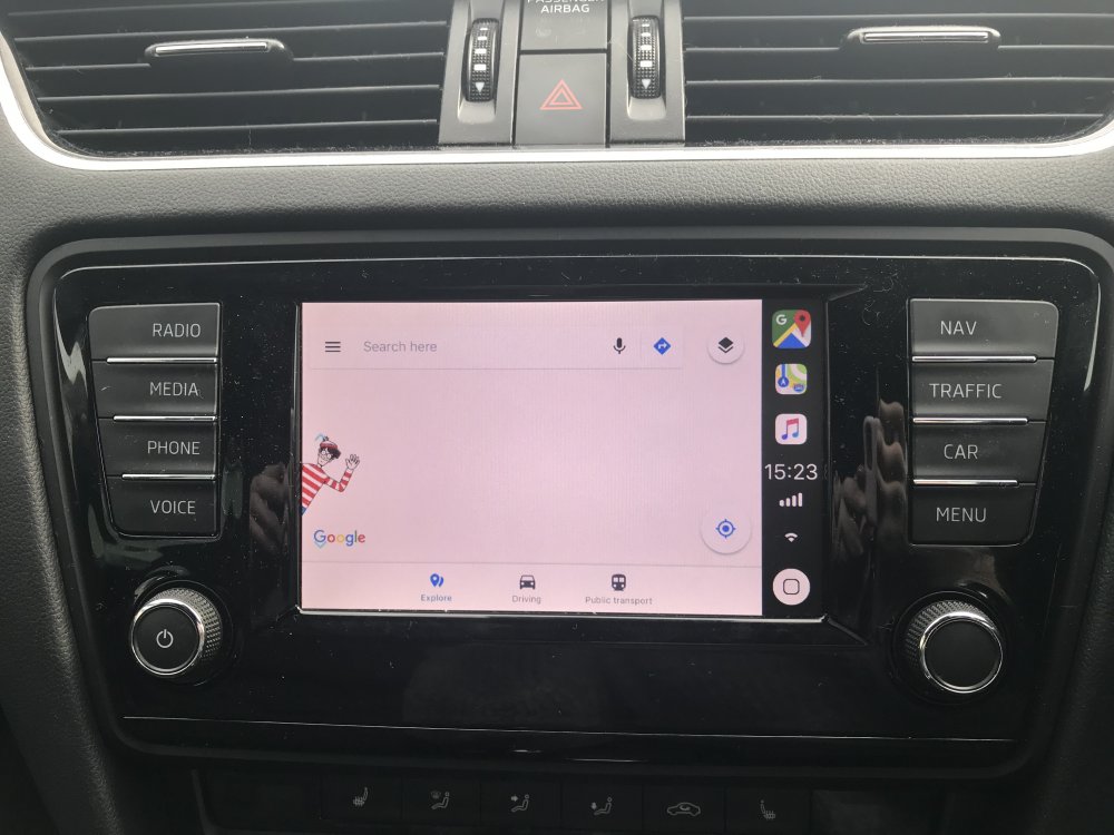

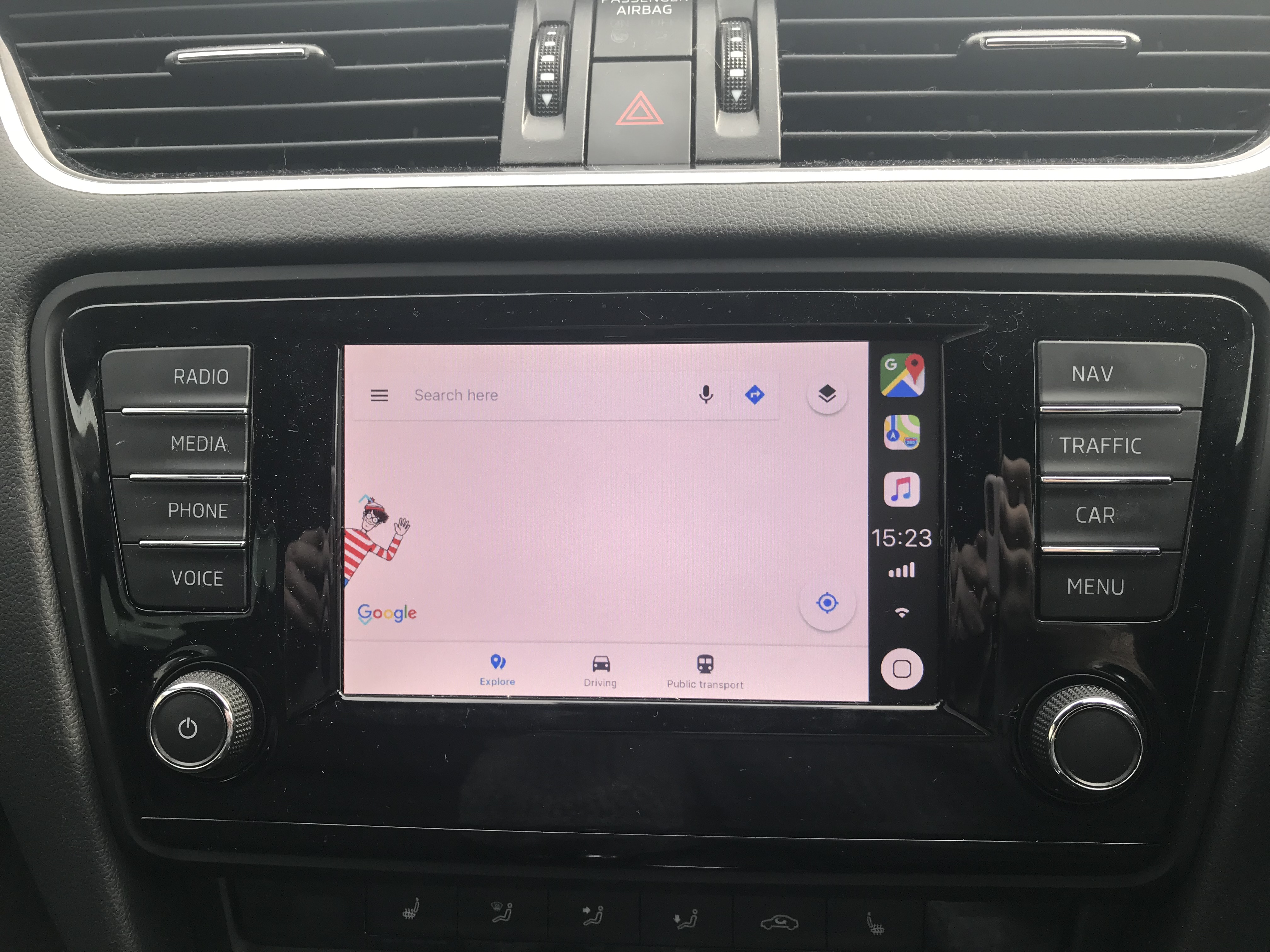

Just to show the Google Maps running :)
Currently in the process of jaibreakibg my old iPhone to use Waze on the phone
Yeah you can use waze too. I have just tried google maps properly and it has crashed the phone once, PITA being on iOS10.3.3 it’s probably a bit of an old firmware. It worked well otherwise and setting it to Native and then ratio to 1.5:1. 1:1 doesn’t work so well.
