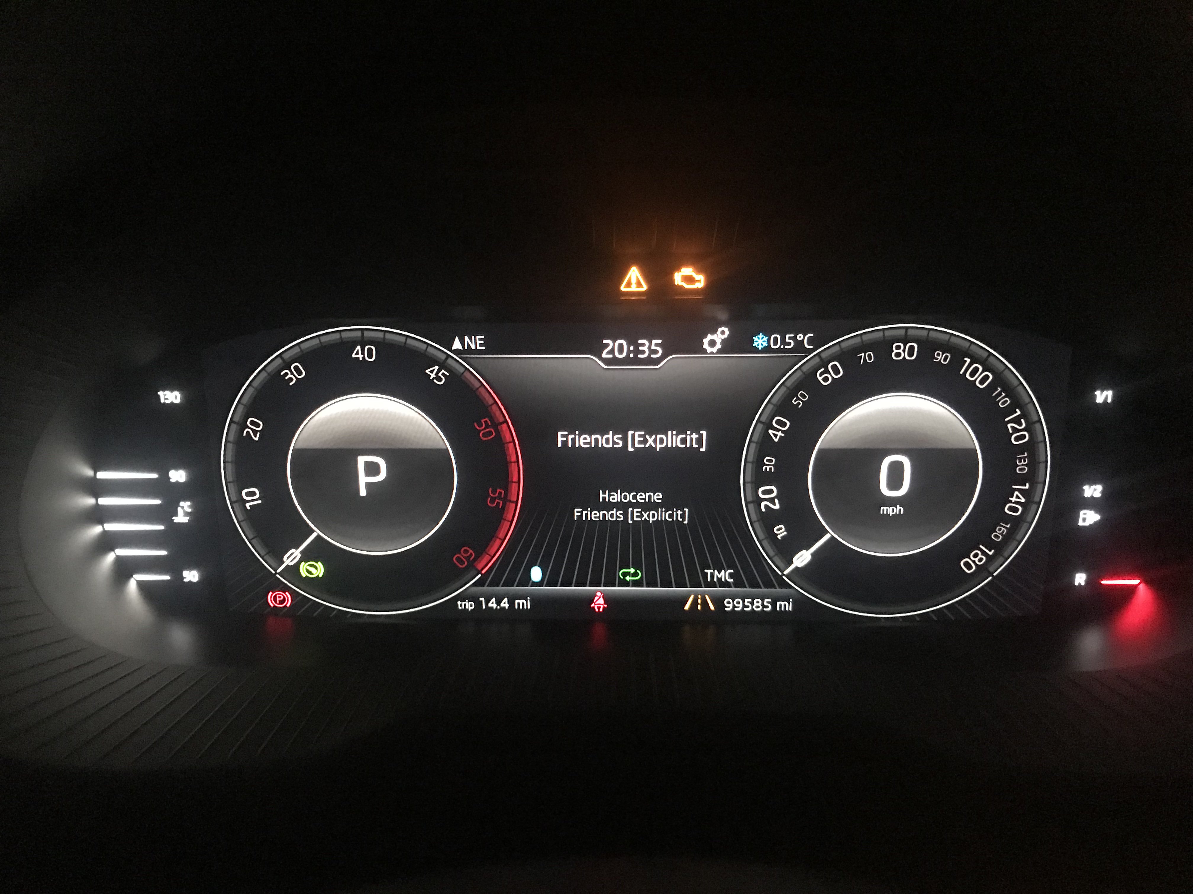

Talking of things that are done and working, barring a few things I need to sort, the virtual cockpit is in the car!!!!!! B)
10-A1557-F-BB15-4781-94-F5-E8-D9-FCE9225
4-A259-F9-B-B107-4729-937-B-830-A39525-A
0-BD56-A73-D809-4-B00-9914-D4-A17-C5742-
6-D669-D6-D-0-E17-4390-93-C7-FD316-D35-C
479-BAC08-09-CE-4-DA1-9-DDD-28-D6286-F76
Here’s how it came out of the dealers functions wise, no lane assist, no cruise control, left hand drive setup, only 2 menus on the centre display and a hatchback on the display etc etc
And after a bit of coding, making it up as I go this is what I now have
I suspect the reason I need to change the CAN Gateway is the fuel gauge issue. This is prevalent on early Golf 7’s with this retrofit and I guess this is why I have no fuel gauge for the time being. The dealer computer refused to even go near the 3V0 Gateway! I also noticed that the dynamic roadsign display fault doesn’t make a warning bong anymore, it just flashes up and goes. I need a scan of a car with a virtual cockpit to try and see what else needs coding as there are a lot of bytes that are 00 and the coding from my old cluster doesn’t copy over. I have a Skoda startup screen, not vRS and no needle sweep etc for now. Despite all that, I’m really stoked with it! Can’t wait to get the rest of it working. Also need to trim the top of the dash behind the cluster as it doesn’t fit quite right. Still freaking awesome though :D
Awesome work!!!
After following your lead with the reversing camera retrofit, I think you have just moved the bar significantly higher :D
Must. Not. Start. Looking. For. Virtual. Cockpits. :x:D
Well done :beer::biggrin:
Excellent work Sasha
Yikes. You've certainly got some big brass cojones to stick a virtual cockpit in and just hope it works out!
Now, if you can just sort out showing carplay on there, I'll be changing mine over too! I just can't stand the built in satnav.
Great update and the VC looks fantastic! Love the fact it's possible in an older and higher mileage car too... I wonder if you have one of the highest mileages shown on an Octavia with VC?!
On the fuel gauge issue, does driving data show the range left or does that not work either? Brave driving it if you don't have either indicator of remaining fuel, I'd be so paranoid I was going to run out!
excellent work! id love to see the process but id guess this is one mod you want to keep to yourself
Edited by JohnnyType2
I didn't like to mention the top speed again as it seemed to upset someone before. However I can confirm your tractor is officially now quicker than a certain VC equipped Vrs245 (oops hope he's not reading this):tongueout:
Would VCP have been able to code this?
Peter’s seen it on Facebook so we’re all good :) I’ll send him the coding to change the display as the 10 mph increments are a handy touch.
Not the mileage and immo etc, has to be an online version of ODIS-E connected to Skoda in Germany.
You've got a VERY helpful dealership!
Yes I have, they are brill and best of all another £0, no invoice bill to get this working :biggrin: Massive shoutout to Karl and Russ from Sytner Skoda North Wales for helping me out again!
