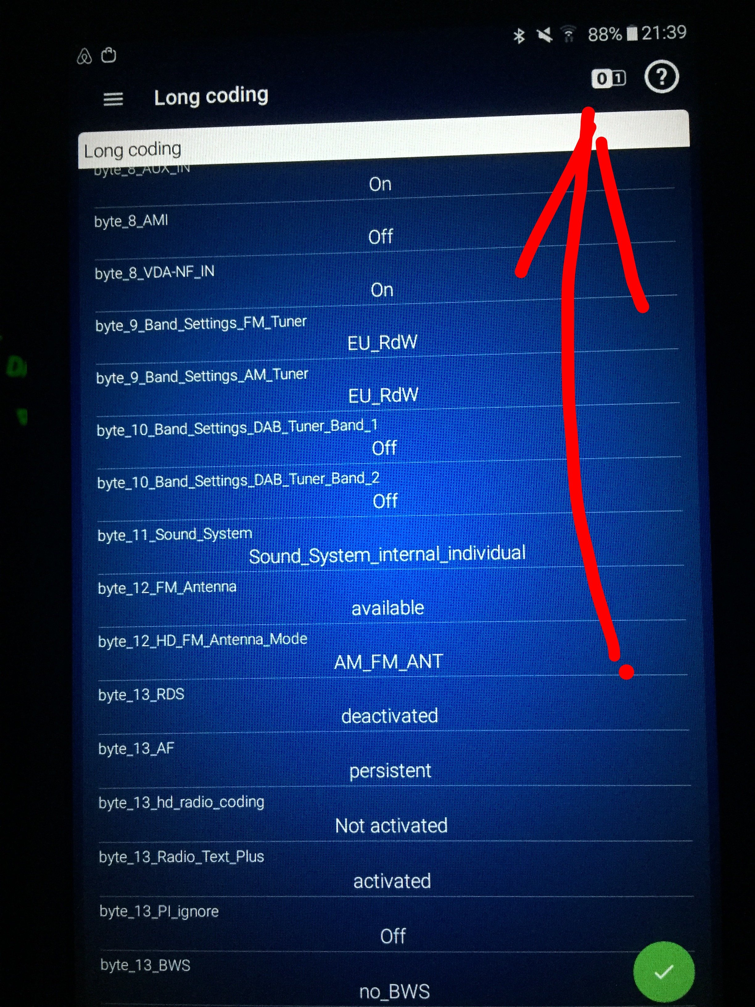

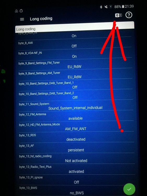

Is this likely to work on all factory fitted setup? I have the Columbus in my car. I did plug in VCDS, however am the first to admit my skills and knowledge of product isn't great - I couldn't see how to "Byte 11 change to Hex04" for example - if that could be explained in more simple terms?
I did go to the said Byte 11 in 5F Infotainment, Long Coding - however simply saw the following options:
I did try selecting the 04 byte-11.....from the drop down and coding back, however after completing a factory reset on "Audio" from the main settings nothing new appeared.

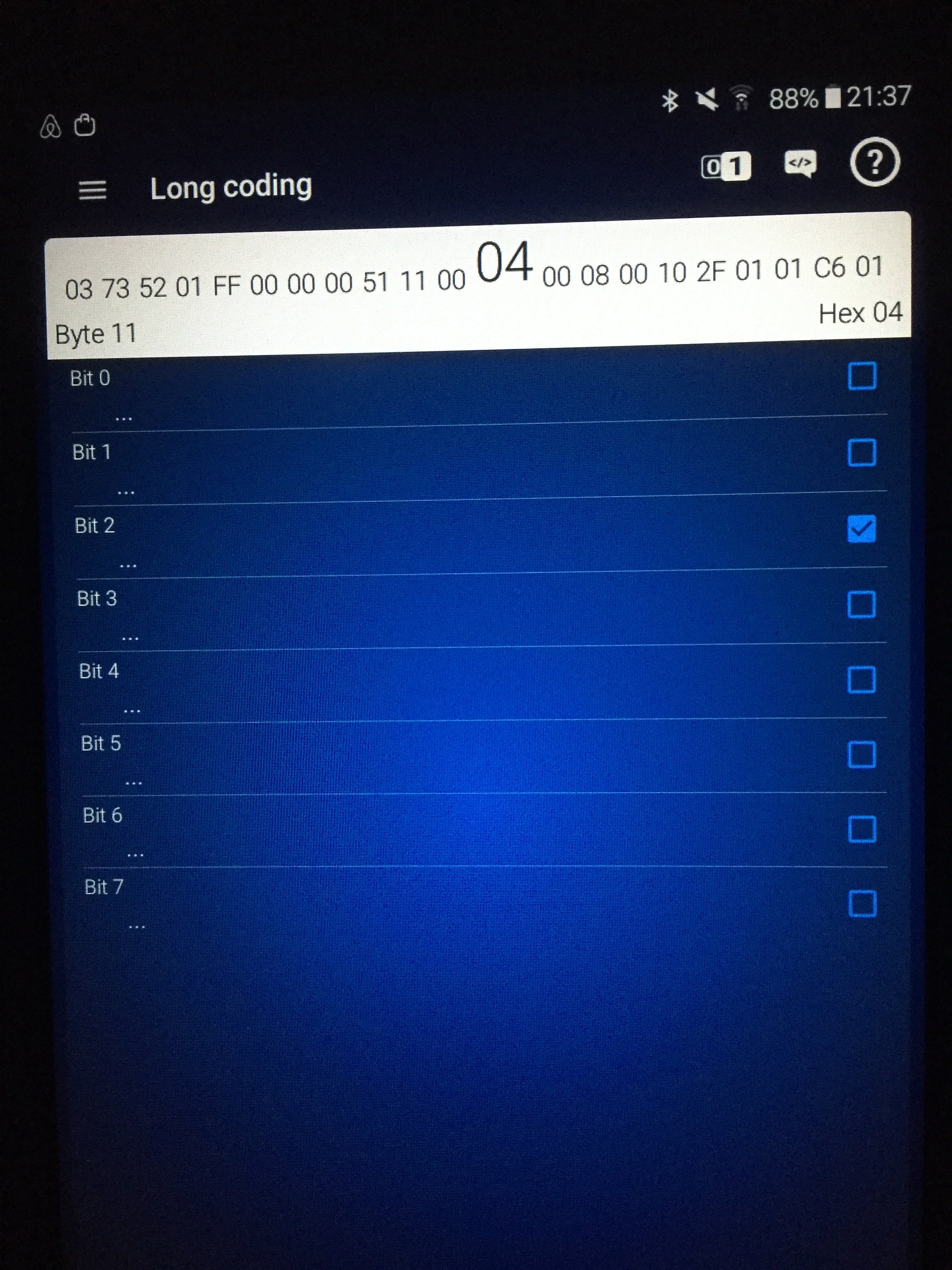

OK, for us computer Biffs who want to try this with OBD11 on a Facelift vRS. Click on 5F Infotainment then click Long Coding.
Then on the next page click on the top right corner on the 01.On the next page use the right arrow at the bottom of the screen to move along until you see Byte 11 at the top left of the screen. The box opposite Bit 0 will be ticked. Untick that then tick box opposite Bit 2. You will see Hex 04 is now displayed on the right side.
Now press and hold the power button on the head unit until the screen goes off then comes back on. Then click on Media then Settings and Sound. 2 new boxes should be there for you to tick.

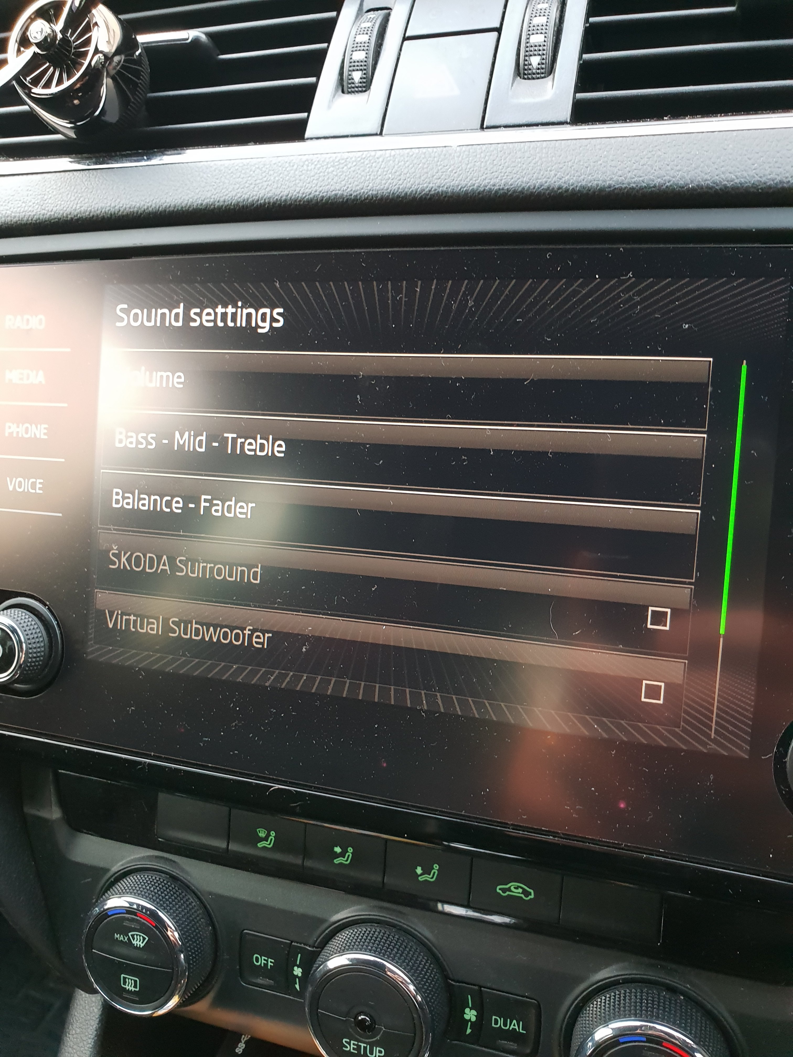

Hi all
I just tried to enable the two functions as above and managed to make the changes to byte 11 ok and,
after resetting the radio, (MIB2 Amundsen) both the new options appeared in the settings menu, but they are ghosted and obviously unselectable.
Using OBDEleven by the way..
Anything I am not doing or idea why they would be ghosted out?
Cheers

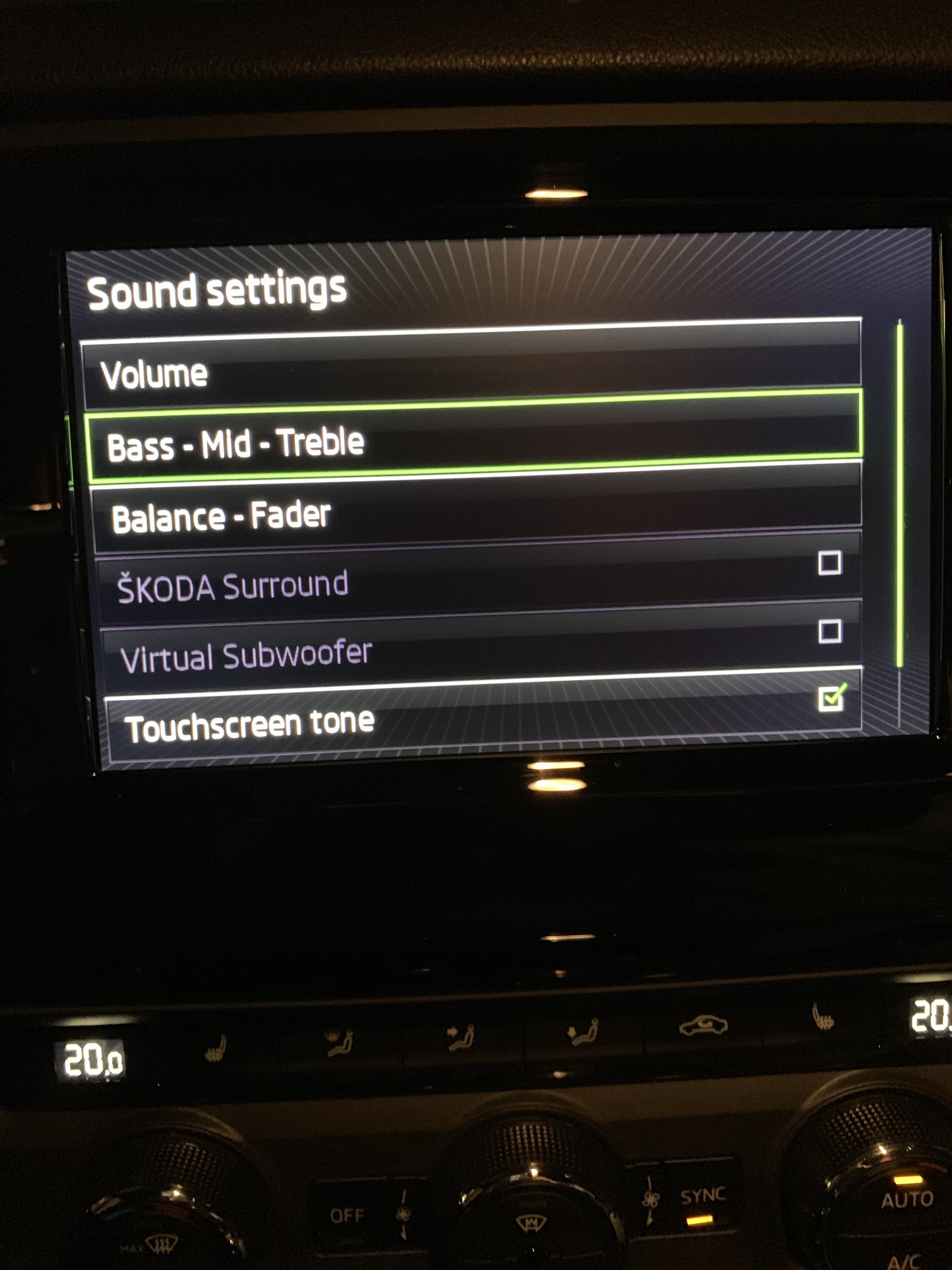

The bottom one on mine was ghosted and was only selectable once I ticked the top one???????

Mate are you accessing the menu from the main sound menu? For some reason if you access the sound menu from a source you can’t change it. To change it scroll through all the tiles on the horizontal menu until you find the sound setting tile, they shouldn’t be greyed out in there.

Yup - just to confirm on my Columbus - one of them was greyed out until the other had been selected, then you could check them both.
Cheers for the replies
Yes I was accessing the sound settings in the main bit rather than from a source and they were both greyed out. Neither would let me put a tick in the box.

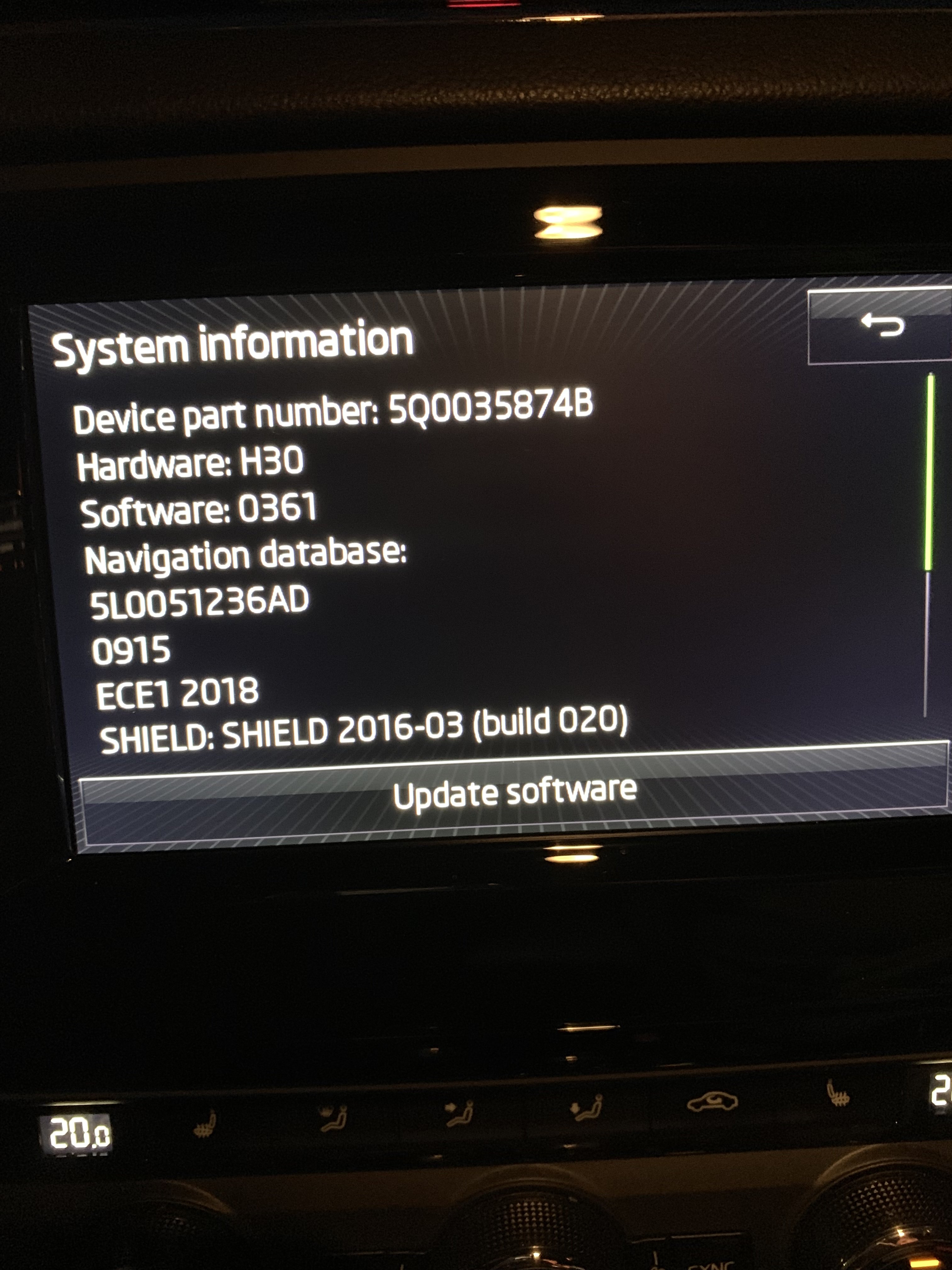

Is it maybe a firmware version conflict?
It’s a MY2017 vRS TDi, just before the facelift, if that makes any difference.
MIB2.0 rather than MIB2.5.
I’ve put it back to original, but will give it another go shortly.
Just tried again but still greyed.
There’s always one!
See pic below.
Typical as I really wanted this to work.
I'm the same and in the sound settings from menu, its amundsen found it in sound settings in media tab  ...all good now working perfectly
Look in media and sound settings there, wont work in radio settings or main sound settings in menu only activates in media for me
As above, I went in through the Media setup and they work there. Double check it and then come back. You can’t enable the virtual sub setting without Skoda surround.
Sorted!
Same here.
Went through media settings first then appeared in main screen also.
Many thanks
Glad it worked for you :)

Success for me, not sure if I have done it slightly different. In the first picture, byte 11 I clicked on that then in the drop down menu it's 4 lines below, sound system internal individual was available to me on my attempt. I didn't change the page first as indicated in the top right corner. Still worked for me.

You can leave the switch on 0 and see the ‘long coding helper’ as it is in VCDS, or set the switch to 1 and see the Hex value as the top and just the bits with tick boxes. What VCDS does is list the Hex value in the long coding helper section so it’s a bit easier to do. The slider on OBDEleven is just showing that information separately.
