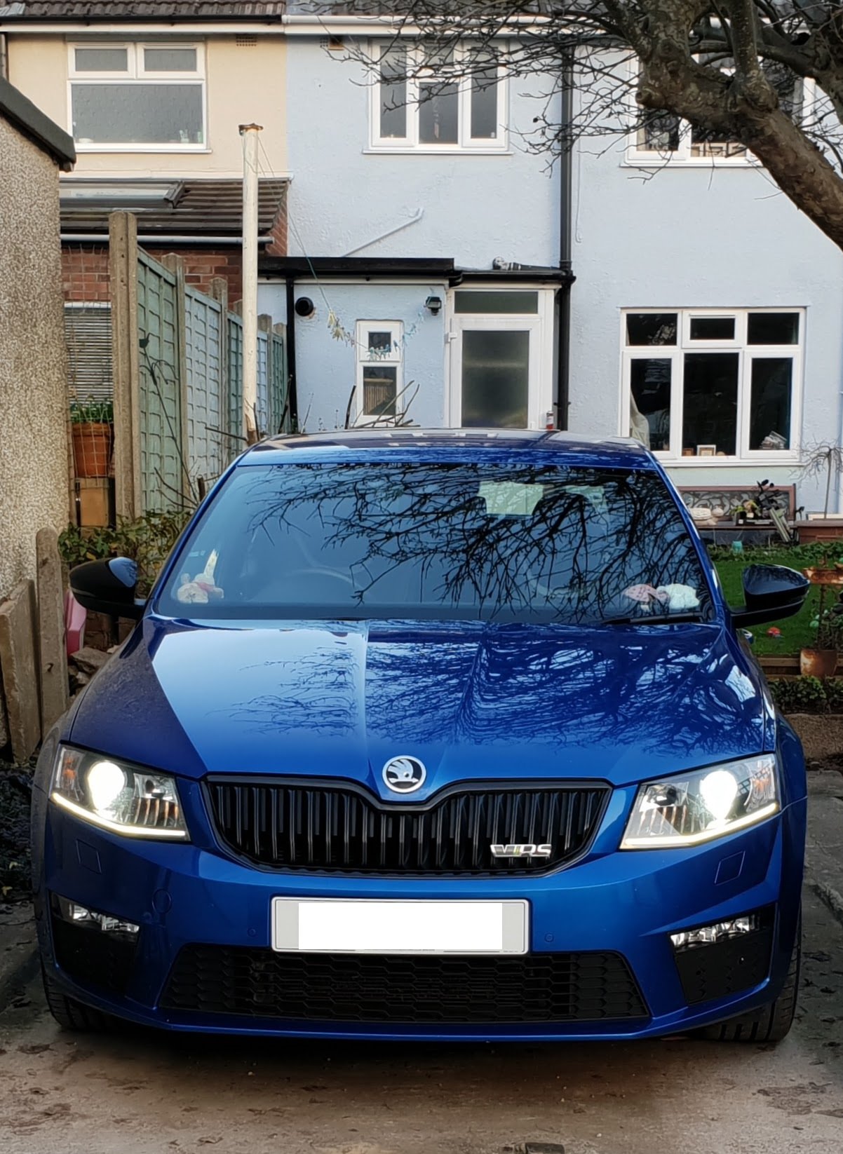

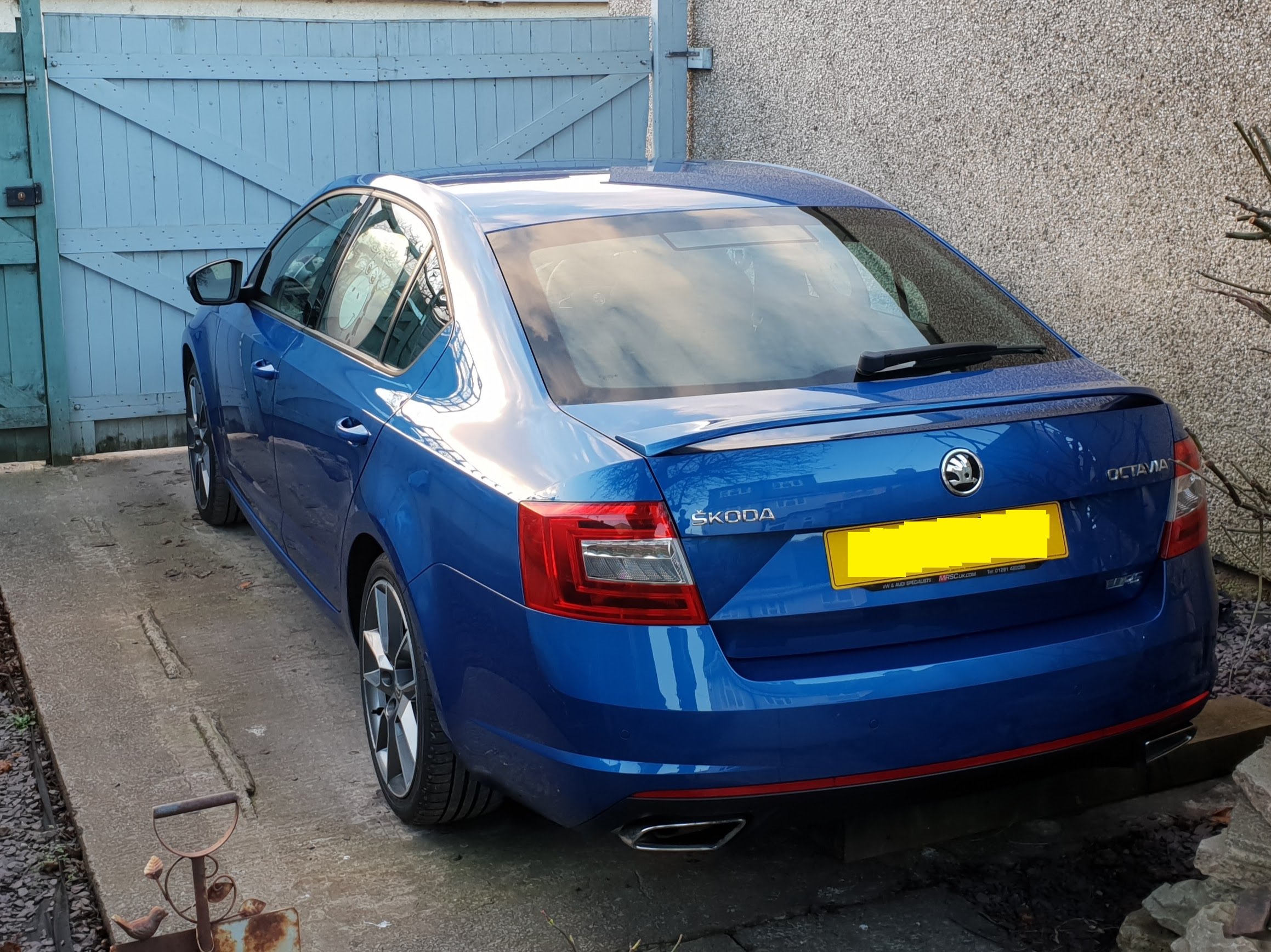

Woohoo, I am now officially part of the club! Drove it home from Caldicot and wow - it's certainly a step up from my 10 year old Civic. Onto the Sasha inspired projects...! :D

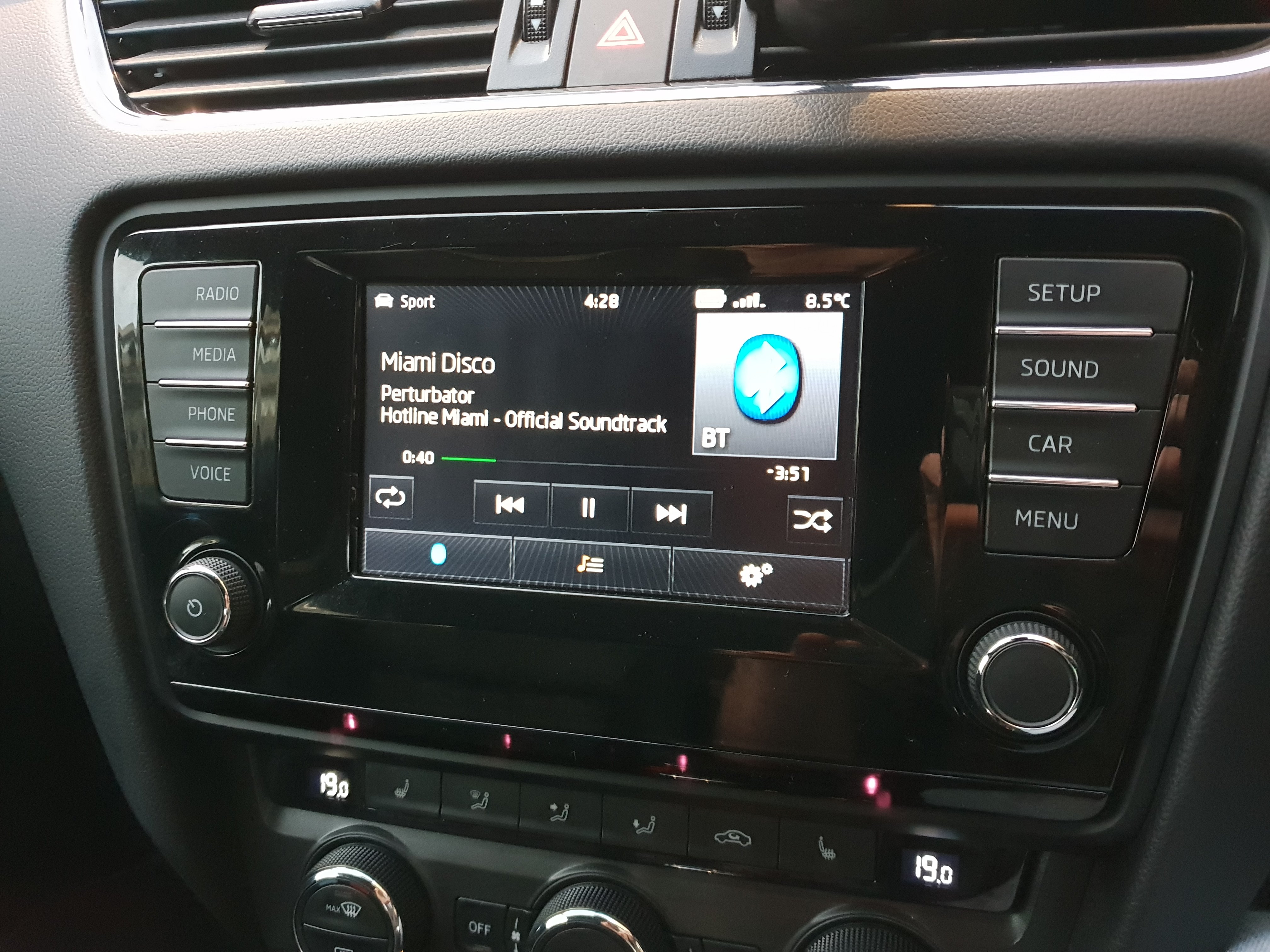

If it's ok, can I ask a couple of questions? Am I right in thinking I have a Bolero unit (see attachment 3)? What are my options to upgrade it - both official and non-official? :)

Are you looking to add Apple CarPlay/ Android auto?

Maybe, if it's an option. Basically it boils down to cost and practicality. :)

Like Sasha (with her help) changed from Amundsen MIB 1 to MIB 2. Effectively it’s very easy to do, you need to buy a Glovebox unit, new Screen and upgrade the USB port. Software wise is a little more complex. When you plug the new unit into your car you will need to remove component protection, most dealers are funny (I can recommend someone in Swindon) and then send the unit of to Poland to be recoded.
cost wise -
Glovebox unit - £100
Screen - £150 ish
USB - £35
CP Removal - £50
Coding work - £200 ish including posting to Poland
I managed to resell my old bits to make some of the money back.
