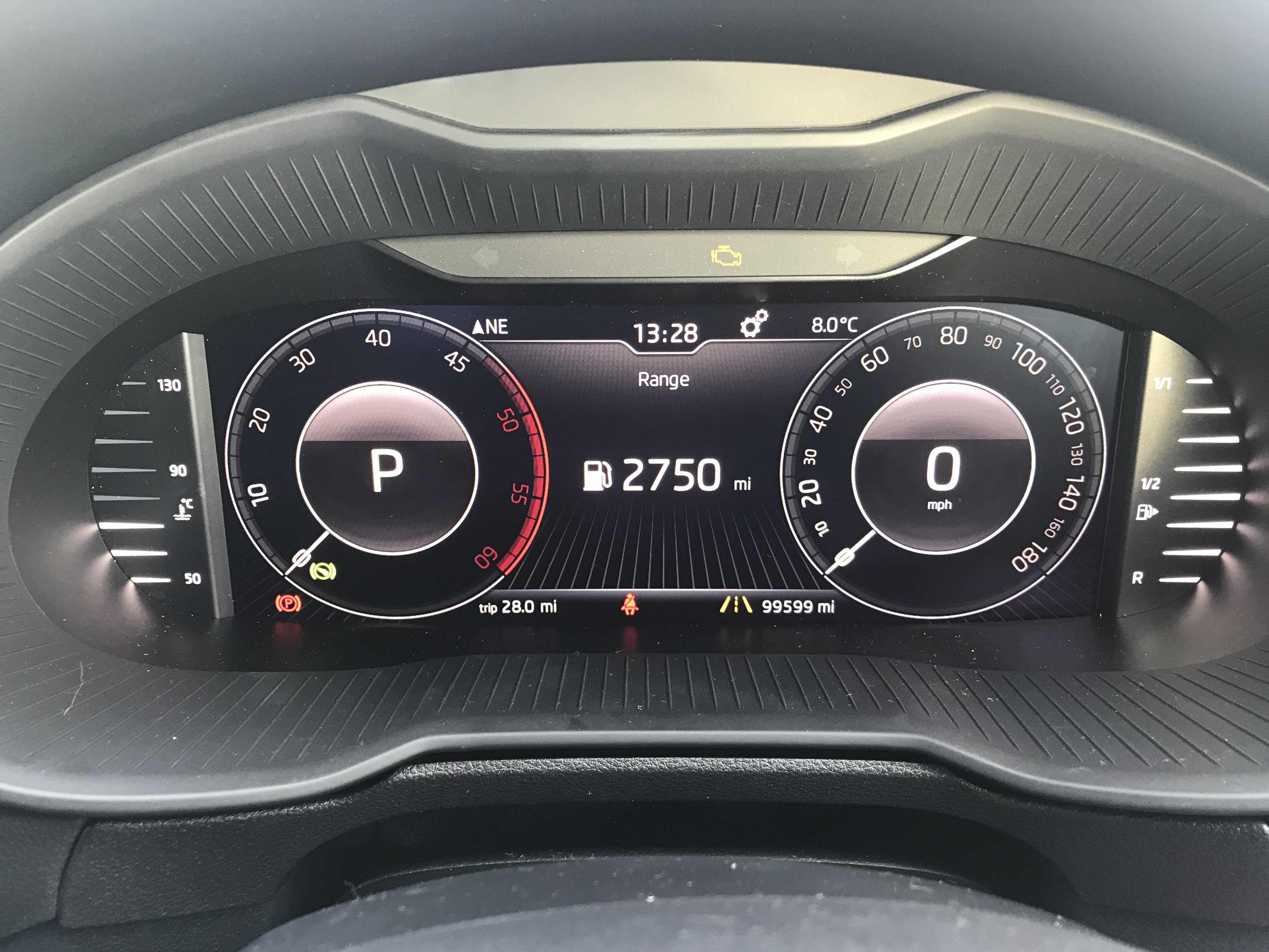

44 minutes ago, SashaGrace said:
I don’t want to jinx it, but I think I’ve fixed the fuel gauge issue! Range seems a bit out, but it’s starting to come back to normal (I hope!)
Ive been out in it and done 8 miles and it’s dropped from 2750 to 2120 so I hope it keeps dropping until it’s normal. At least there is no warning, for now!

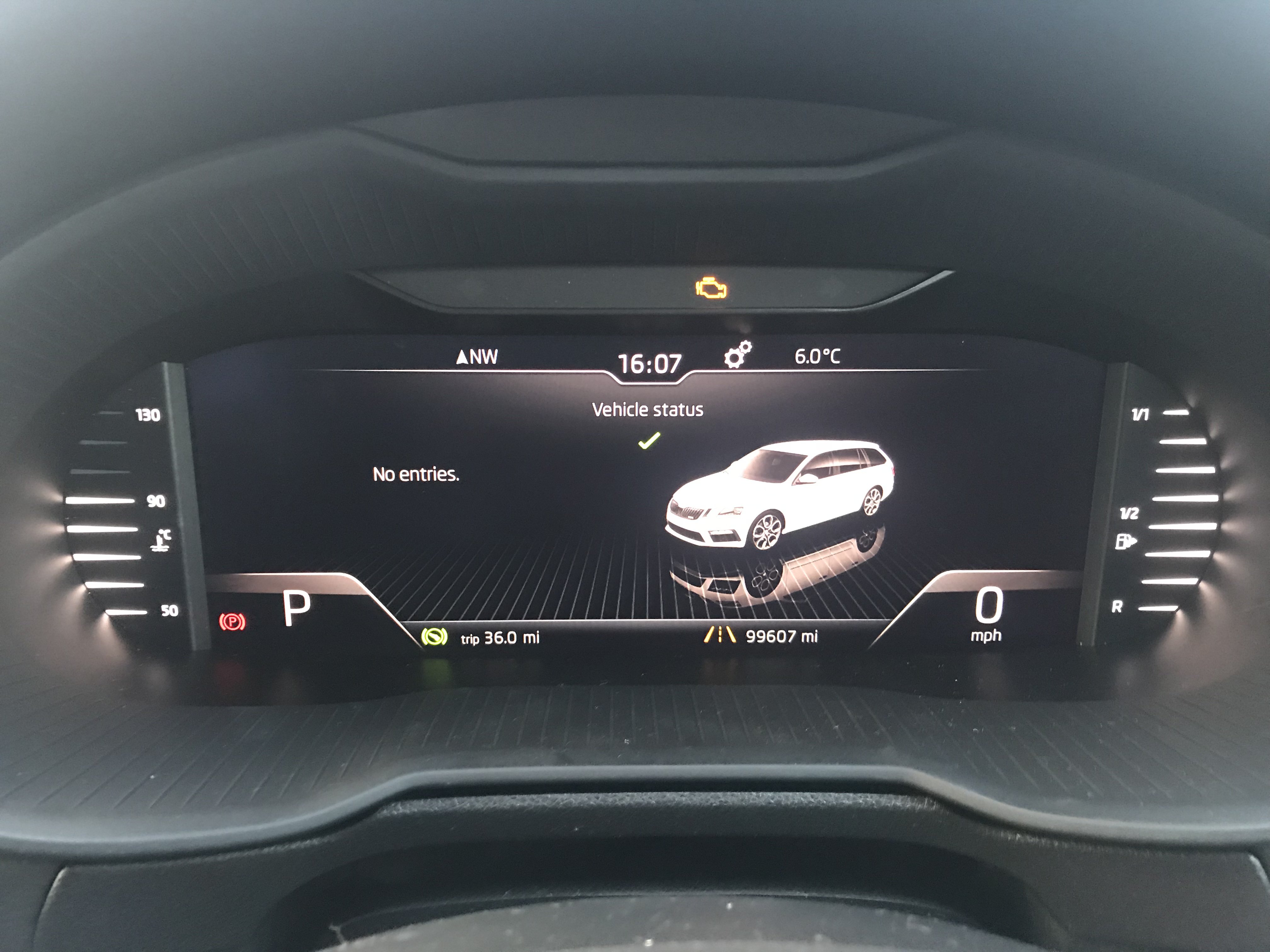

By looking at the coding from a member with aid from factory and telling the car what fuel tank variant it has. The fuel tank sender 2 fault has gone and I have a full tank displayed (which is accurate) but I can’t trust it until it starts to go down which it won’t yet, done 40 miles in the car since having the cluster fitted. The radio is coming to complete the functionality and add map mode. It’s being sorted now I believe.

Well, I’m not sure how it’s going to go right now, kind of wish I’d have had this epiphany yesterday, then I could see if it reads accurately or if it’s just shot up to full. The tank is full for real so I guess I have to wait and see how it goes! I have no idea if the range calc will become accurate with use or not, nor do I know if it will read correctly if the car is filled with diesel again. It normally reads 475 miles to empty when the tank is full. But to drop 600 miles range in 8 miles gives me hope that it’s going to work ok.

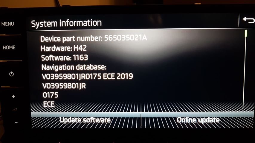

Hopefully it all works as planned!! How much is it going to cost to get to MIB 2.5?
A lot! About £900 with the LTE antennae. Then the screen is £400 or so, so a lot lot :D Hopefully I can claw some of that back with old parts.
My guess is there is a parameter for Fuel Tank Volume that’s set to 0xFFFFFFFF
I can confirm the fuel gauge has dropped a bar so it seems to be working now as it should! That’s a relief :biggrin:

So you must be down to about 1,750miles left in the tank. Playing fuel range roulette at the moment. 392 miles driven and 35 miles left according to the computer and 24 miles to my local Shell garage so should just make it.:sweat:
Actually you are spot on! It’s dropped 1000 miles range in 23 miles of driving. The real question is will it rocket back to 2750 miles when I next fill the tank??

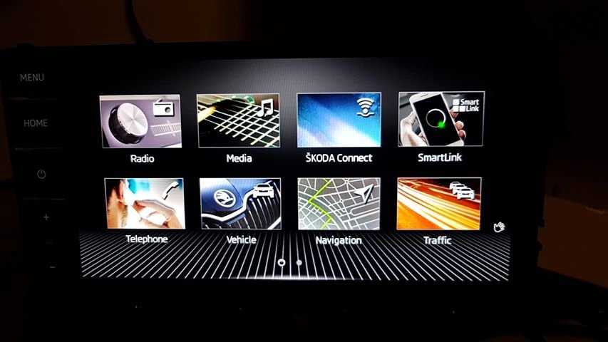

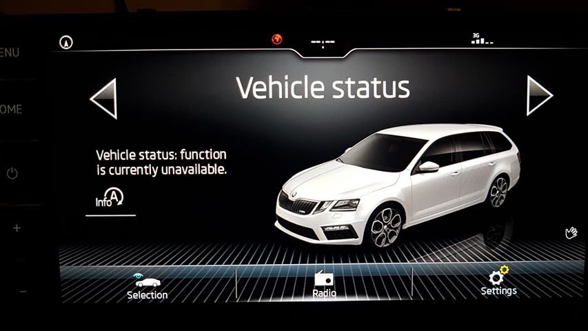

I hope Sasha doesn't mind if I post some screenshots from the unit she's getting :)

thats very tasty, almost make me want to trade up to a 9.2
OMG - Sasha that is such a sweet setup...
