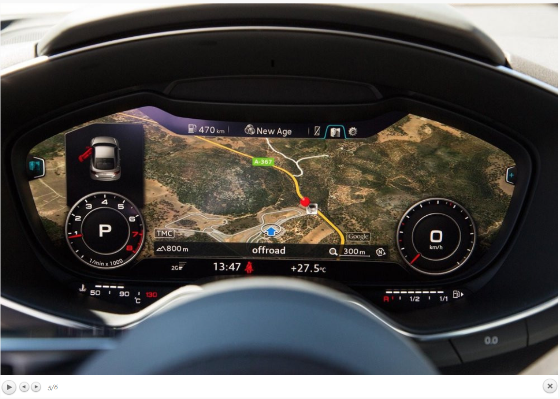

Can the VC display maps from carplay or android auto?

I think that is highly unlikely unfortunately. It's a shame seeing as the inbuilt maps are so rubbish!

It can’t. It doesn’t on an OEM fit either sadly. The only one that does is the one on the TT because it doesn’t have a second media screen.

I glad you pointed that out as during my search late last night for a Superb VC they had this photo
812318661_ScreenShot2019-02-05at01_35_24.thumb.png.3c6f297683e6841440e1c070bd1cbaaa.png
BUT on closer inspection it is clearly a TT VC (a bit naughty having it under the listing for a Superb VC!) Not only do I tend to use google maps now but ideally I would have liked the above layout as for me I think it is better laid out.

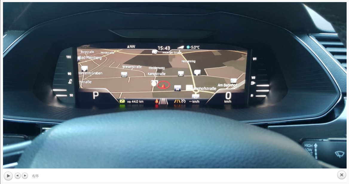

This is either the Superb or Octavia VC map
1538484727_ScreenShot2019-02-05at01_35_44.thumb.png.258ad6515556fd6f199573a52b83a145.png
