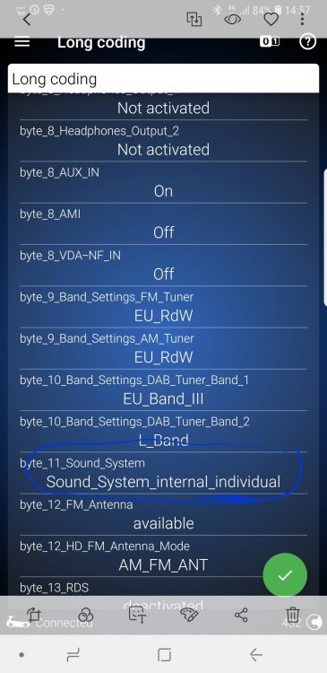

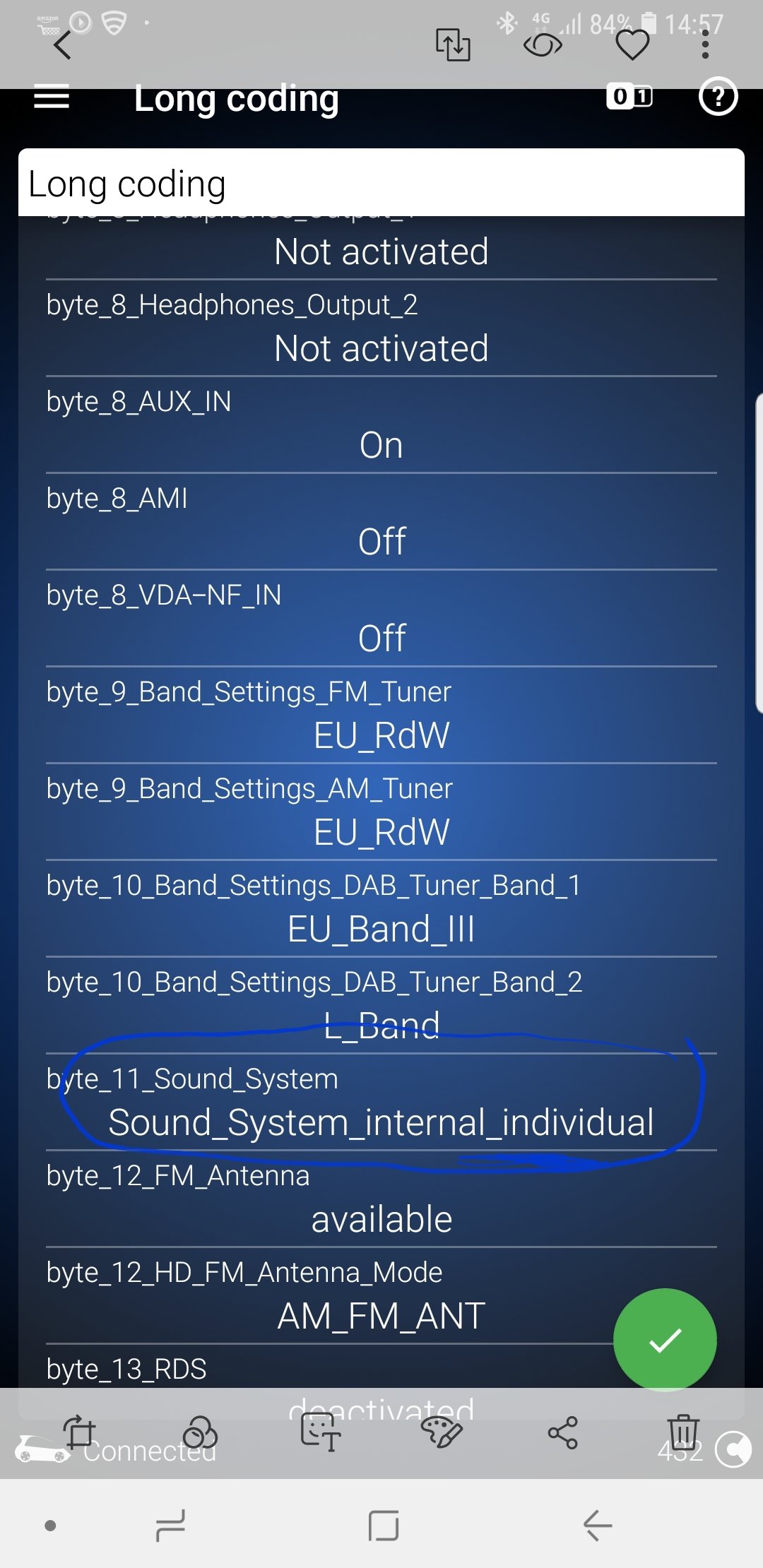

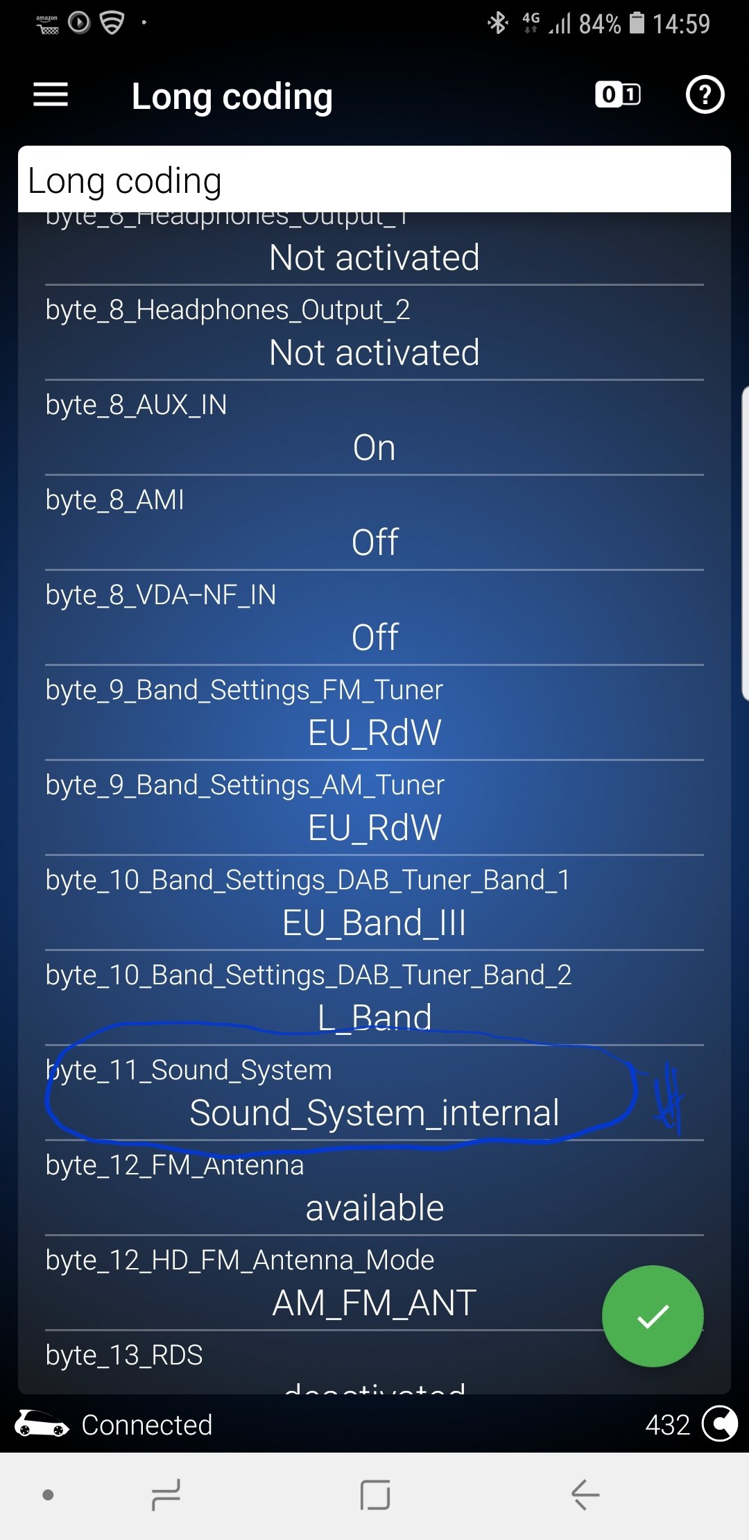

I tried this on my MIB1 Bolero earlier today.
As per the previous post, with the MIB1 you don't see the new options in the sound set up (accessing from the Media option) but it does change the sound.
The change however, was not for the better; I have my EQ set to 9 for bass and around the 0 / -2 for mid and treble just to get a reasonable sound (having moved from a Mondeo Titanium X Sport to the vRS, the vRS sound is awful) and the coding made the sound much tinnier and reduced the prominence of the bass. A little like the fake surround sound on ghetto blasters (for those of you who recall twin tape decks) in the 80s.
Looking at the long coding you can see the change has been written to the module (see images).
I've changed it back, but definitely worth trying. Maybe those of you with MIB2 / 2.5 units will have more success :)

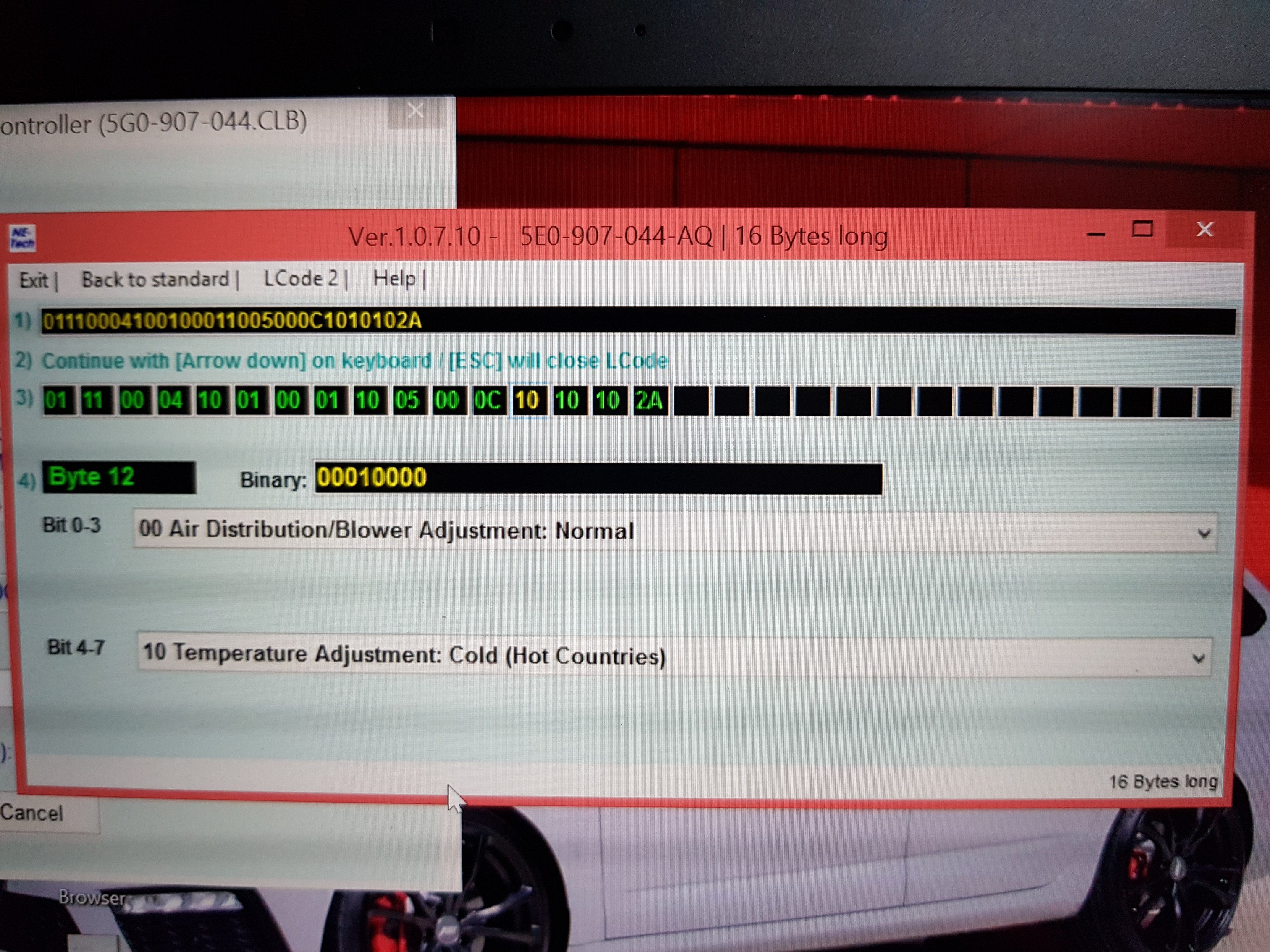

Sharing a tweak I found under Auto HVAC. This made the air conditioning cooler.
Funnily, the Skodas sold in Singapore feels stuffy and it only feels normal after I have coded byte 12 to 10 by selecting cold temperature for hot countries (like Singapore).
