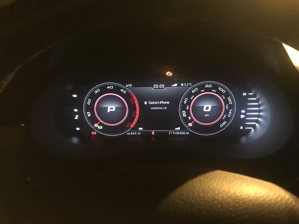

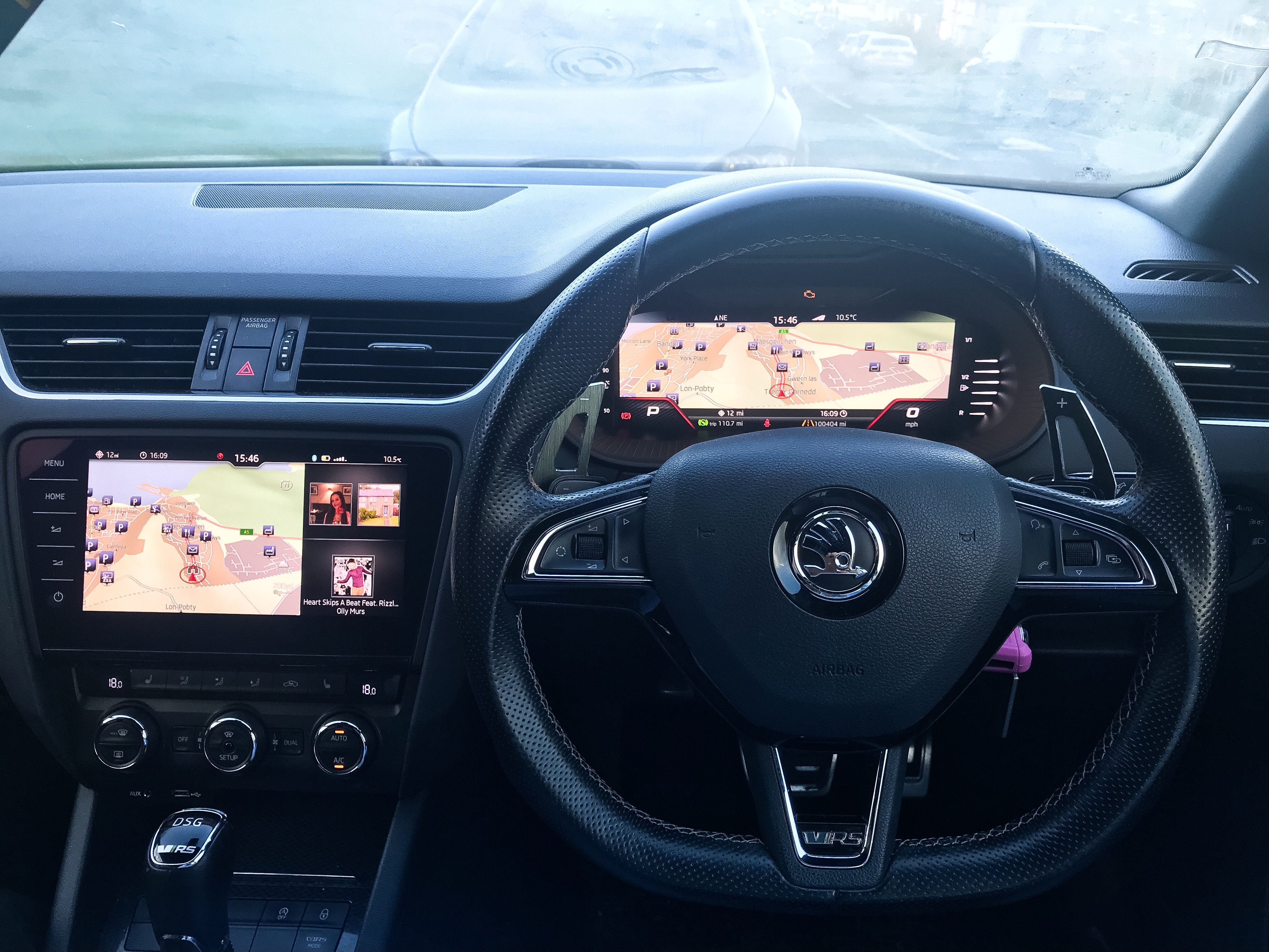

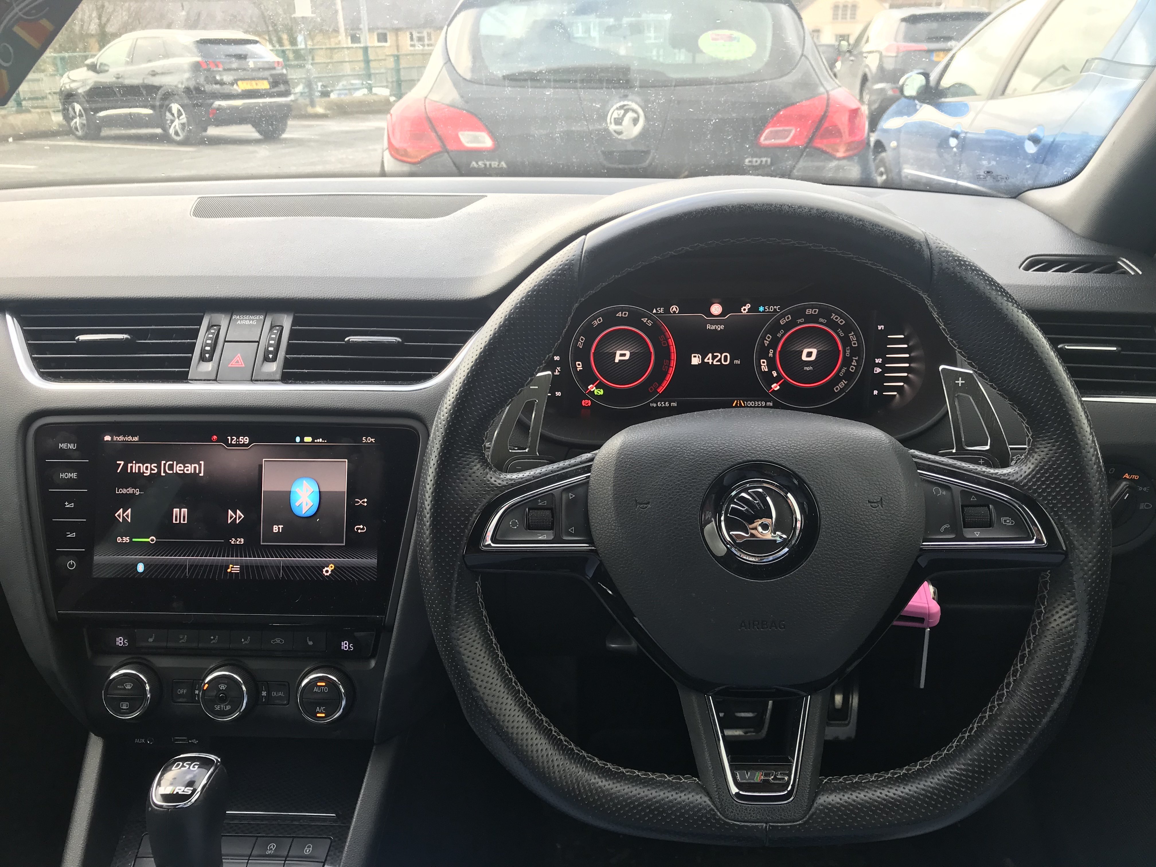

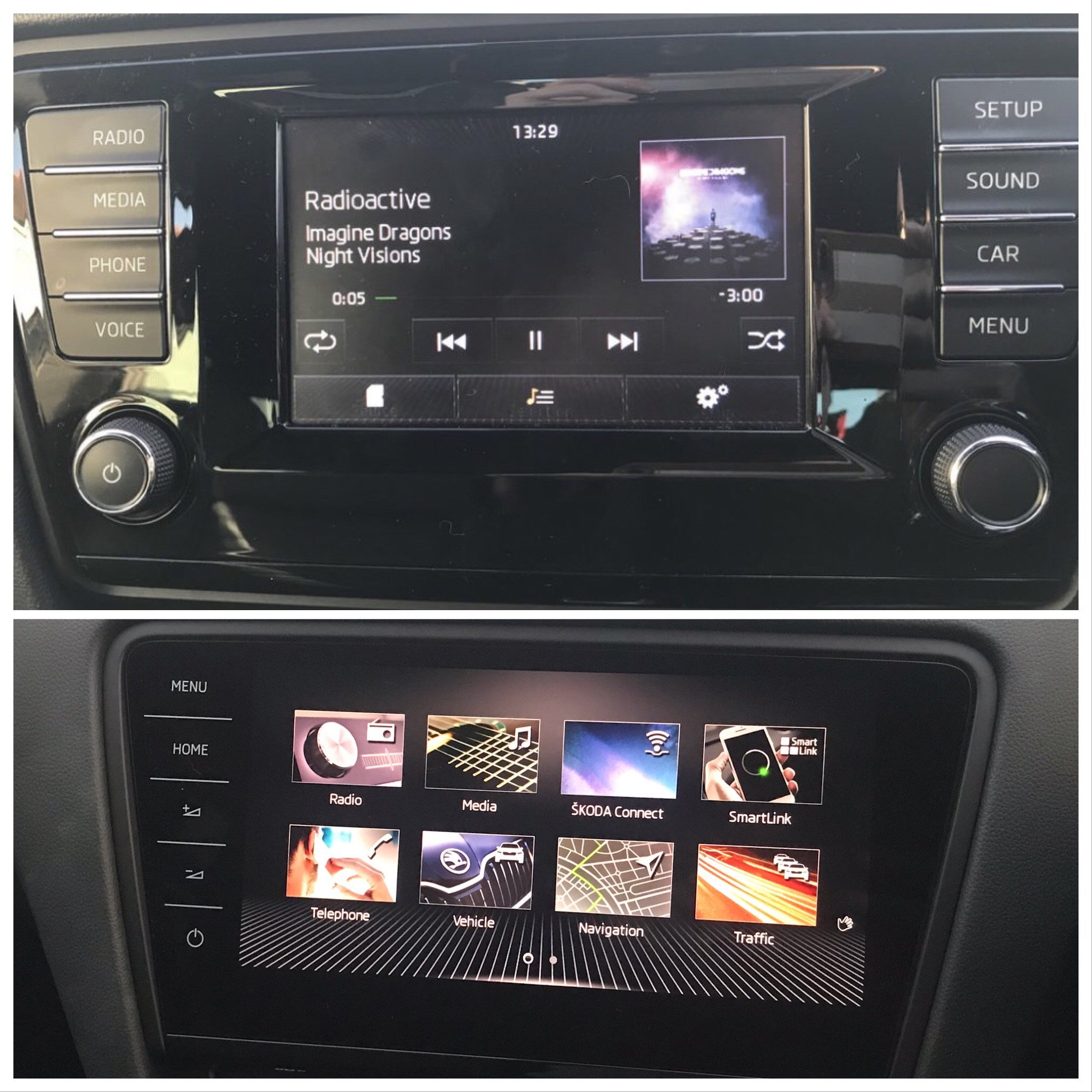

  • Talking of things that are done and working, barring a few things I need to sort, the virtual cockpit is in the car!!!!!!      Here’s how it ca
  • My wheels are back!!! Please excuse the dirty car but this week I have broken my Brother’s Fabia and my Dad’s Alfa 159 so I’ve just bolted my wheels on and got moving as I’ve no time today to fit the

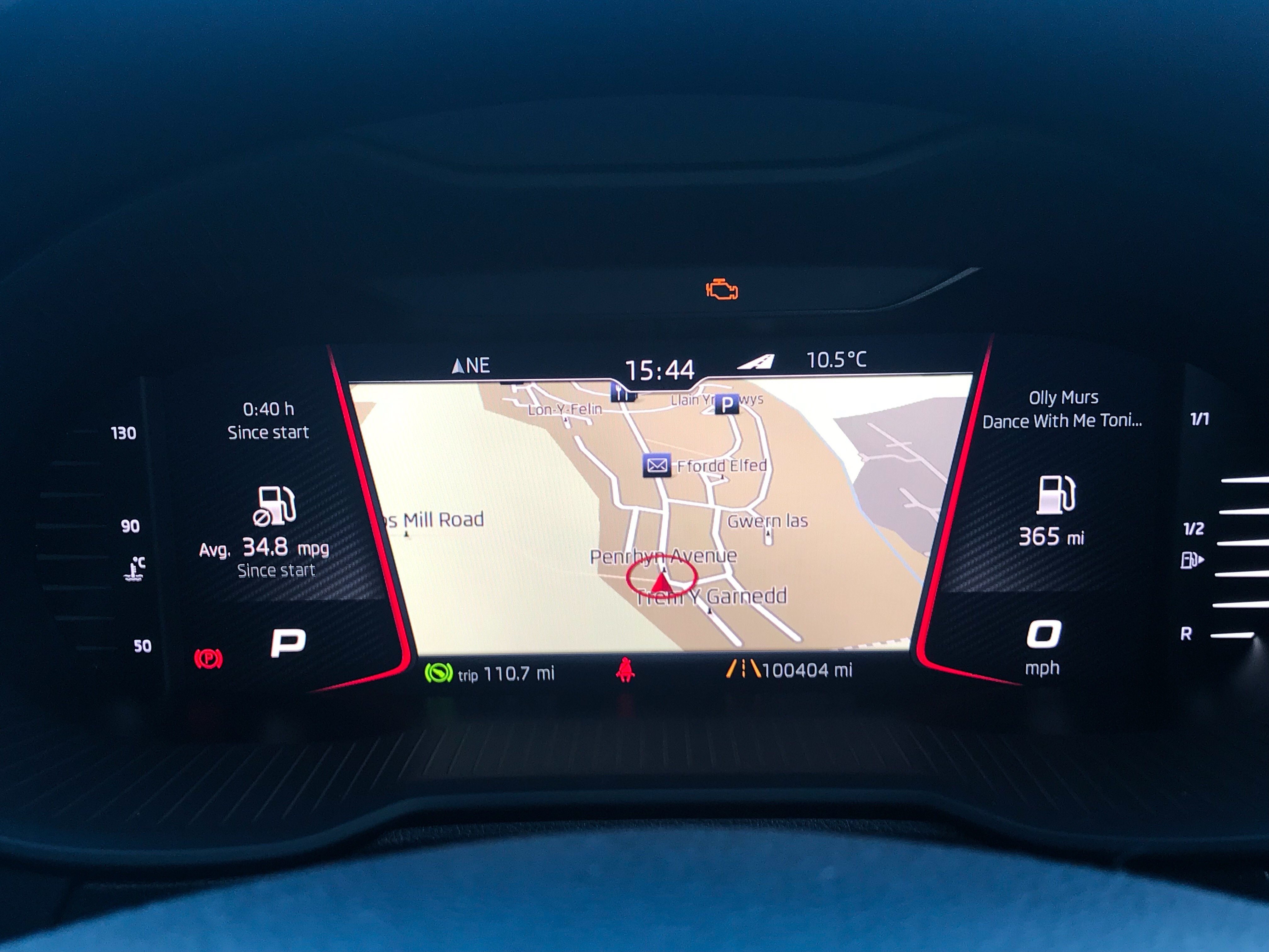

  • Oh yeah!!!! It’s finally sorted, a couple of adaptations and coding changes guided by the genius that is @pab567 I have finally got the map mode working and it is awesome  So it’s confirmed that you d

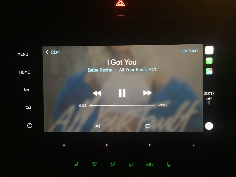

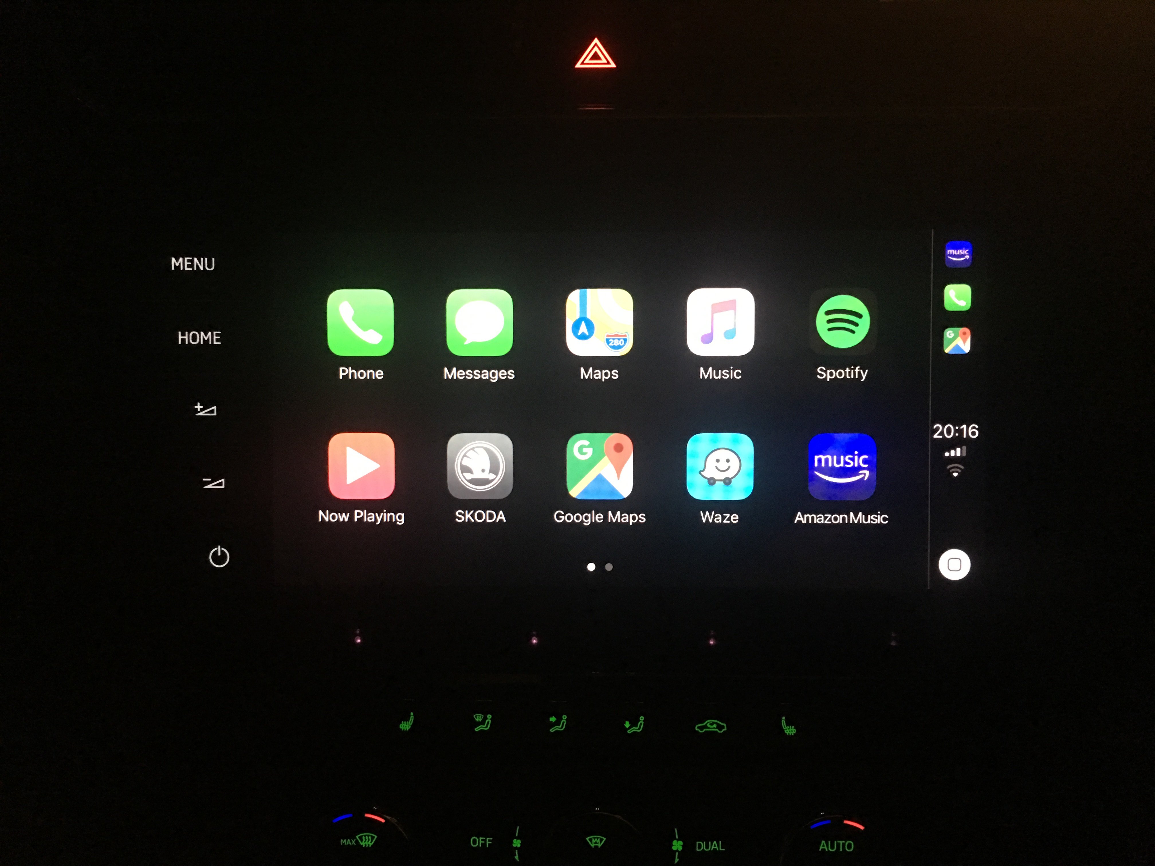

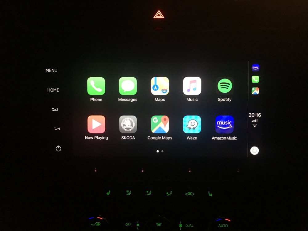

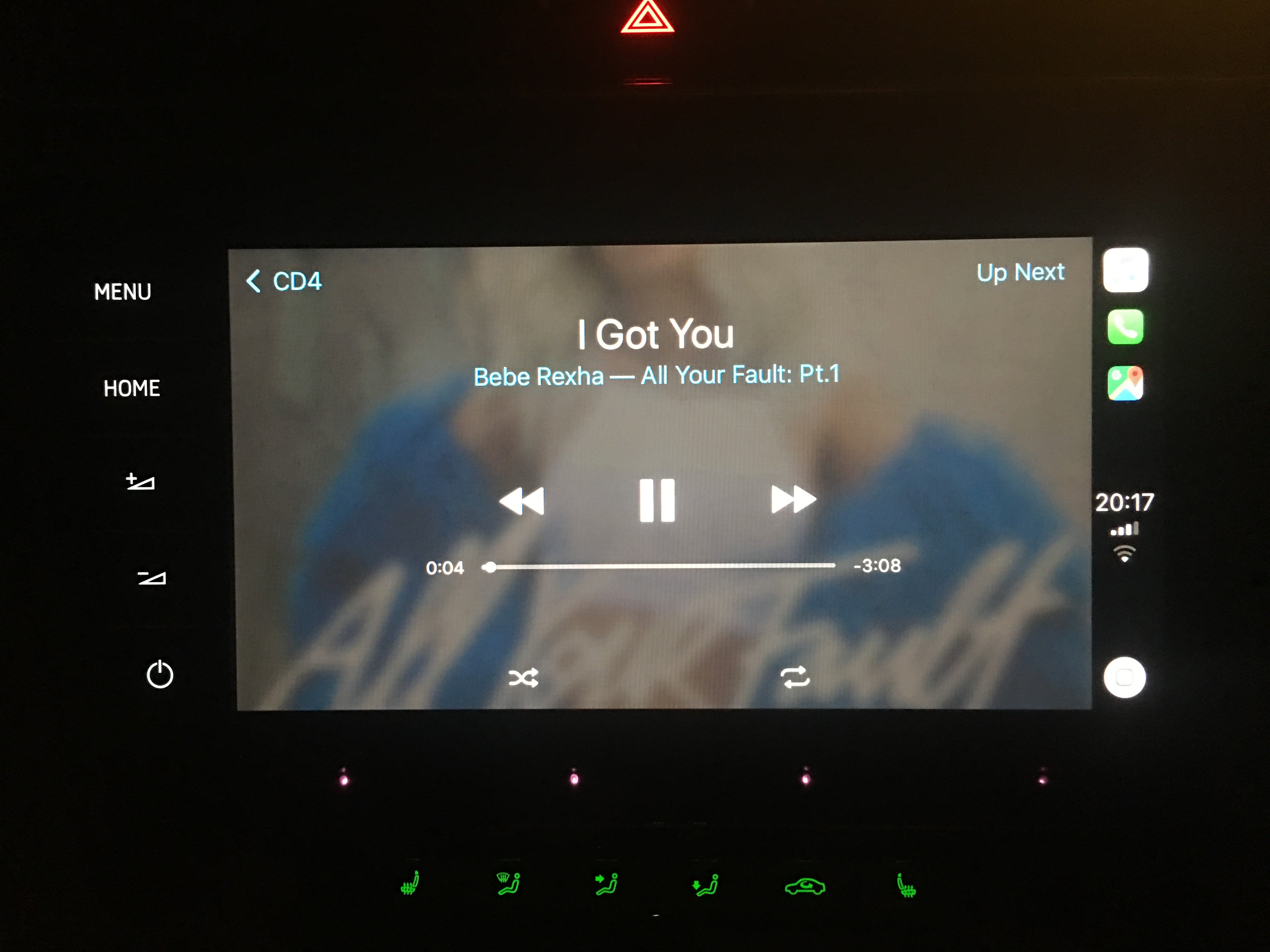

Forgot about the new Apple CarPlay view as it now has 5 icons per row. Love it :)

I did head for my right swivel knob when browsing the settings earlier haha.
It took me about 2 years of ownership to realise that you can use that to scroll up or down lists. I've always just done it on the touchscreen :D
Then you won’t miss it when you go for this retrofit :rofl:
Looks great, massive upgrade from stock.

I can understand why it wouldn't be worth the time and money to develop, but its a shame nevertheless that Skoda don't have a RHD-version of the screen with the buttons on the other side.
I don’t mind the buttons being there. It’s not as big a deal as it looks like it would be. It also puts more screen toward the driver so that makes up for it a little :)

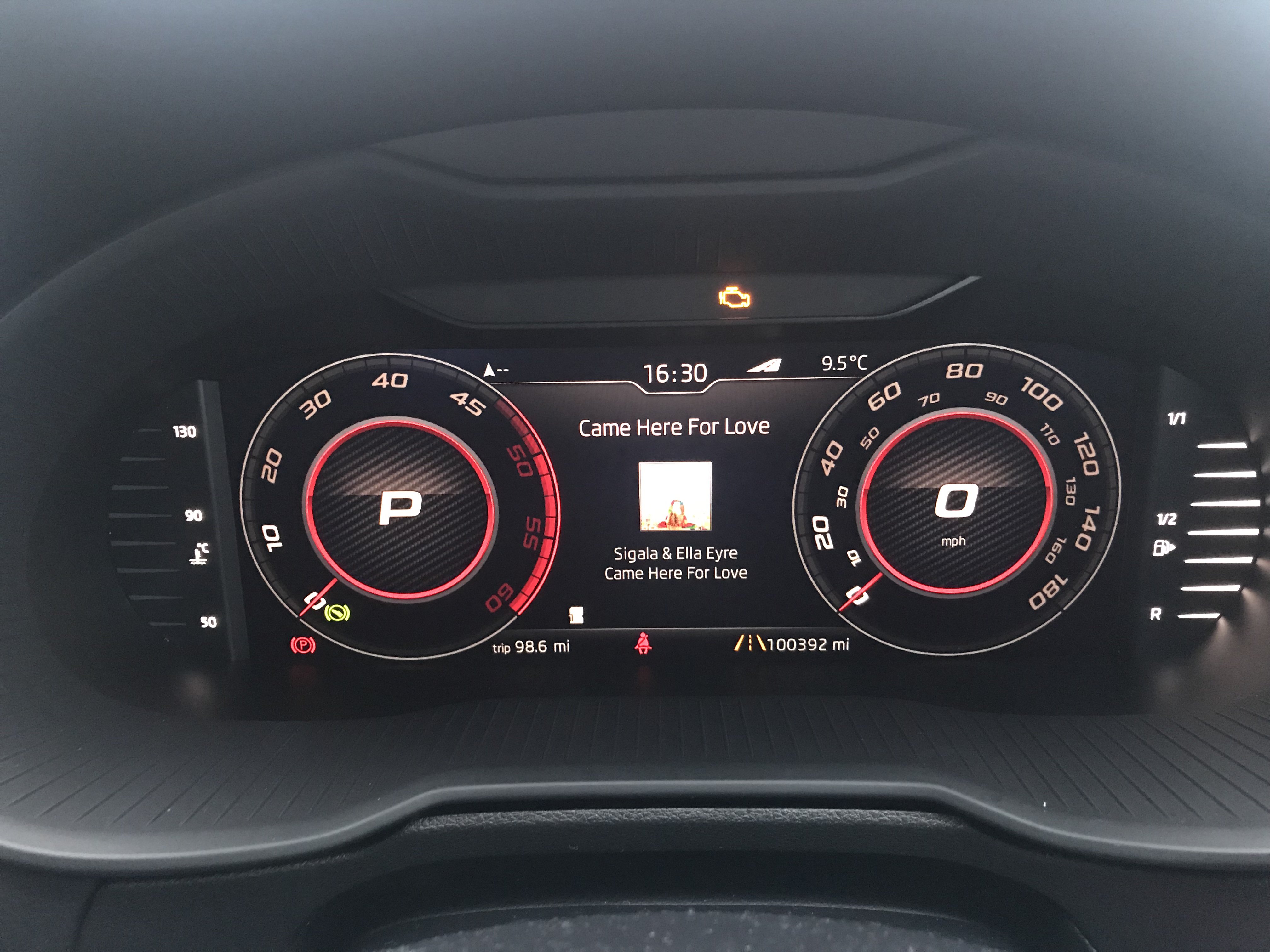

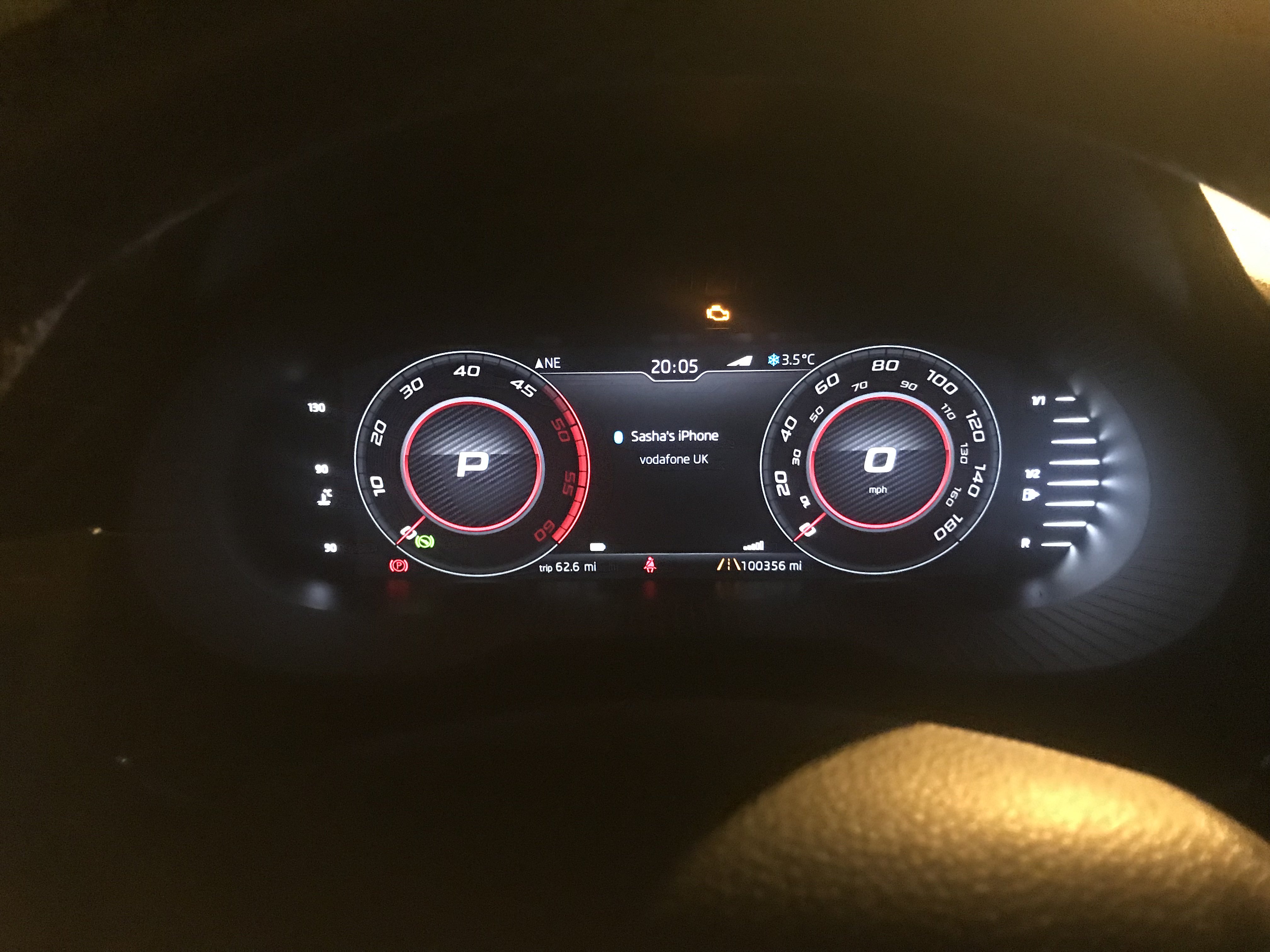

Massive thanks to @ExSEATfor sending me a scan of his virtual cockpit because with this I have now been able to get the vRS skin going :cool: I’m too excited to wait for daylight for proper pics so please enjoy
Still no map mode yet, but I am working on it. I’ll be back on that tomorrow because the low battery warning has come on so I’ve come in now. This is much more awesome though :D

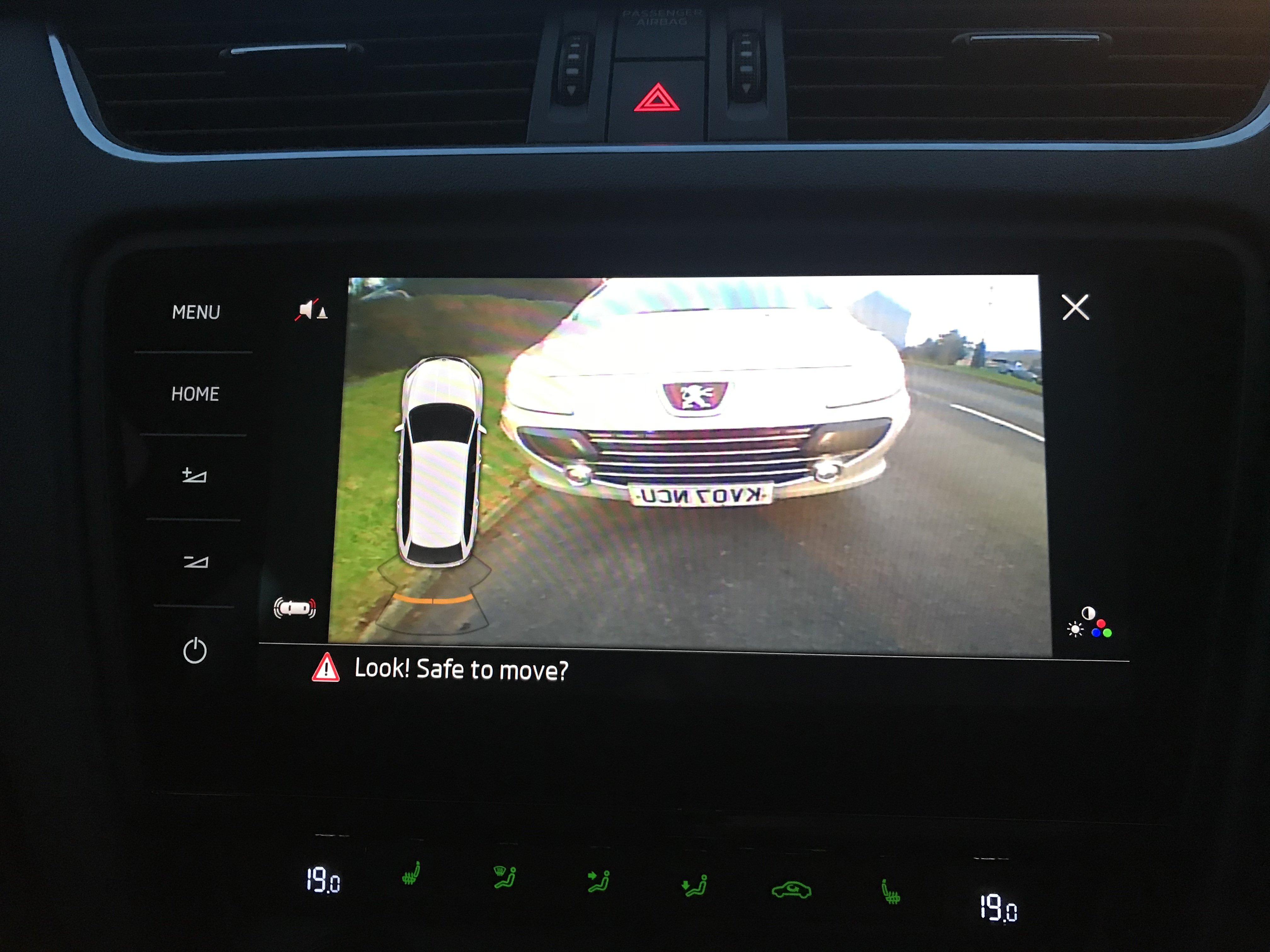

Got the rear camera and mic working again but the rear camera screen doesn’t work like it did, I have to press the menu button to get the display of the car up whereas before it used to come up by itself when reverse was selected. Anyone with one of these radios know why? Loving the clear parking sensor lines though, much nicer :)

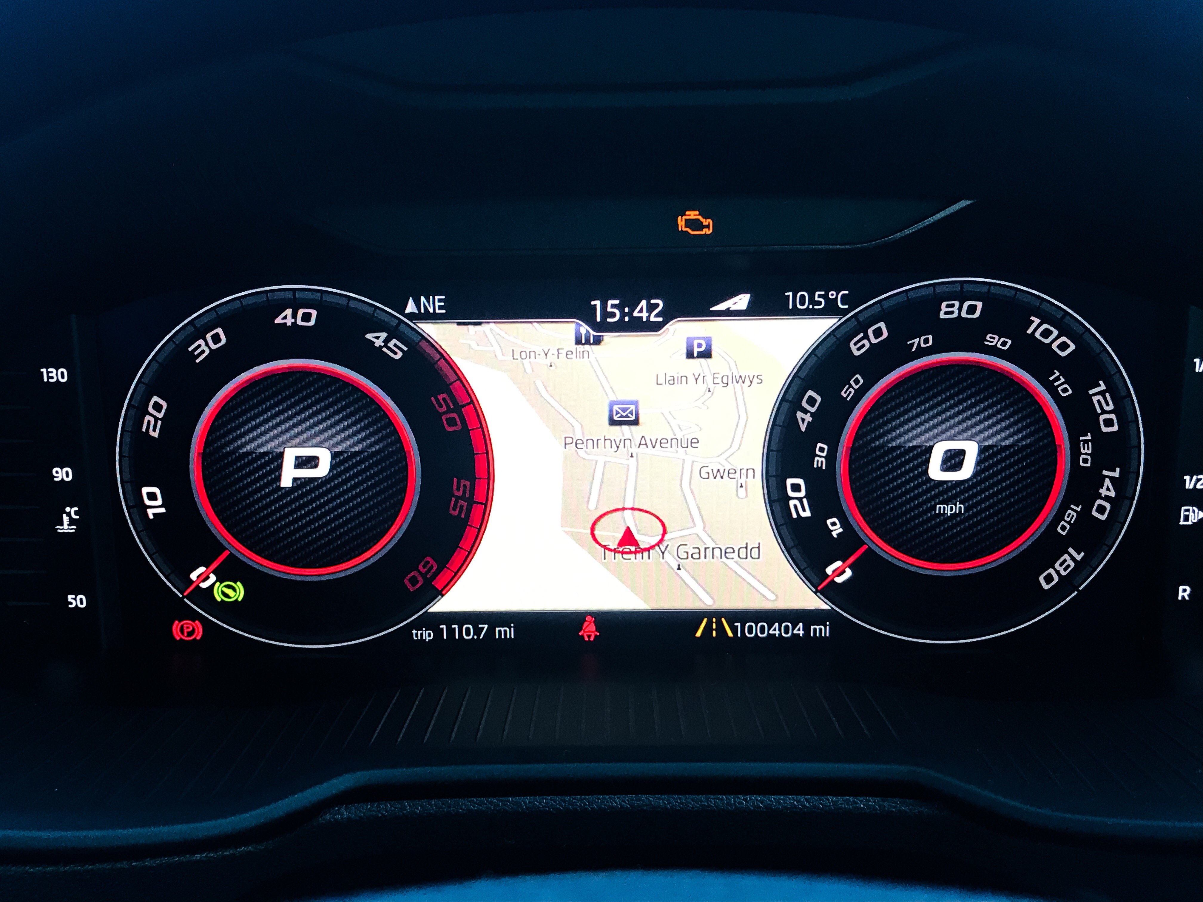

So close now, got image transfer but no map yet! Will keep working at it :)

At least your range seems to be working from what I could see on an earlier VC photo.:thumbup:

Looking like no Can Gateway needed then??
It’s spot on now and coded to 108% range calc to be accurate.
I remain hopeful for the sake of ease, but I have one just in case :)

Hi Sasha, what you using to code in? VCDS or another lead/software?
2 hours ago, SashaGrace said:
Oh yeah!!!! It’s finally sorted, a couple of adaptations and coding changes guided by the genius that is @pab567 I have finally got the map mode working and it is awesome B):inlove: So it’s confirmed that you don’t need a new CAN Gateway. Steering wheel controls next and fingers crossed it’ll be done.
