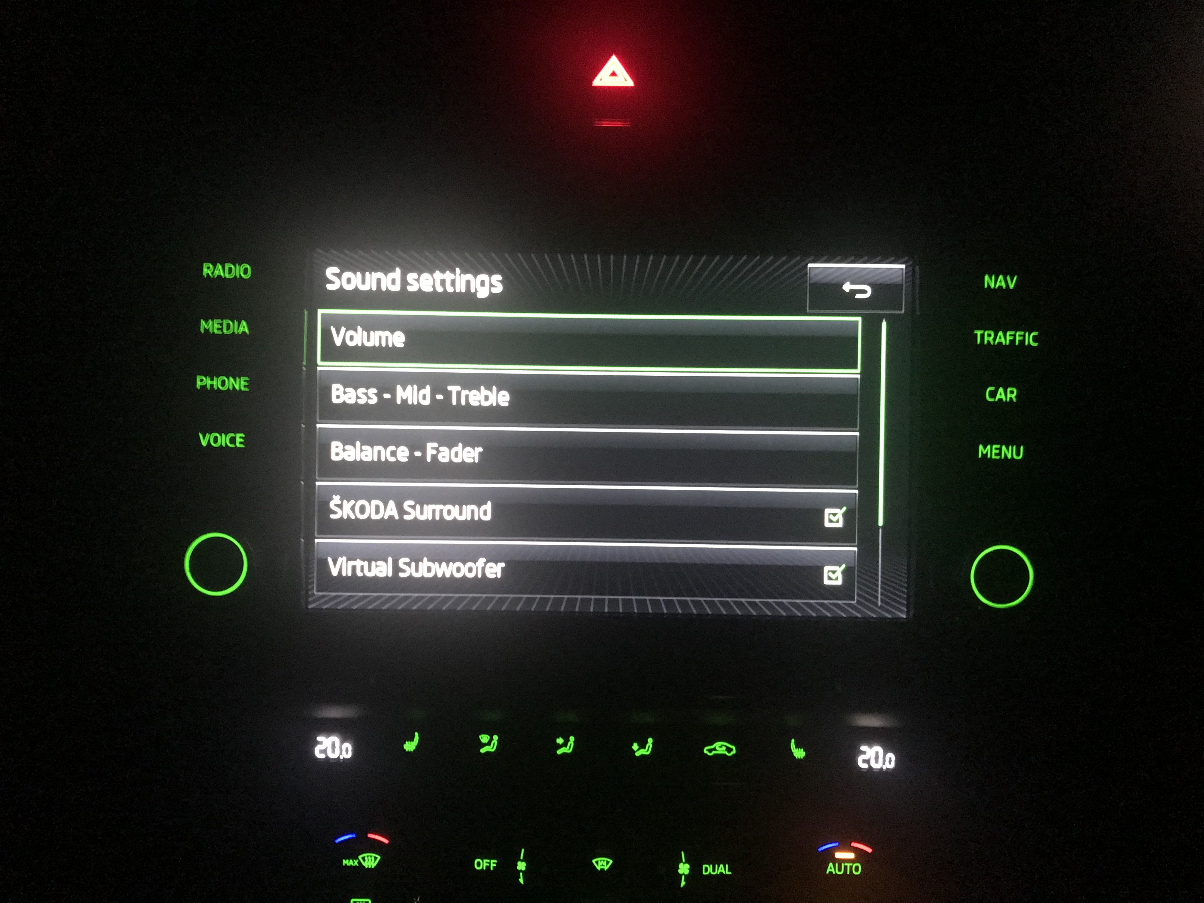

13 hours ago, SashaGrace said:
Tired of the tinny stereo? Here’s a tweak recommended to me by @Maverick567. Use OBDEleven/VCDS to go into module 5F Infotainment - Long Coding - Byte 11 change the value to Hex 04 and then reset the stereo. Next go to the Media tab, click Setup then Sound and tick the 2 new boxes, Skoda Surround and Virtual Subwoofer. Makes quite a difference :rofl:
Is that for Canton only?
No mate, not sure it will work with Canton. Mine is not Canton.
So you've done it?  What HU have you got.
cheers
As above, it’s for non CANTON cars. My HU is a MIB2 Amundsen :)
Ooh .... will have to give this a go.  The one think I dislike about my Oct 3 (other than the regents) is the very poor sound system.  The stereo in my Oct 2 was far far better
Dont get me wrong it’s not like replacing the stereo but it’s a noticeable improvement!
Is it a no-go or a maybe on Canton systems?
I guess it’s not going to be any help with a CANTON system because there is already a sub. Maybe someone with CANTON can tell us?
Any improvement is worth it as the standard system is basically tragic :D
I had looked at going down an amp sub route but I should put that sort of money to better use like family fun stuff.
I'm not somebody who seems to think the world has ended with my standard audio fittings - however any opportunity to enhance would be a bonus.
Is this likely to work on all factory fitted setup? I have the Columbus in my car. I did plug in VCDS, however am the first to admit my skills and knowledge of product isn't great - I couldn't see how to "Byte 11 change to Hex04" for example - if that could be explained in more simple terms?
I did go to the said Byte 11 in 5F Infotainment, Long Coding - however simply saw the following options:
I did try selecting the 04 byte-11.....from the drop down and coding back, however after completing a factory reset on "Audio" from the main settings nothing new appeared.
Edited by Stoofa
You are doing it correctly so I wonder if it isn’t compatible with Colombus models.
