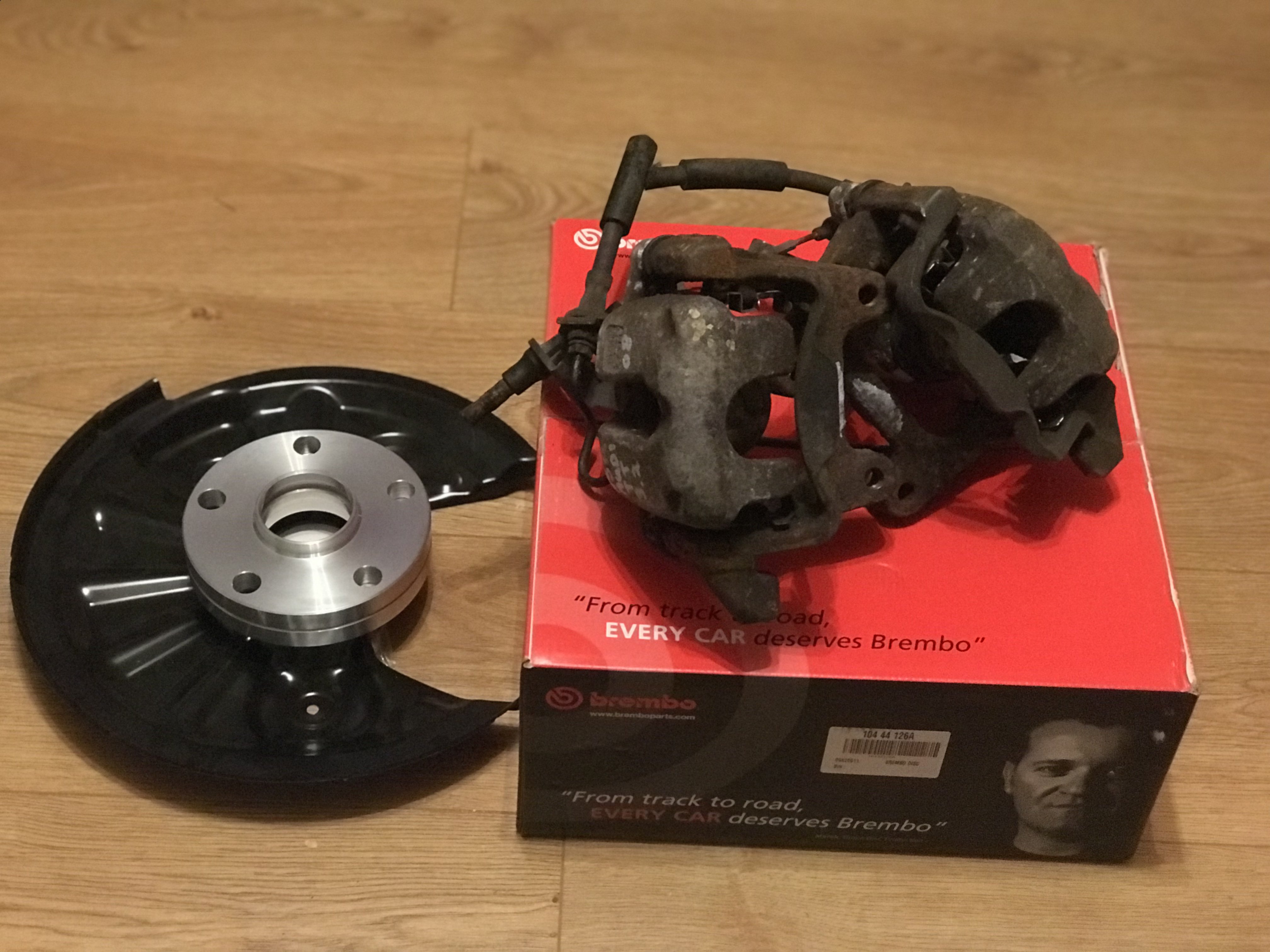

Haha thanks :) The next mod is coming in a few weeks, 310mm rear brakes. Callipers from an S3 8P are on their way, new Brembo discs are ready for collection tomorrow as are the correct 310mm disc backplates from a 245. Longer hoses and otherwise new hardware has been ordered, just got to decide on brake pads now but I’ll wait until the callipers get here to do that as I want to make sure I get the right ones! Callipers will need a refurb and a coat of red paint before fitting and then I hope the brake bias will feel more neutral and the car won’t nose dive so hard under braking! Also got 15mm rear spacers on order too :)

The parts gathering has begun!!! Next job is to decide on which pads to go for on the rear and then get the callipers cleaned up and painted red. Also need to get another disc shield which is on back order and should be in tomorrow. These discs are huge!! Can’t wait to get them fitted. Also got 15mm spacers for the rear to improve the look :)
