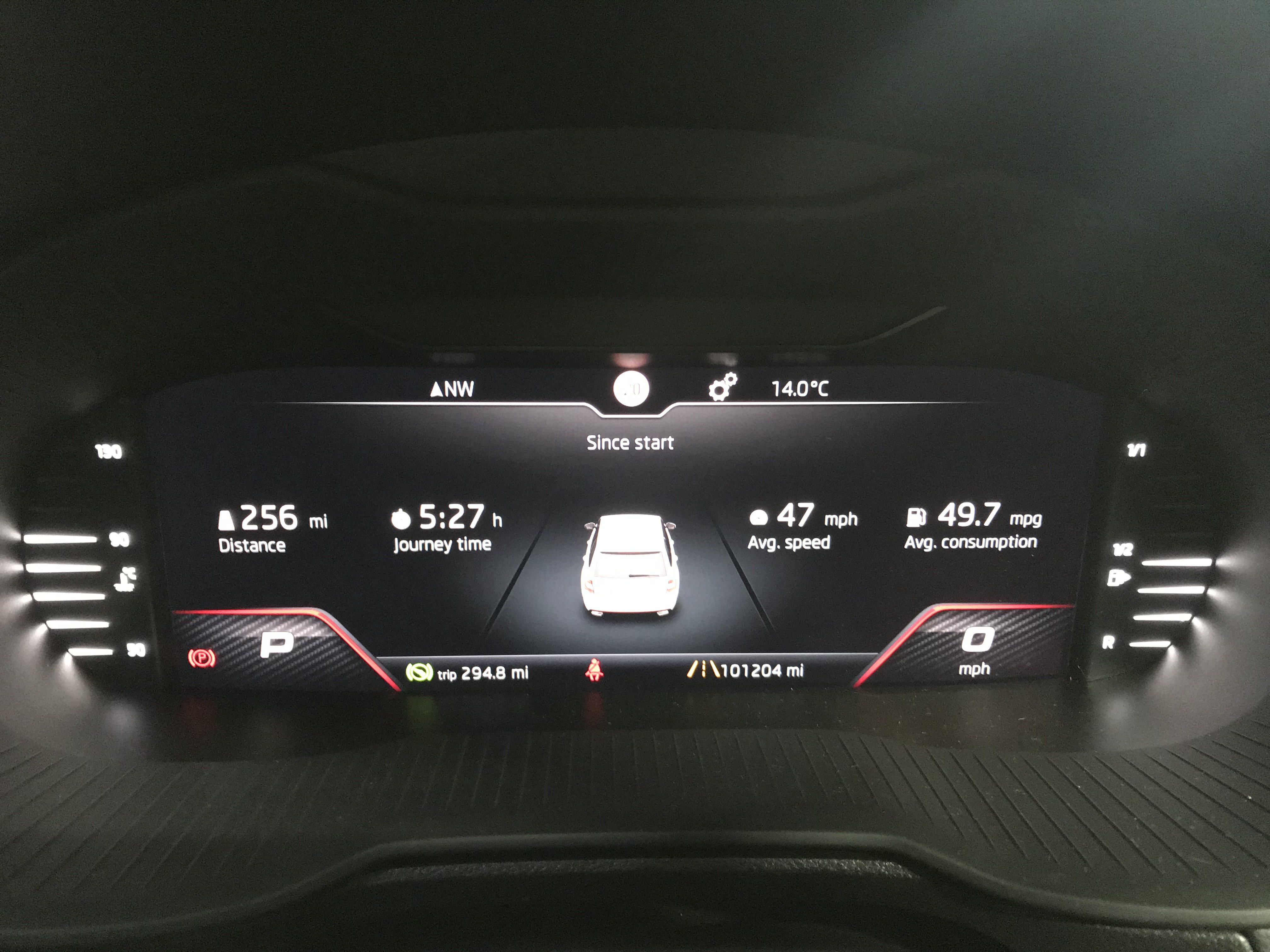

One more question: :)
Were you able to set your miles on the VC?
can it be done or you have to live with what it had?
If it’s a new VC like mine was then the mileage can be set, as shown here
101204 miles :D
If it’s used then you’ll have to go with what it says already I’m afraid.
101204 miles :D

Interesting, I have no idea why the VC can’t have the mileage altered once it has done more than 100km but for now it can’t. I guess someone will work it out at some point.
The 100km max to have the mileage altered doesn't only apply to the VC, VAG have implemented this for many years (over 20 AFAIK) on all replacement instrument clusters, in an attempt to make clocking more difficult.
Over 100km you have to use aftermarket hacking tools.
Indeed, however the aftermarket people have cracked it on the older clusters but nobody has got it down on the VC’s yet. I have my old colour cluster with 99,500 miles showing. Great for someone with a monochrome cluster showing just under that or anyone really because the mileage on that could be altered :)
