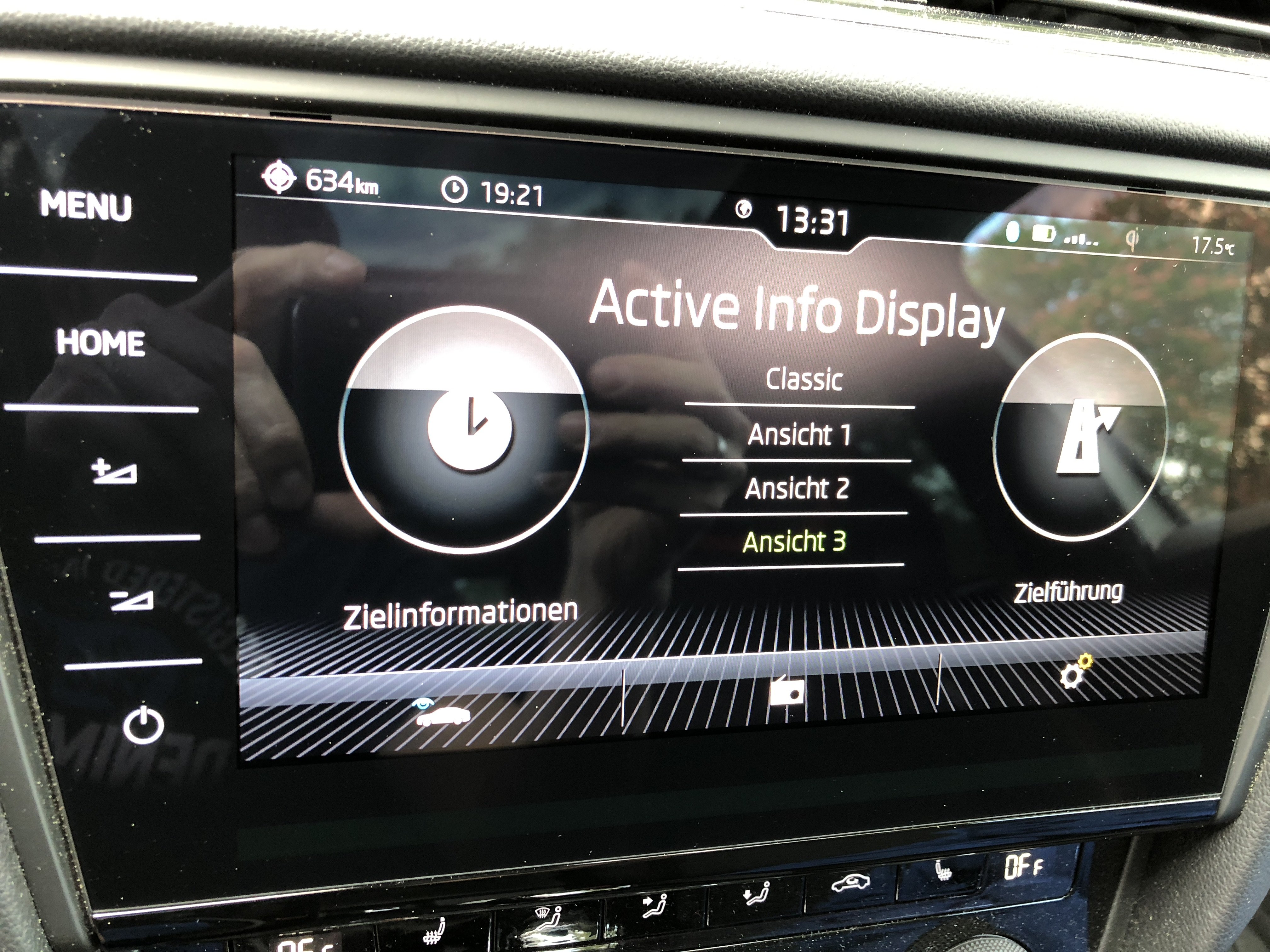

On 14/02/2019 at 09:56, ccosmin said:
Hi, do you know if having the Columbus 9.2 is mandatory in order to have a working active info display?
When I spec a new Octavia  I can select it without Columbus. I don't really need the larger screen or the Navigation so just wandering if I can just simply change the virtual cockpit.
The display works without the Columbus, I had it running with my MIB2 Amundsen and it would even work with a MIB1. You just won’t get image transfer or nav. Look back through this thread and you can see the videos and images of when it was first installed with the old radio and that’s the functionality you will be getting.
