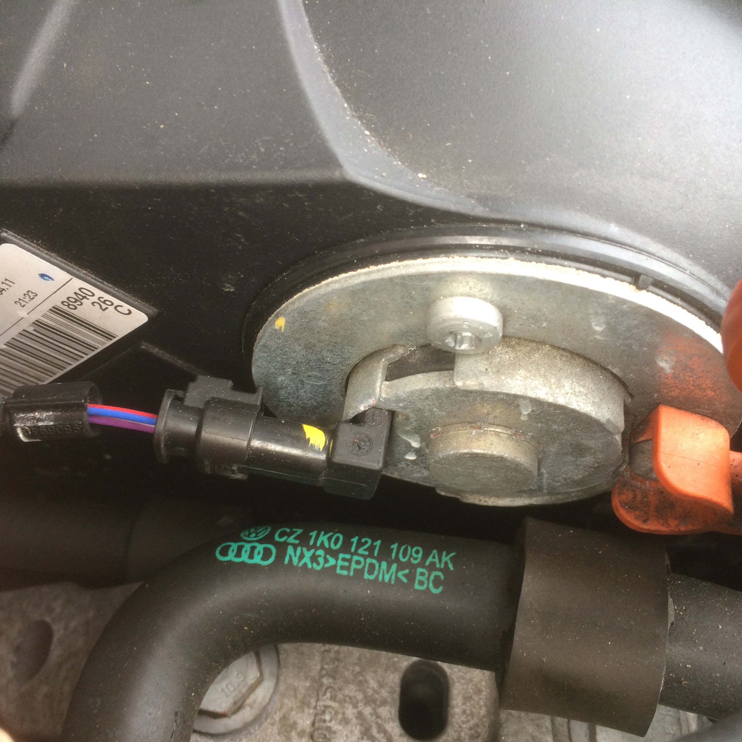

I own a 61 plate 2.0 petrol vRS, which I've had since new. It's only done 31,000 miles. In the time I've owned it, in the first year it did around 12,000 miles. Up until April this year it did a few long journeys, but wasn't used a huge amount. Since April my wife has been using it with our 7 month old son. So lots of short journeys. It's always been serviced by the local Skoda dealer, every year.
Two months ago it complained that the oil level was low. Something it has never complained about before. It needed a litre of oil to get back to the max level. I initially put this down to the fact the usage profile of the car had drastically changed and instead of a few long journeys, it was now doing a lot of short journeys, every day. It was due an MOT a few days later, so I called Skoda ahead of my wife taking it in, to tell them what had happened. They said they would take a look. It passed the MOT without any issue, and my wife said the dealer didn't comment on there being any problem.
Tonight when I was topping up the washer fluid, I noticed what seemed to be oil on the left side of the engine. I immediately noticed it on the circular shiny metal part (not the most technical term) just behind the dipstick, and it was down the side of the engine beneath this. I also could see, what looked like oil residue on the undertray. All of this was on the left side of the engine, as you stood in front of the car (so, drivers side). I apologise now for the terrible quality of pictures. I've put arrows where the oil was noticeable on the undertray.
I wondered if anyone would be able to comment on what this could be, should I be concerned, and a rough idea on the cost to fix. I'd like to have some idea if this is an issue before I call Skoda.
Many Thanks in advance...
That silver plate is the outer side of the INA camshaft adjustment / N205 adjustment valve. It looks like a seal is leaking but I doubt it is leaking 1 litre of oil. You may be aware that the EA888 series engines have a very poor oil control ring design that is prone to blockage and failure.

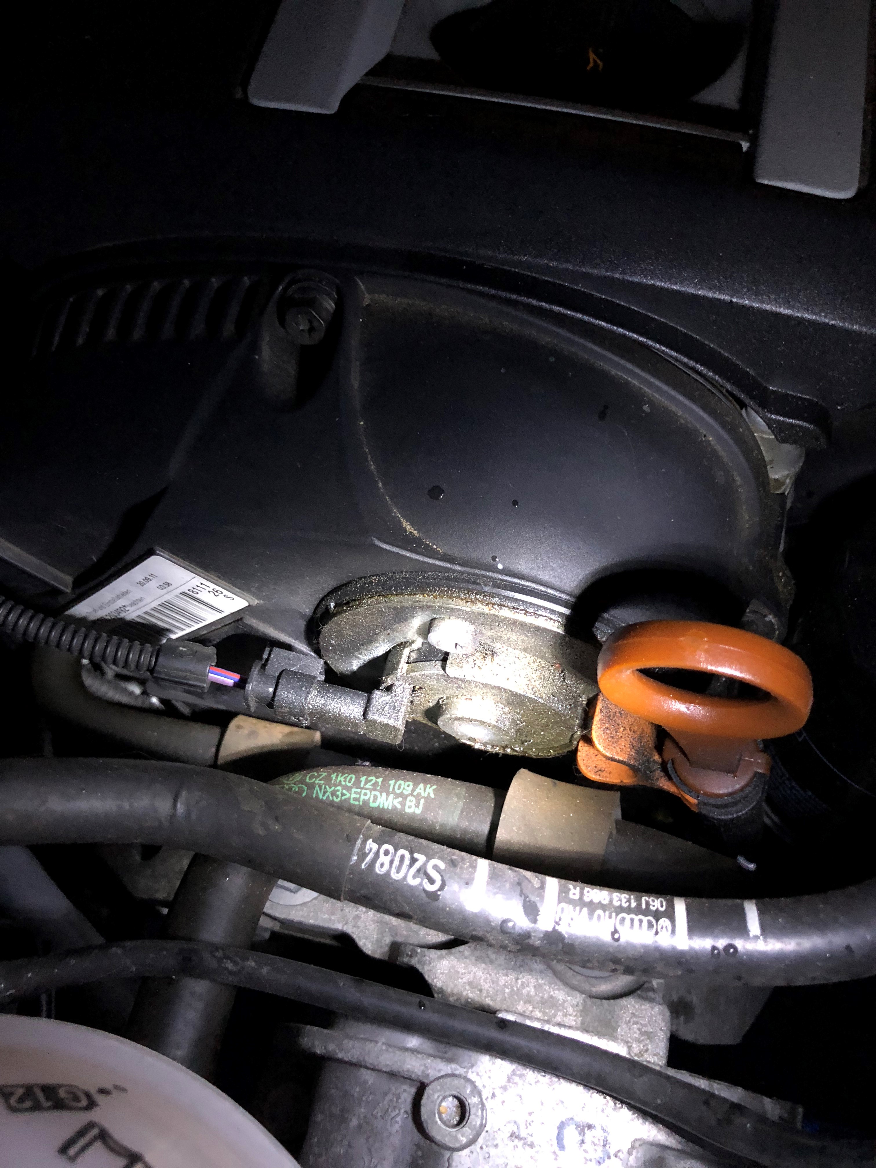

I have a 11 plate bought used with 32k miles. I'm now at 45k miles mixed driving. Still no measurable oil use luckily even though there is oil residue under the intake pipe near attachment to the turbo, I'm still trying to track that.
What oil change schedule do you use, what oil do you use or rather does the dealer use?
Edit: Here is a photo of mine a few months ago so similar mileage...
Edit: Ps I really don't want to be the bearer of bad Christmas news, I actually consider this question as preventative for some far worse news,  but have you considered changing your timing chain tensioner?

The plate you see is actually the magnet assembly of the camshaft adjustment mechanism. The valve is inside on the camshaft.
There is an o ring. If i was diy ing it i'd replace that and see if it fixes it.
A dealer may want to do more. It seems there is a revised plastic part which also requires a new connector.
As said, i really think it unlikely to be the cause of your missing 1 litre.

That O-ring from cam bridge/bracket was N91000101, replaced by WHT007212 and the latest is WHT007212B. Should be a DIY ;).
Just in case, the seal under N205 is 06H103483D, could be a bit more tricky to exchange.

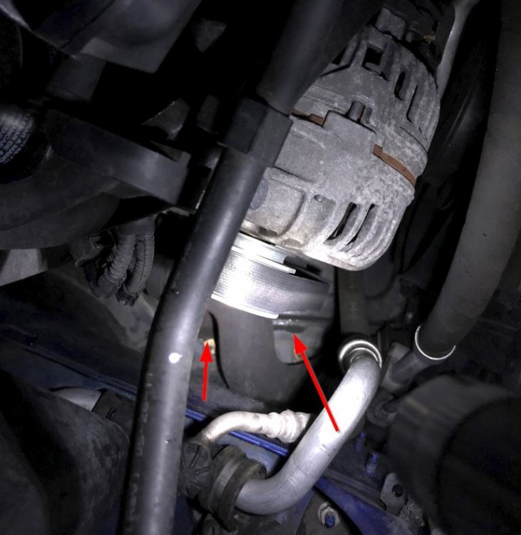

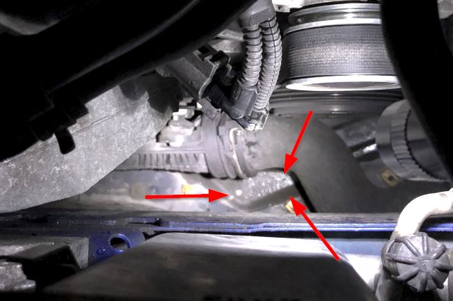

Hi the client, I am having similar issues with my Octavia 2012 RS CCZA engine using oil. You mentioned the control ringdesign that is prone to blockage and failure, where would I find this?
@Brissy
Check the dates on a thread before posting.
The oil control rings are on the pistons.
Yeah I'm still here but it is an old thread!  There are some links to outside sources on the ring design on the ea888 gen 2 in the engine failures thread. Possibly also some other thread particularly on 1.8tsi excessive oil use. Or try googling ea888 gen 2 piston ring design failure etc. Possibly with 1.8tsi or 2.0tsi should find you some info.  The scraper ring clogs with carbon and debris, that is the beginning of all the problems!!
