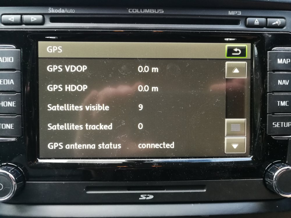

When you use it to access the GPS set up it will at least tell you whether your antennae is actually connected [see pic below.]
I can't work out anything else that can be done with this Setup screen though - it doesn't seem to have any functions.

2] The unit can see the satellites and is "connected" when I plug the original antenna back in but now reports the antenna status as "Disconnected" when I plug the new unit in!
So, does anyone know if the tracking of satellites is a function of the antenna or a software function within the unit?

In your picture above you have 9 satellites visible but none tracked. Either your new antenna is faulty or the radio board in the unit is fried. Another antenna first and if that doesn't work, then a new radio bard and reinstallation of software and maps should be the problem sorted.

@Rustynuts  My unit is showing antenna as connected, but no fix, similar to Dougal's. Does this point towards a dead/dying radio board? Or can a failed antenna still show up as connected? (I have a new antenna on order)

If it's showing as seeing 9 satellites but not tracking any then it's generally the antenna. Only maybe one in a hundred will be a faulty radio board.
