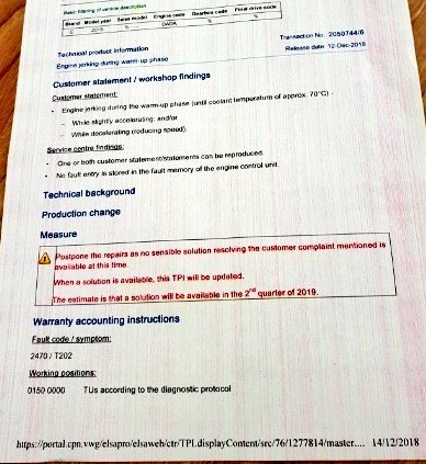

No doubt you will have been given the standard service report i.e.
Tests showed no reported system faults, road test did show juddering, TPI from Skoda is that they are aware of this issue and are working on a solution. When fix is available Skoda will inform the customer.
or words to that effect.

Skoda's attitude to this problem is absolutely appalling. From the word go they have stated that it is a characteristic. They have never yet put in writing that it is not a safety issue despite requests from numerous owners.
Regarding the dealers, I would not trust any who have said that they were not aware of this problem, after mid October, as Skoda made dealers aware of it with a TPI on the 19th ? October. The dealers are hardly going to say " yes Mr _____ we are fully aware of the problem with your car that we sold to you, as other owners have already complained. Sorry we didn't pick up this fault during the PDI.
