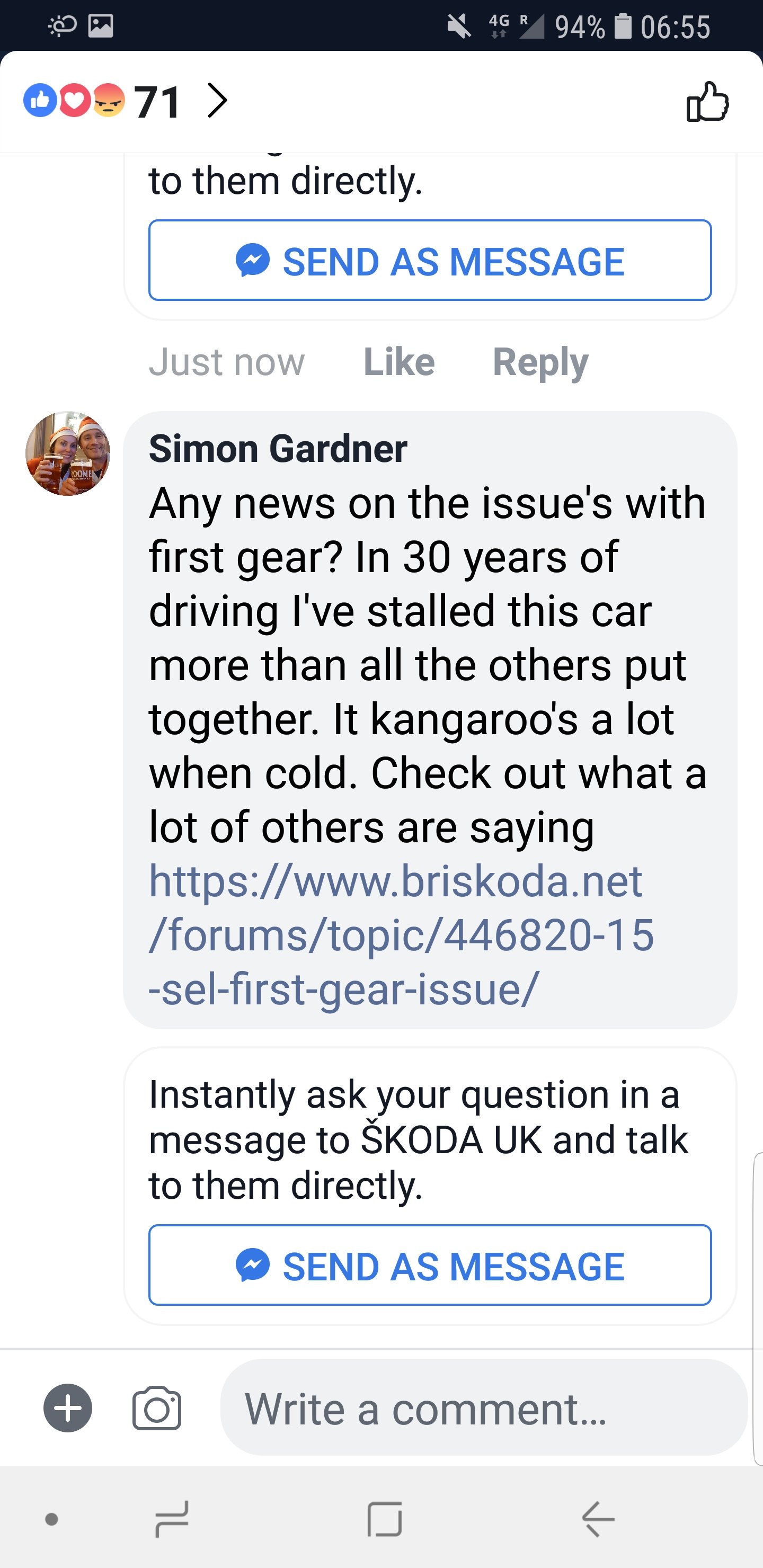

I'm sure it's been done by some of you guy's but I've been commenting on Skoda UK's Facebook page when they post about the Koraq warning potential new customers about issues.
Sieski, I like your style.
I'm not on Facebook or Twitter but if I was I would certainly be using the social media side to annoy Skoda into actually doing something.
Well Done
I've posted it on the Skoda UK Facebook page - now I'll wait and see if it get a response or simply deleted.
