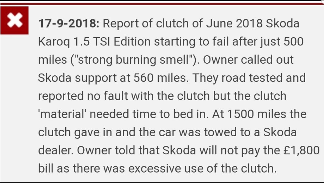

1 hour ago, JeremyGi said:
I assume the delay is due to EU emissions testing but it does seem a very long wait for what to many is a safety issue and for others an embarrassment, I'm sure the wear on the clutch will become an issue in due course too.
Does this now mean that they will admit that they have a problem to the motoring press and the customers with Karoqs, T-Rocs and Atecas I wonder.
I guess that's why the clutch below give up it's ghost. This is screen shot from Honest John website.
That’s what you come to expect as the stock answer from Skoda,always the customers fault.
