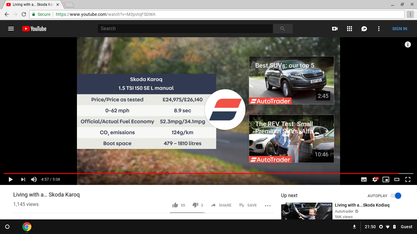

In the Autotrader video above, the reviewer appeared to get 34.1mpg overall; mine, with mixed driving, is showing 42.4mpg - on a recent dual carriageway/motorway trip my Karoq achieved 49.2mpg (car computer, not brim to brim).
I wonder if the reviewer had a particularly heavy right foot ....... or had the car had been tweaked to run richer?

^^^ KW67 CSX in the video First registered December 2017 shows as 125 g/km on the DVLA vehicle check.
 & Currently on SORN.
Revenue weight 1,918kg
**The panel at the end of the Vid shows a SE L manual & 124 g/km.**
Most i see are 122 or 124 g/km.
  What C02 g/km are cars having issues?
EDIT
, i see an Edition on 19" wheels is 125 g/km
Edited by Skoffski
They don't pay for their own fuel, nor do they own the car. That's worth at least 10mpg.
