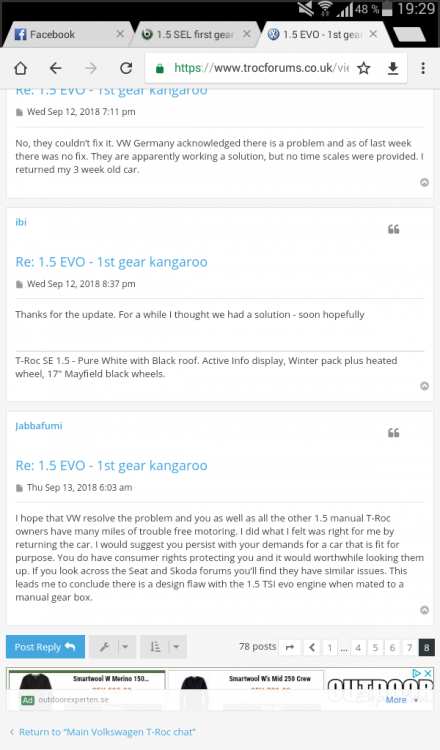

My wife brought her car into our local Skoda dealer today with the first gear issue. When collecting the car she spoke to the service manager. They confirmed that there is an issue with the car in first gear and that they spoke to Skoda Ireland regarding a solution. Skoda Ireland told the dealer not touch the car and they have acknowledged that they know about the problem, but that they don't have a solution at present. But they're may be a possible software update in the future.
My wife is very pi**ed off about this reply and feels like she's being fobbed off and I can't blame her to be honest. The car has cut out numerous times with our 3 and 5 year old in the car. In fairness it restarts automatically, but there is still a delay in getting the car moving again, so its a safety hazard particularly at a major busy junction.
We've decided to push Skoda on the issue and if they can't resolve the issue in a reasonably timeframe. We'll take it further and speak to a solicitor and try reject the car as its not fit for purpose, also on safety grounds.
From T roc forum!Screenshot_2018-09-13-19-29-48.thumb.png.6c40f31125db0cdcc14d01966e084707.png
Thanks for that. We're going back to the dealer to make an official complaint and give then an ultimatum. Fix it within 2 weeks or were formally rejecting the car.
