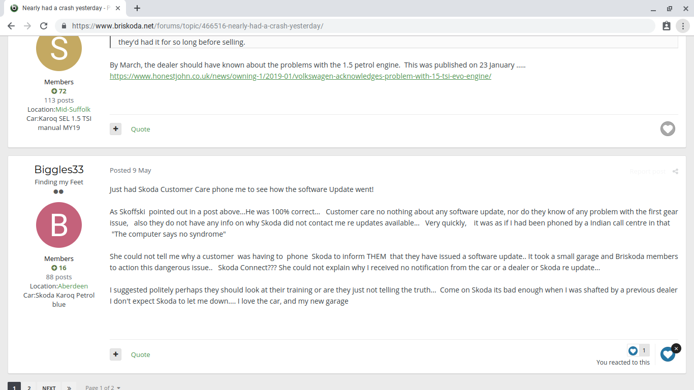

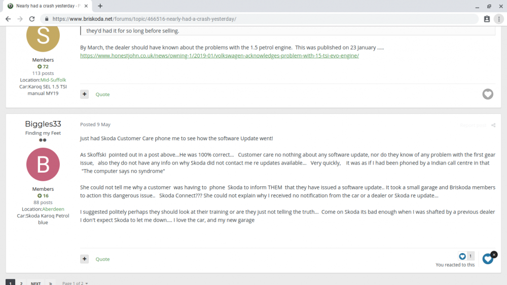

@Kadders
Welcome.
Maybe best say exactly what your Karoq 1.5 TSI is.
What was the build date, what spec, and is it a manual or dsg that you have?
Phoning Skoda UK is fine but who are you speaking to there?
You need their replies in writing because for some reason they must be hiring casual staff on a daily basis with a keyboard and no password to sign in.
