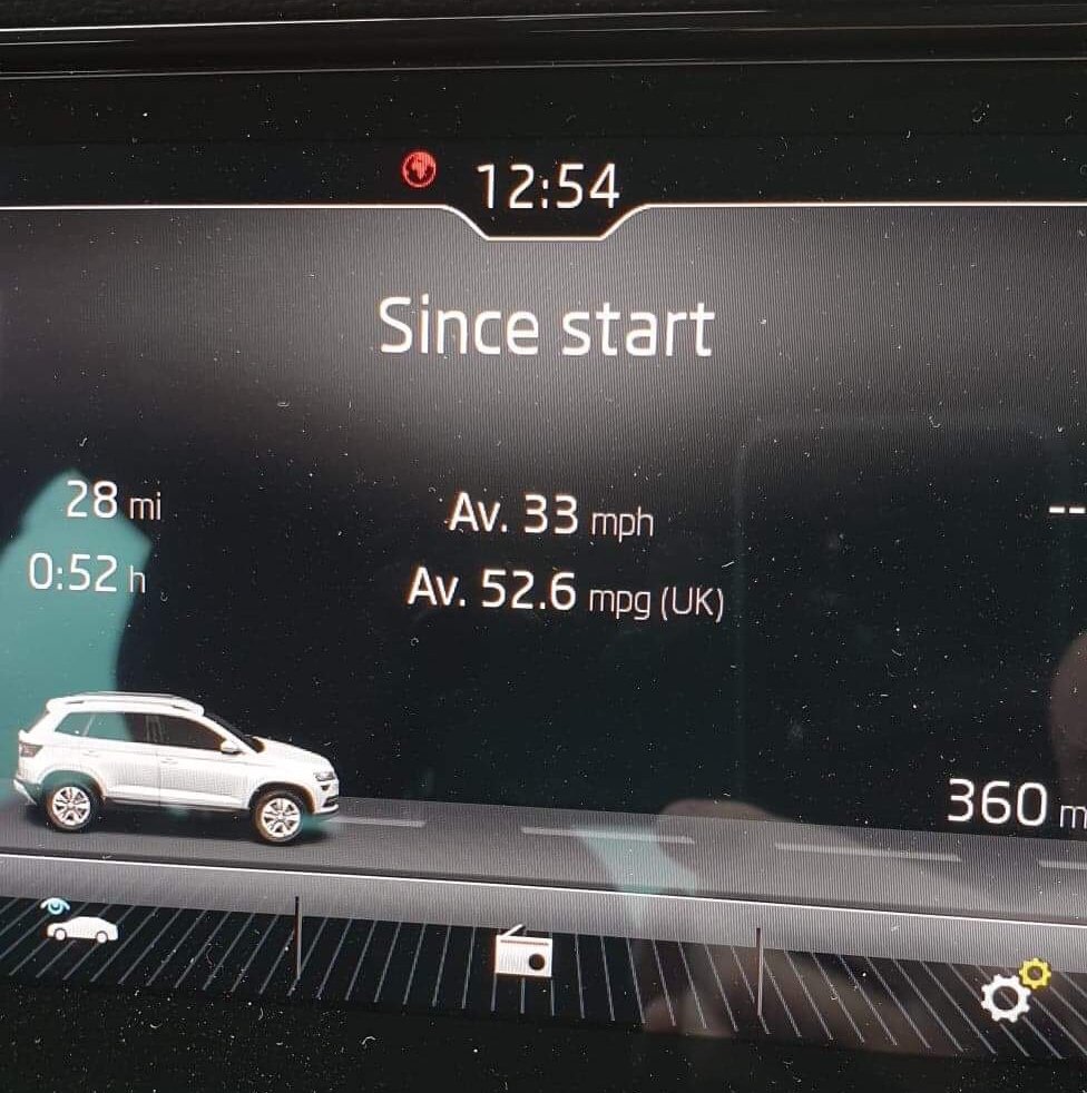

Happy days. Just done a 28 mile round trip to daughters house and achieved 52.6mpg.
I have no issues with the fuel consumption. Mine averages 38mpg on a three mile urban trip which I think is quite good.
