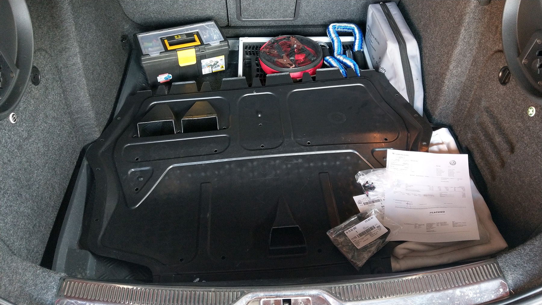

I've emptied the boot, including the emergency wheel  from its well, didn't help

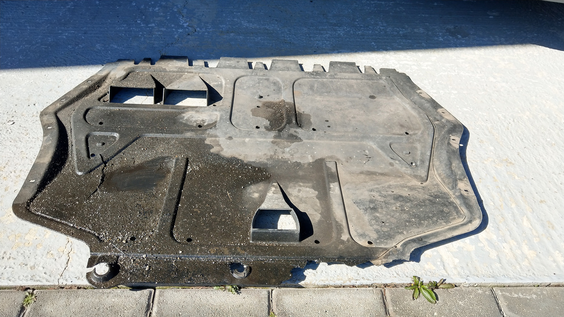

Engine under tray (old & new) - it had only one main bolt attached to the plastic, it was dangling around, and it was cracked on both sides, potentially falling off with the next encounter with whatever you can hit under the car. You can also see traces of oil on it, I think it is the engine valve rubber seal, will get to that soon  ... the new plastic tray, after being securely tightened, doesn't make any noise, can't hit the gearbox while moving around, and it holds the front wheel arches plastic covers more securely in place.

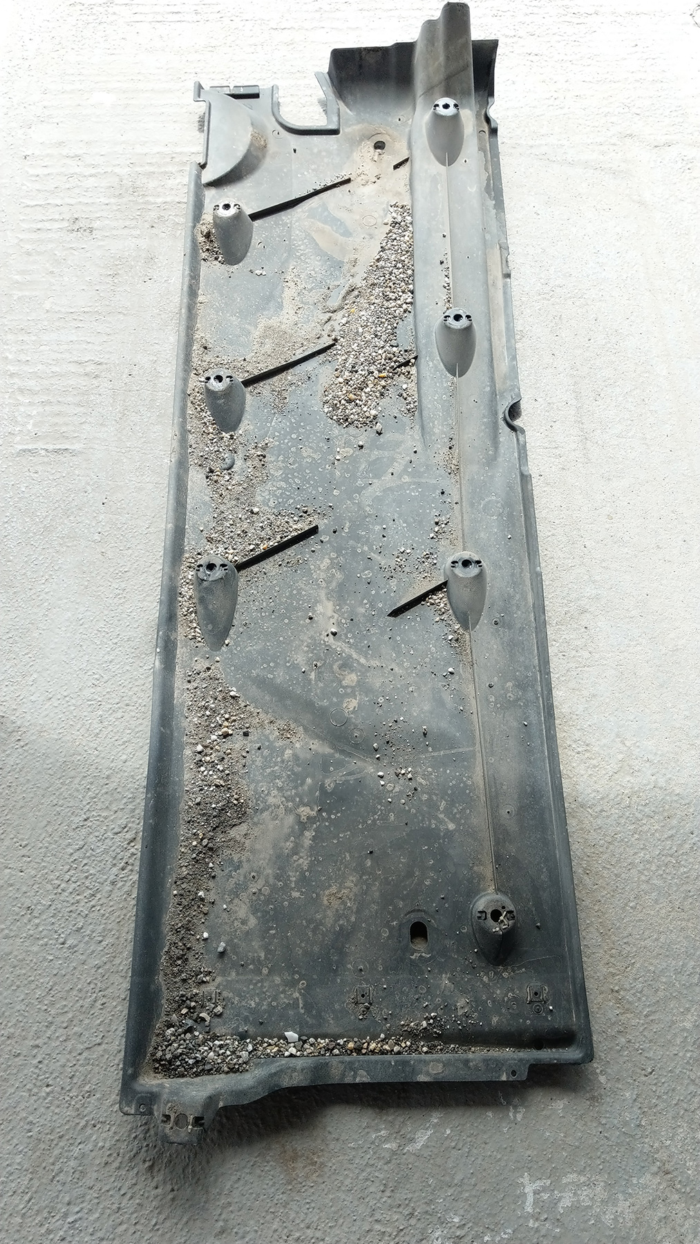

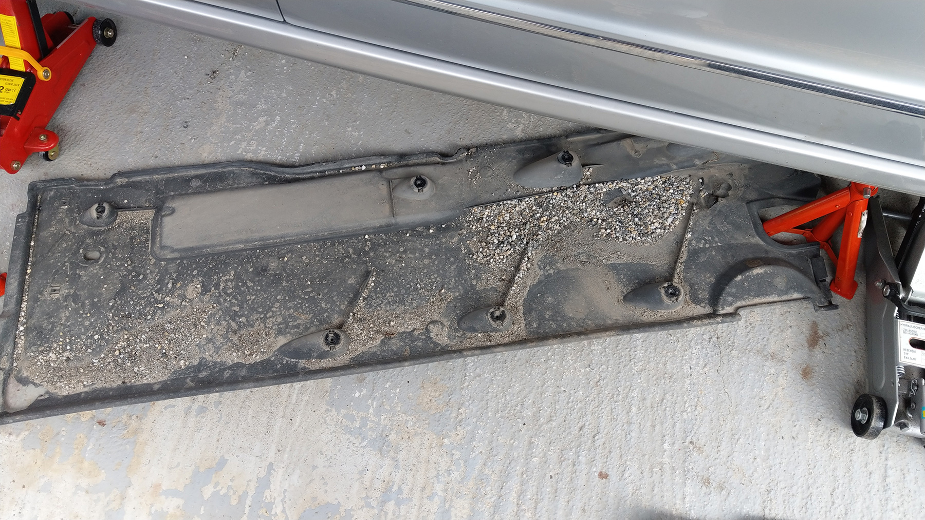

Under body plastic covers (both sides) - removed the debris, dirt and gravel that was in them, not that much actually (if no one removed them for 10 years)

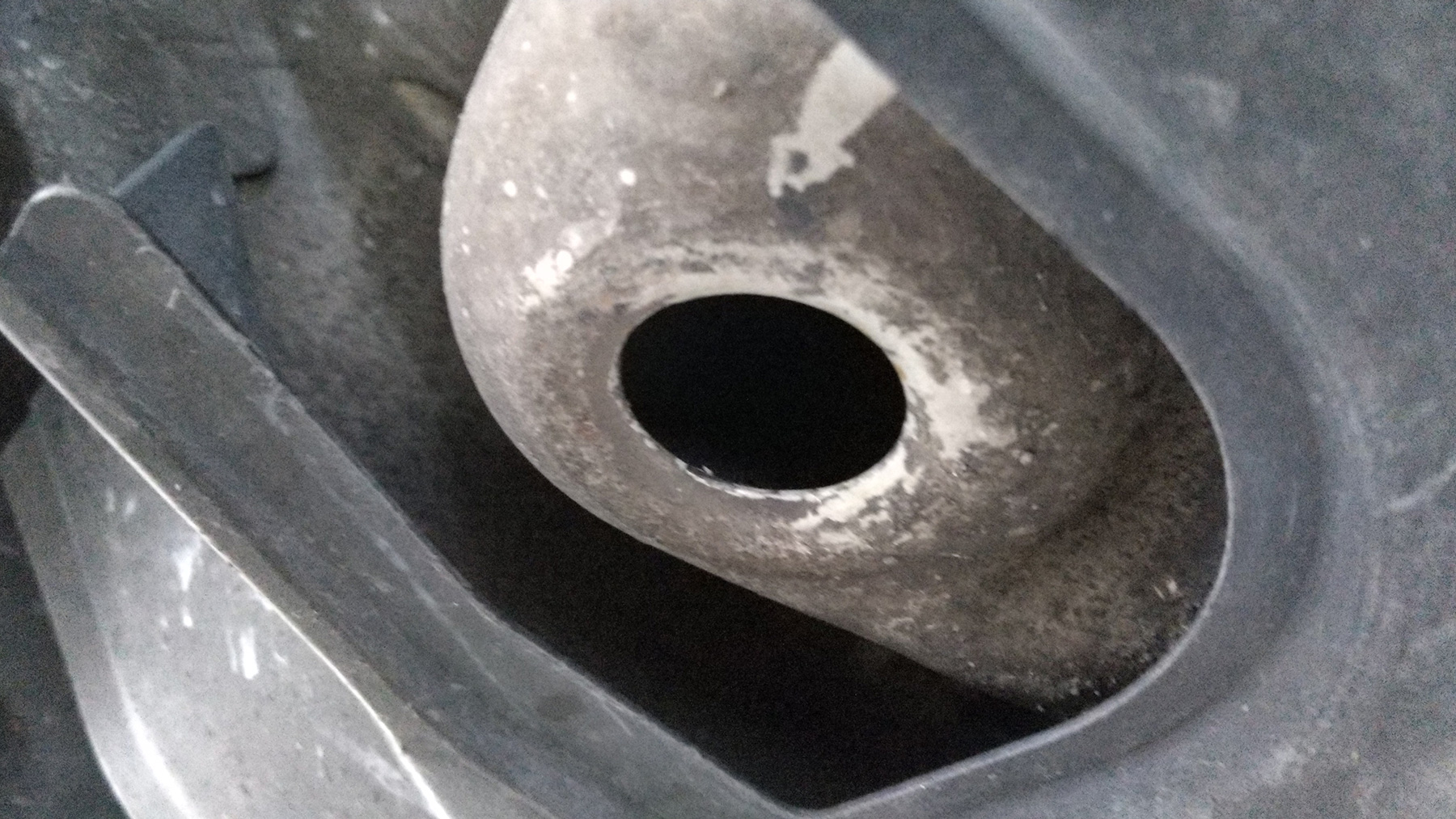

Don't ask - some kind of hard pipes that are going from the rear left wheel arch towards the front (under the rear left passenger, before & after) ... the left one on the picture could produce sound to the chassis behind it (but probably not during normal driving conditions), I've used a plastic strap to just slightly pull it closer to the right one, now there is no way for it to make any sound
That's only part 1 of 2 ..

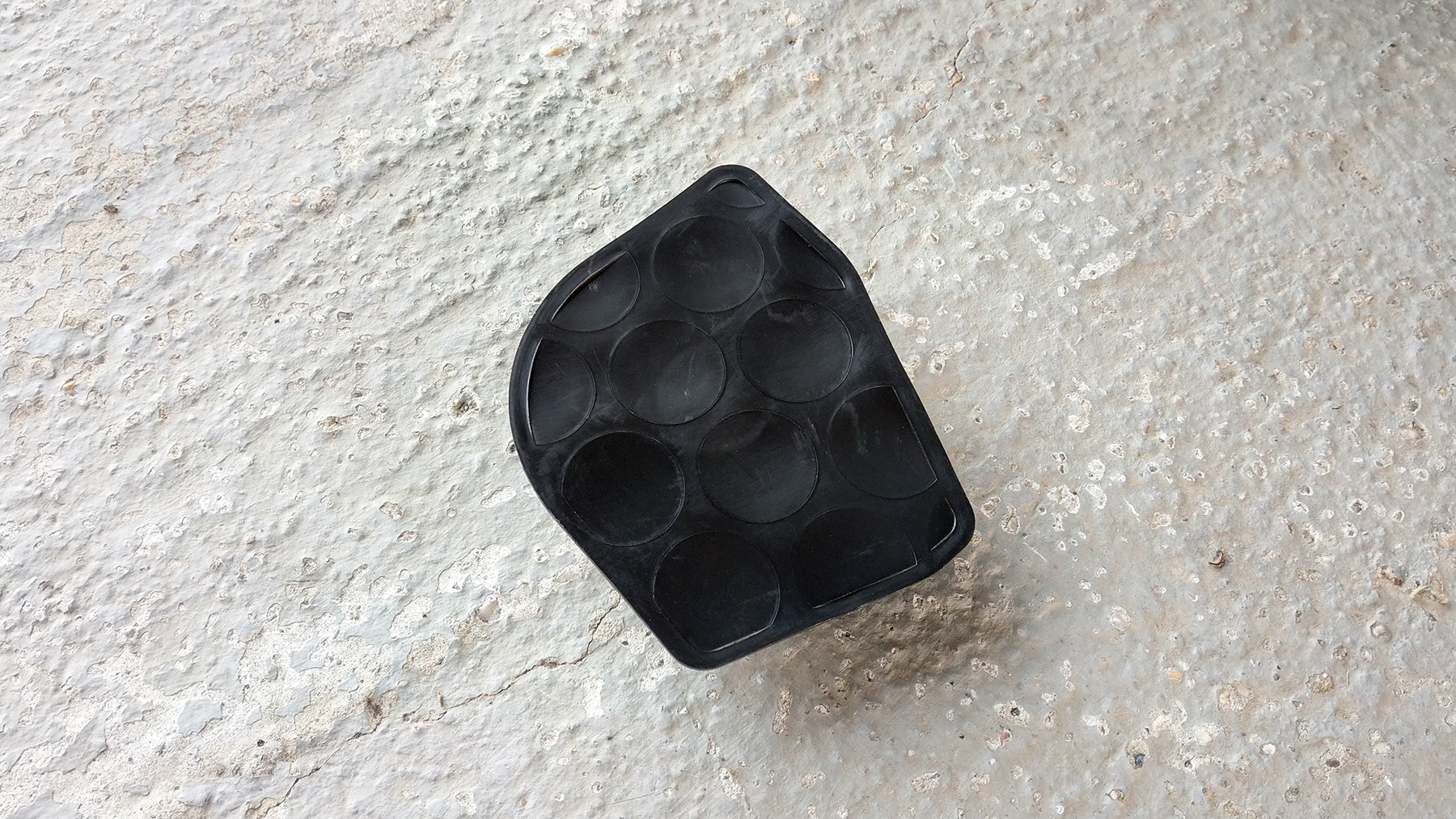

The driver's side behind wheel arch plastic cover (that holds in place the left side plastic body cover) - it was missing, so I've ordered it (cost 1.5 GBP - yes, I've written int correctly) and attached it to the chassis.Holds the plastic cover in place nicely.

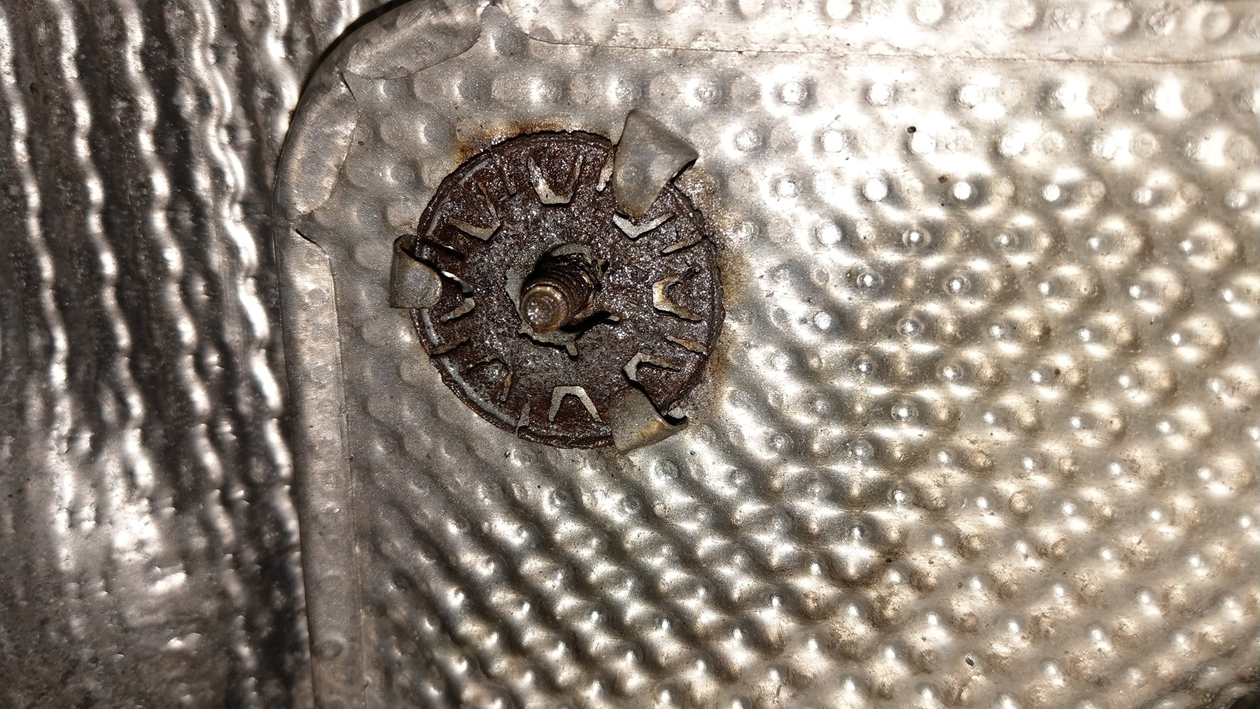

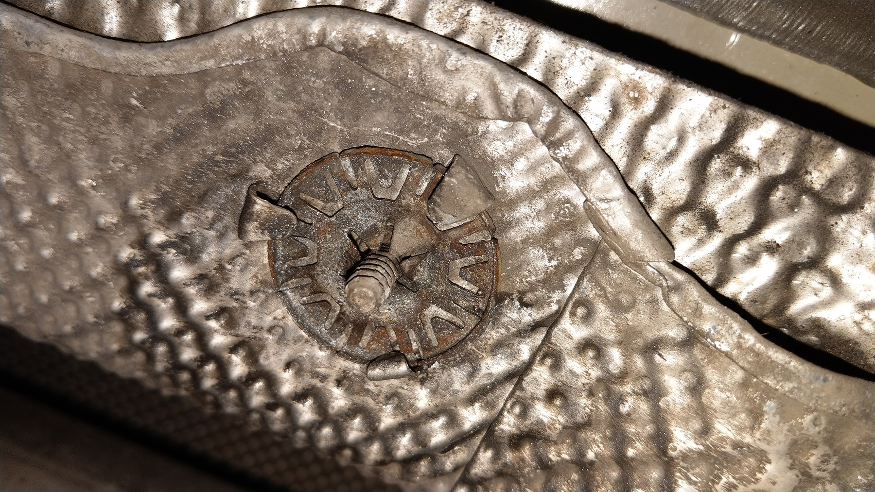

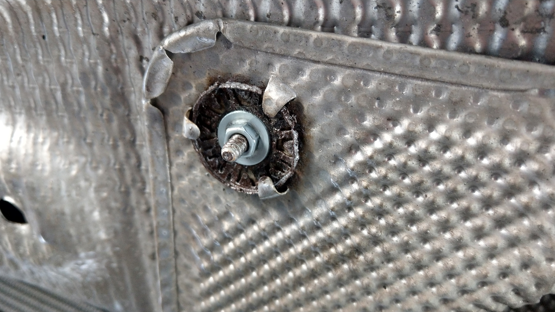

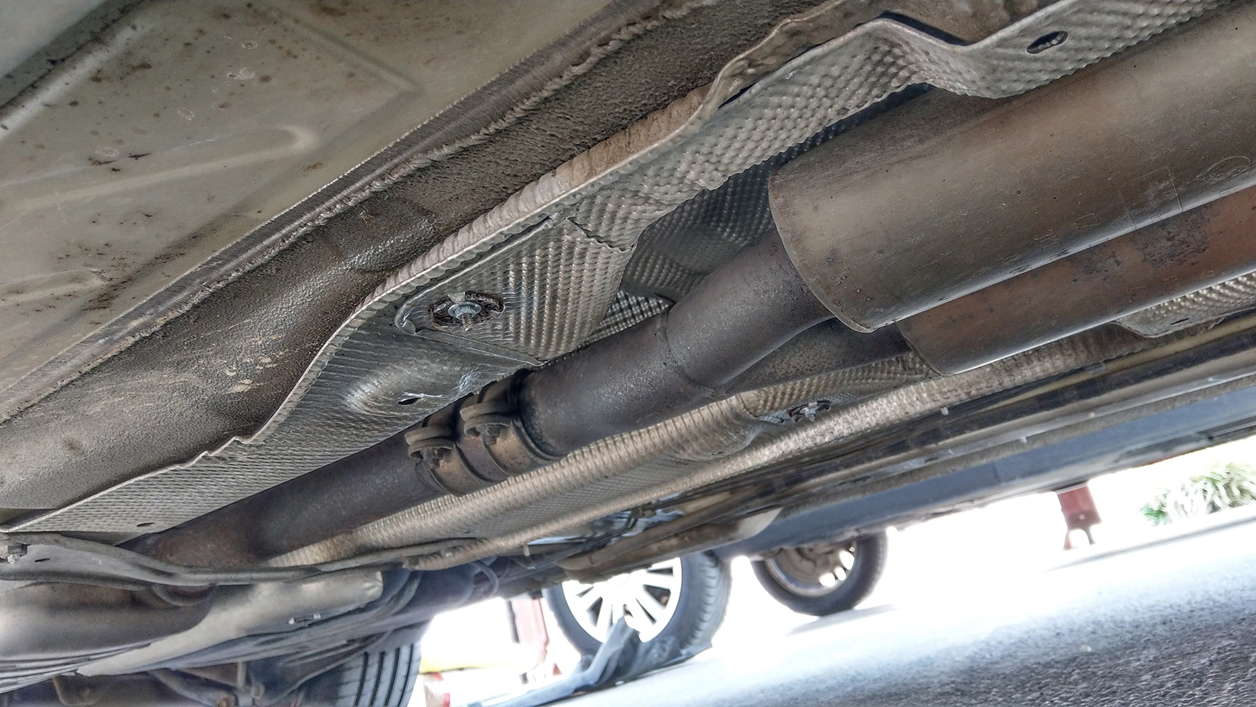

Metal "nuts" that hold the exhaust thermal insulation to the chassis - this was a WTF moment of revelation - who in their right mind designs these things - the rust ate two of them away (symmetrically on each side), and the front part of the middle insulation metal sheet was freely thumping around ... I hope this was the rattle-maker while driving in certain speeds, which could start vibrating on a normal, straight road, probably due to wind turbulence under the car. I've applied some Nigrin Anti-rust spray (that clears it away and provides metal protection), put a M5 nut with a washer below it, and tightened it in place (times two), and now the thermal insulation can't make any noise even if it wanted.

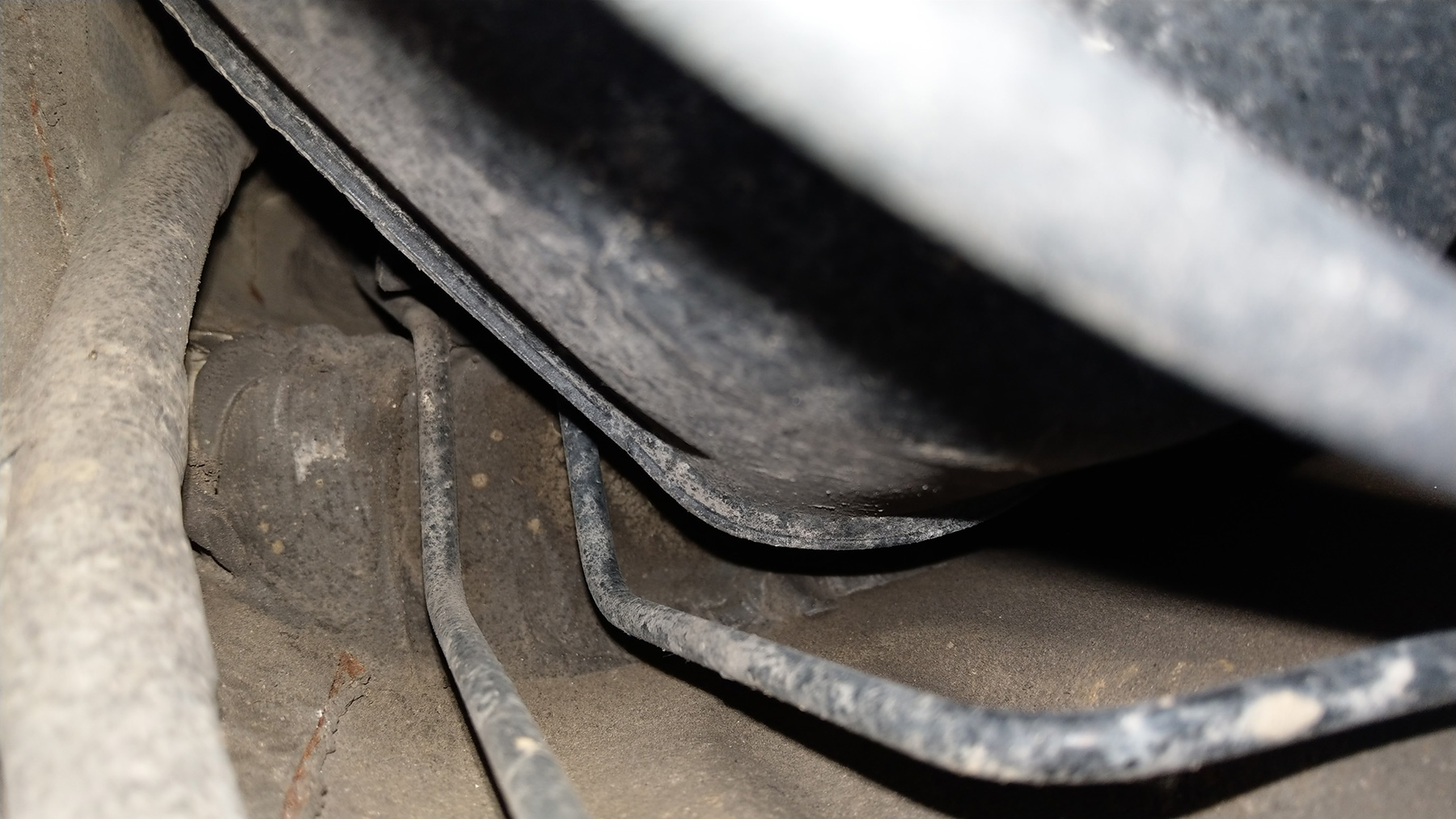

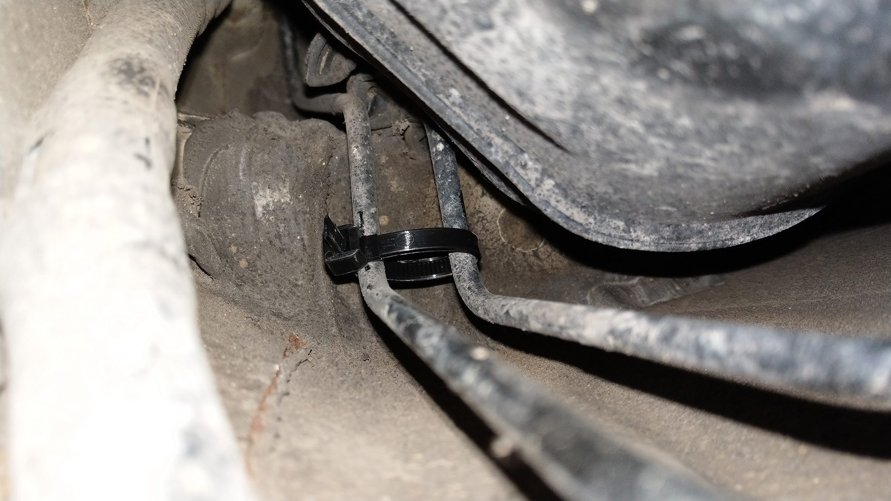

Fuel line from the reservoir to the front (passenger side - right side of the car) - unintentionally, I've figured out that the fuel line and the other pipe that goes parallel with it can rattle within the chassis, so I've put some rubber as a strip inside, to envelop the pipes and reduce the chance of them rattling.

Fuel line situation
