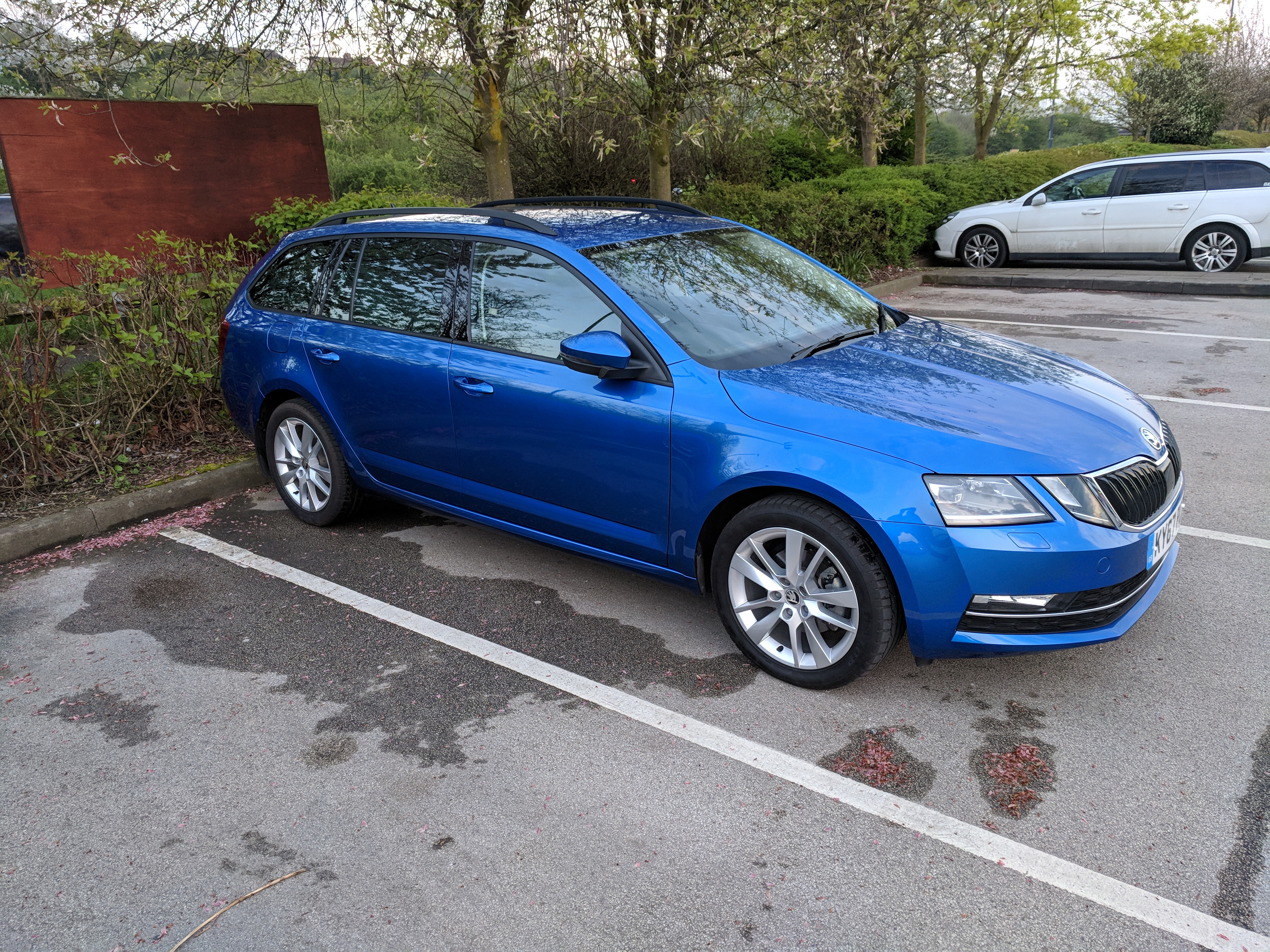

On Monday I collected my new car, well it's new to me and a 67 plate. After months of searching I finally found one with the extras that I had hoped for. I've stayed with the Octavia dsg estate but this time it's 2.0 TDI SEL spec. not a 1.6 like the one before.
It's only had one owner from new and a measly 865 miles on the clock :thumbup: I got a fair price for the previous one, so it's been a week of getting used to the new car and it's features, etc.
Seeing as I have obd11 I have made a few adaptations, but a few more need to be made as I get used to her.
My biggest gripe to date is the faf of having to select eco every time I start it up. I've searched and I've not found the adaptation to set it to stay on eco. So if anyone can point me to the instructions I'd be very grateful.
I've changed the headlight assistant to come on at 30 mph instead of 45, I've changed the comfort blinker from 3 to 4 , I'm seriously considering turning off the stop start, but holding off on that for now.
When I figured out how to post a photo or two I'll put some up, it's lovely in race blue with the 17" trius alloys.
I'm doing about 22 to 24 thousand miles a year so I think this is going to be a keeper, well longer than the last one, I didn't have it more than 18 months :D

Picture of the lovely lady below :blush
